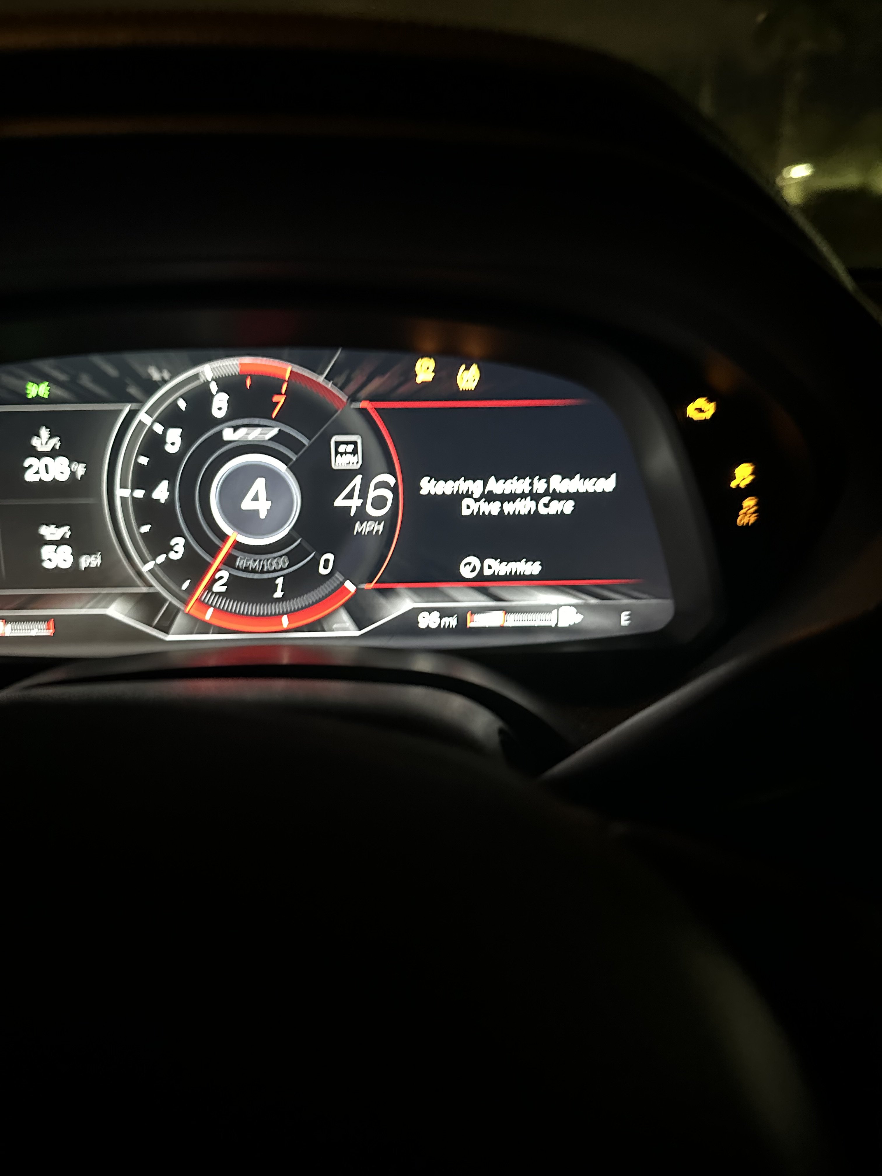

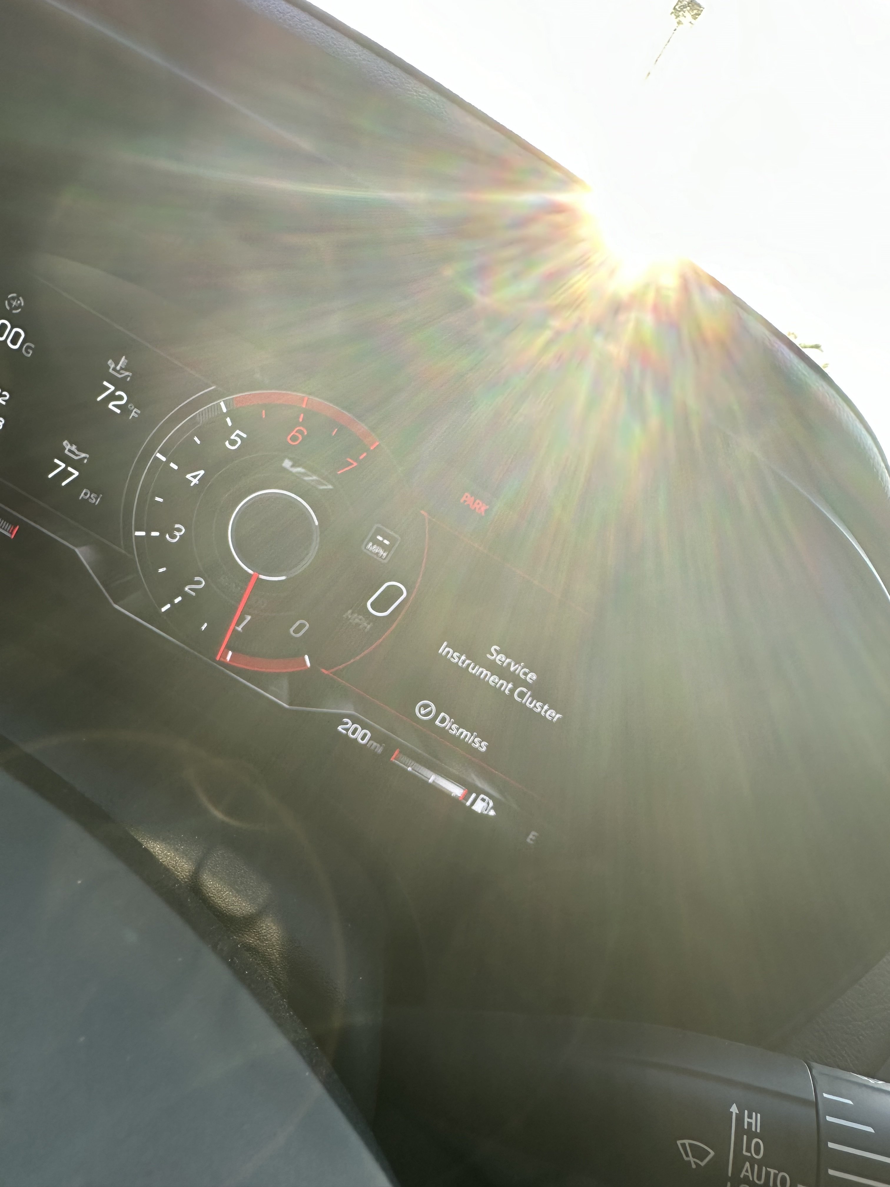

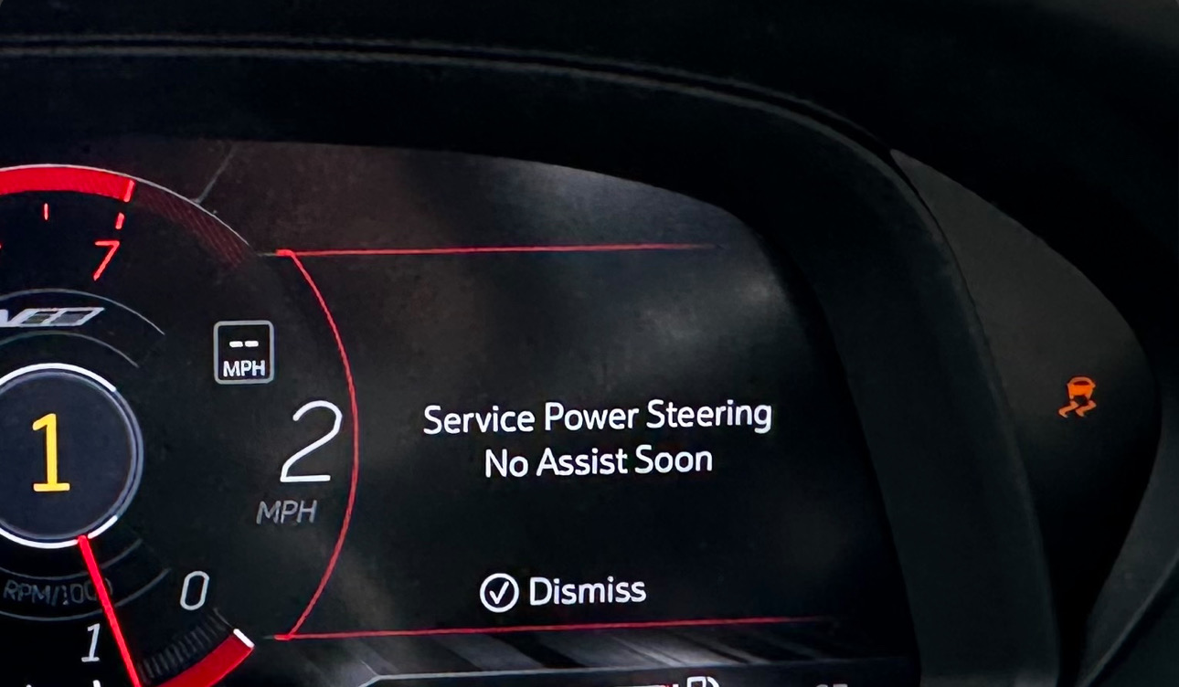

Can anyone take a video of the problem happening ? I’m currently fighting the same issue. 2022 CT-4V blackwing manual with 14k miles & the car does this. I’m in Florida and Cadillac denied my demand letter & final repair attempt bc I had a Tmobile sync up drive in my console. It wasn’t even plugged in. Regardless my steering goes out, my brakes go out & my e brake stops working. I have lost all faith in the vehicle. They only did software updates and tried to blame it on the battery. I drove this car 14k miles and they drove it 34 miles saying they couldn’t replicate the issue. Well no shit you guys don’t even know what it is!
