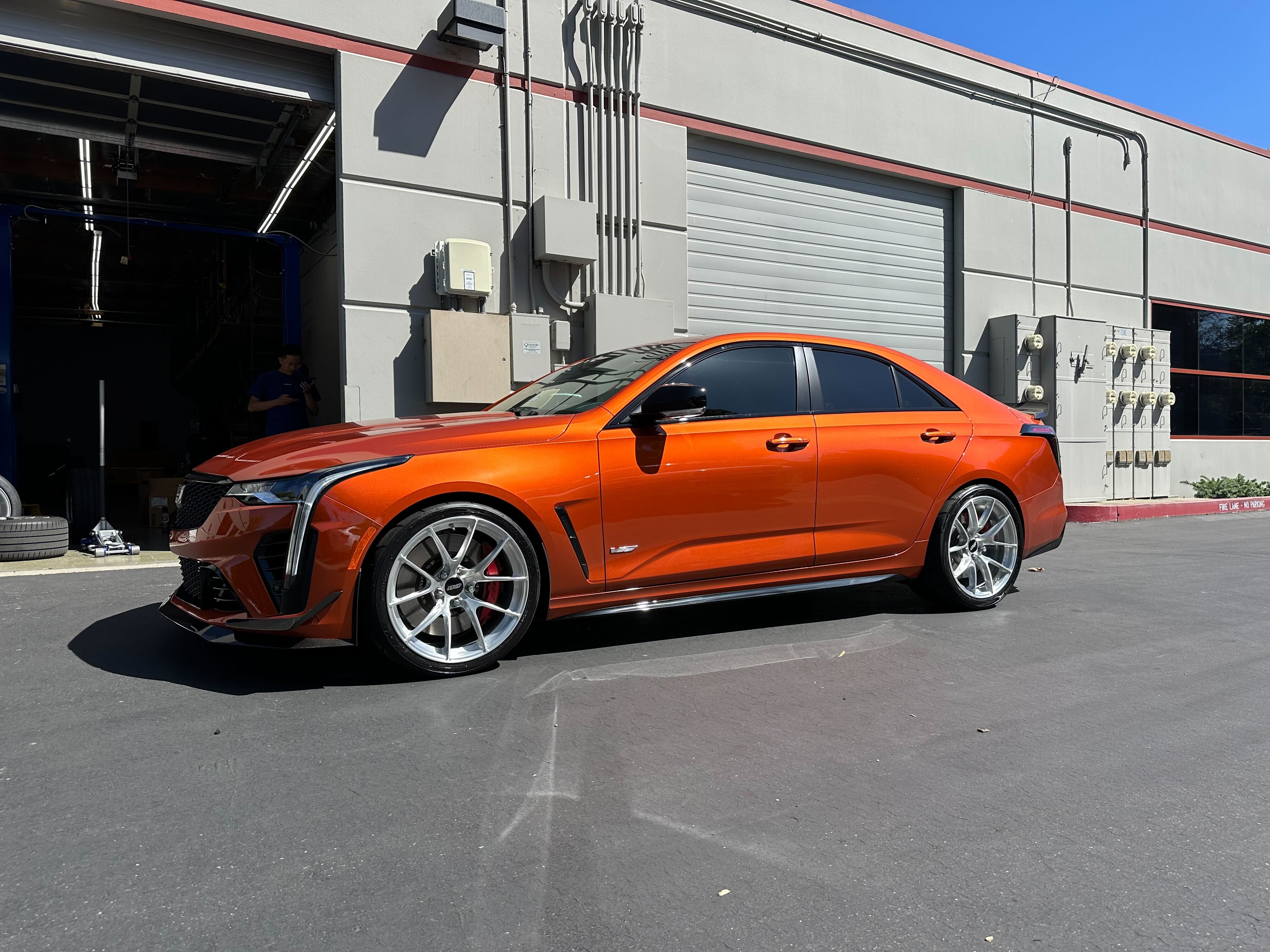

Nice selection of cars! I saw your email come through this morning so I will respond there. For everyone else, we just had a CT4-V BW in the shop the past few days testing numerous combinations. Here's a behind the scenes cell phone shot of VS-5RS in Brushed Clear running 19x9.5" ET22 front with 265/30-19 // 19x10.5" ET45 rear with 295/30-19. All stock, no mods, no rubbing while driving.

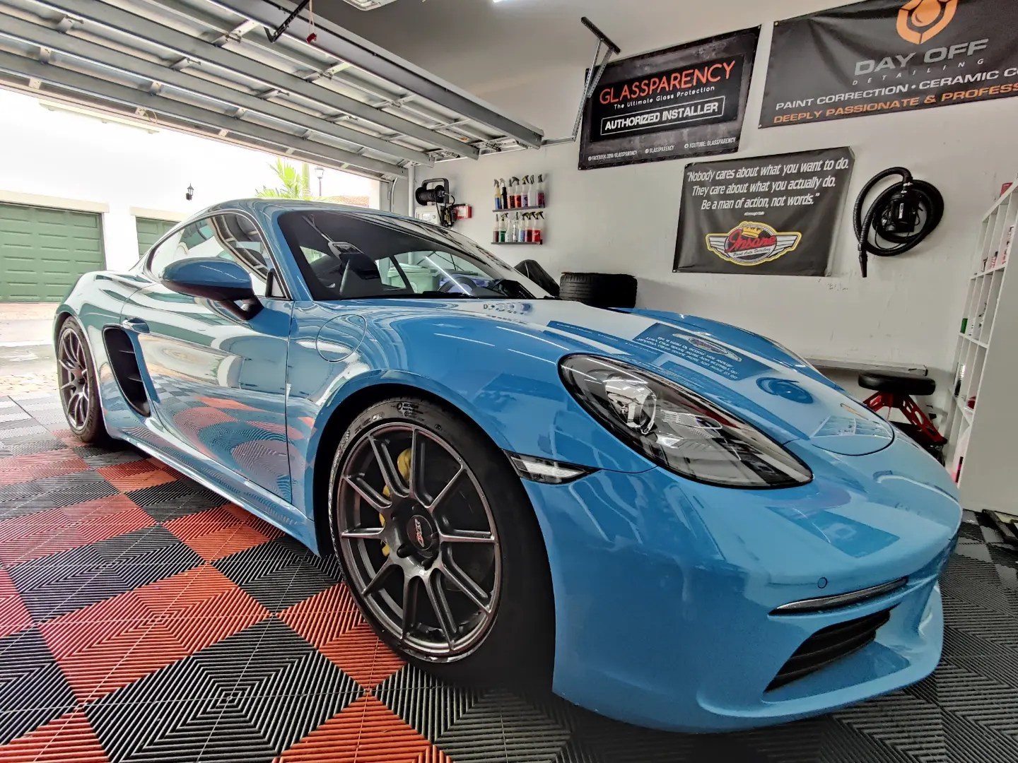

Just a few from the collection. I'm loyal to Apex Wheels. They've been good to me and what I put my cars through.
