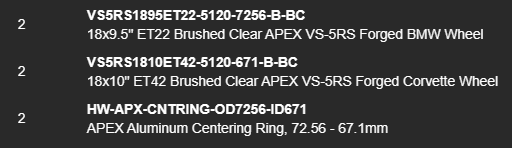

The gentleman you are looking for is Cory Smetzler @ Apex Support -- email is support@apexwheels.com
Extremely knowledgeable and very quick to respond -- here is the setup I went with

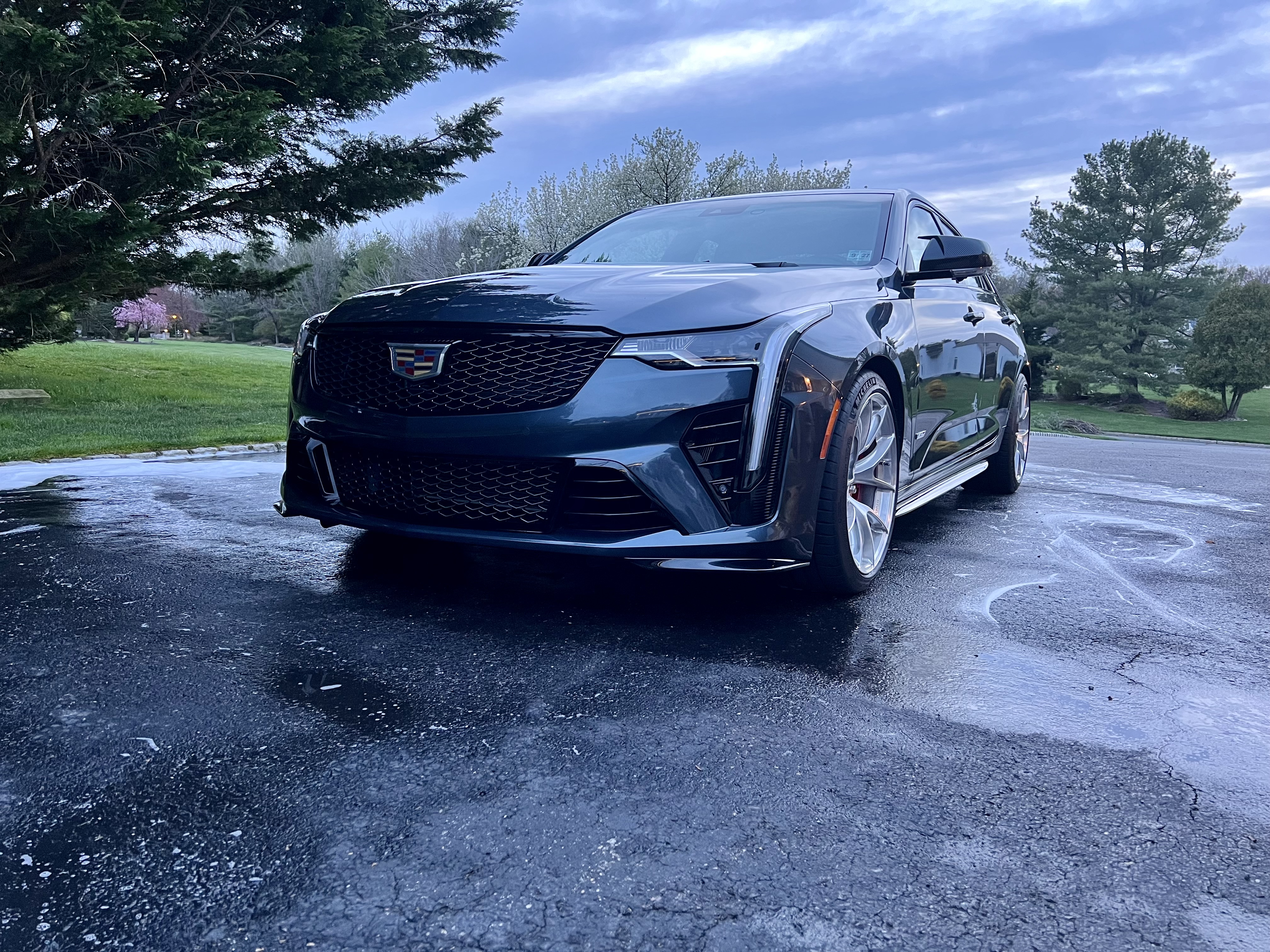

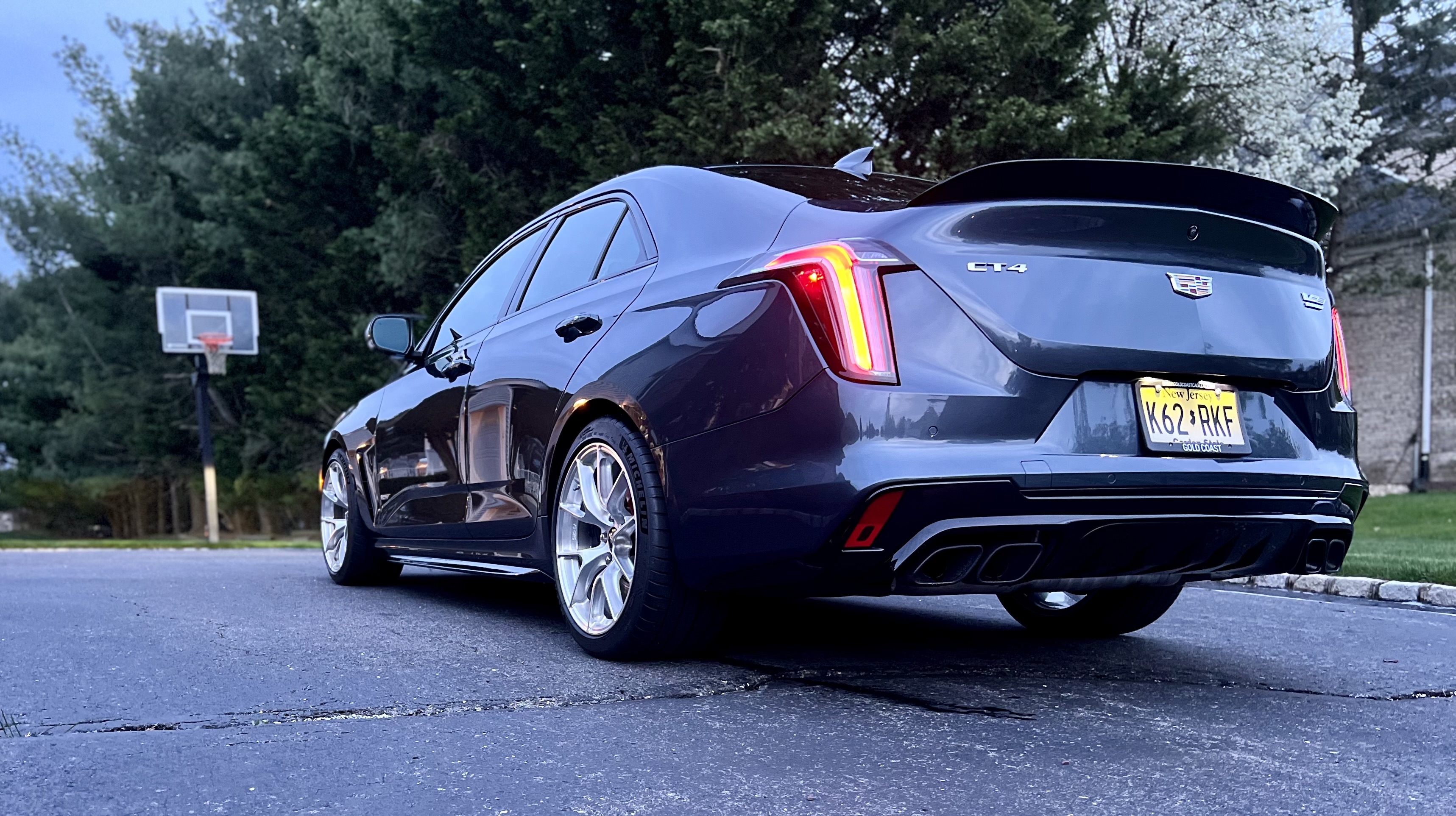

I went with Anthracite in OEM spec and mounted the stock tires. I will say the pictures don’t do these wheels justice in my opinion (not that they look bad in photos, just better in person). I initially ordered these in Satin Black then changed my mind to Anthracite and I’m glad I did. I think these show the depth/detail a bit better and some of that can be lost in the satin black. The wheels have some concave which I like. This is stock size but the rear looks like it pokes out just a bit more which I think was confirmed in prior posts due to offset. I did not need spacers but Discount Tire told me the stock lug nuts would damage the paint on the wheel. I know prior posts said you can use the stock lugs but I didn’t want to risk it so bought some they had on hand. I believe Apex marketed on the box these were shipped in “built to win races not shows” but these are the best looking wheels I have ever had on a vehicle. Very satisfied with these.

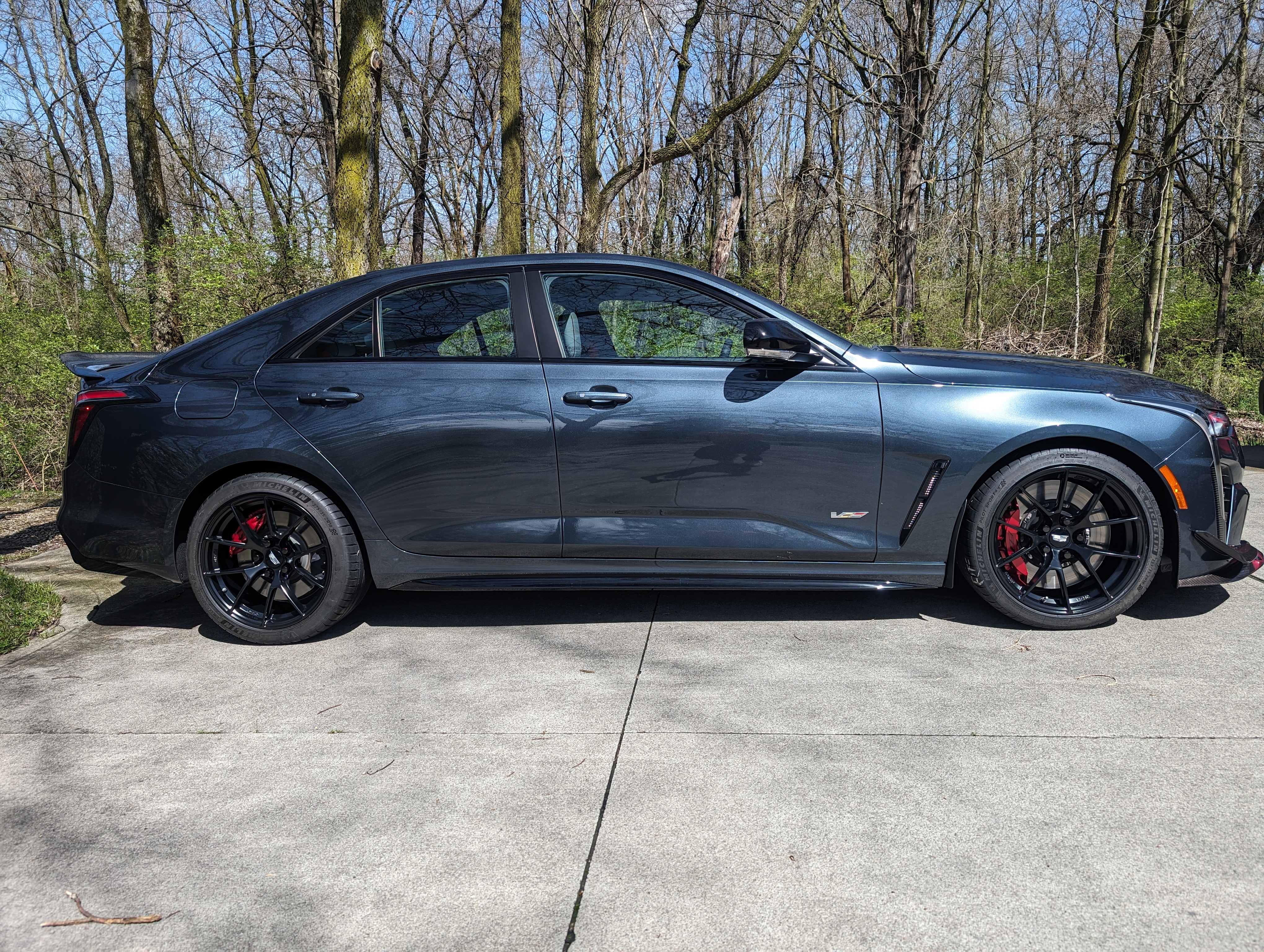

I'm happy with the satin black. I also considered the anthracite but thought it might be too close to the Shadow Metallic color and wanted some contrast, plus it matched the black trim. And we have bl4ck_wng with Shadow Metallic with silver for the trifecta.

I thought Apex were hub-centric and didn't require centering rings?
Some sizes are hub centric, some aren't. They're only there to help with initial installation though, once the lug nuts are torqued down the wheel becomes lug centric and the hub is not doing anything. Same way the factory wheels are setup.

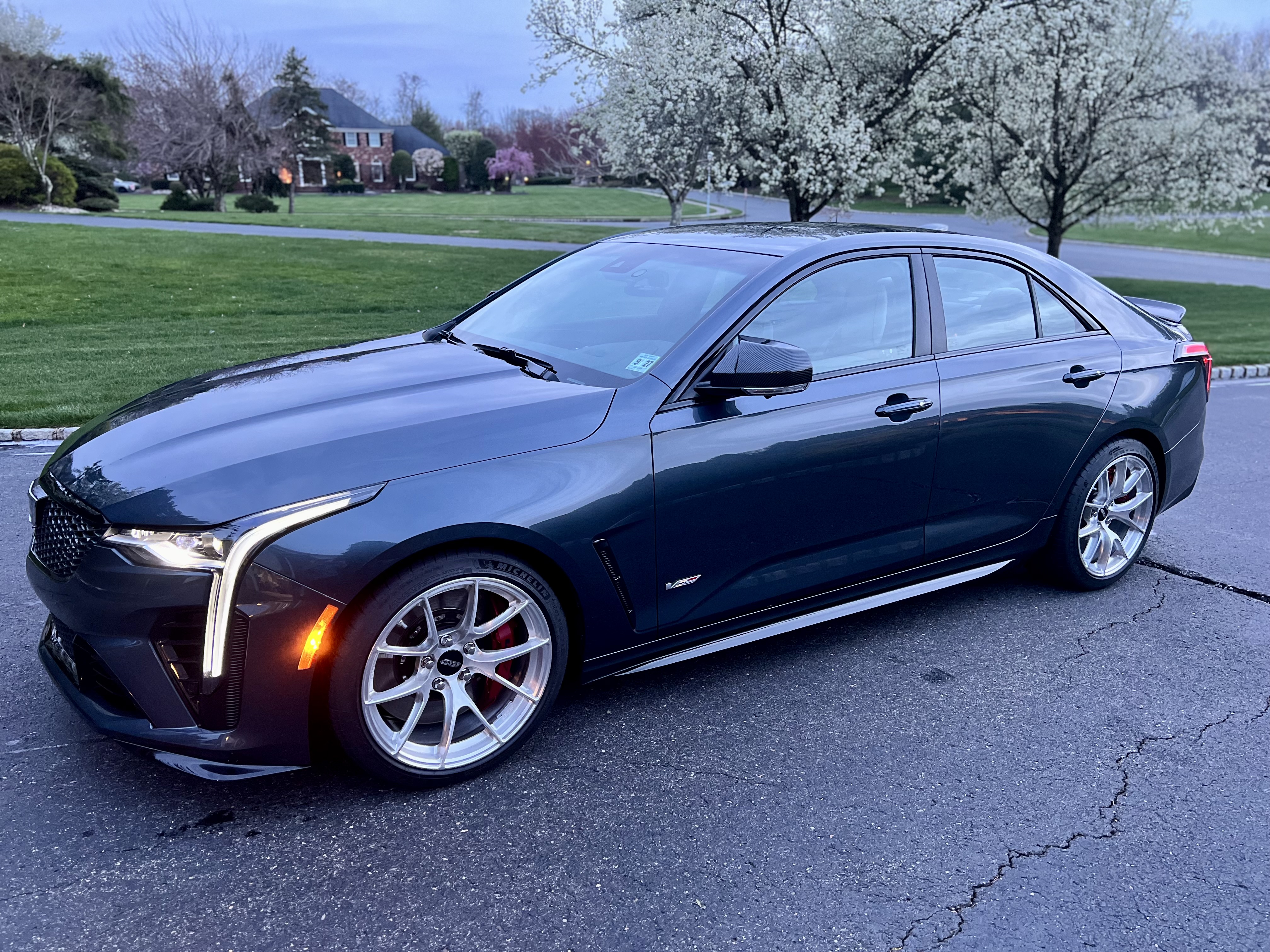

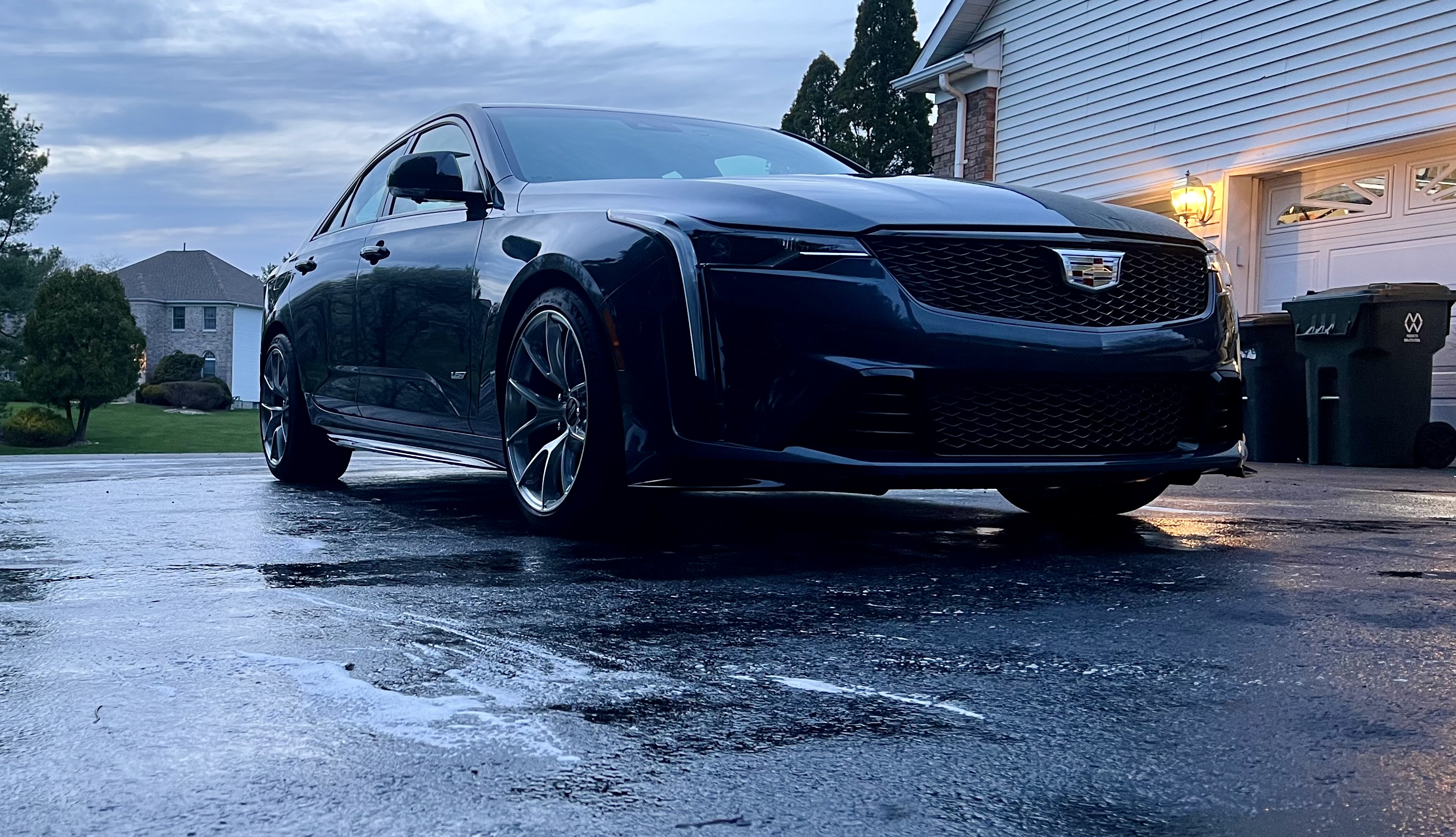

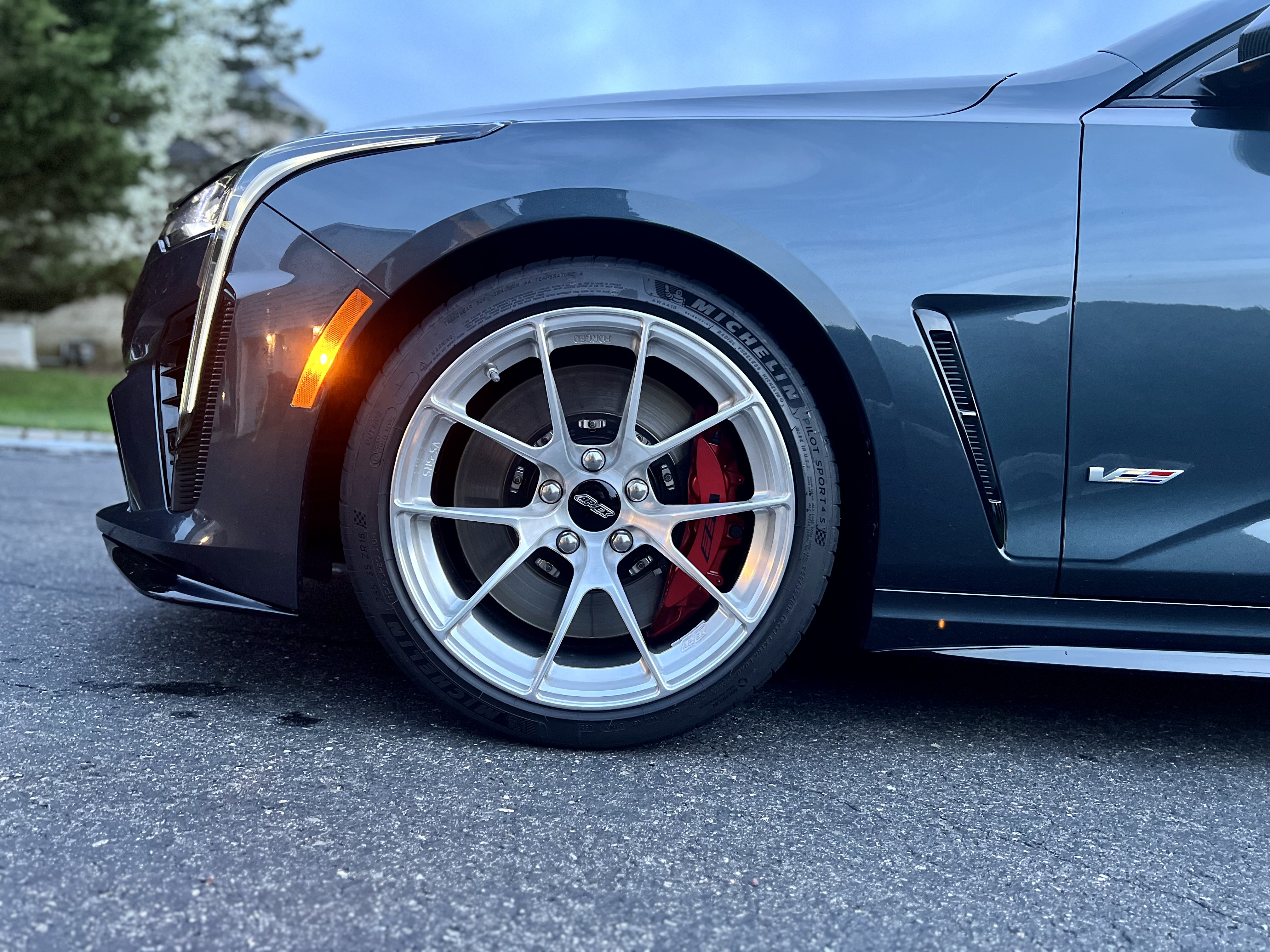

Can you post photos of your car with those weeks?. I found a post you placed on the "What did you do to your BW" thread but the pictures are very low res.
Yikes you are right— idk what happened there. See (hopefully better) pics below

Nope, these are BMW setups, they fit our cars, but require adapter rings to retain the hub-centric fit.
Not true, the factory wheels are hub-centric
Not exactly, the factory wheels use a tapered lug seat so when all 5 lug nuts are torqued down (ideally in a star/cross pattern), the hub is still floating in the bore.
That's why with the wheel pressed up against the rotor but without anything torqued, you can shift it up/down/left/right slightly. They're not an interference fit, there's still a gap.

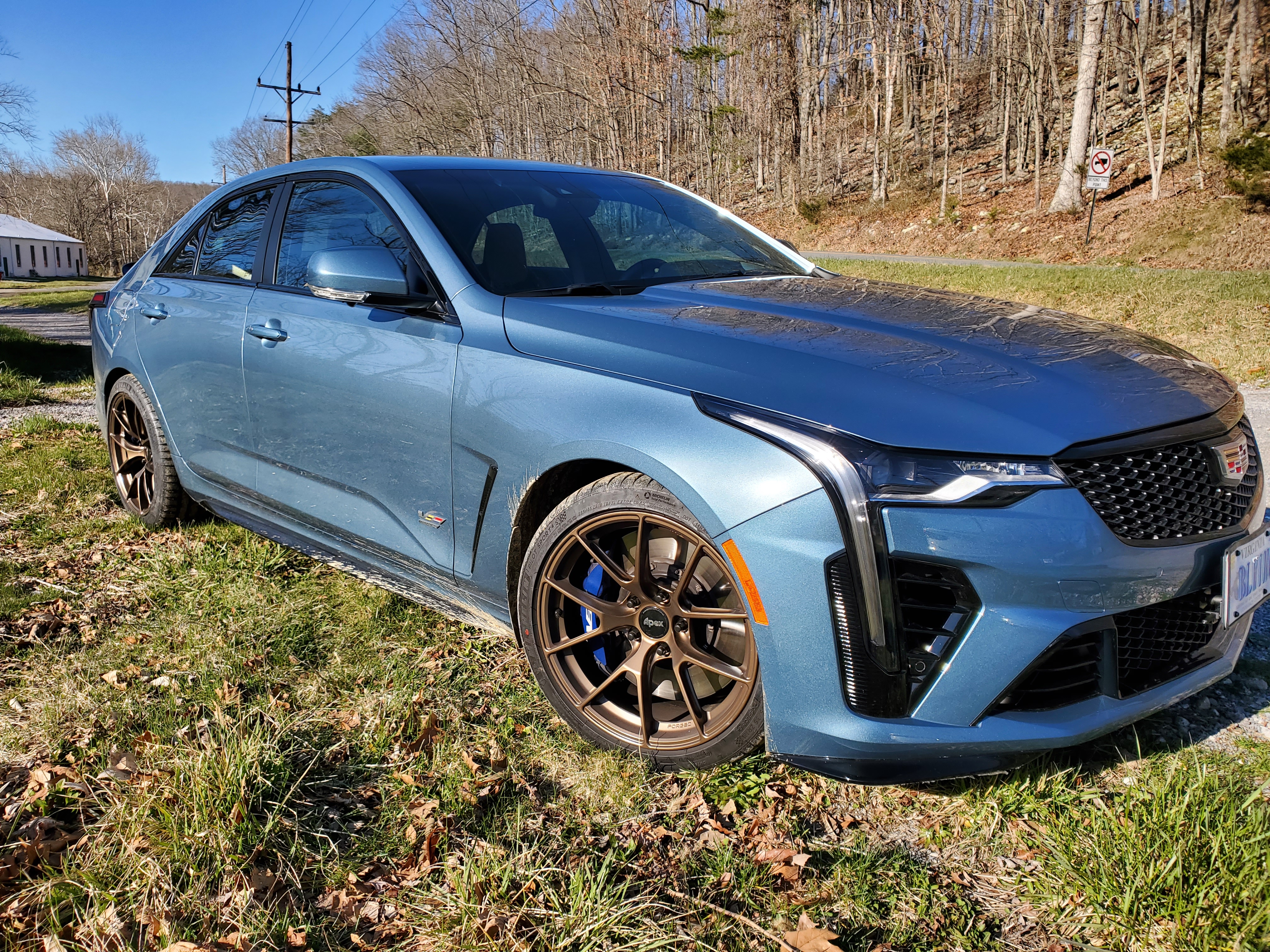

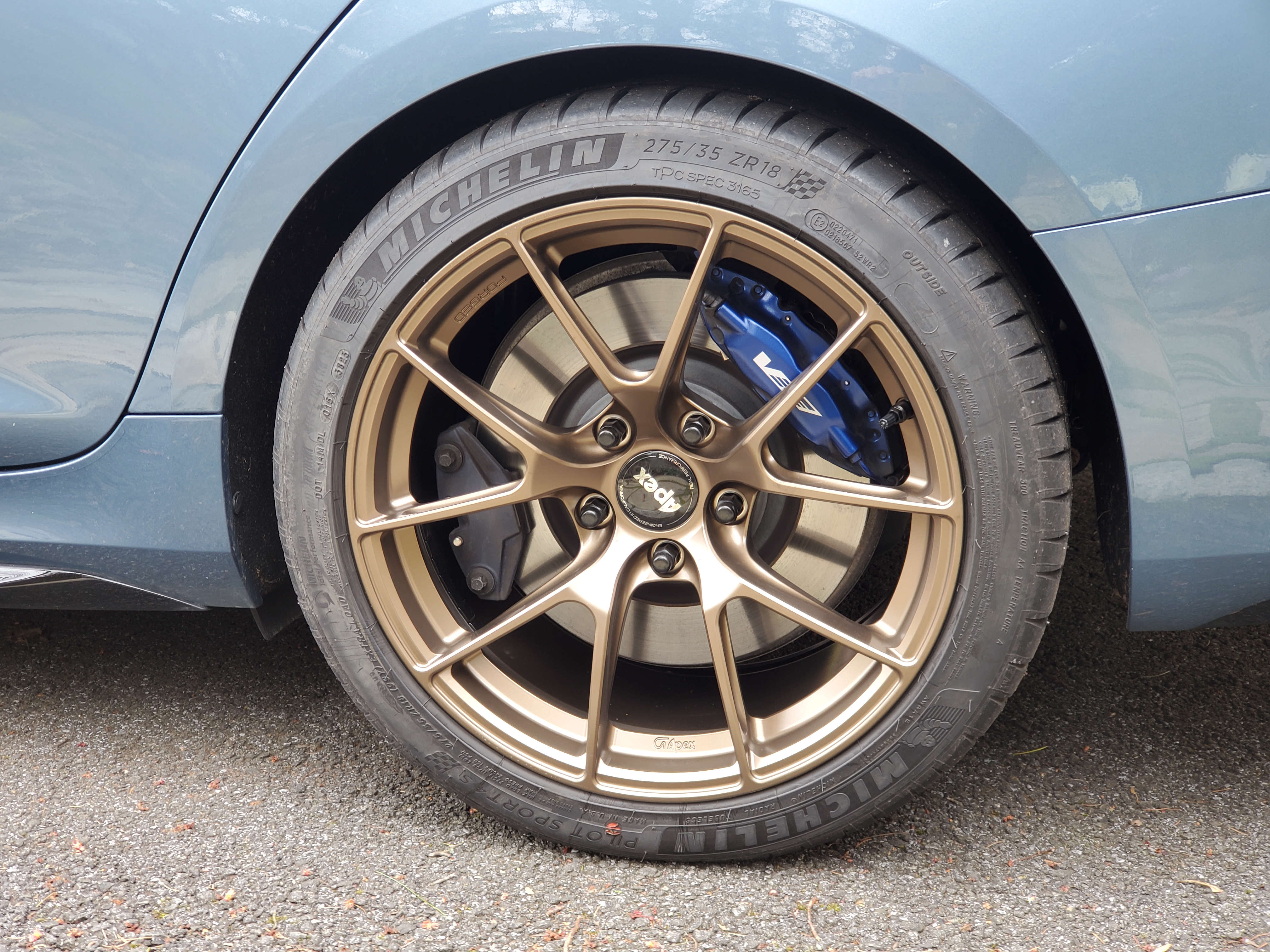

They have produced OEM spec bronze wheels but they are not always in stock. They often have sizes that are compatible with spacers and wheel rings etc. I'm using these and I think the fitment and offset look great. I should also note that they have several styles of wheels available in bronze.

That looks great!
I am debating between these and the cadillac tech bronze wheels.
That looks great!
I am a big fan of the OEM bronze wheels...and wish the car came with them. That being said - there is no comparison with the Apex wheels which (arguably) look better/more aggressive and are much lighter. Apex all the way IMO.
