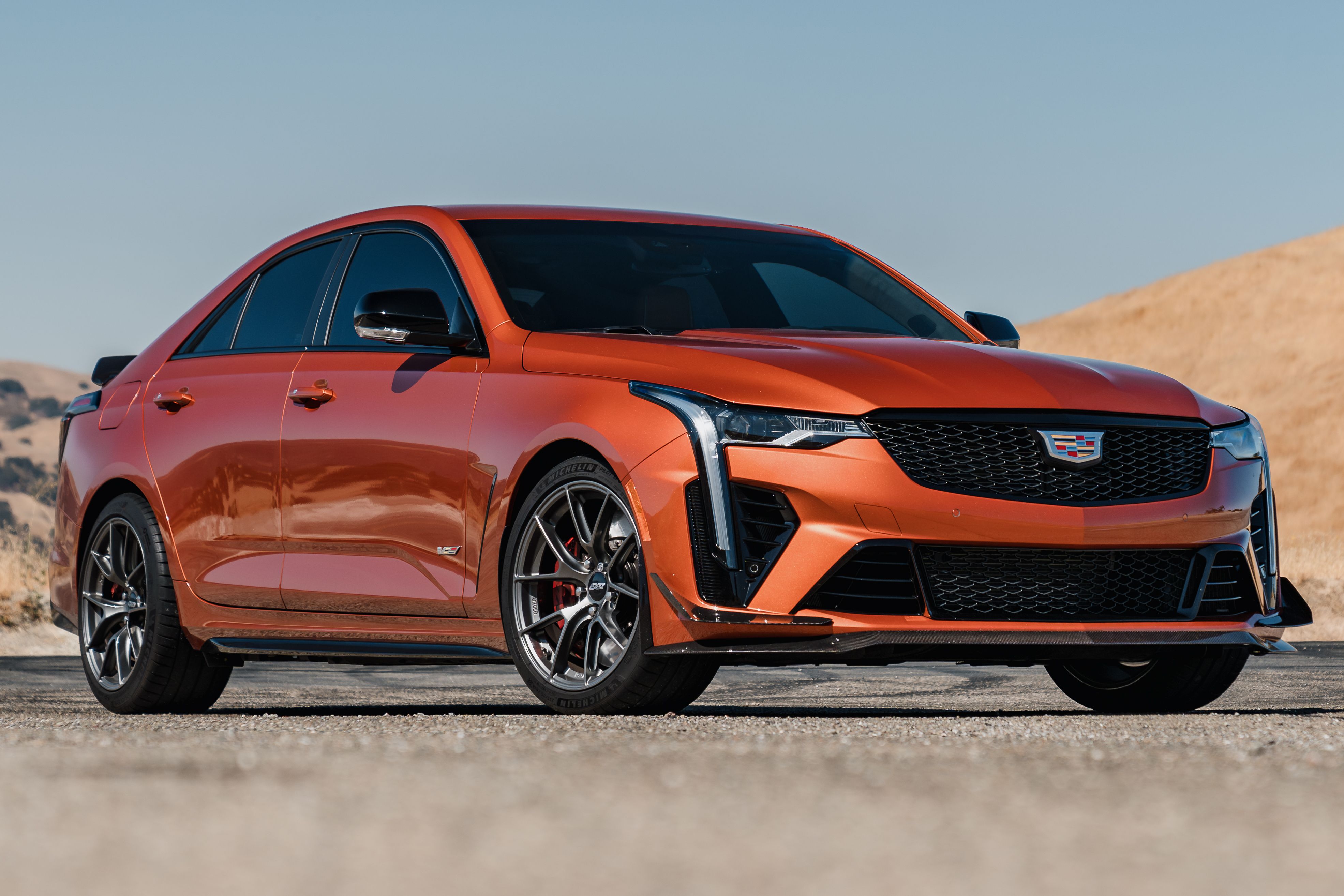

For reference, this car is running 18x9" ET30 front and 18x10" ET42 rear with the OEM tires.

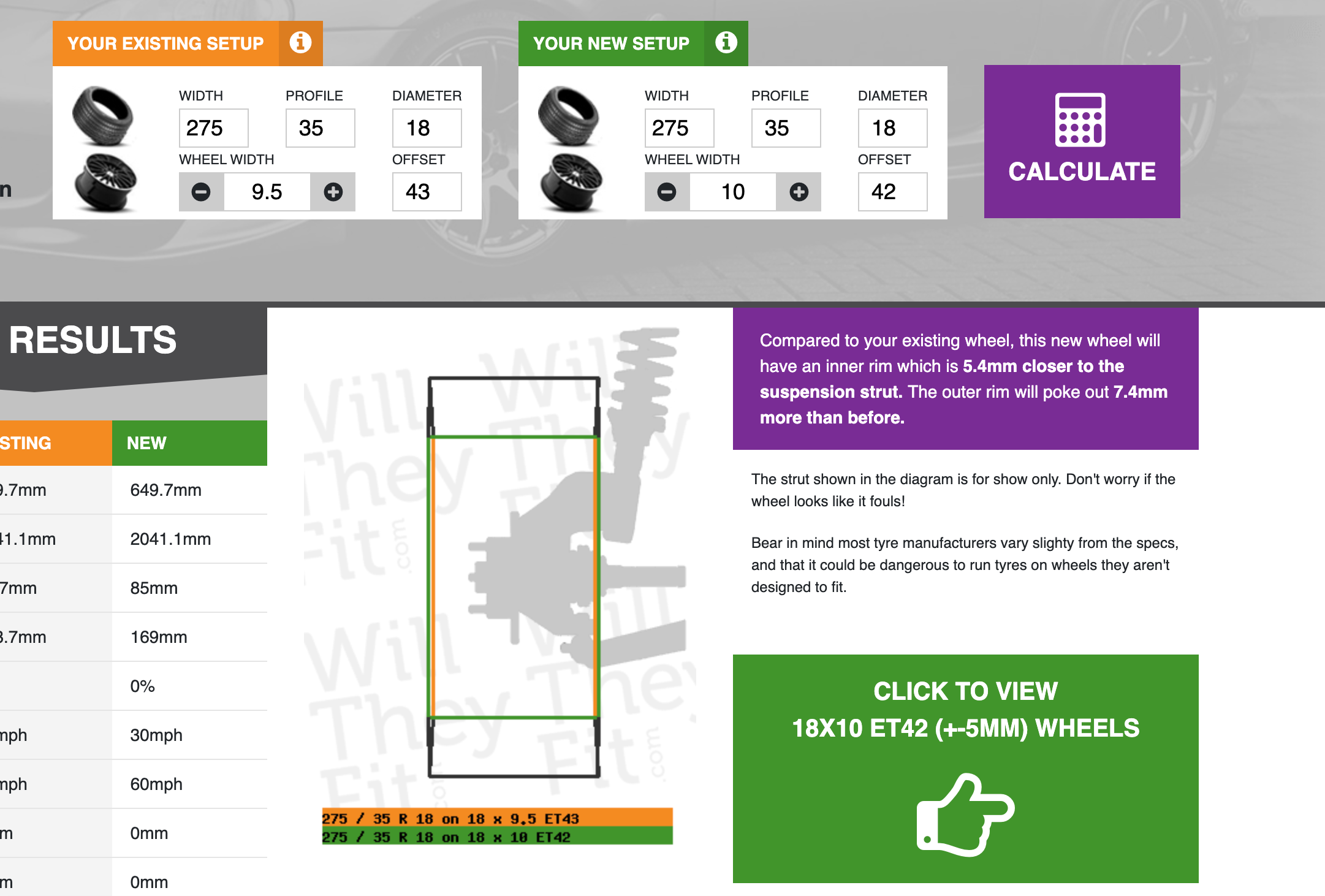

Curious... which would poke out further in the rear: the 18x10" ET42 in the picture above or the 18x9.5" ET43?
From the posts, it would seem like there is a 1mm difference, with the 10" wide rear slightly edging out 1mm more, but I just wanted to check in case there's something I'm missing.
Also, is this car at stock ride height too?
Offset changes with wheel width, so there is more than a 1mm difference. As you can see here, the 18x10" ET42 sits just over 7mm further out compared to the 18x9.5" ET43. The Orange car is factory suspension, yes.
And *that* is why you always consult with the experts first!! Thanks!!

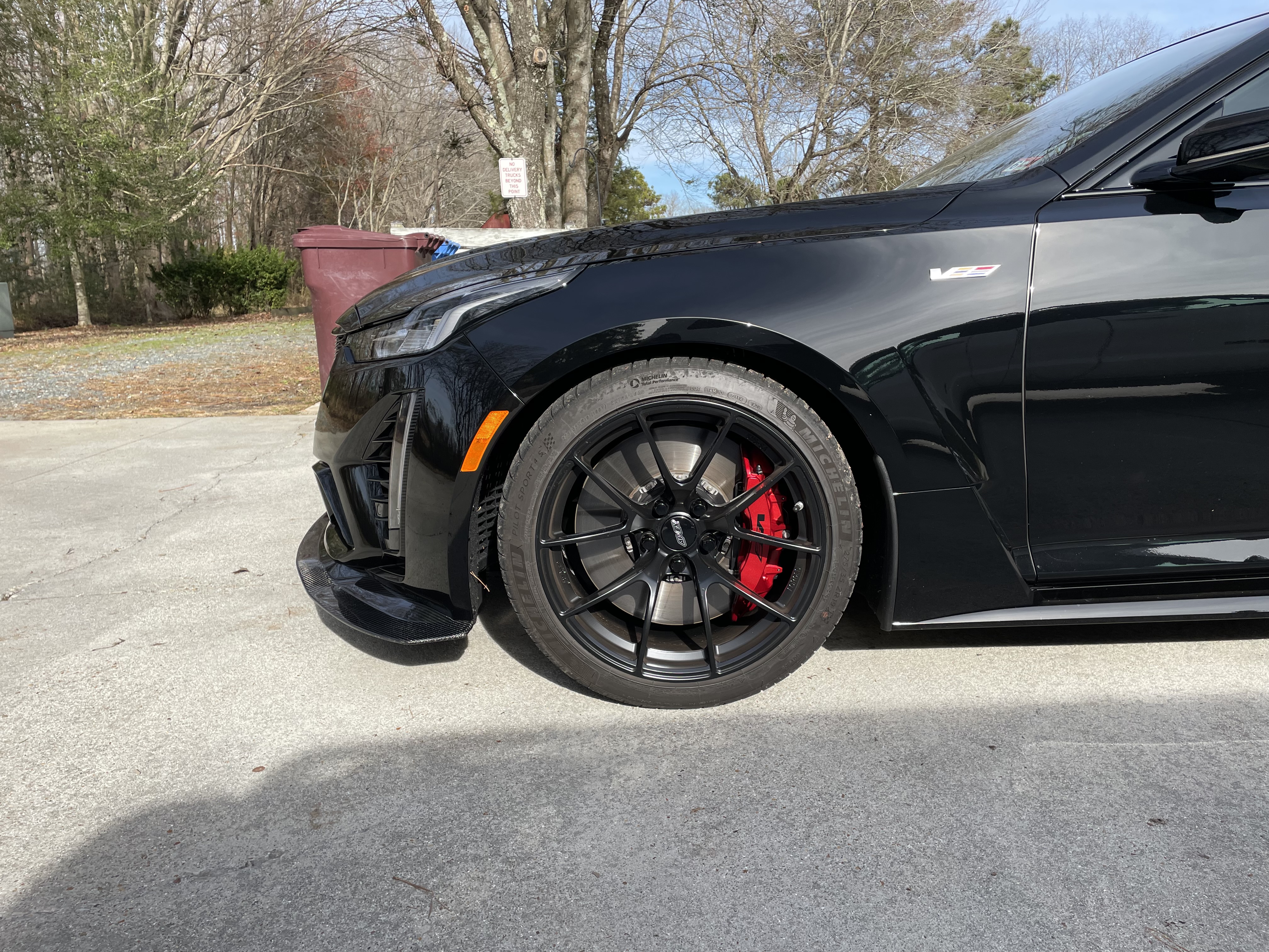

On a 5BW, but the VS5RS are such a perfectly designed wheel. Reminds of the BBS FIR. I purchased these during the BF sale, received them within a week.

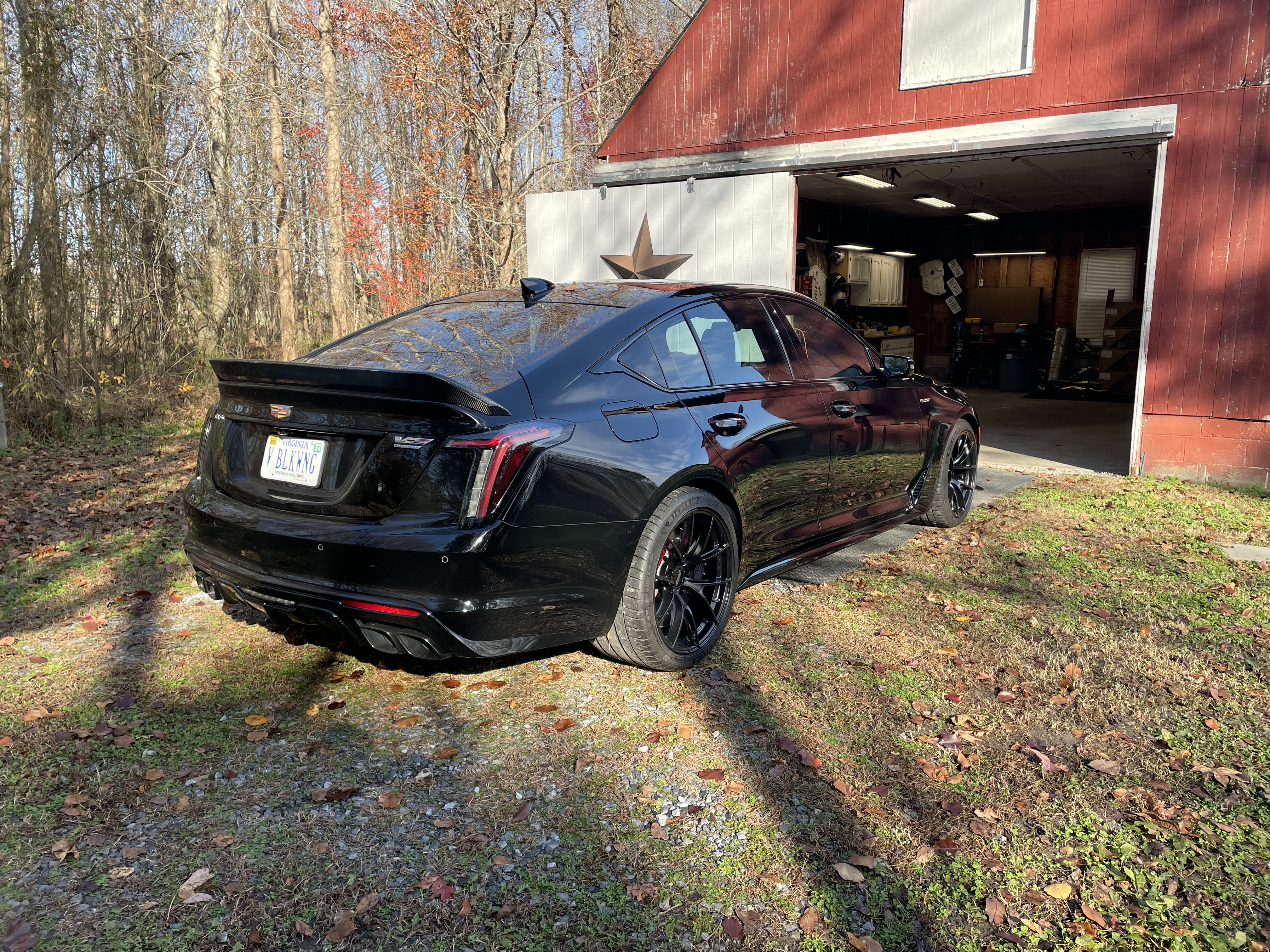

I ordered mine straight from Apex website on Black Friday sales so got pretty decent discount and free shipping. Shipping was fast, only 2-3 days. Very happy with my purchase, wheels look very good in person fitment is much better compare to oem. I am glad Apex make quality and lightweight forged wheel that are affordable compare to most brands.

Wow looks sharp!

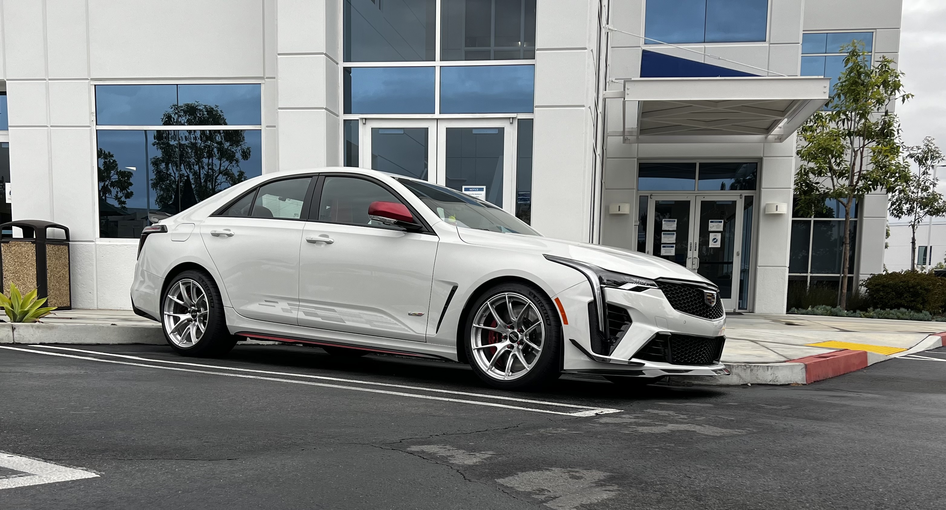

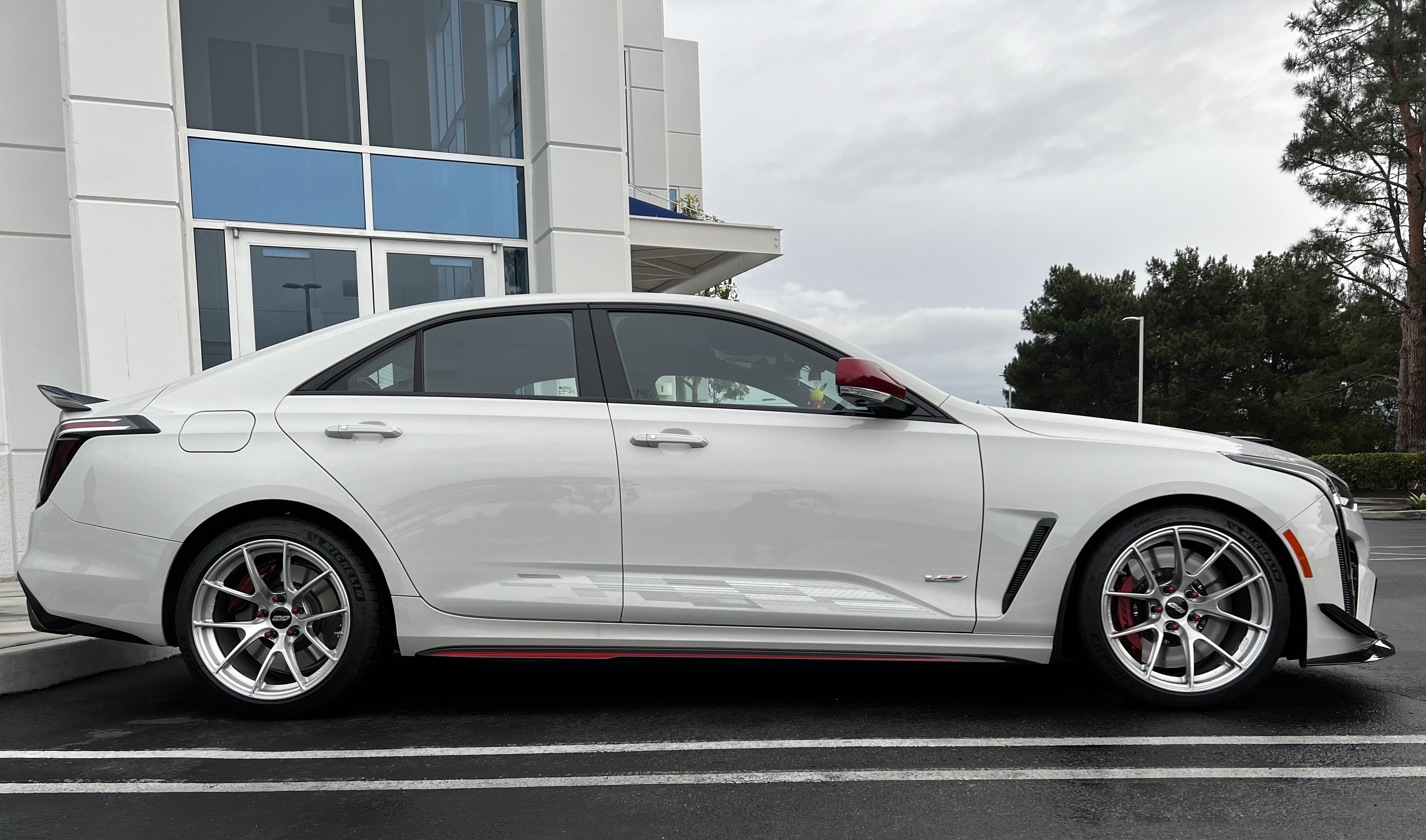

Is the white car here Cadillac CT5-V Blackwing Wheel & Tire Fitment Guide on factory suspension? It looks very low. And are these 19s or 20s?
Those are 19", and I'm 99% sure the car is lowered but do not recall what the owner said for springs.
Looks amazing! Is this 19x10" ET20 front and 19x11" ET44 rear with factory tires? Mind if I add them to the website?
