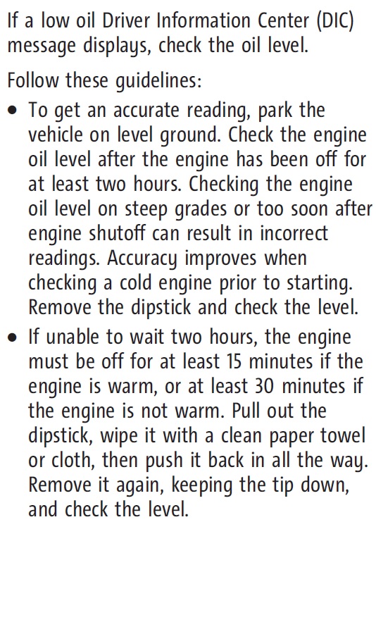

You need to start your own baseline buy finding a level spot to park and only check after the car has sat overnight. As @1Evil55 said, step one is make sure you starting with the correct amount when cold.

I would take the lead on this diagnosis by ensuring you have the correct oil amount to start with.

So, if your car is level and has not started or run for a few hours, then pull the dipstick out, wipe it off, put it back in then pull out and check the level. If it’s not showing any oil on it, then add perhaps a quart, then check the level again, till you see the level show on the dipstick. If it’s checked right after it’s shut down, then it might show a low level or not at all because the oil from the heads and coolers and other parts of the engine have not flowed back down into the oil pan, where the dipstick resides.
