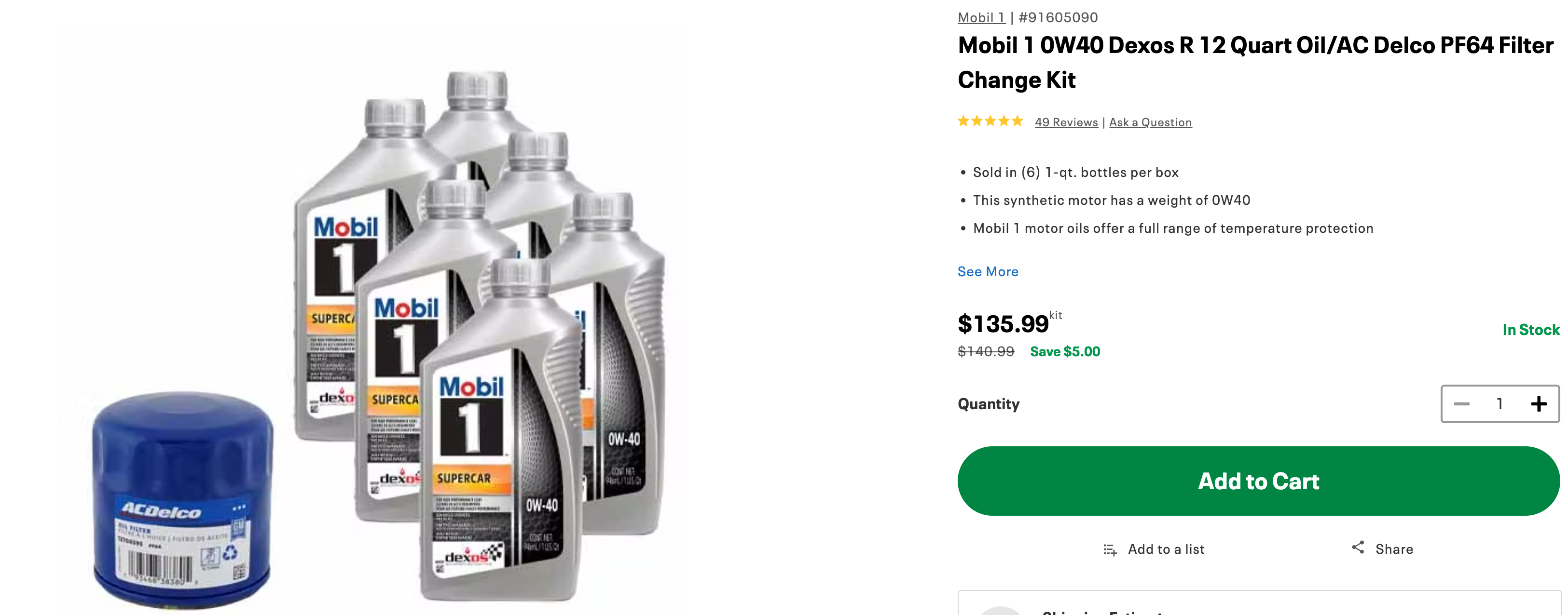

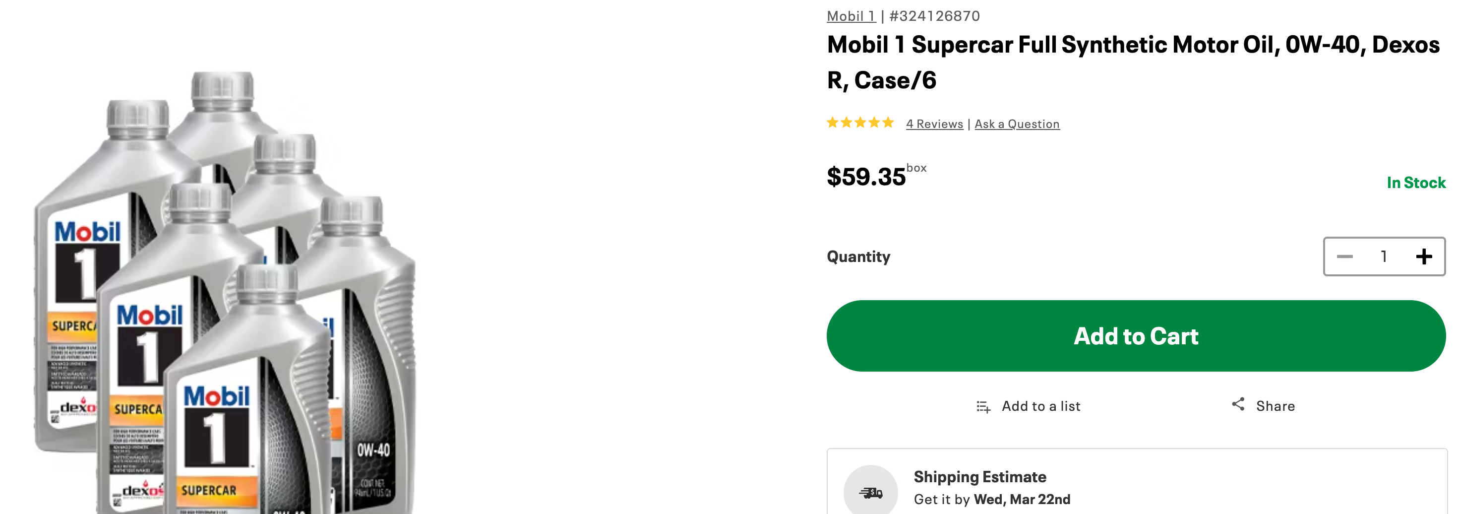

Speedwaymotors was my go to when I had my ZL1. They have kits as well (2) Cases, (12) qts plus a PF64 filter for $136. You keep the extra 2 qts and on your 3rd oil change you only need to buy 1 case. :)
Fantastic! Thank you sir!

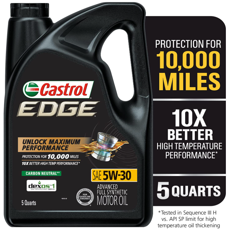

I've had a really hard time finding the Mobil 1 5w-30 Dexos 1 Gen 3 on Walmart or Amazon. They are loaded up with the high mileage stuff, and the normal version photos don't show the Dexos spec. I did find Castrol and Valvoline in 5-quart jugs with the Dexos 1 Gen 3 spec at under $30 on Amazon. I think I'll likely just get Castrol. I always got that brand for my GLI and Audi.

They always seem to have it in stock at my local Walmart stores. They also carry that high mileage version. I guess that could work as well but it costs more. Ideally, you just grab the least expensive Dexos 1 and call it a day.

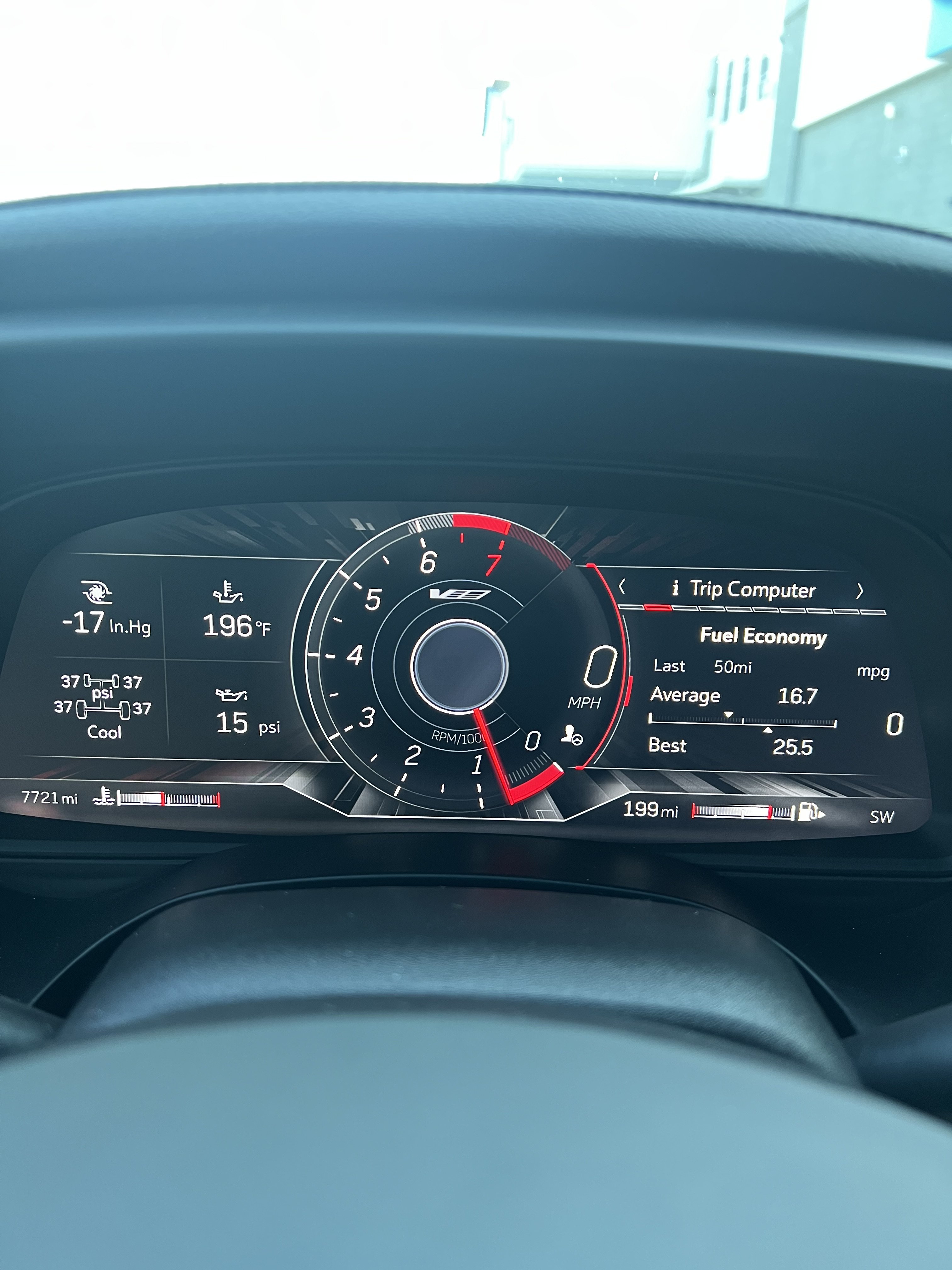

Has anyone seen oil pressures all the way down to 15 PSI on the CT4?
Has anyone seen oil pressures all the way down to 15 PSI on the CT4?View attachment 18972
I see 17-18psi at hot idle. What is the oil monitor life at, percentage-wise? Also, are you running the stock 5W30 oil?
By the way, anyone else notice that the tires stay listed as "cool" temp much longer after the latest software update? My tires used to say normal but now even after the pressures rise 3 psi and they still show cool just like in your pic.
The oil life is at around 40%. This is the lowest I've seen it. Normally it idles at around 18-19psi when hot. I have had the oil replaced once with the same oil it came with from the factory.
Were you doing any spirited driving where the oil temps were higher before you took this pic? Was it a hotter day than normal where you were driving? I am in Florida with 88 degree temps. Once warmed up oil pressure is about 18-19psi like you mentioned but lately I see it dip to 17psi-18psi at hot idle. I am at about 40% oil life remaining as well. 2500 miles on the car. I will be curious to see if it go back to 19-20psi at hot idle once you change the oil and filter again.
Were you doing any spirited driving where the oil temps were higher before you took this pic? Was is a hotter day than normal where you were driving? I am in Florida with 88 degree temps. Once warmed up oil pressure is about 18-19psi like you mentioned but lately I see it dip to 17psi-18psi at hot idle. I am at about 40% oil life remaining as well. 2500 miles on the car. I will be curious to see if it go back to 19-20psi at hot idle once you change the oil and filter again.
I was not doing any sustained spirited driving prior to noticing the pressure. It was a bit hotter yesterday than it has been at around 90 degrees here in Fort Worth.
FWIW, I did an oil change today and noticed a slight increase in the idle oil pressure. At 196 degree temps I would bounce between 17 - 18 psi, mostly 18 with some dips to 17 here and there. Now I am getting 19-20psi at the same oil temp with the fresh oil. However, I did change the filter from a PF63 to a UPF63R as recommended by some of the folks here.
Ambient temp here is 90 degrees. I went and drove in a spirited fashion and got the oil temp up to 210 and I was still seeing 19 psi with some dips to 18 psi so the fresh oil does appear to play a role but only 1-2psi in my testing so far. Also not sure if the filter change makes any difference.
I would do an oil change and see if you notice a difference. Also, check to see if you are a little low on oil. From what I read, it is a good idea to change the oil a little more frequently in the LF4.
Some oil pressure specs I ran across in service information. I'm assuming these are likely minimum values fully warmed up as the first listing (for the 2.0L not shown here) said 100 ° C.
3.6L: @ Idle - 69 kPa (10 psi)
3.6L: @ 2, 000 RPM - 138 kPa (20 psi)
3.6L: Piston Cooling Jet Valve OpeningPressure - 2.2-3.0 bar (32.3-44 psi)
