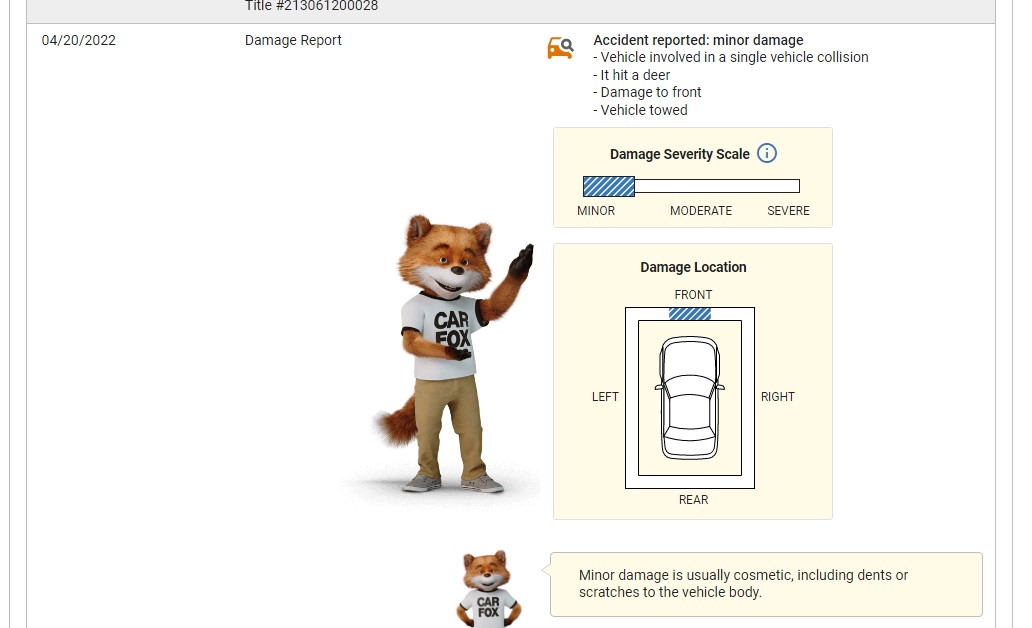

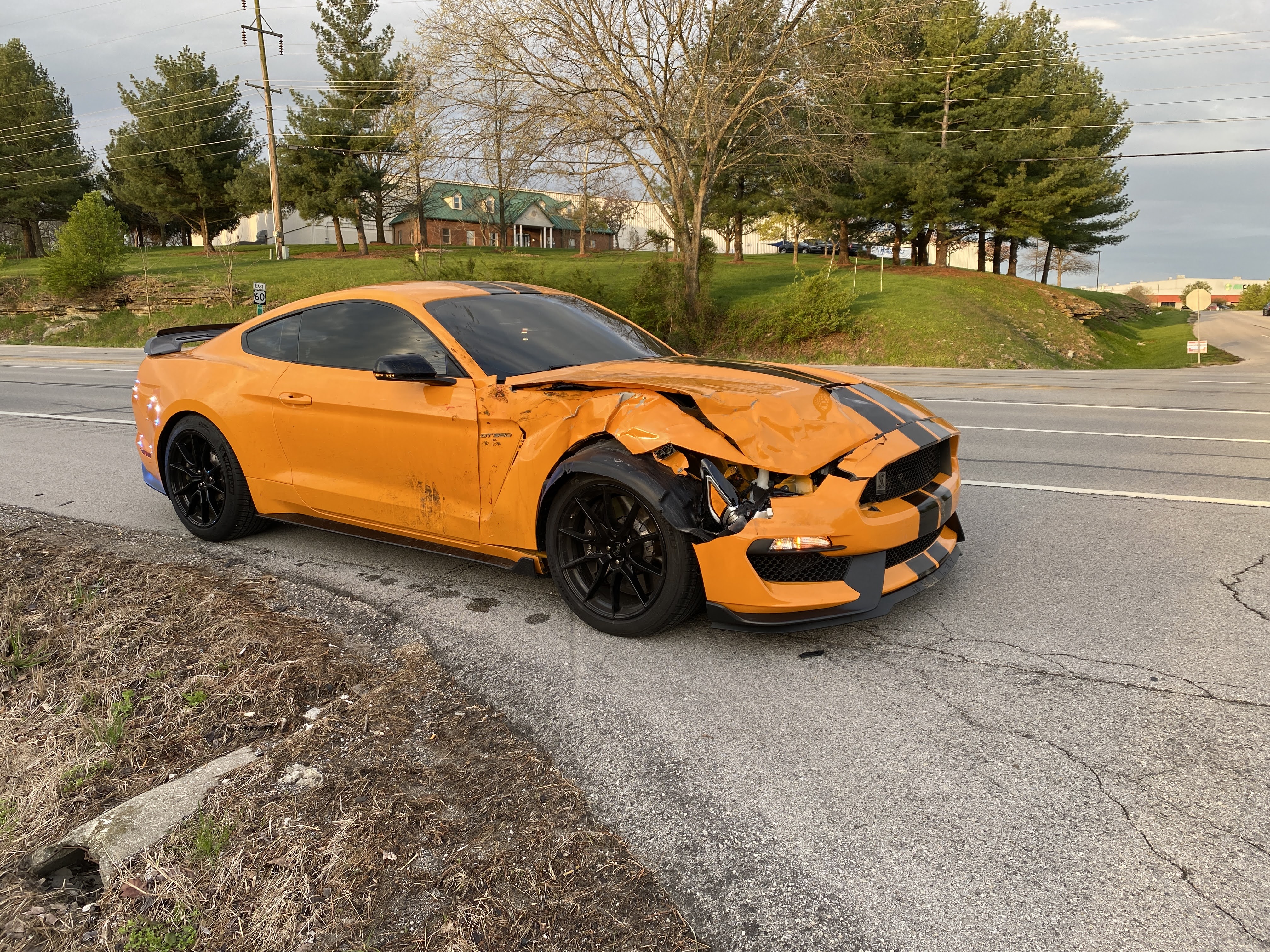

I hit a deer on 4/20, did 28k worth of damage and Carfax shows a minor accident......
IMO it wont catch the engine being replaced.
FYI, the deer didn't make it......

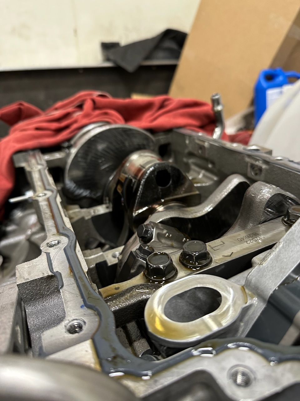

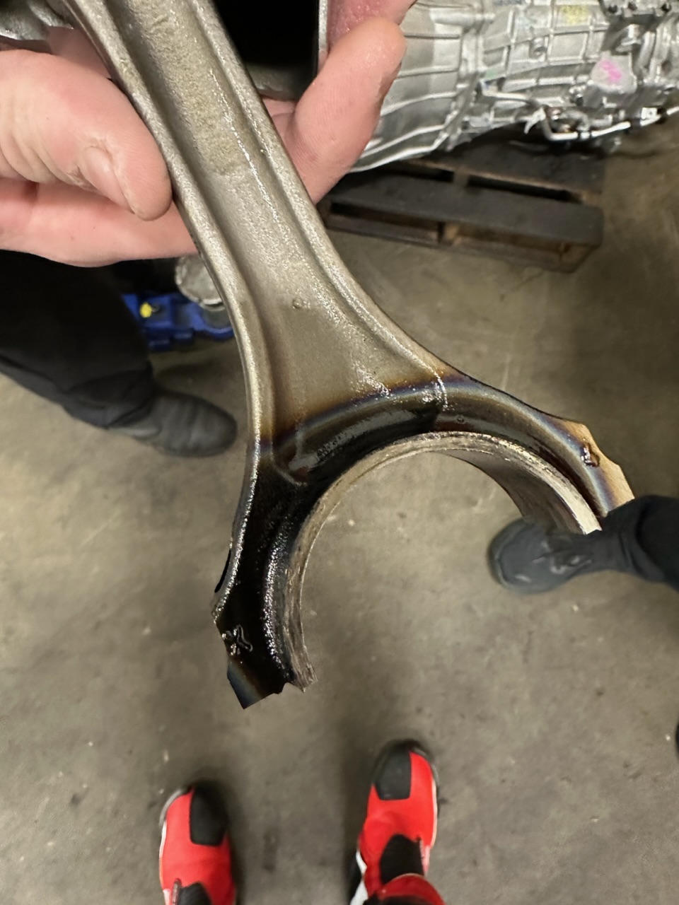

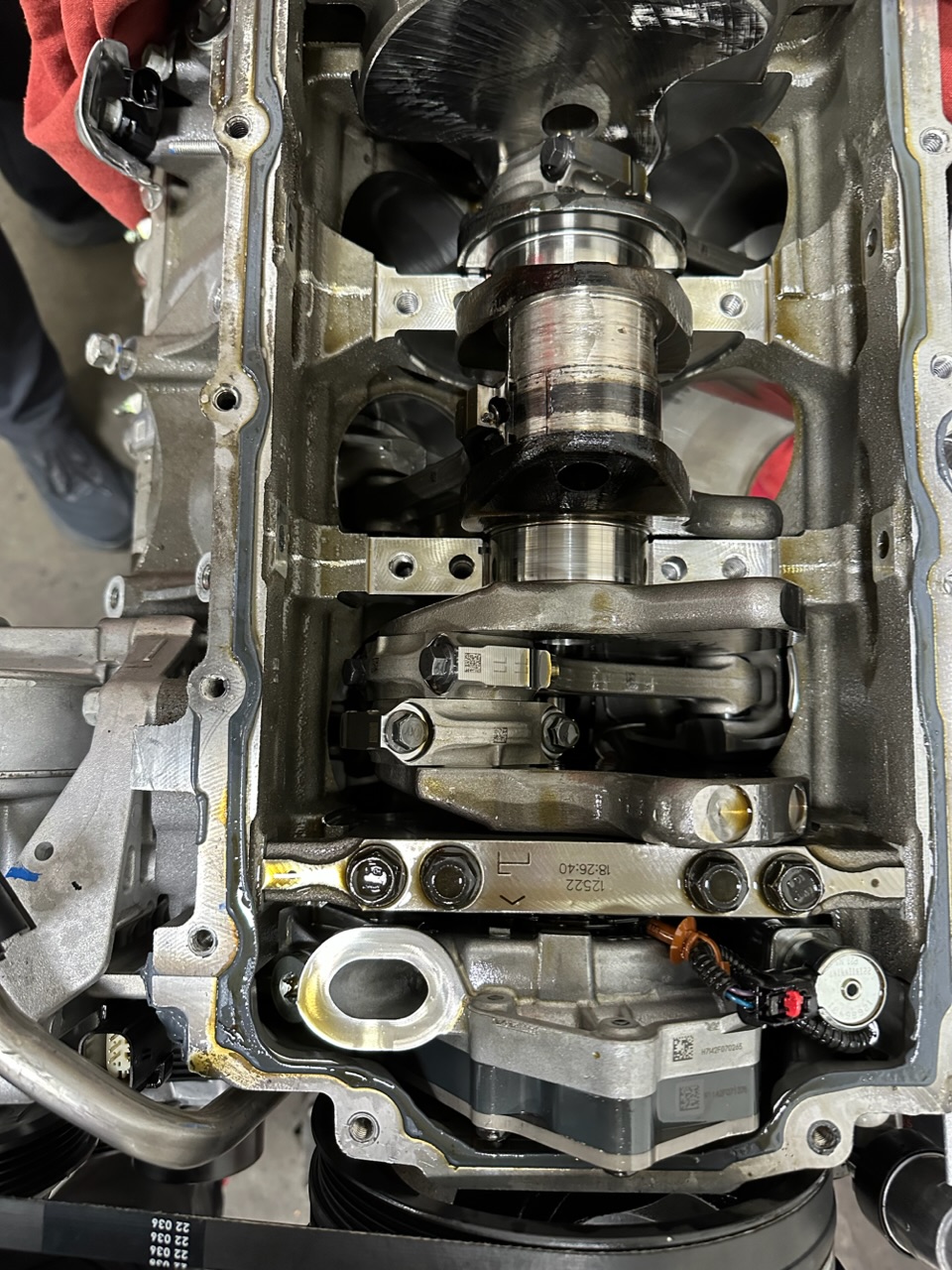

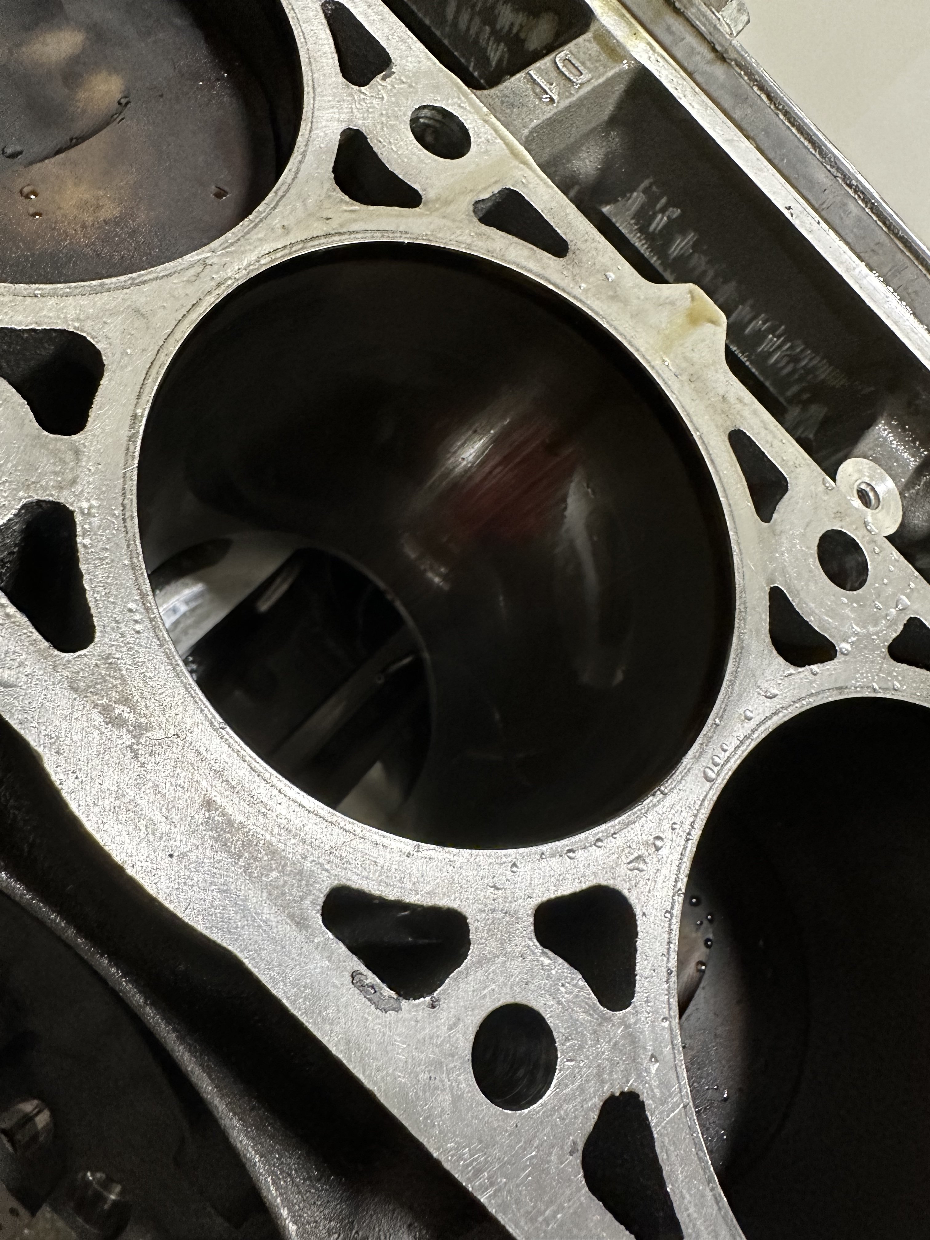

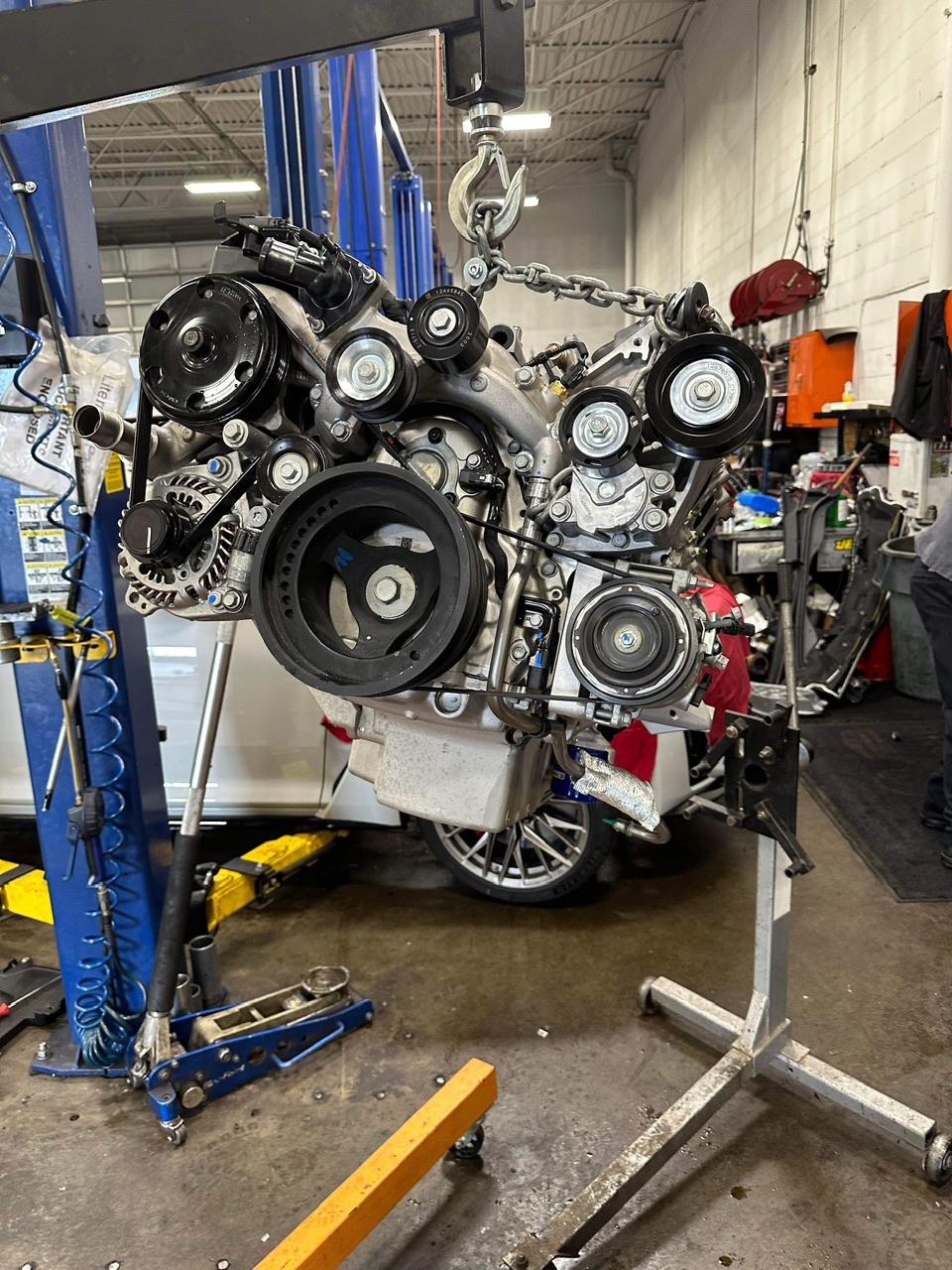

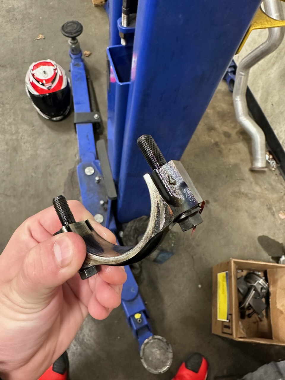

Well boys here’s the damage. To be honest it’s impressive that the engine held up for 288 miles and this much heat with basically no oil going to those bearings.
New motor has been ordered

Just for educational purposes: Do they know what specifically was done wrong? Con rod bolts torqued too tight?

Now, we see the obvious result of what was going on, but unless we know the exact building process, we don't really know how it happened. I've seen lots of videos of engine building where they use automated torqueing devices and where a computer selects individually spec'd parts to be used in a specific place. That, in itself could open up another can of worms, but realistically, without input from the builder I don't think we have a good answer.

Disregard the service manager on that one. The tech discovered that the crankshaft had a defect/nick in the oil supply channel and that’s why there was no lubrication to those bearings. Not the builders fault more than likely but definitely cause for concern with other Blackwing LT4 motors assembled on the same day.
That very thing was on my mind since both rods on that journal were affected. I guess we now know the service life of the assembly lube. ;)
Poor Crystal...thrown under the bus because of a bad crank. :(
Maybe now they will be double checking for oil gallery obstruction? I can't say I have ever looked for that myself when building an engine.
