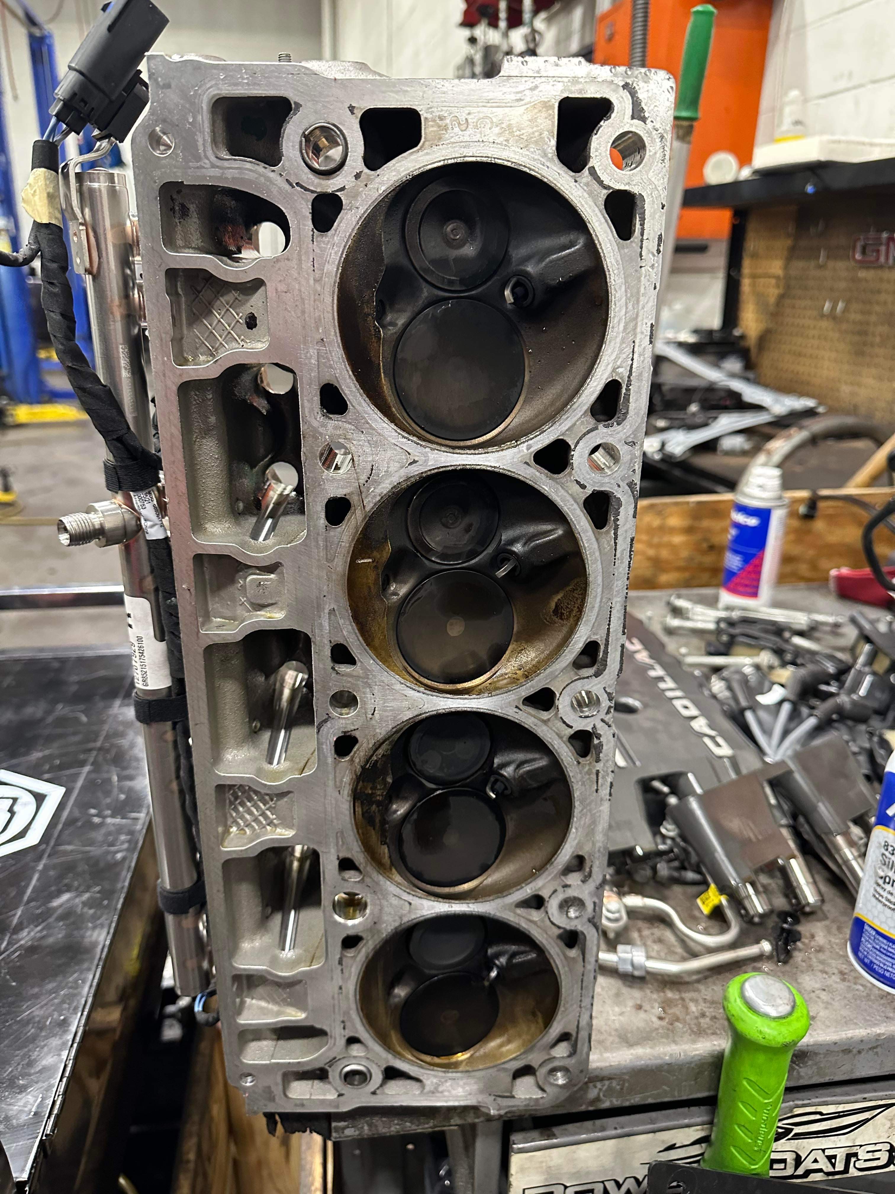

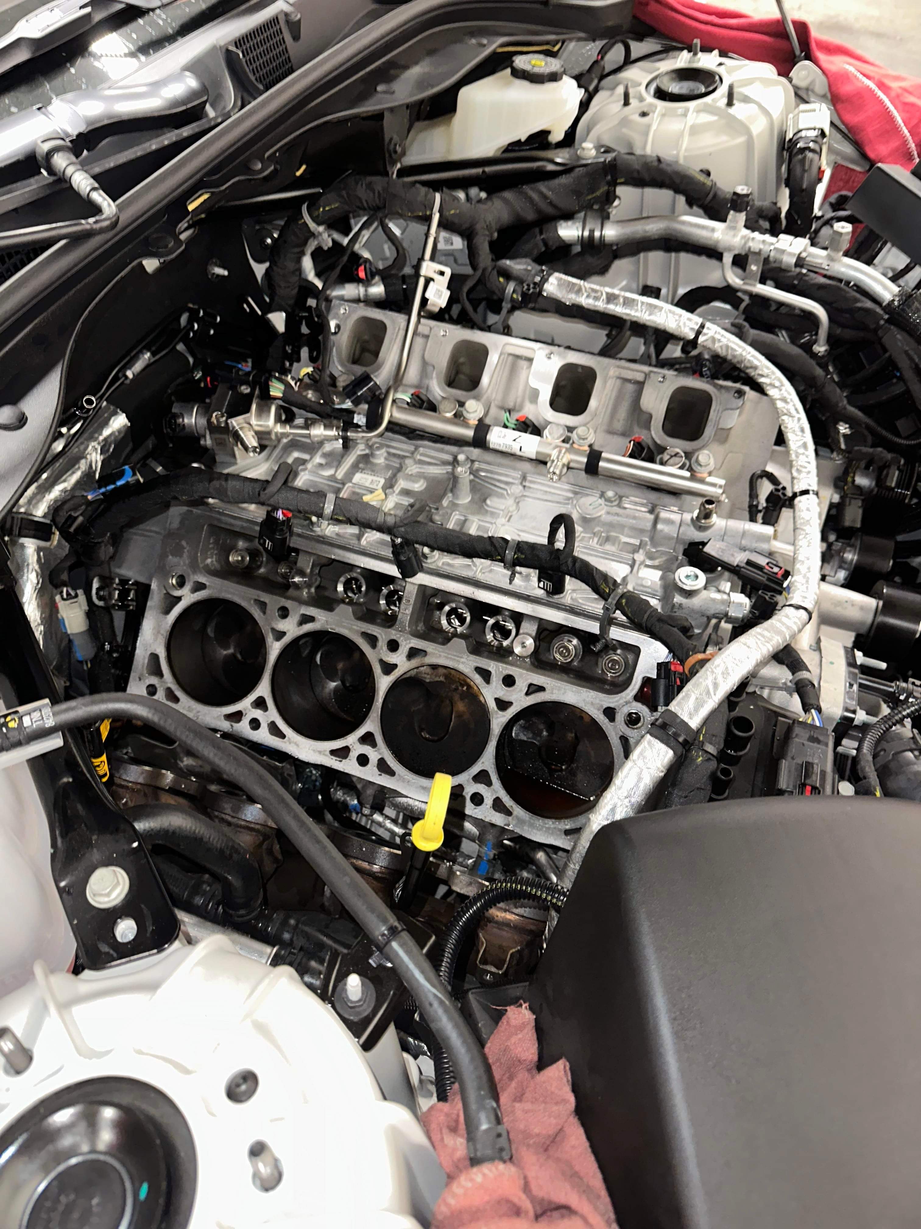

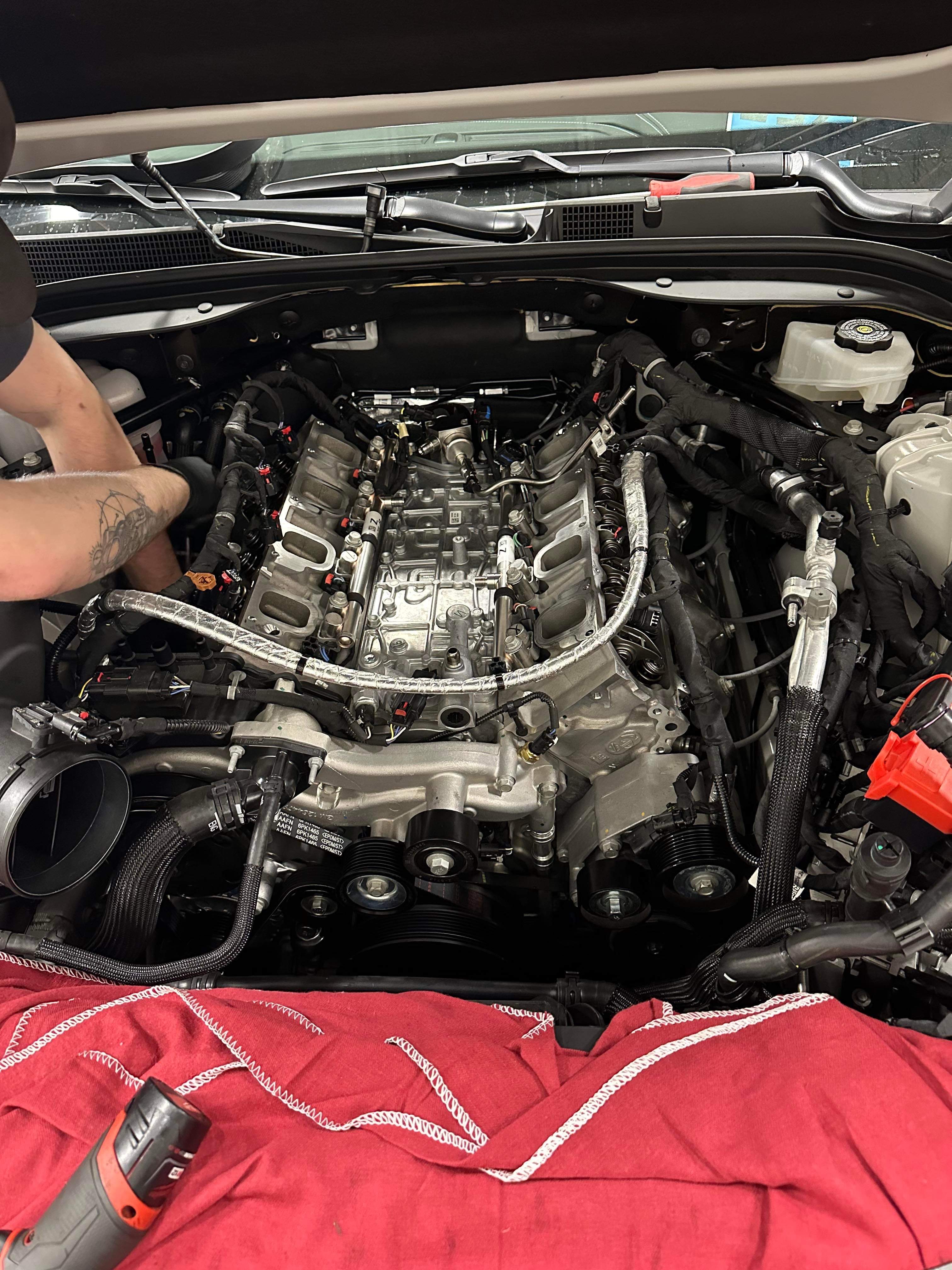

Well boys. Getting the call from the dealership tomorrow morning. Heads are off and.... well it's probably rod bearings lol. Just my luck but she's gonna need a new long block.

if you ever wanted to know what a less than 300 mile engine looks like torn down here it is.

Results are in. Cylinder 4 rod bearing spun. It was more than likely not torqued properly since there’s 30 thousandths of play in it. The noise is the piston moving up and down and the rod smacking into things. Soooooo it’s gonna need a new motor, and I hope it doesn’t arrive with Crystal’s name on it this time
