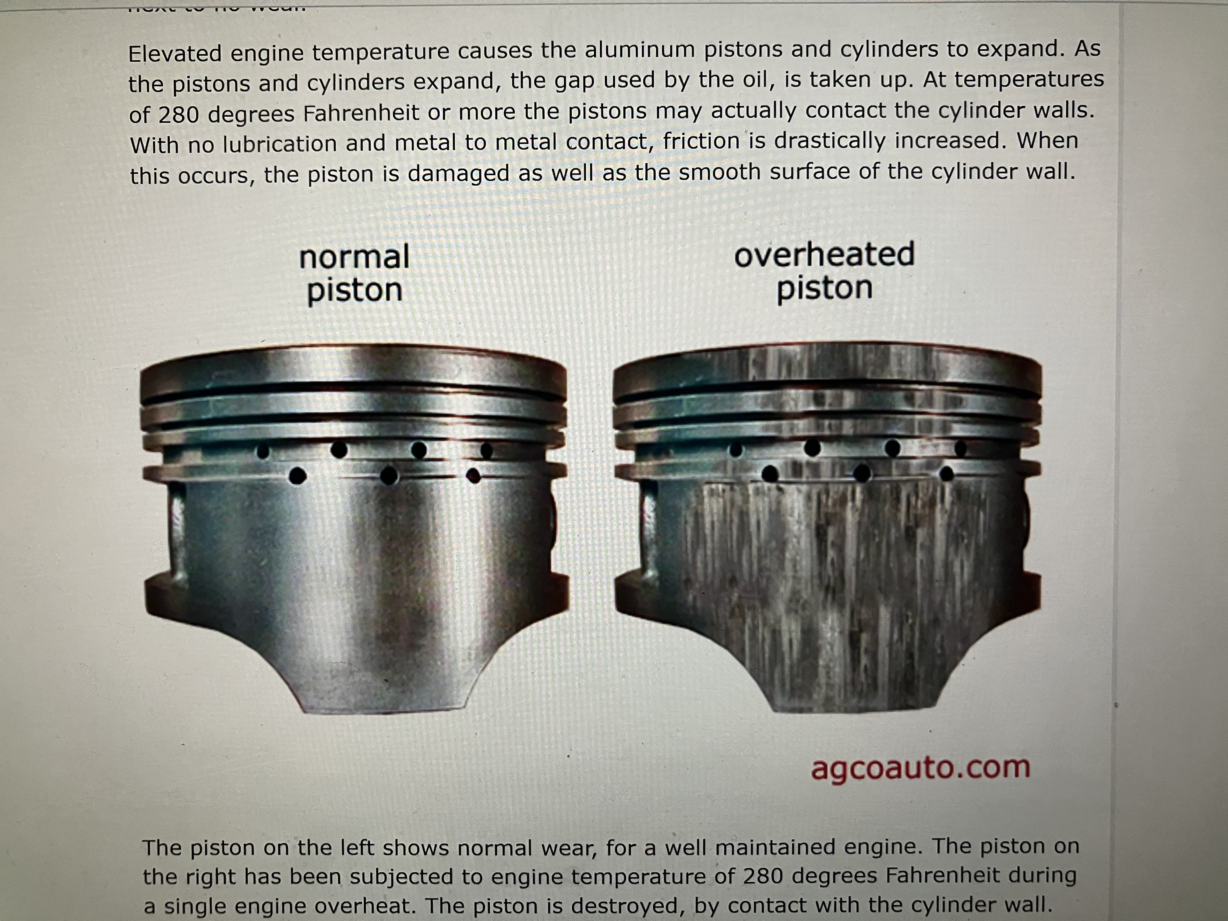

Got the car back today. Dealer wasn’t even going to do an oil change even though the instrument cluster stated it needed one due to the oil overheating. Got them to do that as well as finish installing the parking sensor module. They put it in last time, but neglected to do the programming to make it active until I pointed out it still wasn’t working. Got 2 different part numbers for oil on this invoice, both of them reference the euro car formula 0w-40. They claim the correct oil was put in, but I’ve lost a lot of confidence in this whole ordeal. For some reason 7 quarts of one part number & 2 of another (even though I believe the car calls for 9.5). I asked they at the very least do a compression test to try and check for damage as best one can without actually opening stuff up. Instead they just threw on another belt & pressure tested the cooling system. I have got to believe after being 280+ degrees & having coolant boil for an extended time period that at least some bearings got hurt if not cylinder walls. I’ll guess we’ll see how it performs as is next track day & if it’s lost any power. I’m concerned about the long term when it comes to the motor that is in it now given no real inspection on its condition has been done. Found this nice example of what happened to a piston at 280+ & wonder what mine actually look like right now.

Having a dealer check anything outside of a warranty claim is a near impossible feat. You will spend more back & forth with them. Drive the car as you normally do. If what your saying is true about piston ware being the case with you car it wont be long till failure. Plus tbh if that did occur I'm pretty sure you would feel it at idle or light load.

if the pistons were broken, yes. if the pistons are scored and have damaged the walls, no. it would just increase oil consumption, possibly reduce compression/boost, and certainly lower how long the motor is strong for. same thing with the bearings. wear/damage could have & likely did happen to them, but unless it was super extreme damage it wouldn't show up now or anytime soon. instead it would have just significantly reduced the life expectancy.
