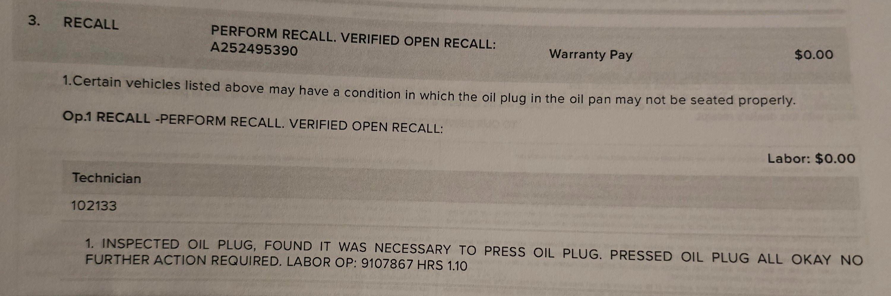

I went in for an oil change after ticking over 500 miles and had this checked. It needed to be fixed.
Unfortunately, the dealer also managed to scratch up my fender and hood while they were at it, so that's fun.

Glad the plug didn’t uncork on you beforehand! Did you get the dealership to acknowledge fault for the scratches at least? I’d be pretty unhappy if that happened. I saw a video posted of a guys PDR recording the tech at the dealership scraping the shit out of his CF splitter. I immediately ordered a dash/rear cam so I can record when I take it in for service anywhere. It beats walking around the car taking pictures.

That sucks man, sorry to hear that for you. Careless techs and dealerships really should be held accountable. I hope they make you whole on that! I guess the silver lining is your girl didn’t puke all her oil on the side of the road and leave you stranded at least.
