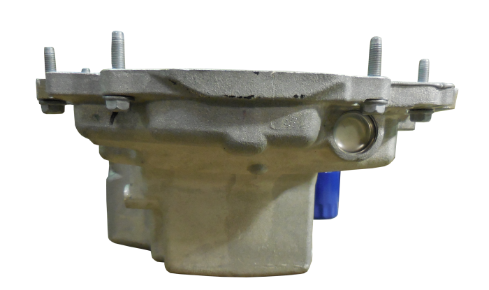

Hopefully someone can post details on the specific plug in question, where it is, and what to check. When I first read this thread I was thinking it was the drain plug, but I gather now it's some sort of oil galley plug or similar.
From this thread, here's what I think it looks like:

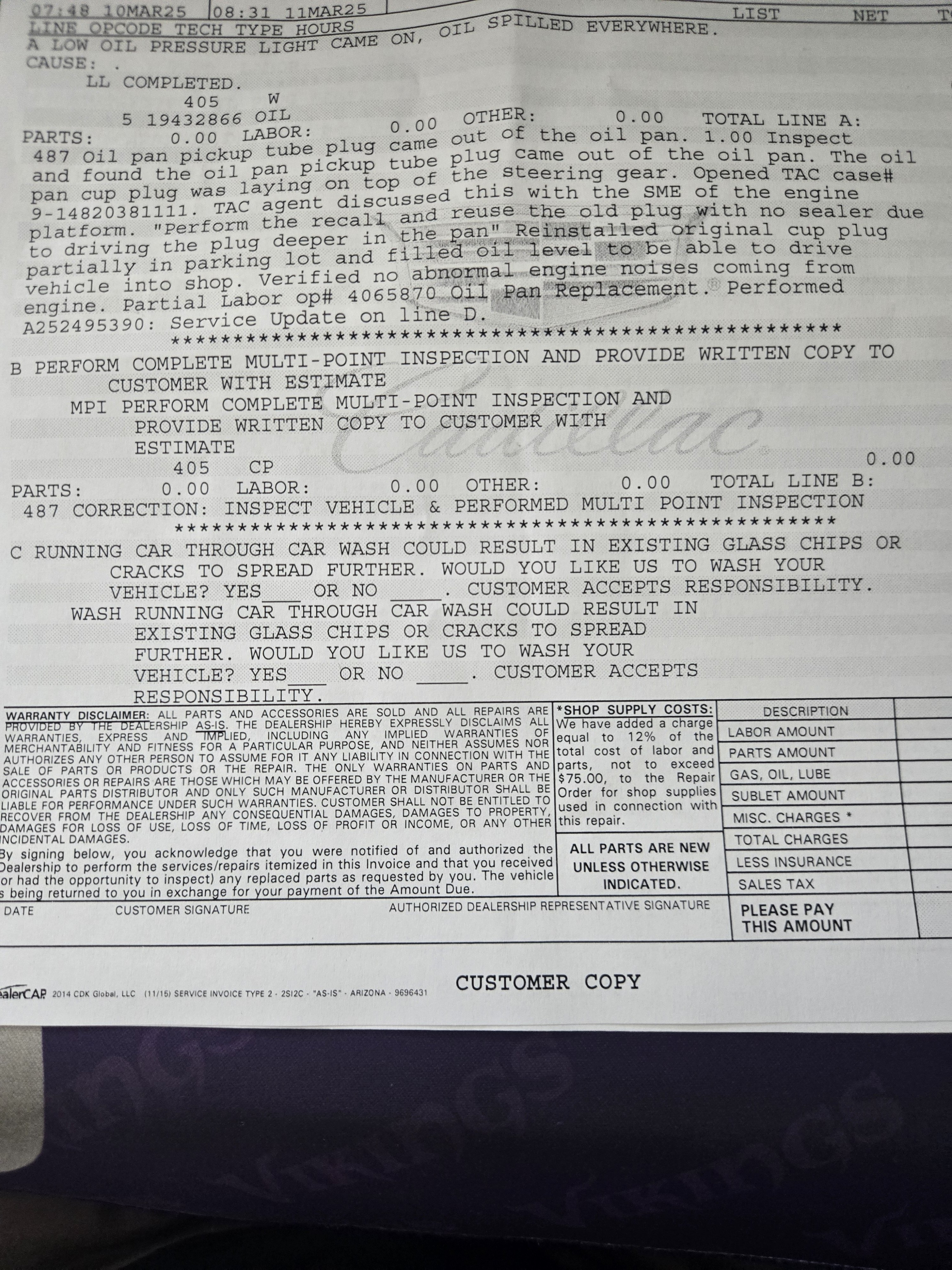

Just got my car back. This was the writeup on the invoice.

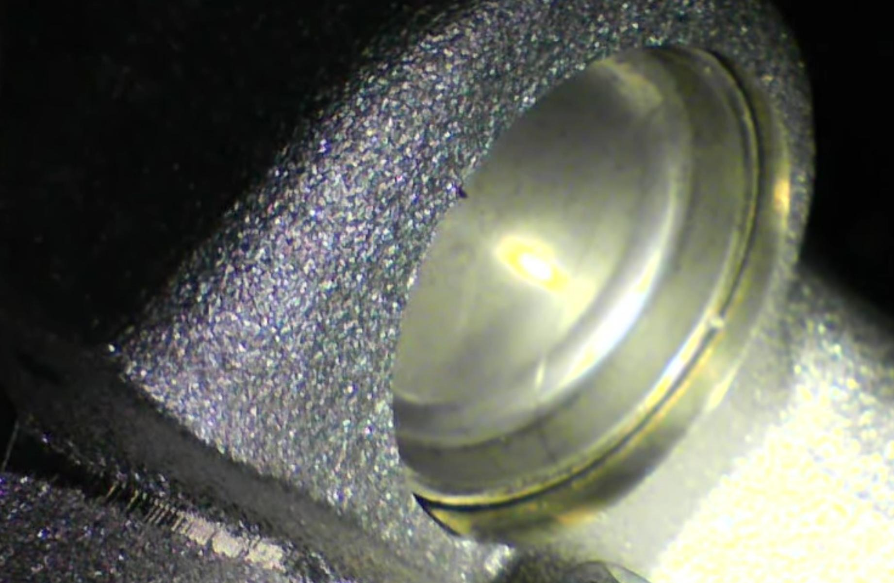

Took a look at my plug - seems ok?
EDIT from the future - this is NOT ok and had to be pushed in further as per the TSB seen later on in this thread.

For those of us lucky to have a 2025 CT5 Blackwing - there is a service bulletin posted today for ALL 2025 CT5 Blackwings to have the oil pan checked for a possible manufacturing defect. This document was shared with me this morning and my car has had the 'fix' completed. Still working with Cadillac service escalation team to hash out compensation, etc.

So ultimately what exactly is the issue? Is it simply the oil pan cup plug not being pressed in adequately? Is that the same part as the "487 Oil pan pickup tube plug"? So with this failure the entire oil pan needs to be replaced?

From what I understand, they just press the plug back in.

In my case the servicing dealer had my car for over 29 days 'awaiting parts' for a new oil pan after they first tried to present me with an almost $7k bill for something that was very clearly a manufacturing defect. The Service Manager tried to say that because I used a non GM branded oil filter at my 500 mile oil change I caused the front of engine plug to come lose at 607 miles on the odo (I may have been the first 2025 to have the issue on Feb 3rd?). I escalated the case to Cadillac customer care and they are working through approvals to provide me at least $750 for the service mis steps (I may still seek out legal representation as that amount is borderline insulting for a 130k car purchase that failed in a very dangerous way). They are also looking into a powertrain warranty extension. I am supposed to hear back in the next day or two.

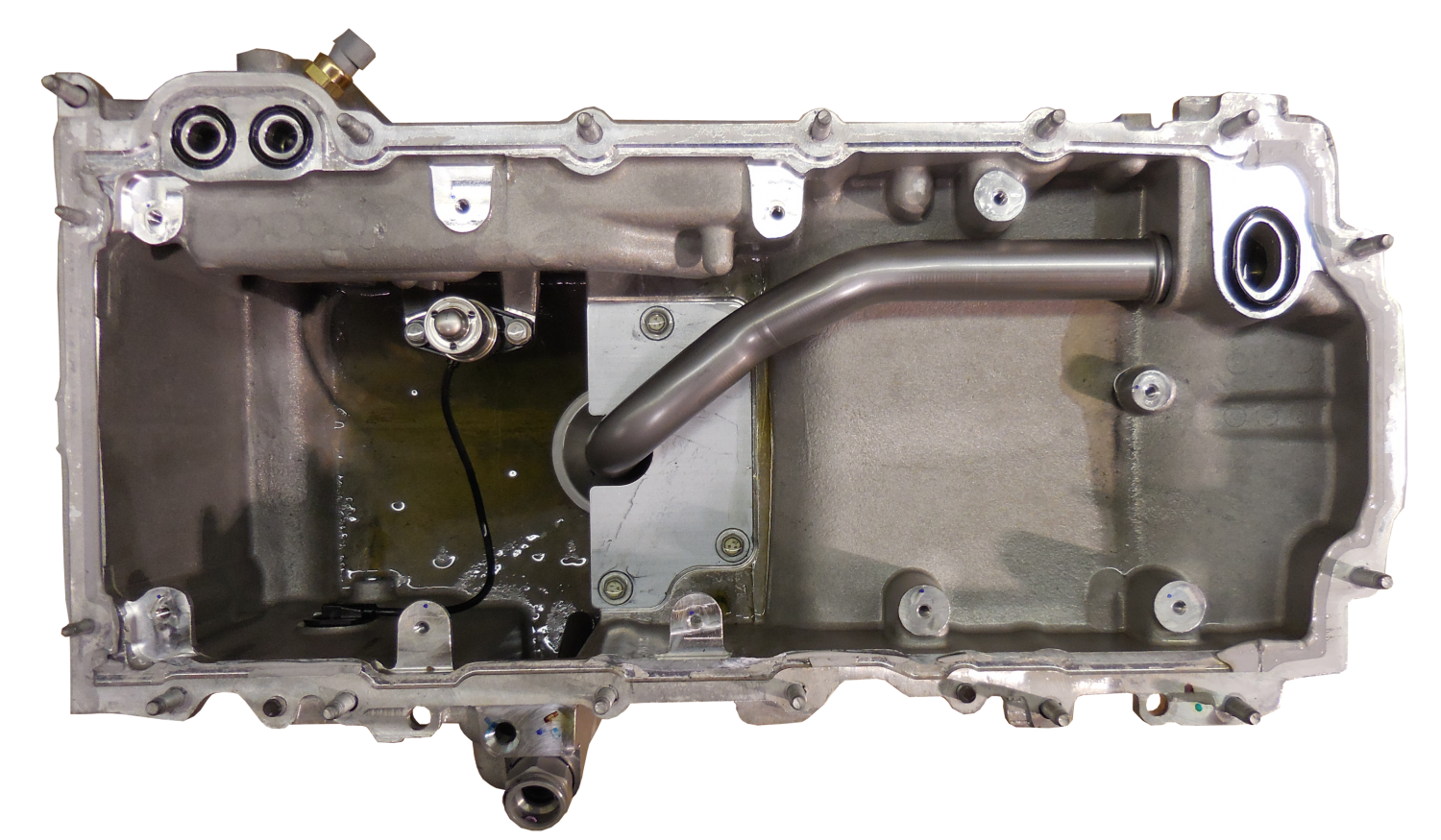

Anybody know why the plug is even part of the design? If the pan has an actual drain plug threaded in, what is the purpose of this gap?
Perhaps this is a multi-vehicle use pan and the port has some real purpose in another application.
After looking at the top view of the oil pan, I think the hole is machined as part of the oil pump pickup circuit.
My thought as well. Looks like it’s for tool access for a machining operation. But, it does leave a vulnerability. There are many other ways to plug that, looks like they went with the cheapest way possible. At a minimum they should have a retainer clip so that at worst it leaks but doesn’t blow the plug.
