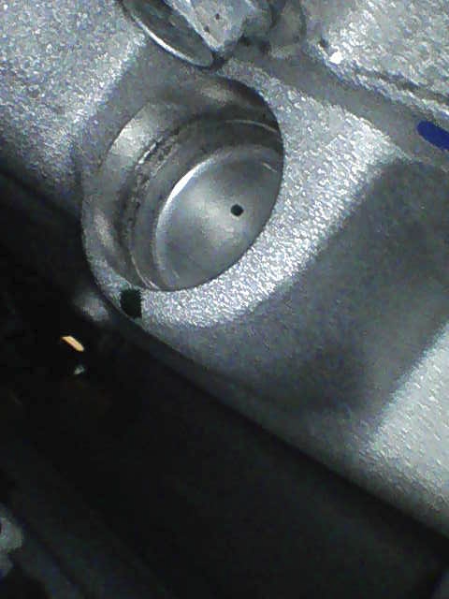

I used an endoscope to look at mine which looks fine. My car was built on May 21st, 2025.
Very interested in how you did this. I was about to ask how hard it is to remove the shear plate mentioned in the tsb. I'm assuming you didn't have to remove anything to get the endoscope in position?
Anyone know how hard it is to remove the shear plate?
If you want to take a look, you don't even need an endoscope. I was able to see it from up top with the hood open kneeling/crouching down right by the driver side headlight and a flashlight. The plug is around the middle of the motor and slightly towards the driver side. You can see it by looking down in the void right below the air intake on the engine side.

For the endoscope, I put a 90 in it a few inches from the camera end and used a grabber to hold and aim it. I put the camera below the lowest belt and kept searching until I found the plug.
I tried this and you're right! But I don't see how you'd get a decent picture from that far away and my eyesight wouldn't really let me see well enough to know if the plug is in far enough of not.

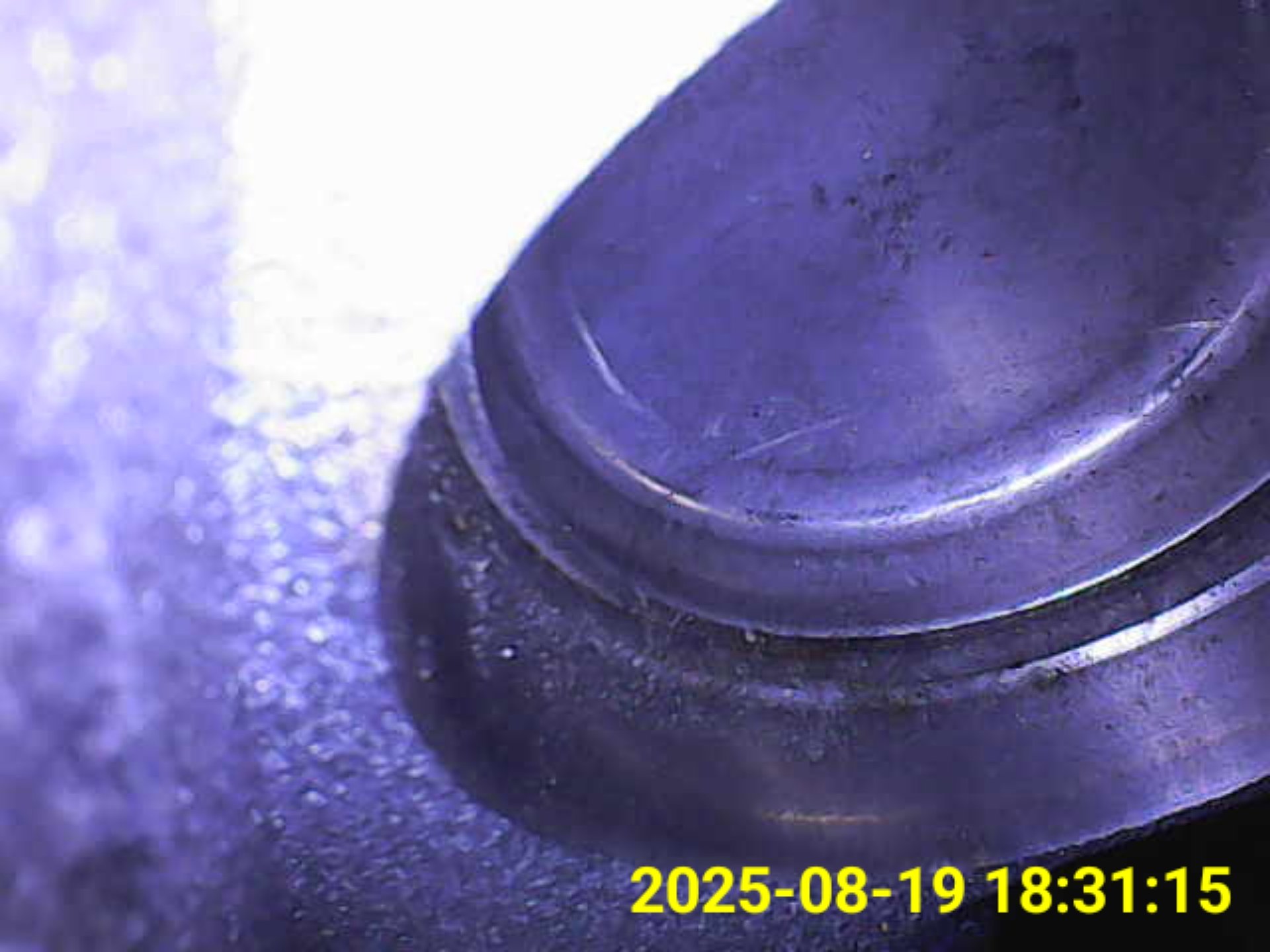

I very much appreciate the advice. I was able to view mine with the hood open and had a good degree of confidence the plug was pushed in enough. I went ahead and bought a borescope that connects to my phone just to be sure. I got the photo attached, which seems to confirm I'm in good shape. I have a 2025...
Yup - you're good
