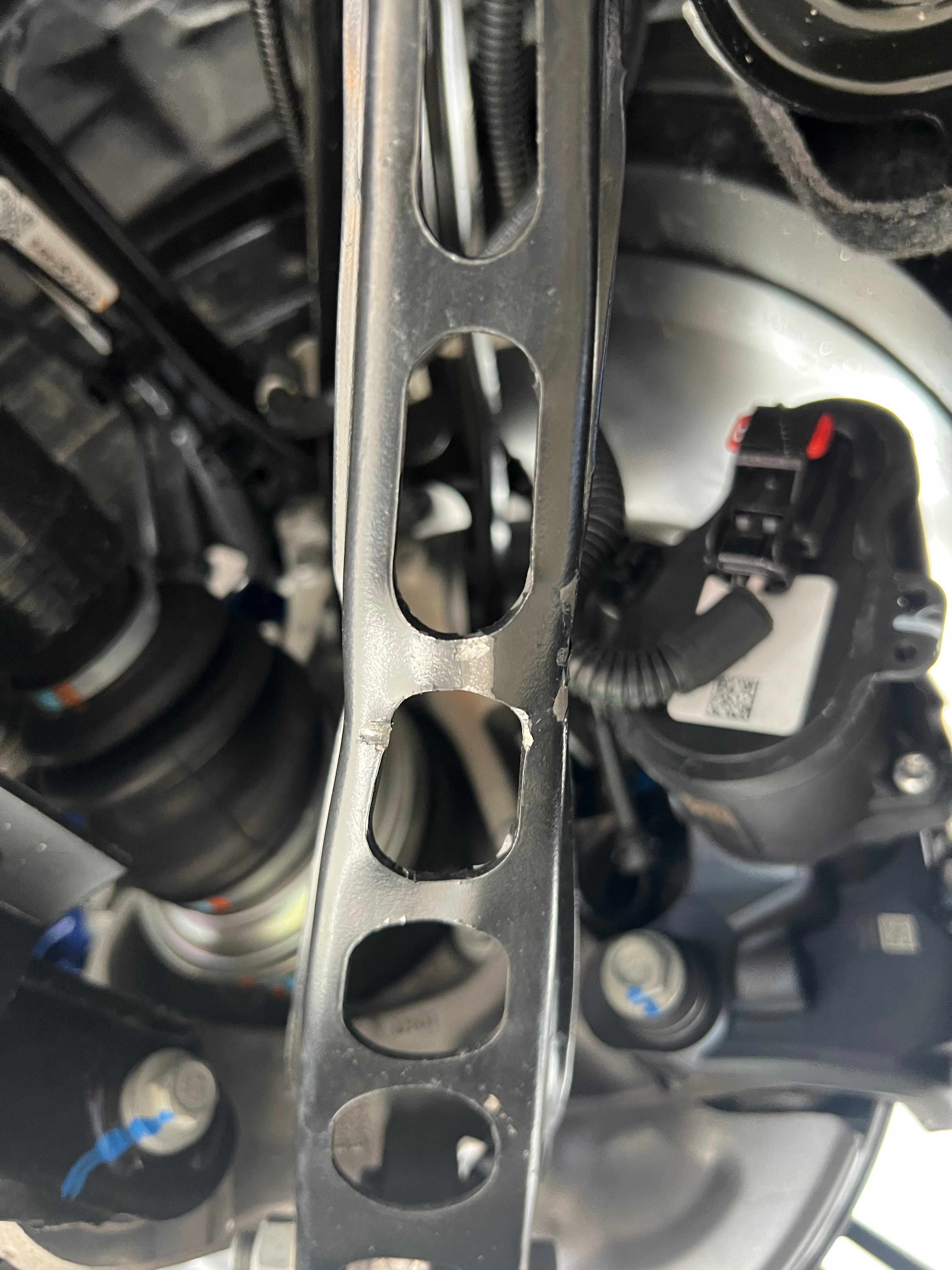

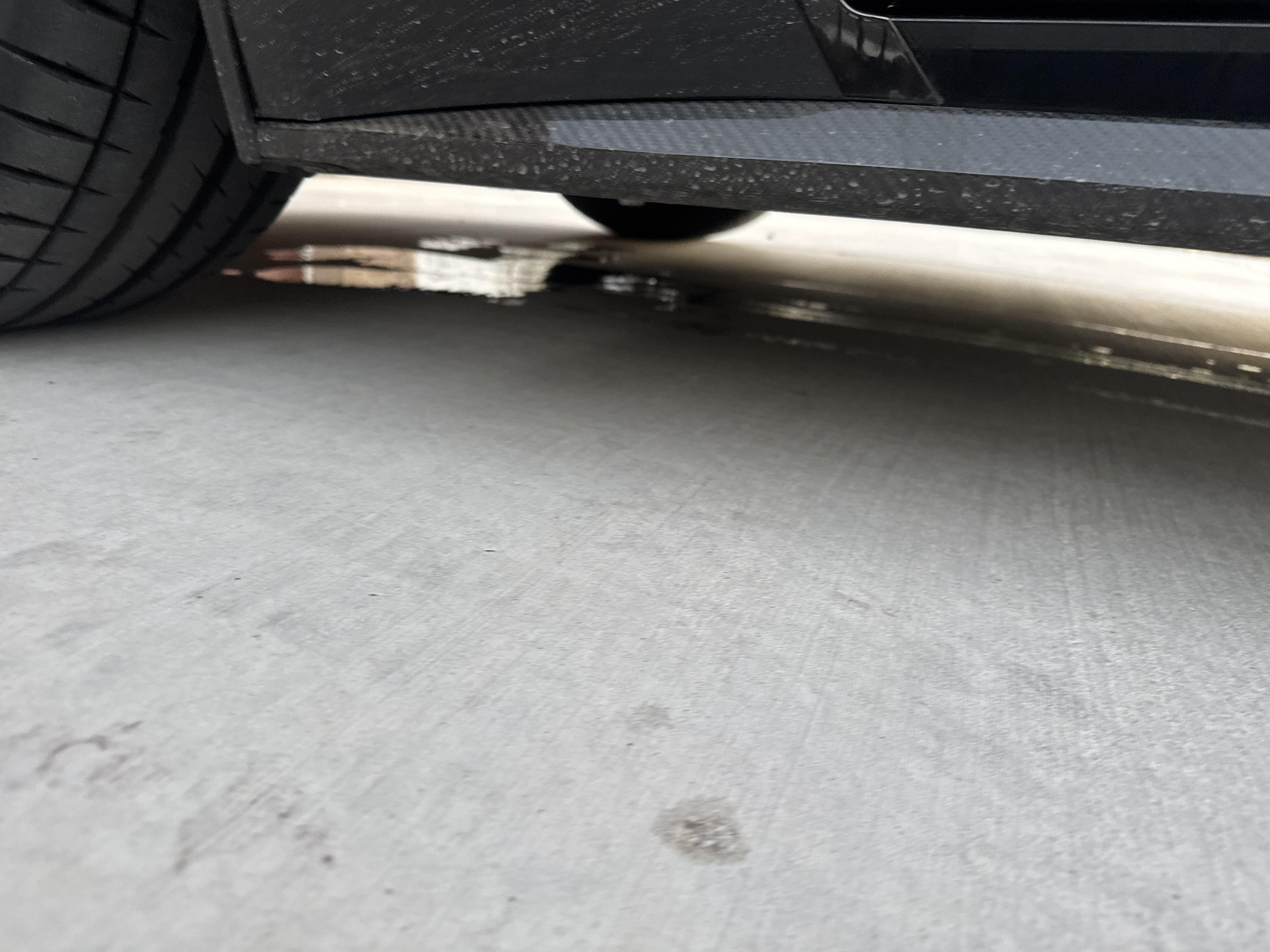

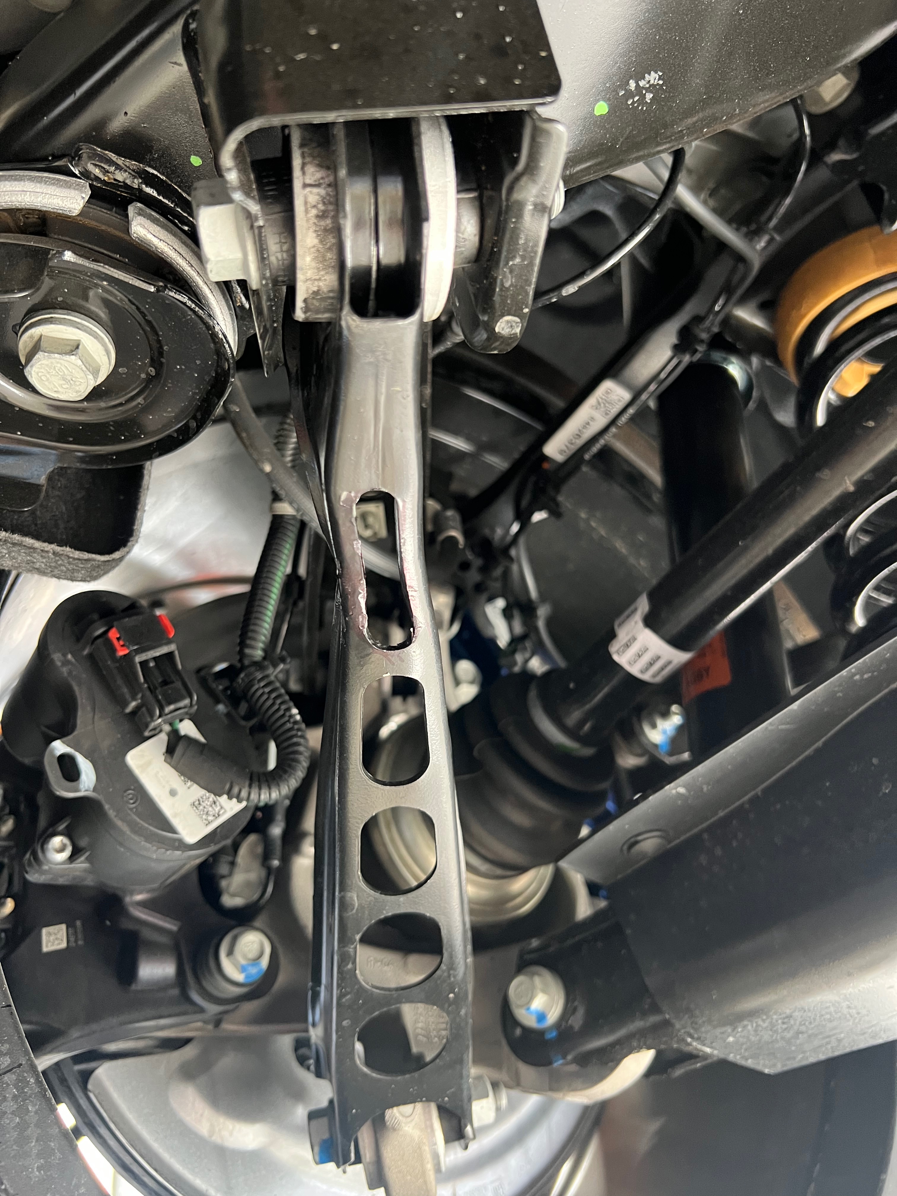

On February 23rd the same thing happened to my blackwing after 9 days of having it. The car dumped all of the oil into my friends driveway (I was pulling in) The Cadillac executive resolution team has been in contact with me, they supposedly put a rush on the oil pan however it has been 3 weeks and I’m getting annoyed. To top it off when the vehicle was towed the tow truck drive hooked onto the rear wheel links DAMAGING it and I now have to open a claim against them and deal with that even though I did the towing through the Cadillac app! They are compensating me, I paid cash for the vehicle and they are going to calculate a car payment based off a 5 year loan.(I just found this out rn)

Tell them to look up TSB A252495390 - the fix is to replace the plug, not the entire pan. That will allow you to get your car back much sooner as the pans are nowhere to be found.

A note that that 'official' GM approved fix is to press the oil cup back into the existing oil pan versus replacing the oil pan itself, if possible. So assuming your dealer found the oil cup in the under engine plastic tray that may speed up the process on the engine repair. Very sorry to hear about the damage the tow company did to the car's suspension pieces. I have about 3k miles on my car including some track laps at Sebring with oil temps up to 260f after the fix and no issues so far. They did use a form of high temp epoxy/JB weld which had to cure overnight to seal the oil cup in place as part of the fix.

Honestly I have no idea what’s going on they haven’t been giving me much information I had to ask multiple times for the pictures of the damage the tow company caused.
