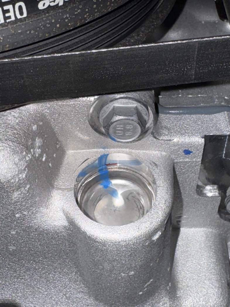

So my soon to be 5BW was built second week of January this year. My plug was actually pressed in all the way from the factory. Here is the picture the technician took upon their inspection.

For those of us lucky to have a 2025 CT5 Blackwing - there is a service bulletin posted today for ALL 2025 CT5 Blackwings to have the oil pan checked for a possible manufacturing defect. This document was shared with me this morning and my car has had the 'fix' completed. Still working with Cadillac service escalation team to hash out compensation, etc.
