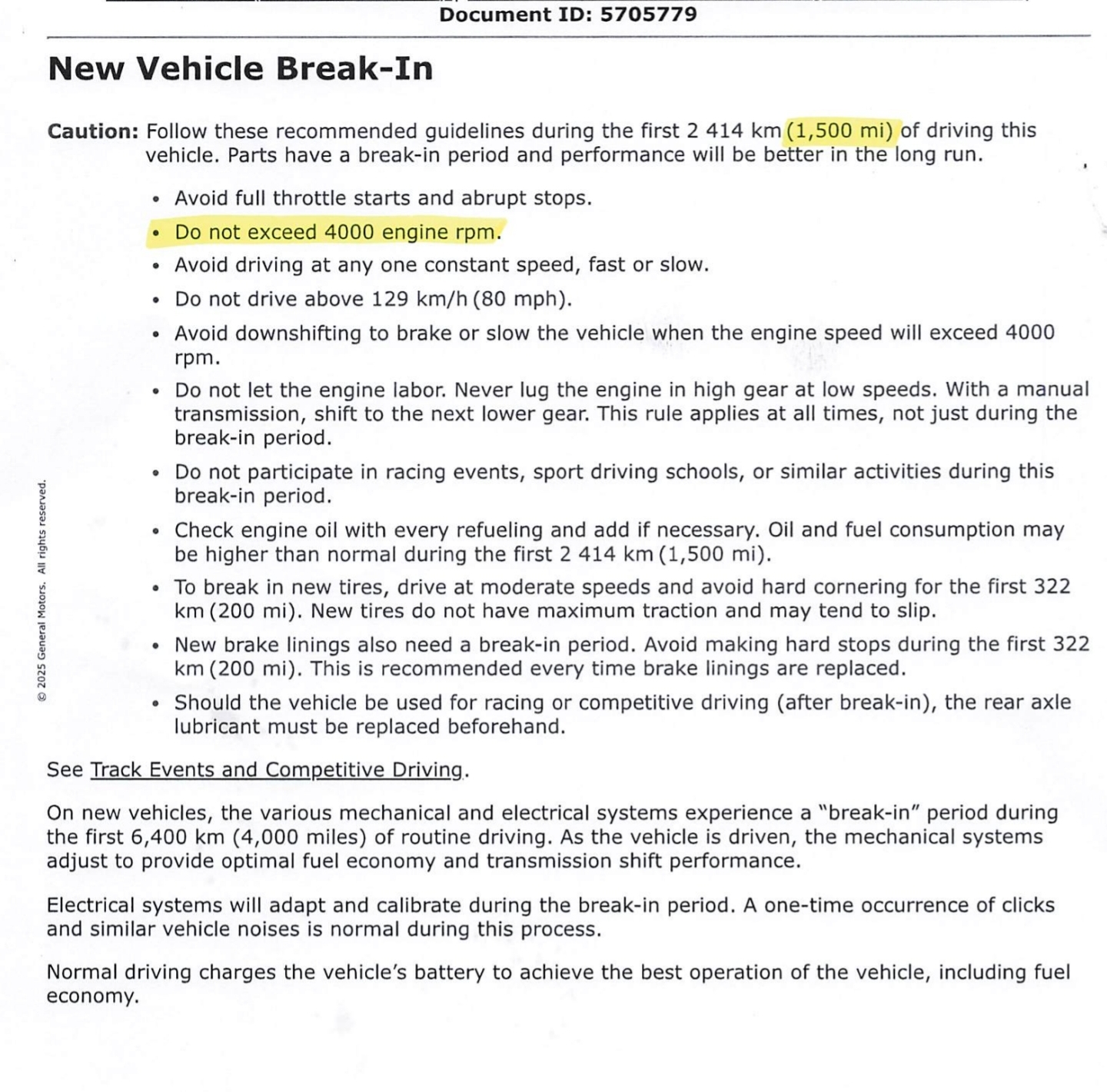

I was just reading up on a civic type r break in. 600 miles and let it soar. Funny how they try to pin it on you for the 1500 miles period. Heard 1500 miles is more for diff than engine.
The exact wording in the owners manual is "recommended" not required fwiw - I looked it up. Someone else on the forum also pointed out previously that at exactly 501 miles on the odometer the engine redline on the dash changes from 4k to normal. Why program it at exactly 501 miles versus 1501 if that is truly a concern?

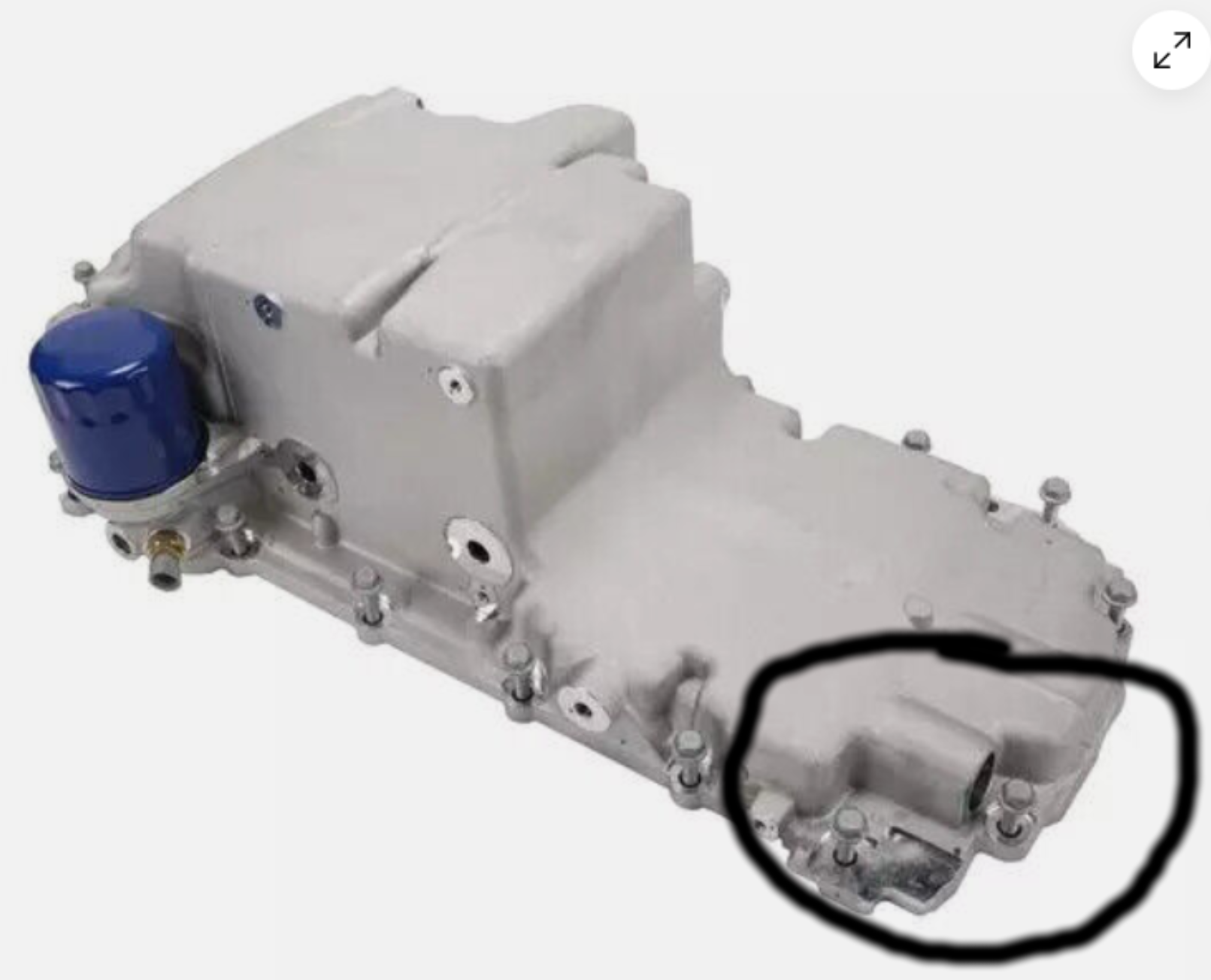

What is a "oil cup plug"? I believe the LT4 oil pan used on the blackwing is GM 12707563 but I haven't been able to find any pictures.
I haven't been allowed to see it myself at the dealership - but from what I understand its a metal plug inside the circled area that is used during manufacturing and it should never come apart. GM Part 12707561 is the prior version of the oil pan used in earlier LT4 engines. The Service Tech said he compared my oil pan to another vehicle with an LT4 and found the sealant and plug on mine showed it likely was not seated completely into the recessed area.
12707563 was what I found for the 2022.

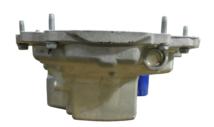

I took another run at searching for LT4 oil pan images and found 12732265:
Looking at the top down view (without the windage tray) it might be needed to machine an oil pump passage.

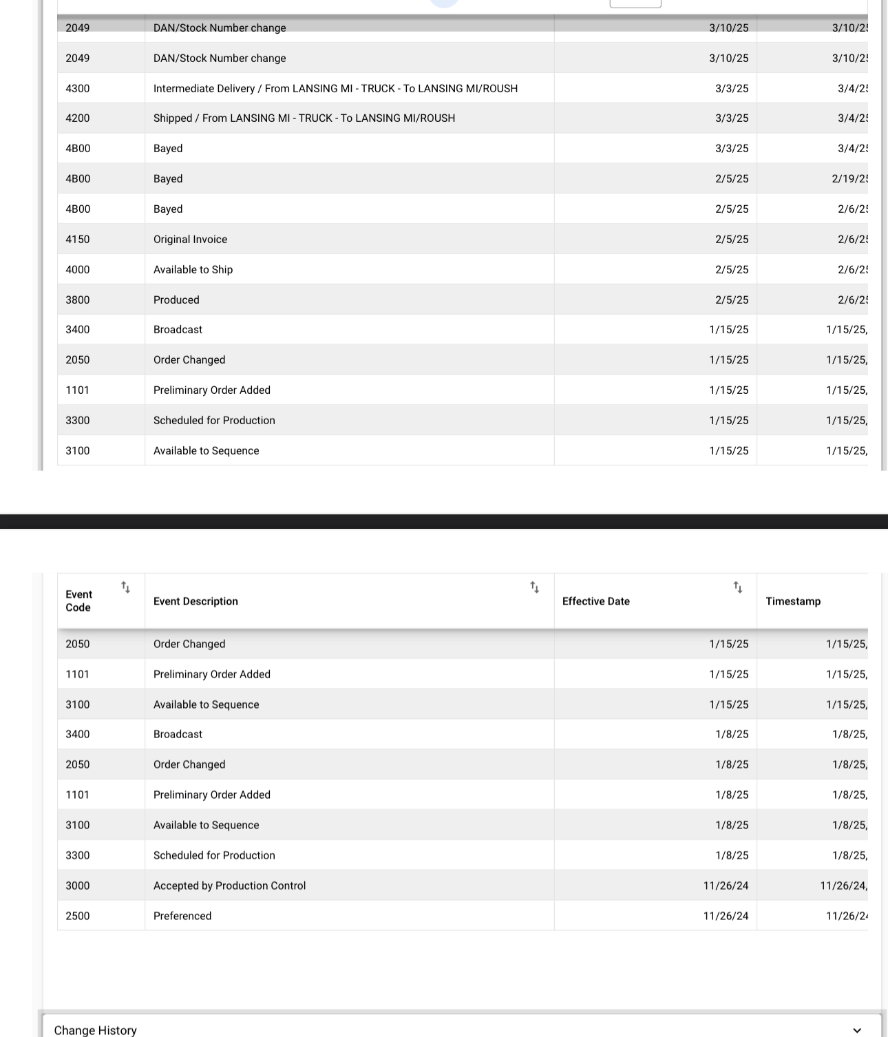

Guess I’m part of this here 🐐 rodeo now too. I opted to go for one that was already being advertised as in transit online. Put down the deposit and got the build sheet. Can anyone shed any light on this? Dealer says it should arrive by the end of the quarter.
Check out the GM Order Event Codes sticky post at the top. It looks like it might be sitting in a lot (code 4B00) in Lansing (based on codes 4200 & 4300).
Nothing out of the ordinary - it seems to take 4-6 weeks after production for them to finally ship.
