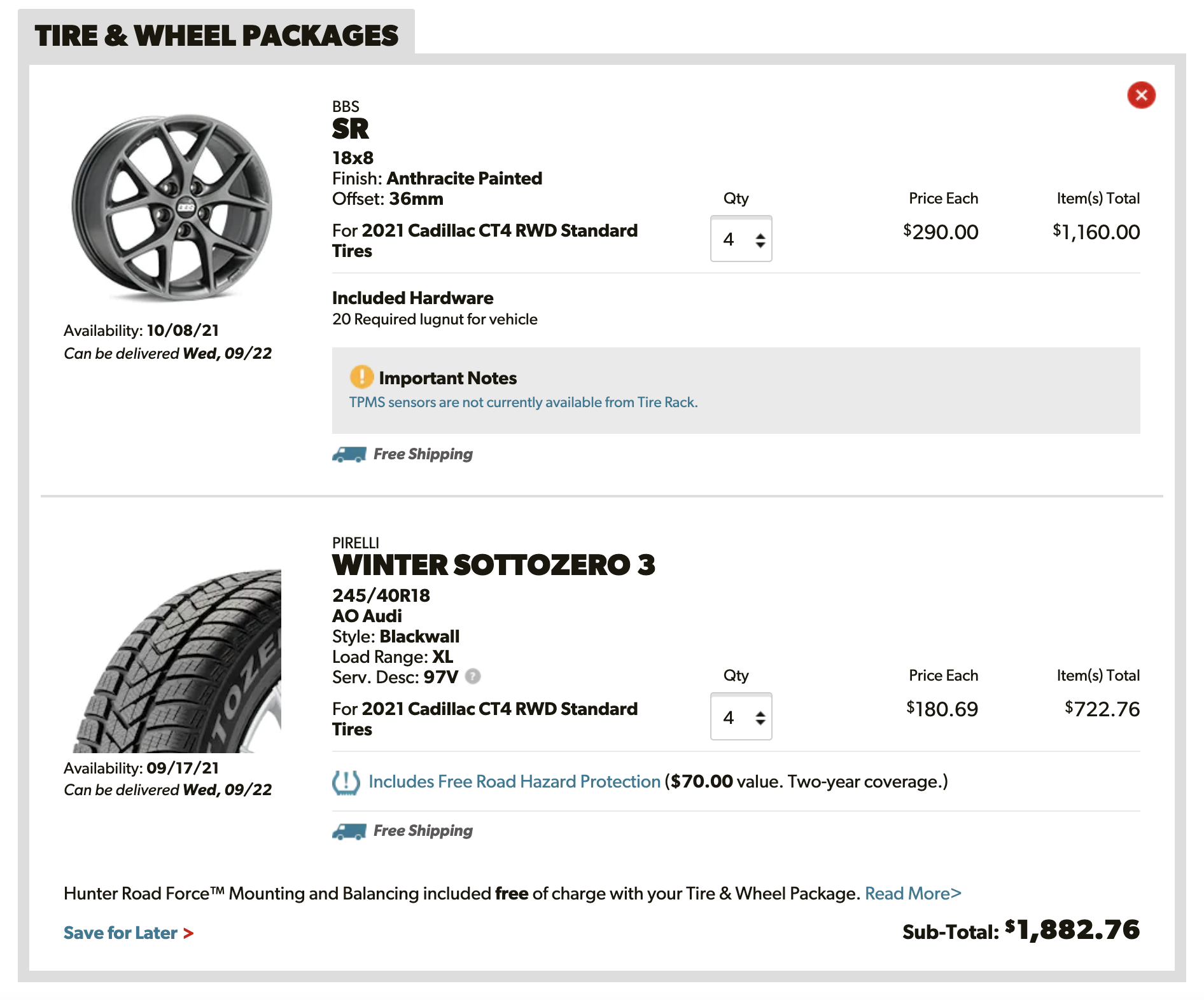

However, that is still a staggered setup. I was looking into a square setup and found a combo on Tirerack I think would work. Being a BBS, it will most likely clear the caliper and you get the extra 5mm sidewall compared to stock tires. See pic below.
You cant run a 255 on the rear wheel, it will stretch tire too much and decrease your OD. Just buy as close to stock no need to overthink this, your talking almost no difference in cost.

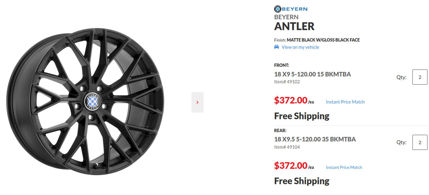

@Mirza Grebovic What kind of wiggle room are we looking at in terms of offsets for new wheels, assuming I stick with 18x9s up front and 18x9.5s in the rear? I believe the stock setup is +28 in the front and +48 in the rear, correct? Also, I know the Blackwing brakes are quite a bit larger than the ATS-V Sedan; will that likely be a problem when sourcing new wheels? I'd prefer to get a second set of wheels to run in the winter, but I also don't want to go up to 19s either.
Also, what is the size of the center bore for the blackwings? I can't find it published anywhere.
FYI, these are the wheels I'm looking at getting:

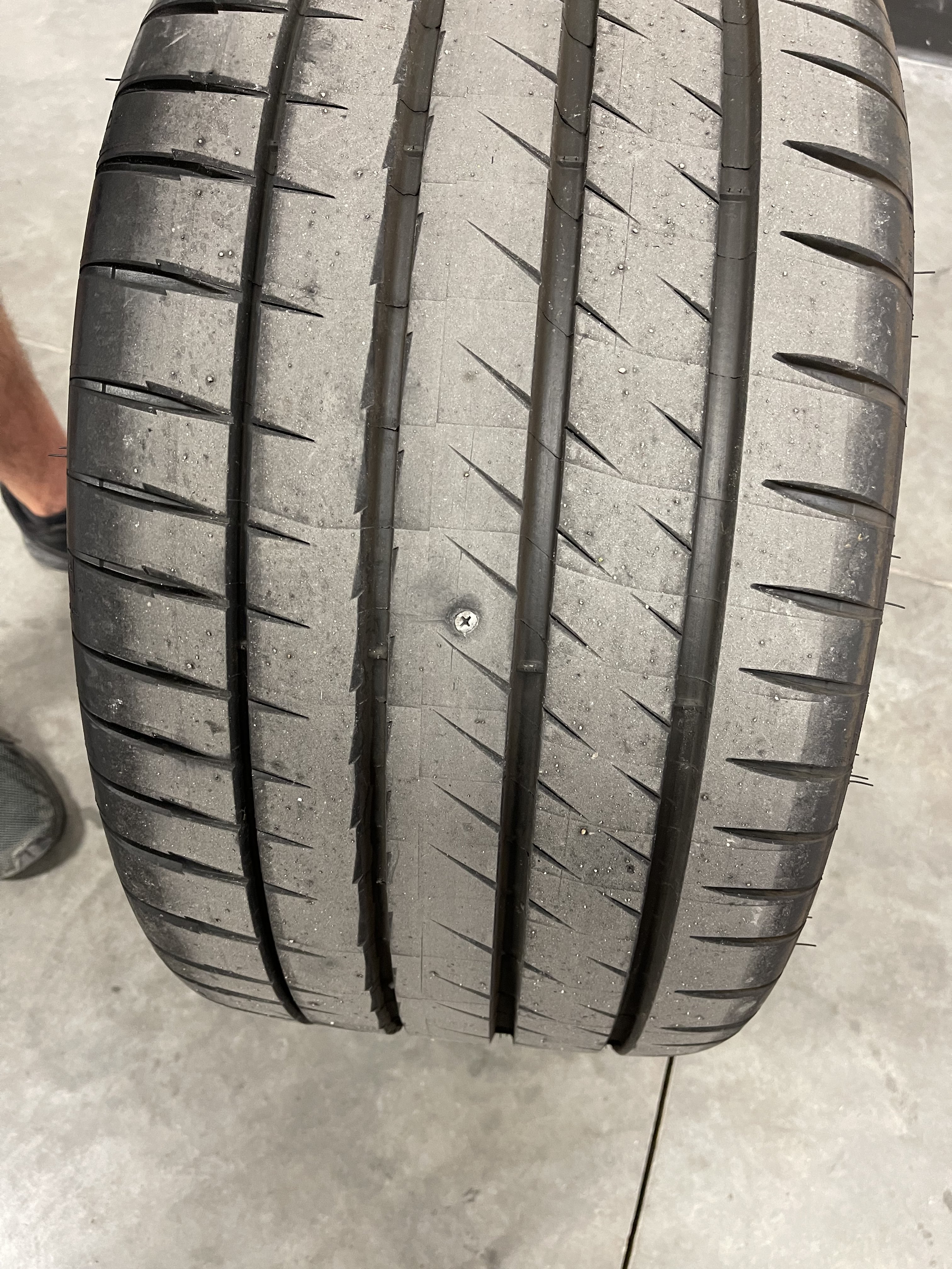

Are there replacement rear tires available yet in case this can’t be repaired? Is a ‘normal PS4S’ okay? Just curious but I expect it can be fixed. Only 200 miles.
That can be repaired. Just make sure that apply a patch inside and not a plug.
Yep they're available. I also caught a nail days after delivery and got it replaced at the dealer. Make sure you get the TPC spec PS4S
Hunter, all depends how you will use car and its something you have to check out with wheel shops. I cant comment on wiggle room without specifically getting into a project here. All tires are different for same size spec, all vary some, and some by many milimeters in width or od. I dont have center bore information.

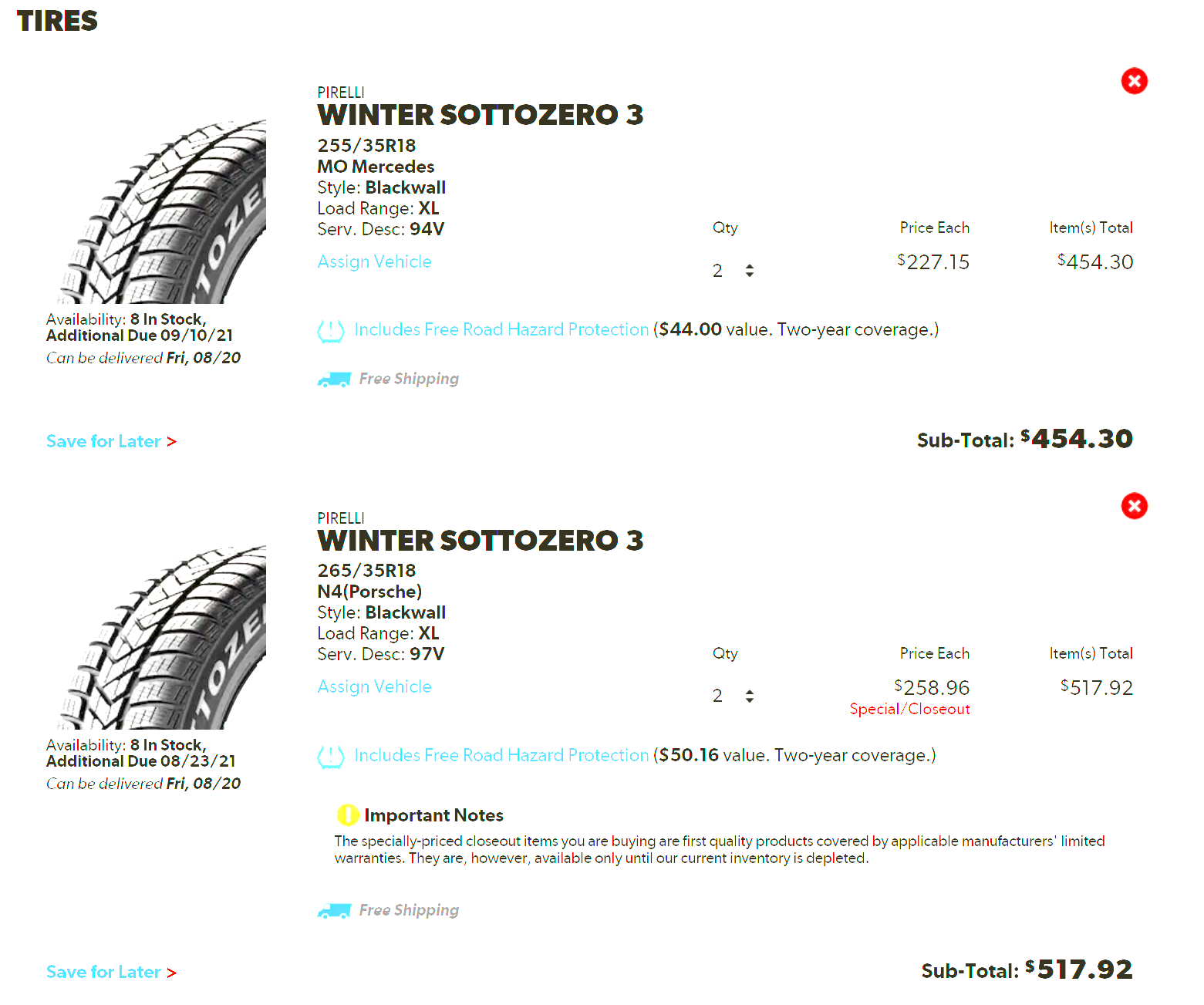

Found a pair of tires that should work according to Mirza. Now to find some wheels that'll work
So as I mentioned before, I was curious about the fact that these wheels are Mercedes spec and Porsche spec respectively, and wondered about whether that meant they had a different compound structure. I emailed Pirelli to find out and it turns out they do in fact differ, and Pirelli does not recommend mixing them, for anyone considering this route.
scratch that idea then. The search continues
