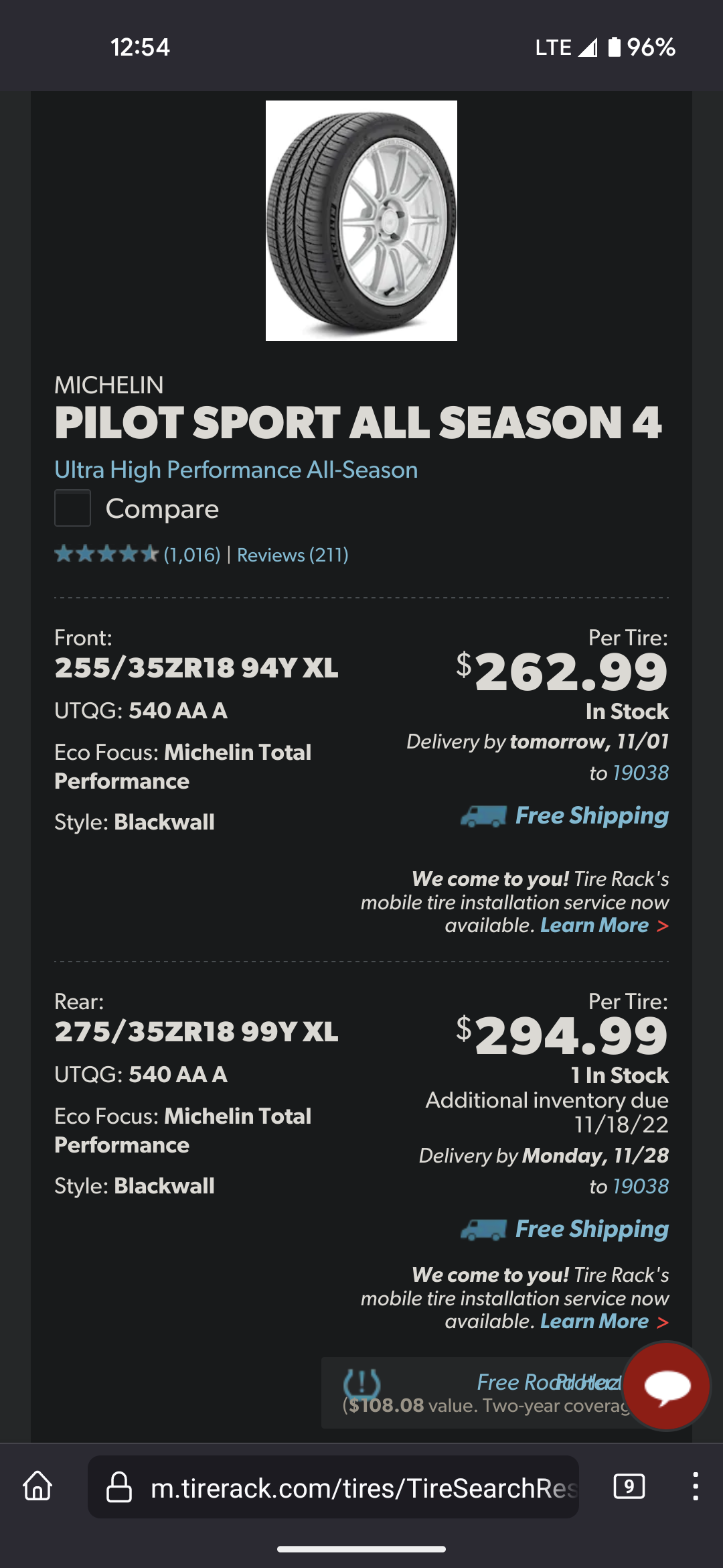

Tire rack should have the standard front 255s in stock, i think most of us went to either 265s or non xl 275s in the rear, not sure if anyone went up to 285. Looks like they have 1 read 275 in stock with more coming in ~2 weeks. The conti dws06+ are in stock now that I ran

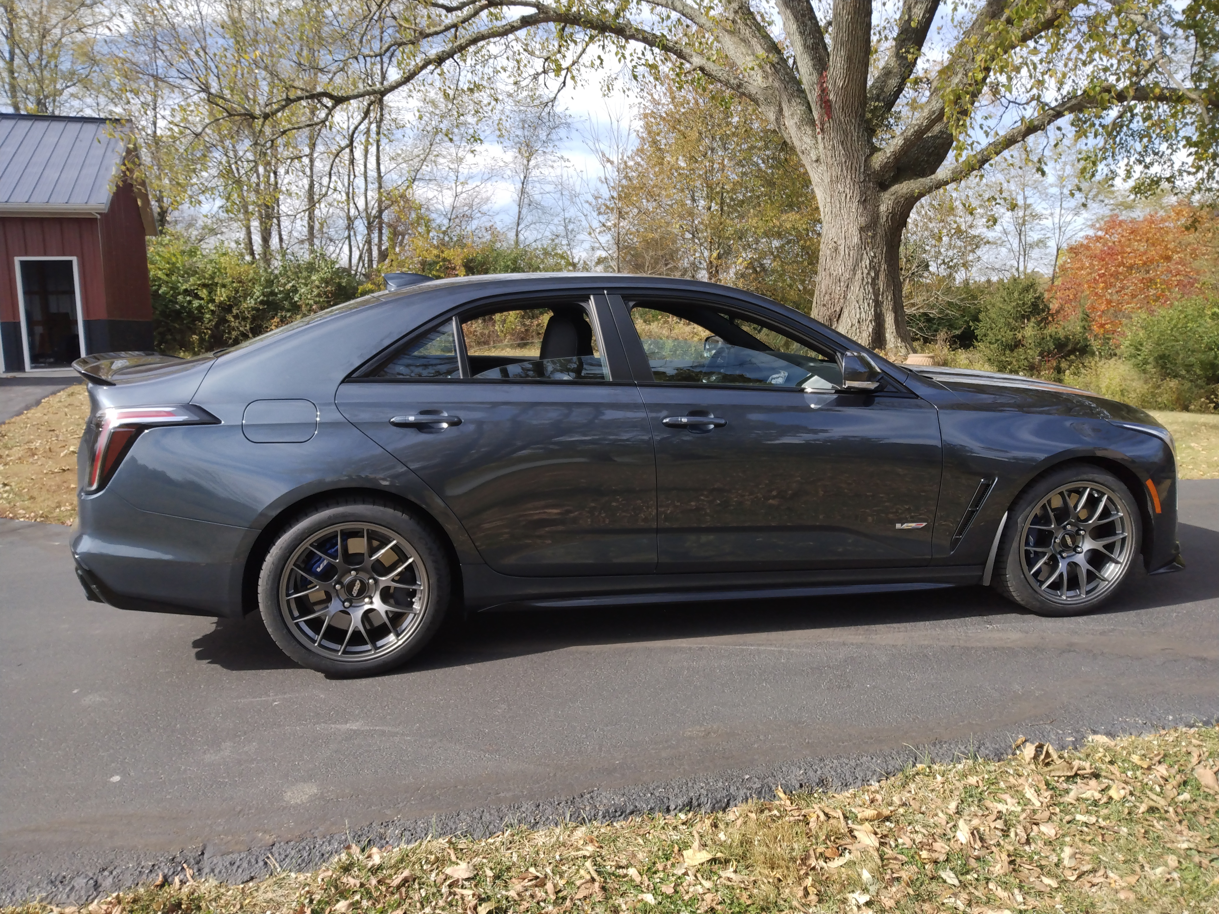

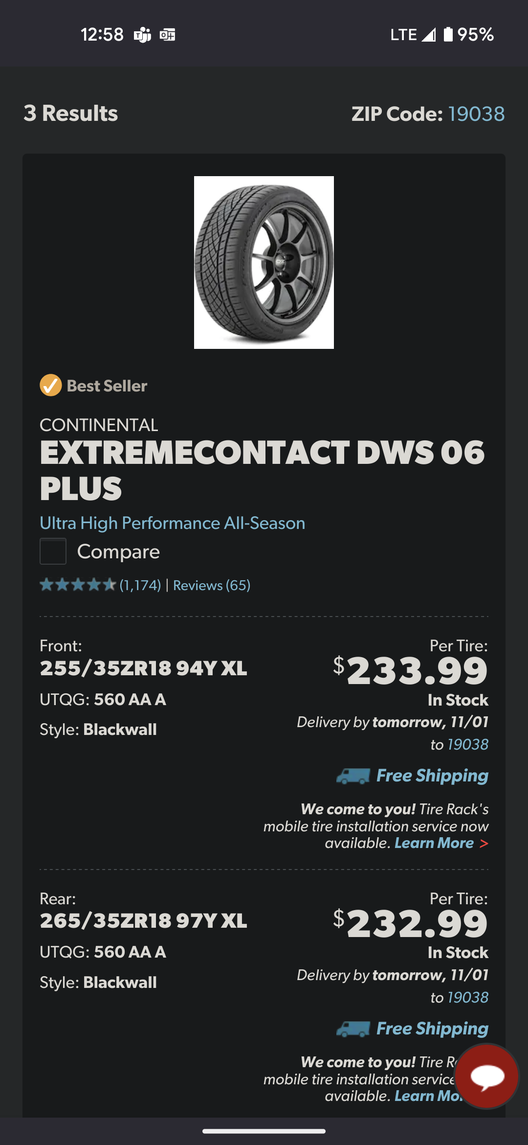

Same wheels as Novakin, but Conti DWS06 plus in 255/35 and 275/35. I have another vehicle for the small amount of snow we get so I opted for a/s instead of dedicated snows(since there were no good choices anyway). The rears don't have xl load designation, but for mild winter street use it shouldn't be an issue.
View attachment 13564View attachment 13565
Any issues with the non XL load on the rear tires? I had the same tires on my S4 and they were great. Was hoping to get a set of these for this winter.

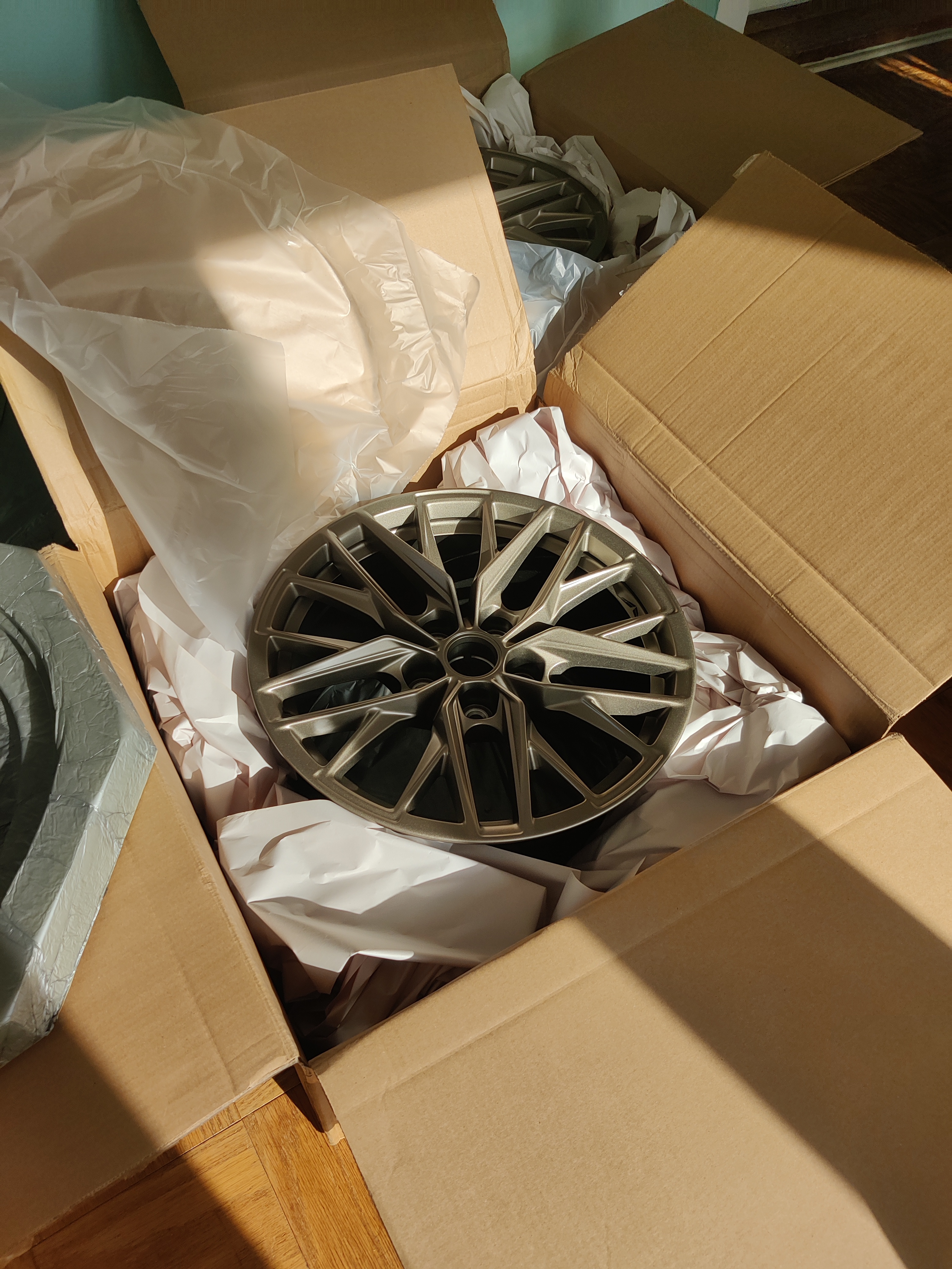

Well my second set of tech bronzes showed up today! Going to mount the stock summers on them. If anyone has any questions or needs anything for Reference off them let me know
Do you have the part number? Most of the GM part sites I've seen don't have pics of the wheels up. I think I want a set for when I put my summer tires back on in the spring.
There's a great opportunity to get a weight on them. Hopefully under 24lbs.

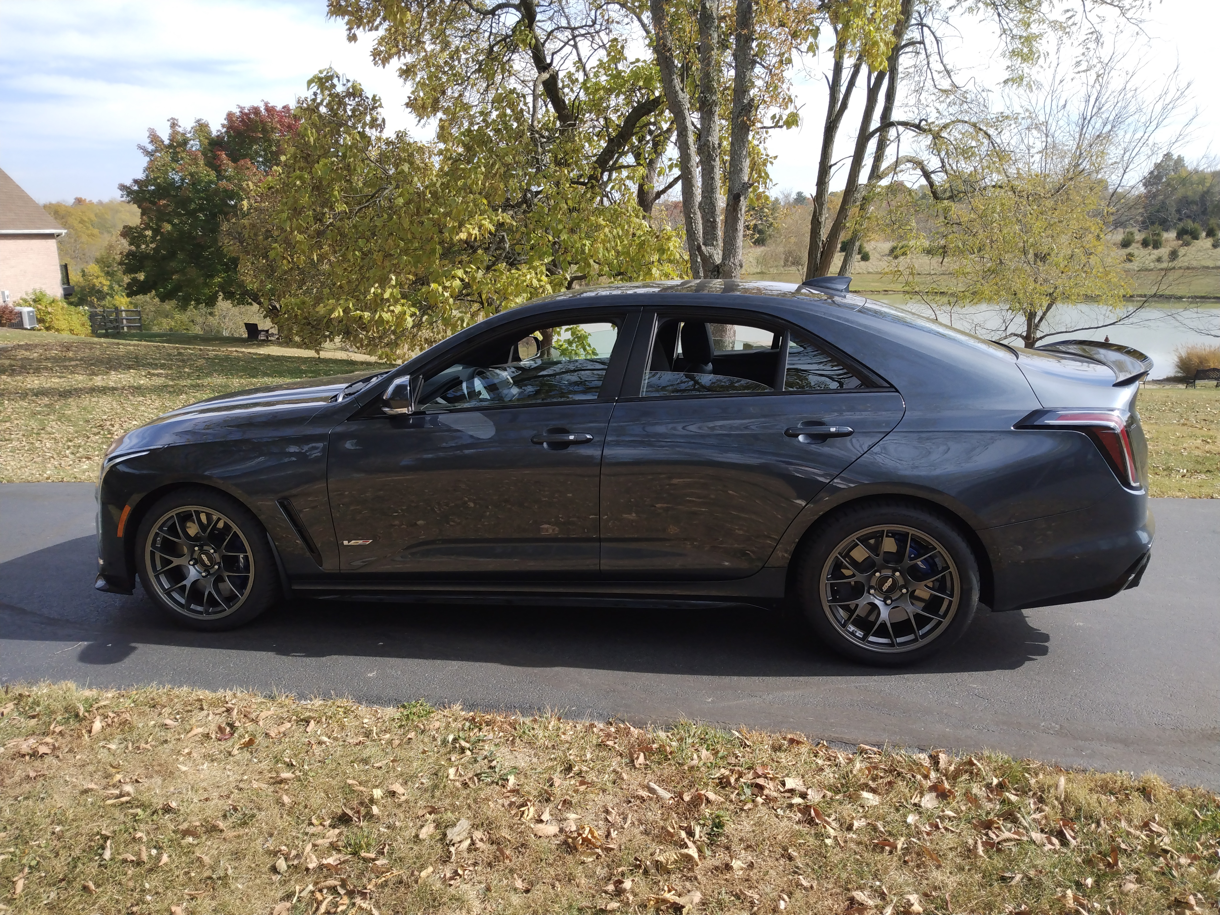

Got 255/40/19 and 295/30/19 sottozero IIs mounted last week on stock tech bronze wheels. Looks wise you’d think the car is on a 305 and so far I’ve been extremely pleased with the tires dry performance as well as aesthetics. Surprised how well the car hooks honestly

I was going to as well but then I realized it didn’t have the right XL load rating for the rears with the DWS06 plus so I had to order Michelin AS4’s instead.

so... I measured these multiple times and cannot explain it but,
Front: 18x9 tech bronze 28.2 lbs
Rear 18x9.5 tech bronze 27.2lbs
That's a bit on the heavy side. That would motivate me to find an aftermarket option. Unsprung weight is worth it to reduce.
