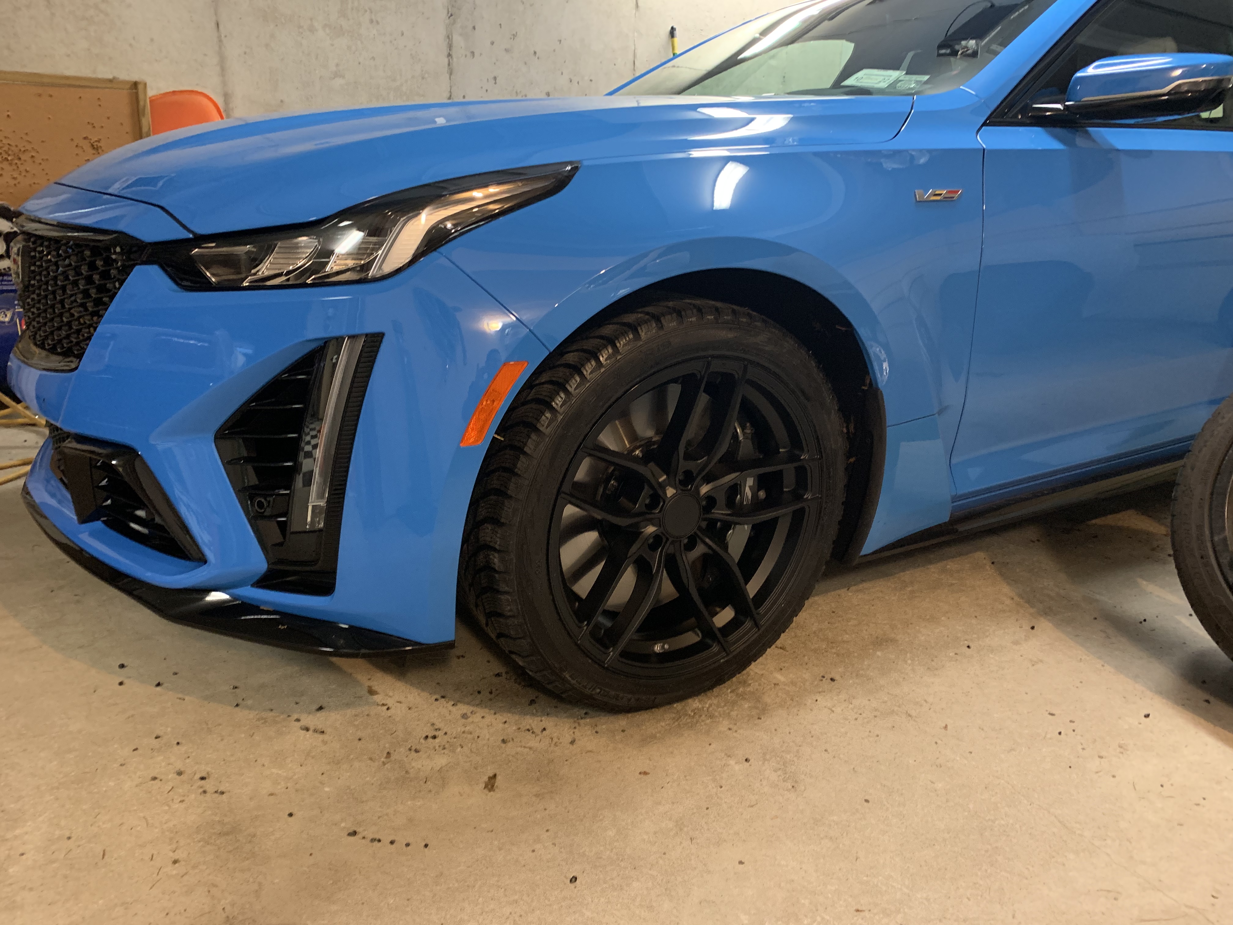

Can you post any pictures of the fitment?
here is a summary of my parts:
wheels drag wheels DR-80 19x9.5, 5x120 pattern
tires nokian hakkapellitta 275/35-19 - i only could find them from one vendor on amazon although they are probably available lots of places earlier in season. i found simpletire.com nice to work with the year before
sensors - GM 13538760
sensor nuts - GM 13581557
need smaller lug nuts than stock. i used cal custom 754003B
tires made in russia, sensors made in UK, wheels made in china, lug nuts probably china too
couldnt find anything made in USA for wheels, tires, or lug nuts

so you ran a 275/35-19 on all 4 corners?
yes, obviously these tires are much more narrow than stock blackwing rear tires. in the snow, that is probably desirable. i can rotate them year to year this way
