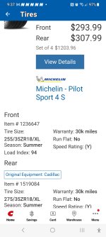

I'm looking at Costco right now and see the Cadillac specific set of 4 OEM tires on sale for $1,157.88 installed. Shouldn't be a problem to order front tires there.

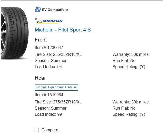

I just checked their site and they have the OEM rears but not the fronts. It doesn't say OEM under the name and the item code on the fronts matches their standard stock 4S item code.
I wonder if we're seeing regional inventory differences? I'm in the Seattle area and using the app on the phone and seeing availability below. I’m also seeing a separate part # for the front Cadillac spec tires as item # 1519051. If this is similar to my experience with the 5BW, I’m guessing one has the foam insert and one doesn’t. Either way, I’ve gone into the warehouse to have them order from the distributor when they’re showing no availability.
I wonder if we're seeing regional inventory differences? I'm in the Seattle area and using the app on the phone and seeing this:
Do you see where the Rear has " Original Equipment: Cadillac" under it but the Front doesn't? That's their site substituting the standards 4S in place of the OEM tire.
Crap, that's bad implementation. So it is the 1519051 item number which is showing out of stock. I've had good luck going to the counter and having them order from the distributor when they're showing out of stock in the past (ordered the first replacement set at Costco in Nov '21 when item numbers weren't in their books yet.)
If I need a replacement set before the TPCs are in (likely if it's June or July), I'll roll the regular 4S. Can't be that different and while I've confirmed that the TPCs are great on track, I doubt I'd be able to tell the difference.

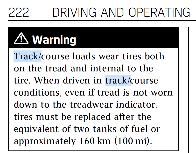

FYI - I burned through the original fronts in 3.5 track days - that was Twenty (20 minutes) track sessions/heat cycles. I had to limp home from the track at lunch. The driver's side front outer edge had chunks coming off. Per the owner's manual - Track life is 100 miles. Reference the - Track Events and Competitive Driving (V-Series and V-Series Blackwing) section:
If that is true, the we are talking about $1500 per track day, YIKES!
Ouch. Yea, I’ll switch to stock size 200TW Kuhmo V730s rather than stick with the stock Michelins. Endurance 200s can take more heat cycles and longer lasting tread than the PS4S while having more ultimate grip. Though I understand why it shouldn’t be on a daily driven vehicle.
You're over driving the stock tires. The 4S isn't going to last if you're running intermediate pace or higher as they're a street summer tire. Like mentioned, you need to upgrade to a 200TW tire. If you're killing your fronts after 3 track days and running the full track alignment then you should probably be on 200TW tires, track pads and fluid. It's going to save you money as they're going to last longer and they don't cost anymore than OEM.
