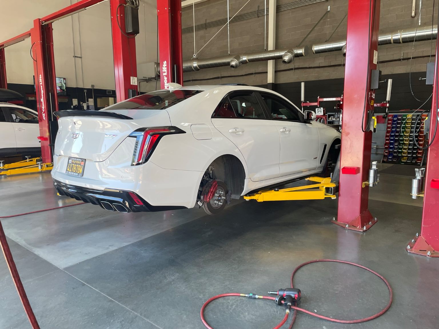

Got my OEM TPC Spec Michelins installed yesterday at Costco. They had the tires in 3 days, but it took almost 2 weeks for an install appointment. They did a great job IMO. No issues and all the techs are "Michelin Certified" with certificates and patches (what ever that means).
Also they did not use nitrogen and green valve stem caps, which was appreciated by my bronze wheels!
Fun part was that the fronts were more worn (to the bars) than the rears...so I left early for the appointment and evened out the wear on the way over...heh.
I'm going to send in the $90 spring mountain rebate form and see how it goes.
Total miles was 9200 with one track day, my commute takes me thru Mulholland/Santa Monica mountains.

Costco did your tires? I'm surprised as my Costco as well as others that I've read didn't have the specs to put it on their lifts.
And why can't you run nitrogen with bronze wheels?
