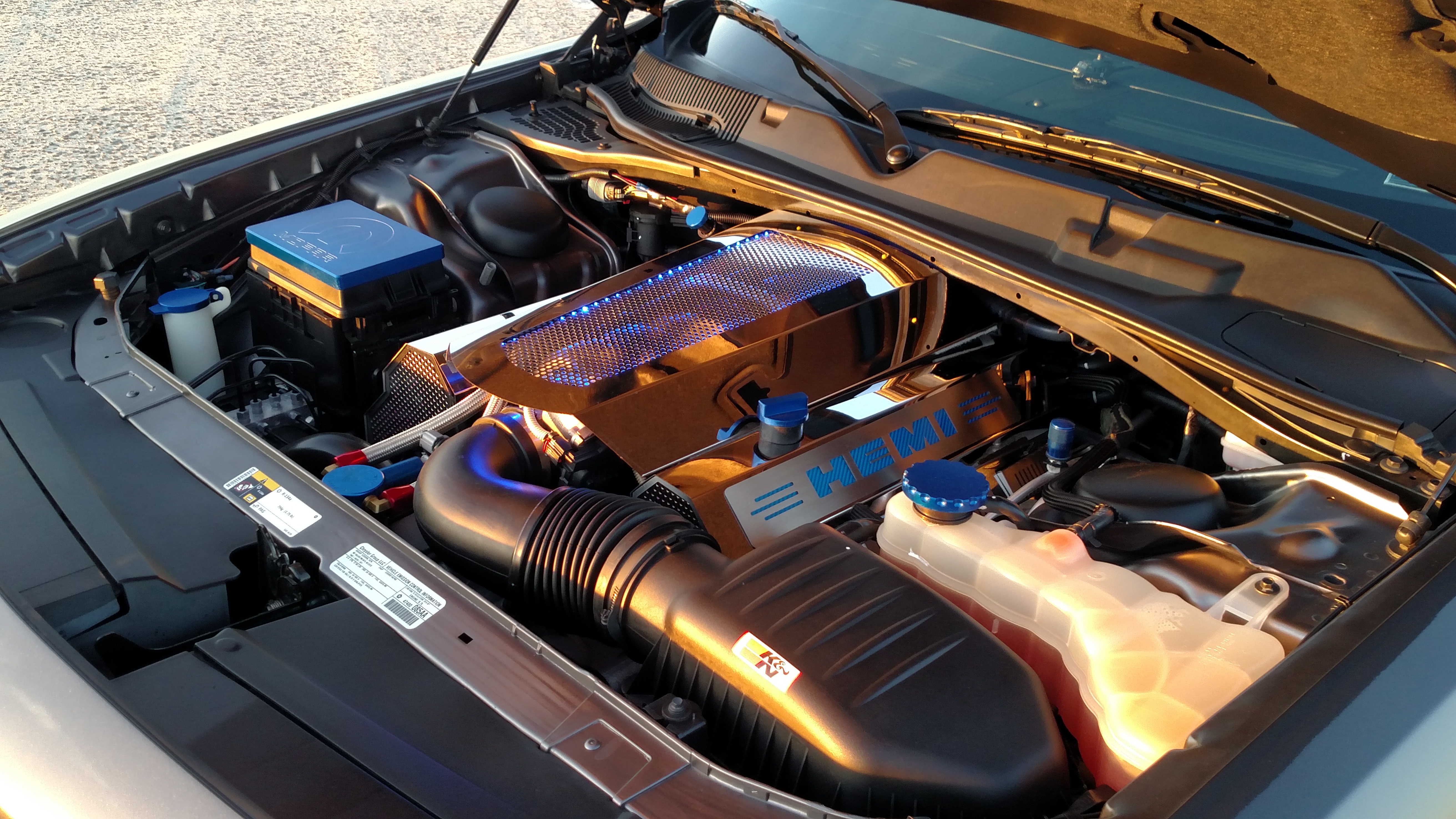

I would bring my 2014 Dodge Challenger into the local dealer for oil/filter change. I have a bit of chrome bling in the engine bay. On my way home after a service, I see some smoke coming from under the hood. The service tech had apparently spilled some motor oil all down the side of the engine and all over my chrome. Stevie Wonder would have seen it and cleaned it up ! Now when I go, I put a bunch of those blue shop paper towels around the filler cap area. Sends them a message.

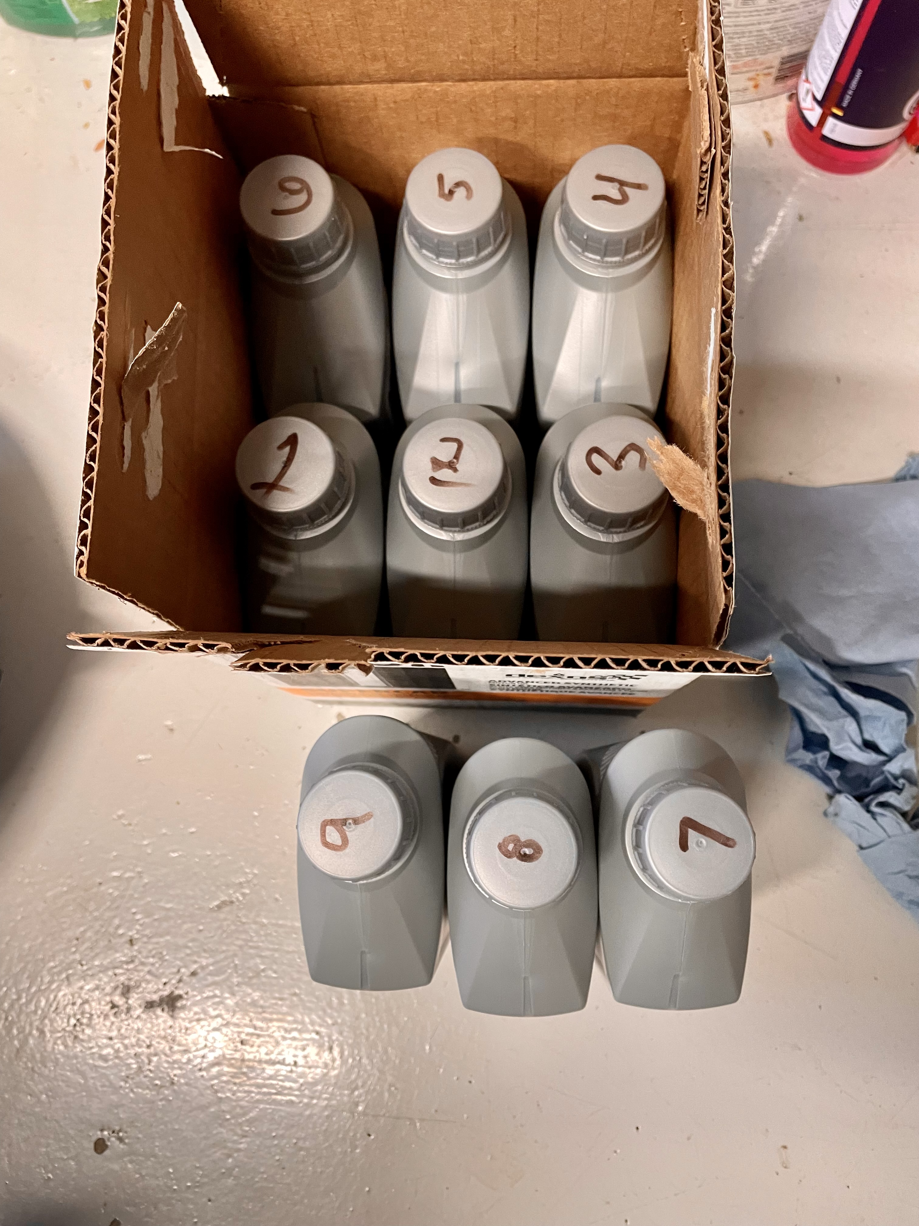

Since I’m not an officially certified GM tech, I use a simple dinosaur method (can you spot it) when I change my oil to remind my old mind how much I have installed, 😁
I also photograph from draining to filling including picture of the drip stick oil line, to reduce chances of warranty denial. 98, best of luck on your outcome 👍
