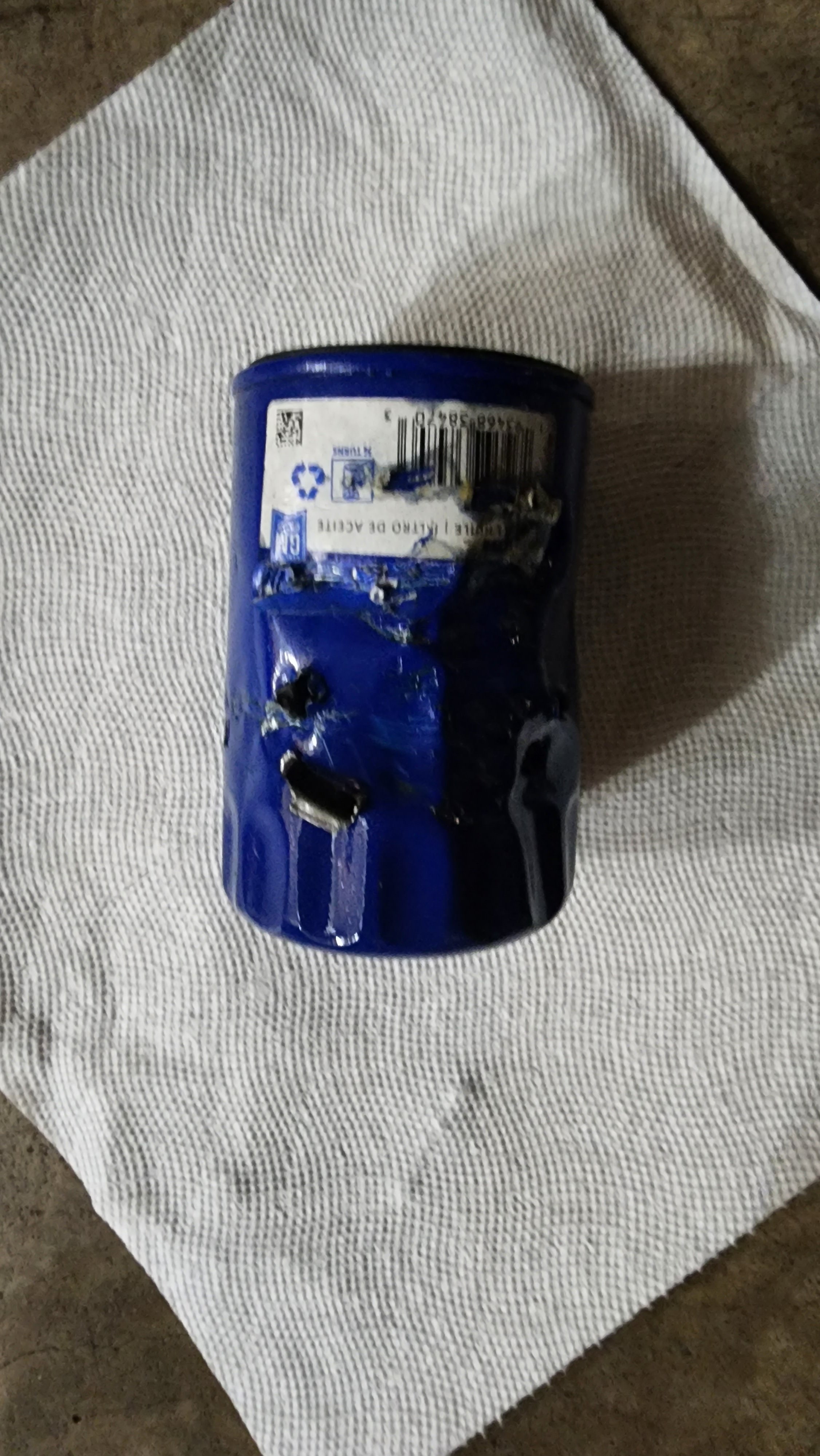

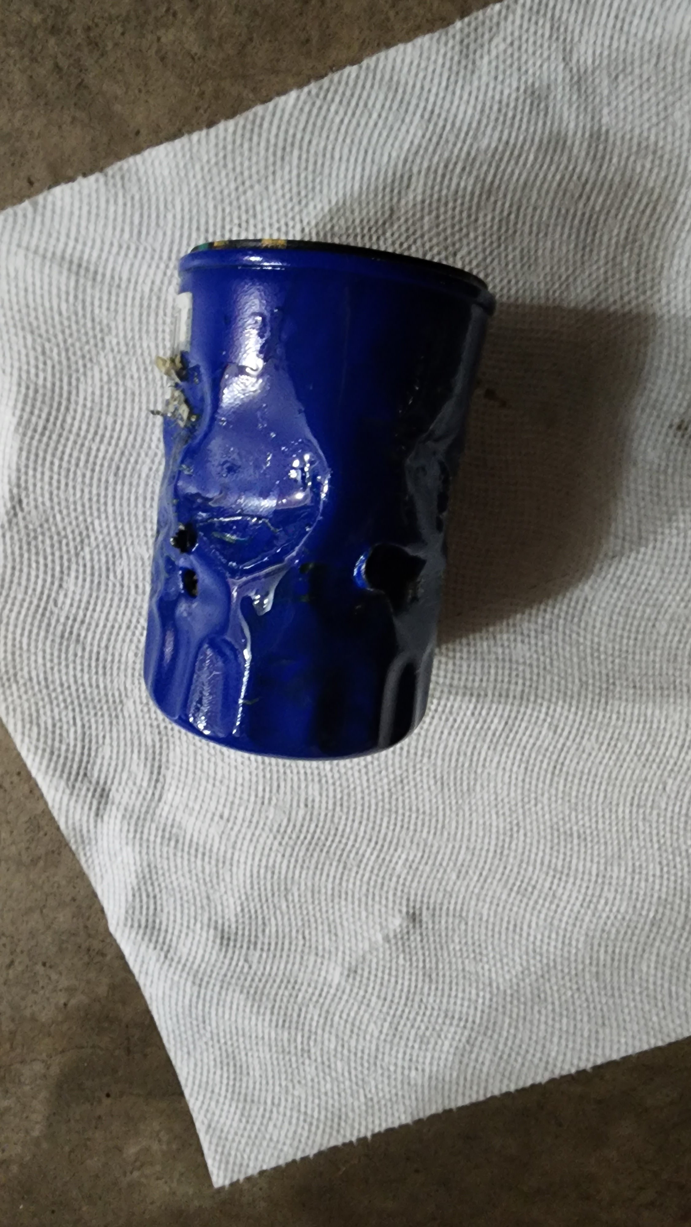

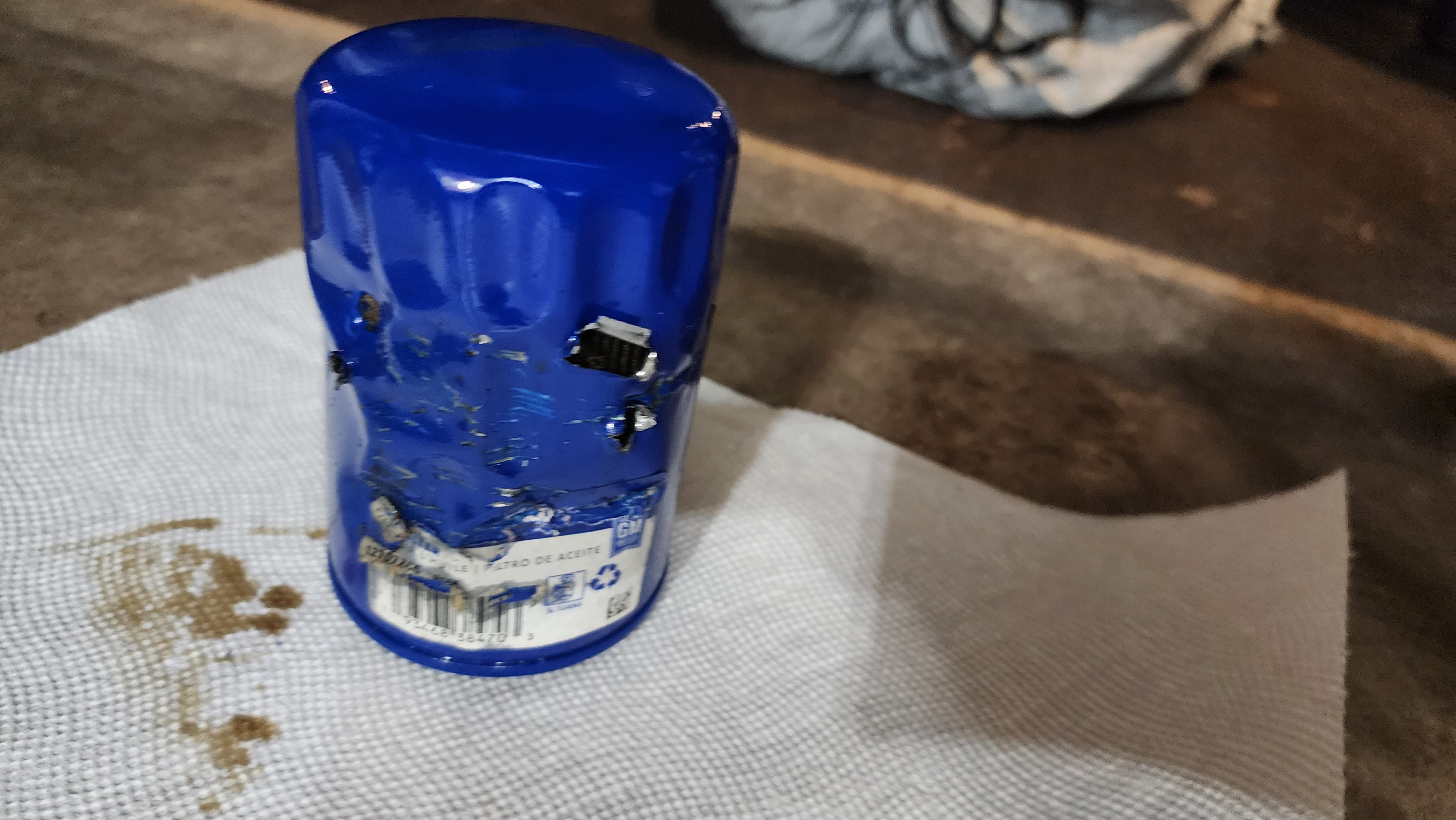

Man, that was the worst oil change I've ever experienced and turned from something fun to super stressful. The oil filter was on there damn tight! Took a 30 minute job into 2 hours of frustration.
Tried an oil filter wrench first (kind with the rubber strap that goes around the filter). All that did was dent/deform the filter pretty bad - no movement at all. Thats all I had on hand so I went to Autozone and got the metal cap that goes on the end of the filter - that ended up not working because I dented the filter too much with the strap wrench so it didn't hold.

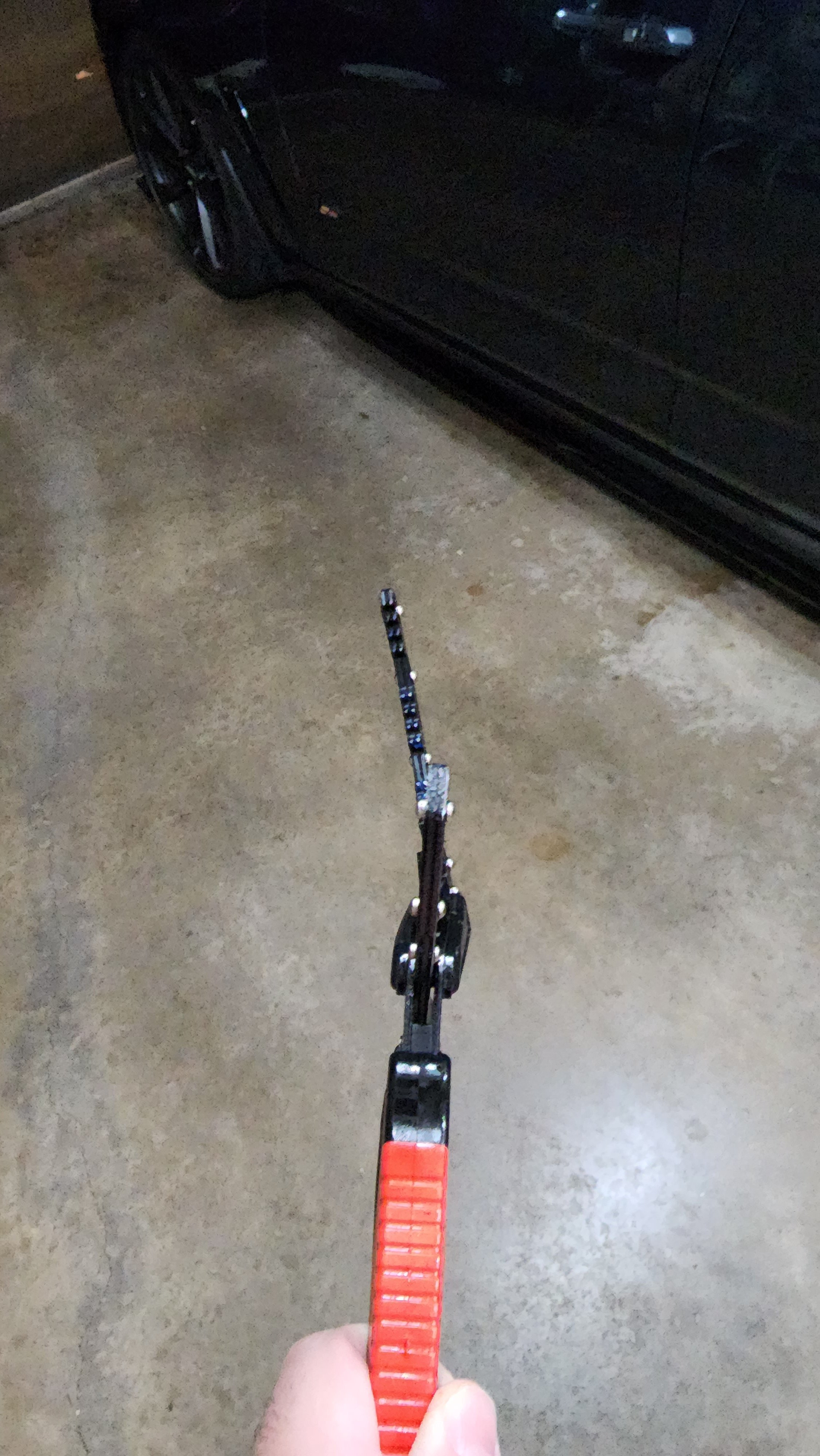

I also picked up metal oil filter pliers while at Autozone, so tried them next ( this: https://www.autozone.com/shop-and-g...pliers-adjustment-range-2in-to-5in/696473_0_0) and they bent/broke as well.

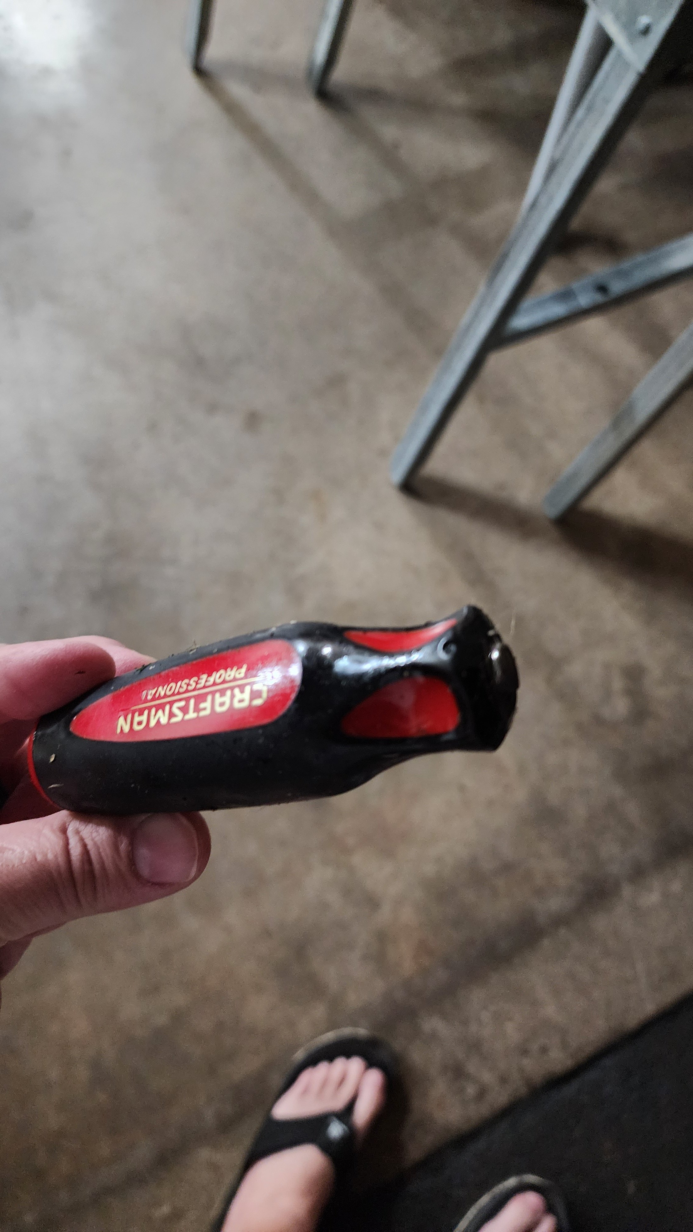

At that point I was running out of options because the metal pliers put holes in the filter so now I was essentially stuck, no oil in the car and holes in the filter so I couldn't just add oil and drive the car. Last resort was to drive a screwdriver through the filter. First screwdriver snapped in half from trying to turn the filter which caused me to smack my nose and make it bleed. Then I got a larger screwdriver and the filter FINALLY moved and I got it off thank God!

Dang, it sounds like you and I both had the same engine assembly knucklehead who thought it was a good idea to torque down an oil filter. My experience wasn’t as bad as yours since I was able to get the fluted wrench cap on the filter before it was completely destroyed. I was denting it up pretty good with the oil wrench filter before I resorted to the cap with an extension and a small breaker bar.
To make matters worse I don’t think they oiled the gasket, which caused it to bind and make it that much harder to break free. Anyway, hand tight now with an oiled gasket to make the job easy next time.

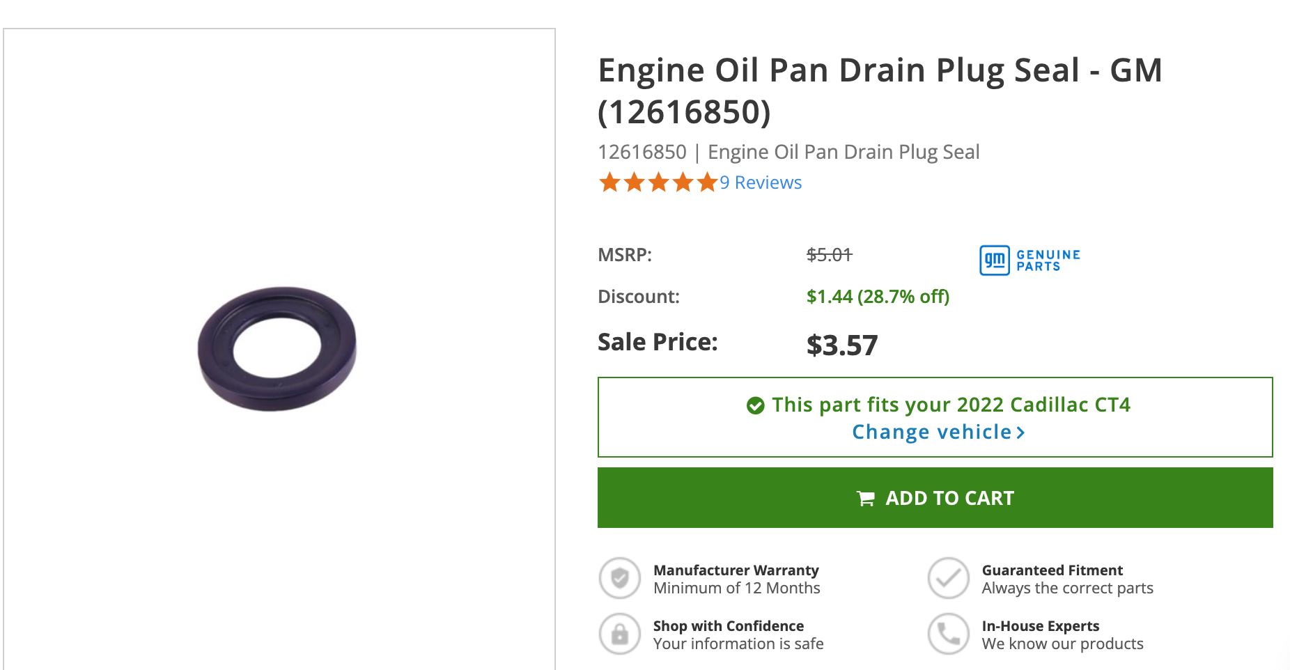

I didn't change mine on the first oil change. I think it just depends on the condition of it. I plan to swap it every other oil change. The official GM one looks a little different. I bought the OEM version just in case. I think I found them off E-bay for a decent price.

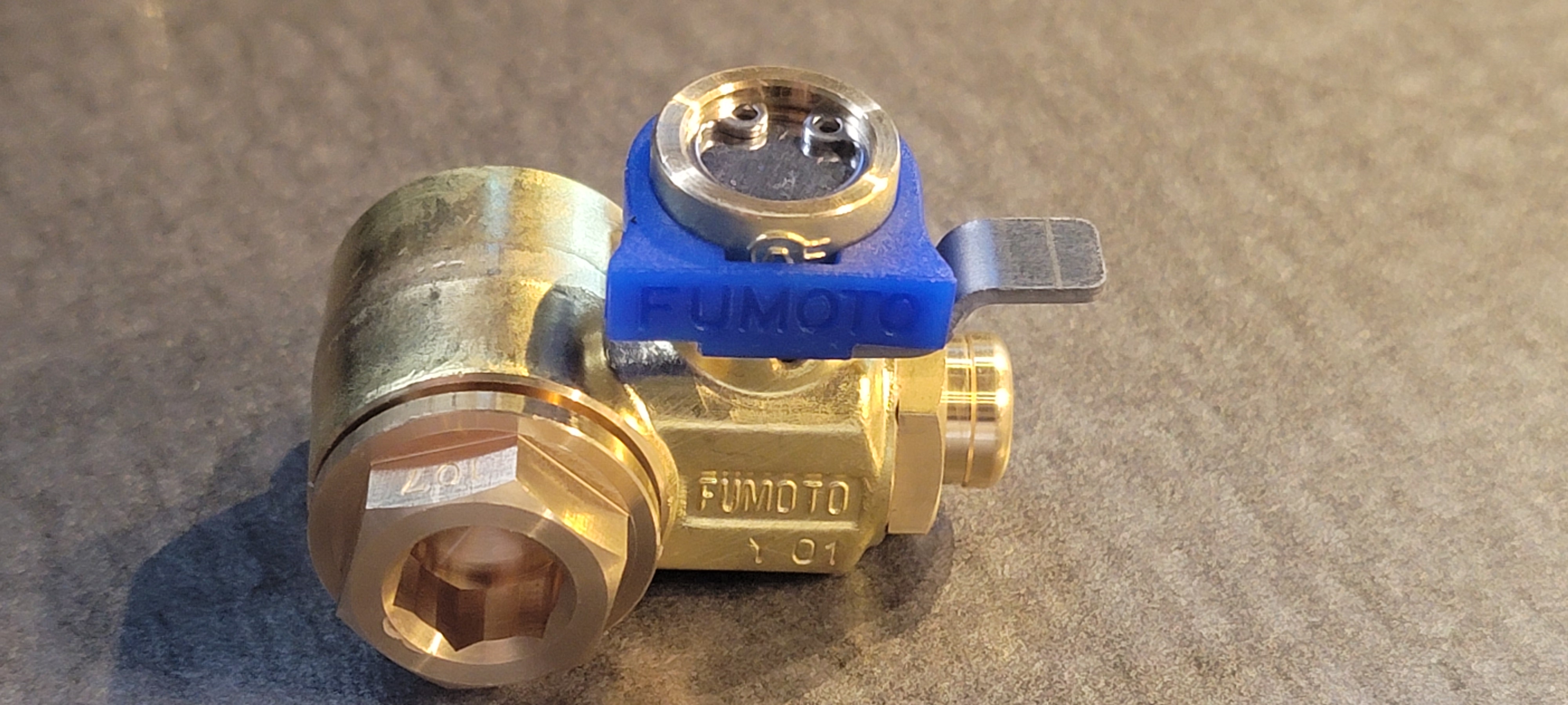

I installed the Fumoto F-107-SX oil drain valve . Install it after the first oil change and never have to remove the drain plug again ! Flip a spring lock switch, let it drain. Flip the lock back and you are done. No cross threaded oil pan bolts to deal with.
I like the idea (even have one sitting in my Amazon list), but it scares me that some road debris might hit it and cause it to drain. I know it has a clip and locking lever, but weird things happen. I couldn't live with myself if I caused such a calamity (and likely not warranty covered). I've never stripped a drain plug or really worried about doing so.
Now curious if any of these current engines have a low oil pressure shut off, like some previous GM car models had. That could take some of the anxiety away.
Emotions run strong on some forums over these drain valves. The benefit is as about as small as the potential for failure, so a I just stick with the caveman bolt and a gloved hand...that I drag on the ground.
