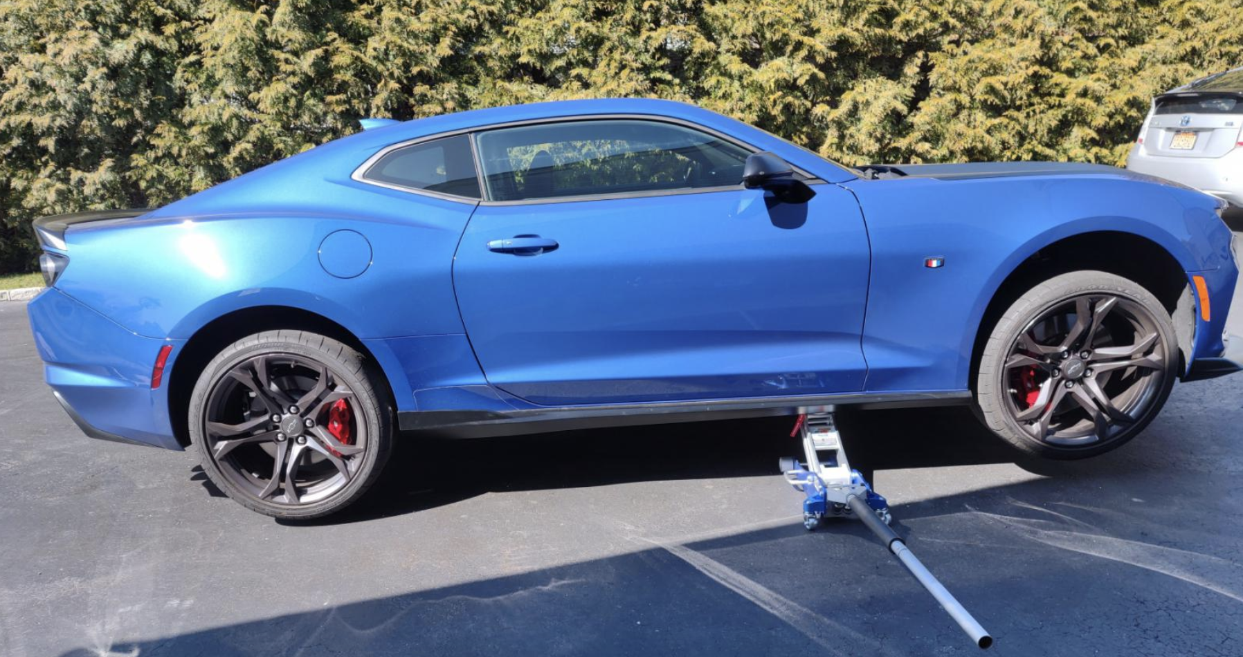

On my Tesla I use two jacks with lift pucks and rotate front to rear per side. It is pretty simple and relatively inexpensive solution. The Alpha chassis is so stiff if you lift from behind the front wheel the rear tire will come off the ground as well. :)
Like this...

On my Tesla I use two jacks with lift pucks and rotate front to rear per side. It is pretty simple and relatively inexpensive solution. Some of these newer chassis are so stiff if you lift from behind the front wheel the rear tire will come off the ground as well. :)
Like this...

It only needs to be just high enough to remove the wheel (as long as you trust your jack or have Rennstands).
I'm well aware that the cars rotate tires side to side. I'm not sure I can lift the car high enough with "hokey pucks" and a jack to take the wheels off. Don
I hear you. You could still use the two jack method, one jack on each side for the rear and same for the front. Just make sure you chock the remaining wheels when you lift.

I use the bolt throught the aluminum sub frame as a lifting point and use two jacks for the front.
