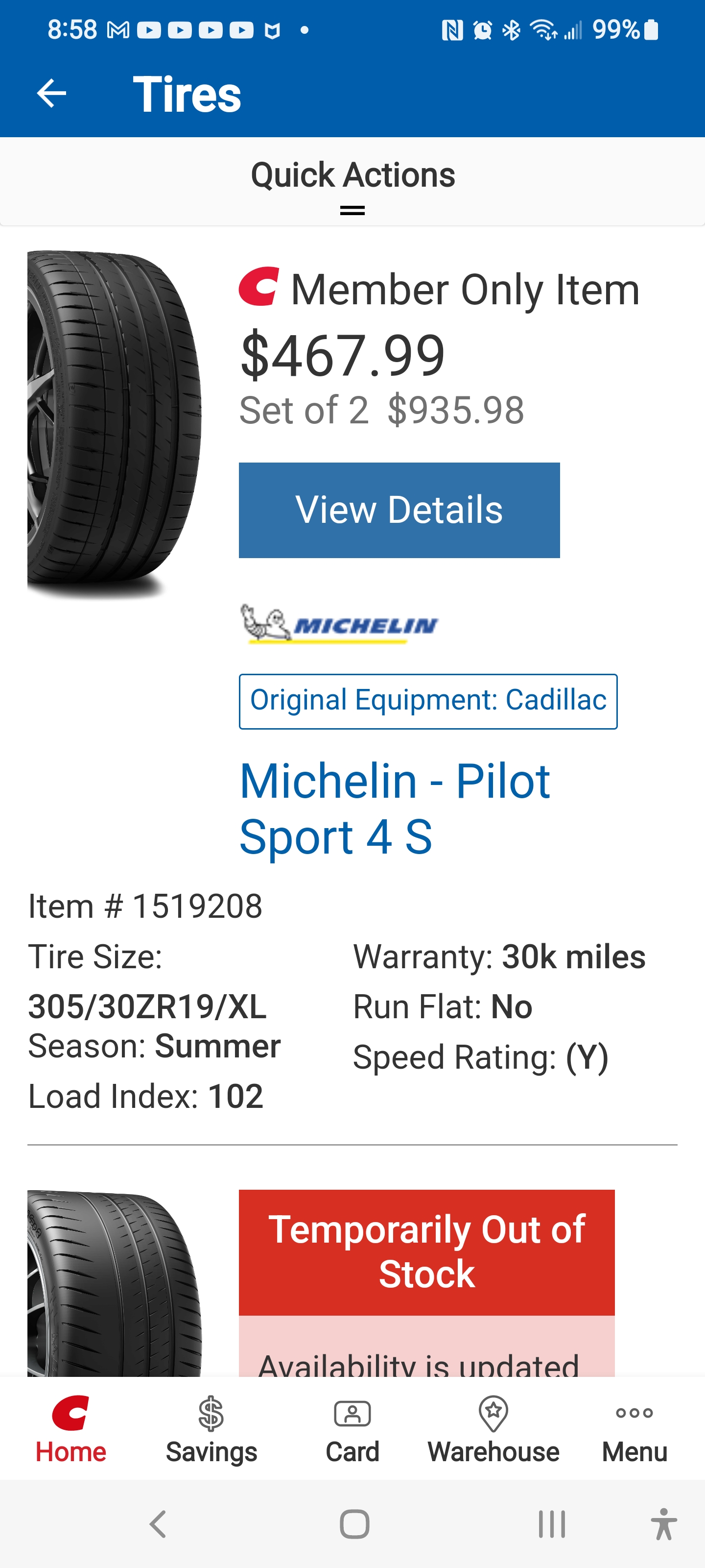

I'm seeing them at Costco in the proper Cadillac TPC spec
I believe that is the “regular” one that doesn’t have the inner foam liner to cut down on road noise. That is what the dealer is putting on until the one with foam in it is available.

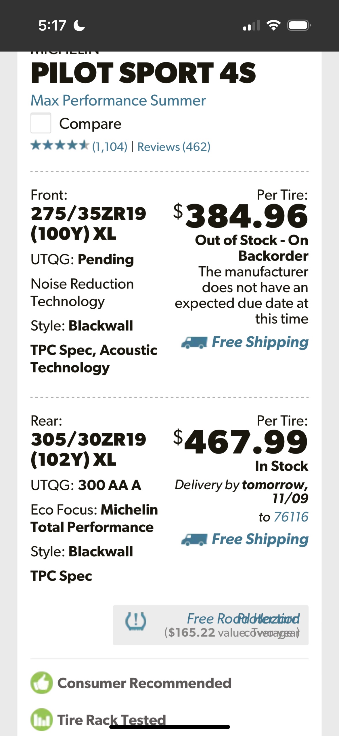

Here is tire rack and how they note the “acoustic technology” on n the fronts. Rear doesn’t show.

This is the first that I’m hearing about the TPC spec being Acoustic Technology. I was under the impression that it was for performance and had to do with the rubber compound. 🤷🏻‍♂️ @Mirza Grebovic ?

Don't know anything about foam. What I read was that the TPC spec for this car is due to about 61% usage of the same polymer used in the Pilot Cup 2 tire. I had to go thru some work with Costco to get the actual tires with the Cadillac TPC spec code but the ones I bought are indeed the exact same TPC code as the original OEM tires that came with the car.
I think both the acoustic version and regular version are OEM. Both TPC spec. I had the same issue on an Audi. They put acoustic ones on my RS3, my buddies RS3 they did not.
So update. Only the fronts have the big chunk of foam in them. The back doesn’t. They said there is a small foam insert but not the “acoustic technology” that Michelin puts in the fronts. Car comes back today.

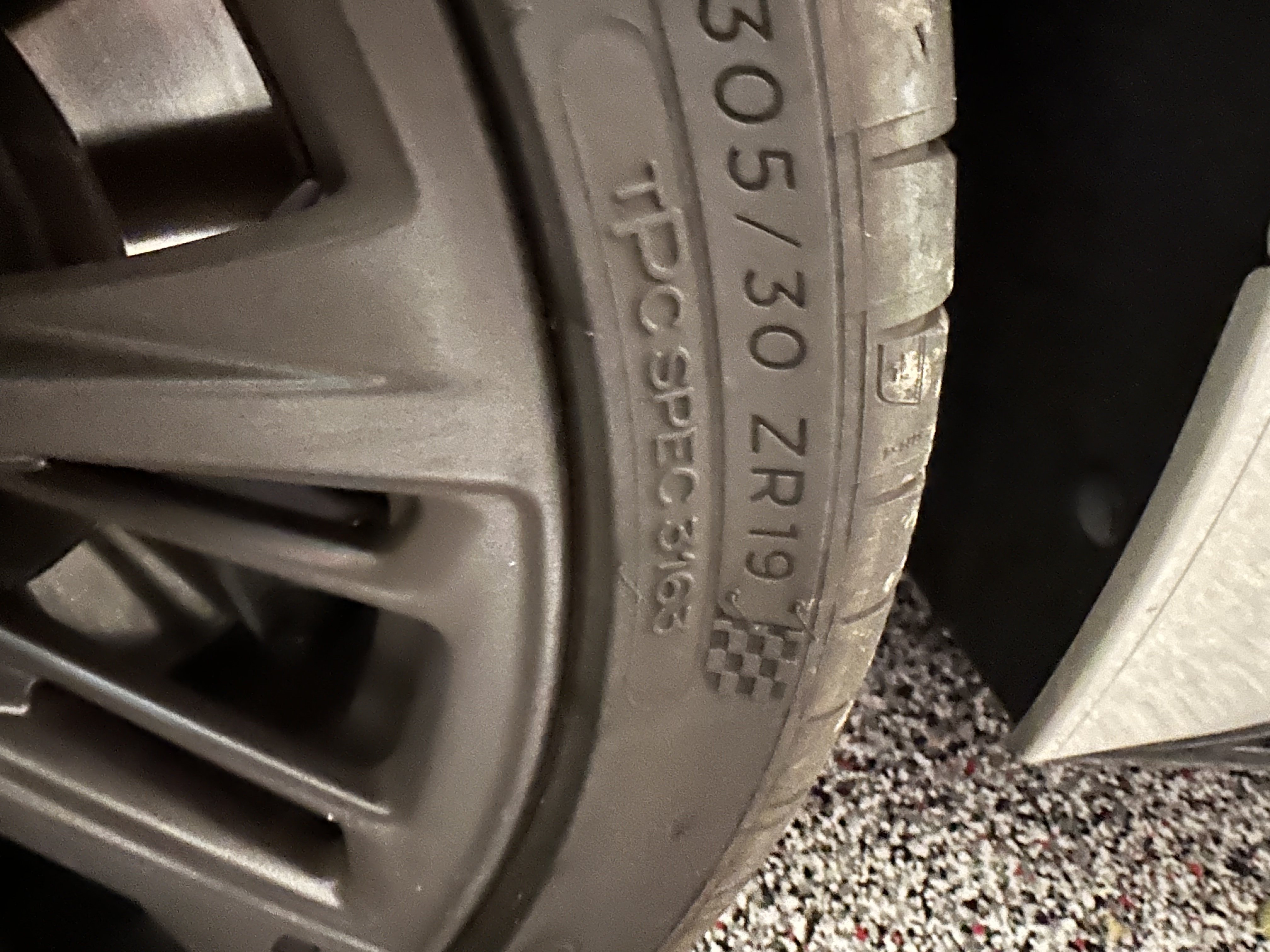

So I got the car back and the tire they put on is not a TPC spec tire but they told me it was the right tire for the car. TPC is not embossed on the sidewall like the other three tires. Does anyone know if a TPC spec tire has ever not been embossed? It seems as if this is a “regular” PS4S…dealer closed but will investigate tomorrow.
OEM tire will have the TPC spec on the tire. Ssme thing for specialized Porsche, BMW, etc tires.

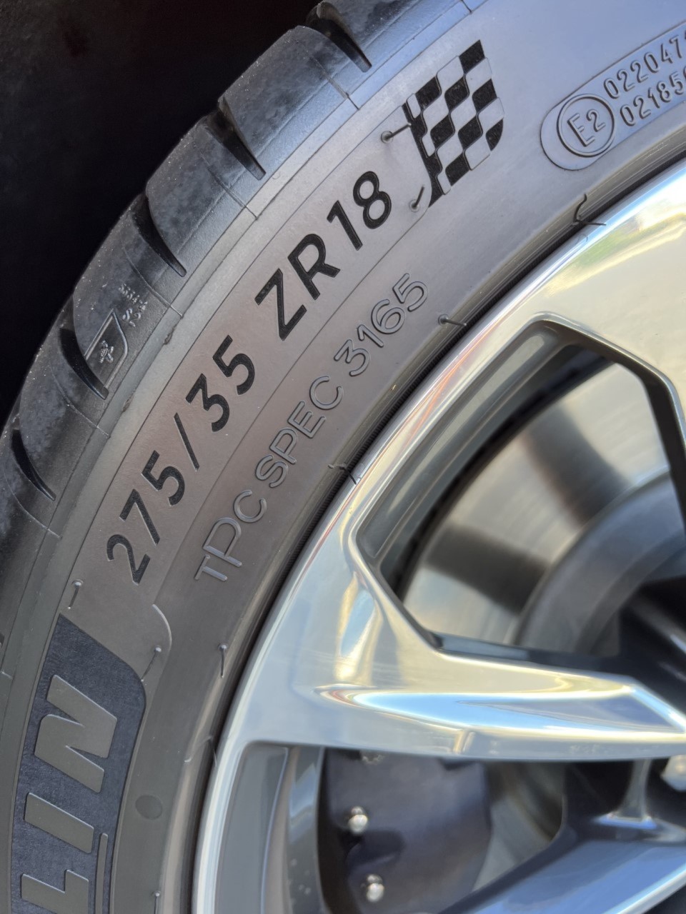

FWIW.....As I remember from being at COTA several years ago, the Michelin man (pun) said TPC is the tire made specifically for Cadillac. No TPC, it's just a "regular" tire. Sounds like another goat nightmare with tires.
I got a screw near the sideway at 206 miles on mine. I was at Discount Tire and they couldn't get the TPC, so I got the regular 4S. Tire Rack did have the TPC version however. Here is the TPC sidewall

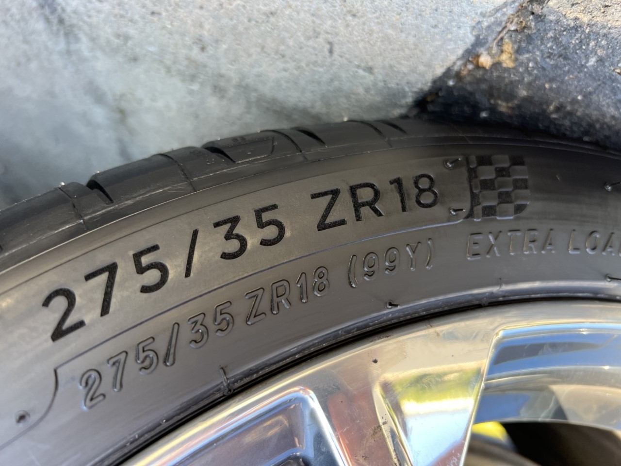

Here is the non TPC sidewall
