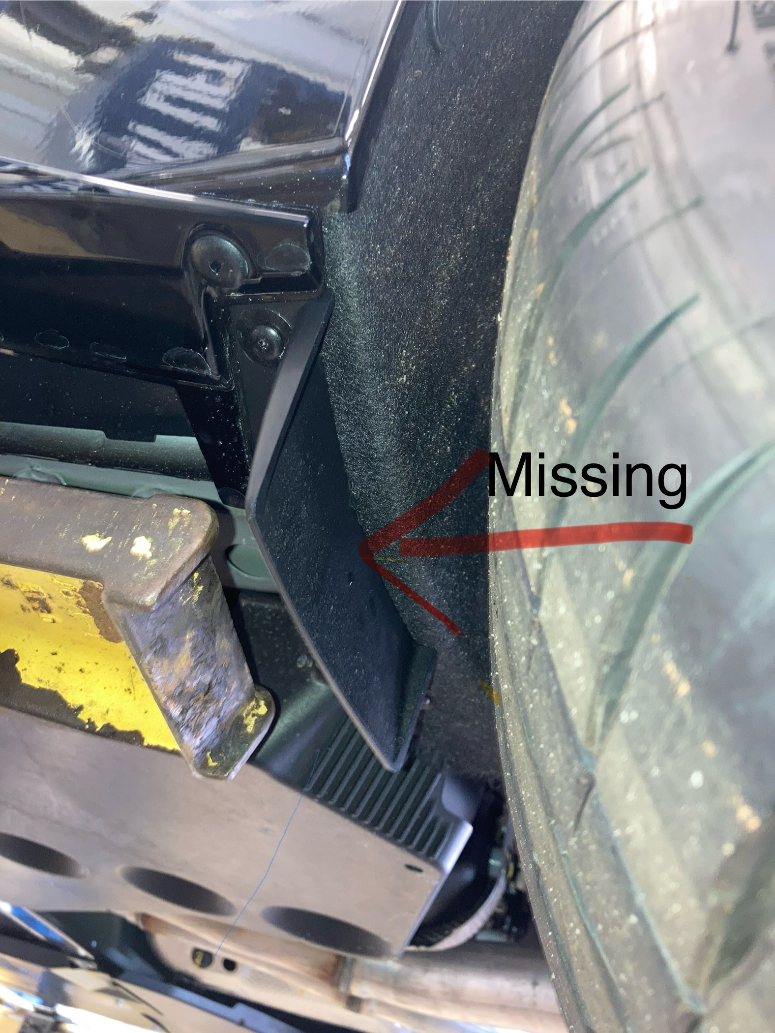

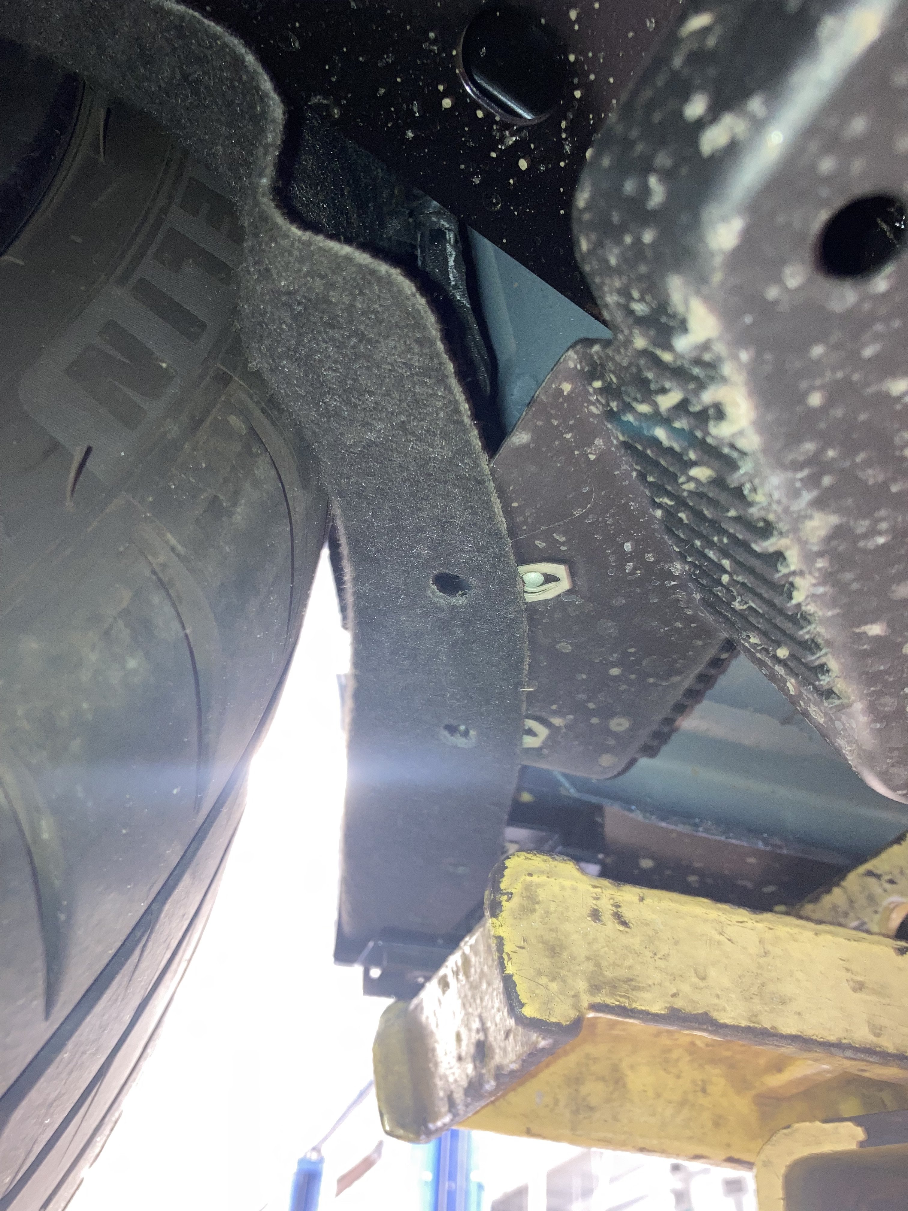

So, I noticed empty screw holes on the underside right in front of the rear tires.

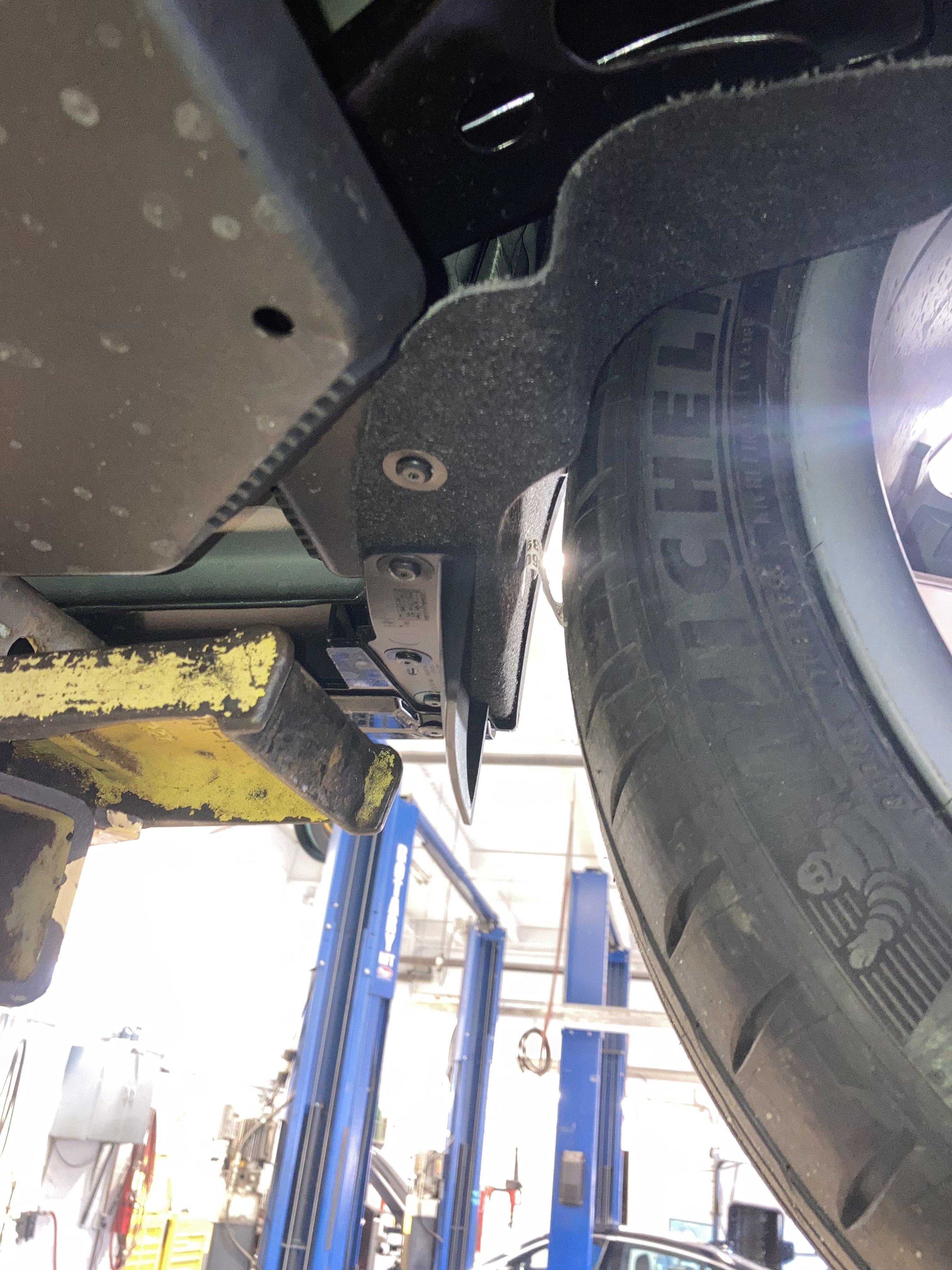

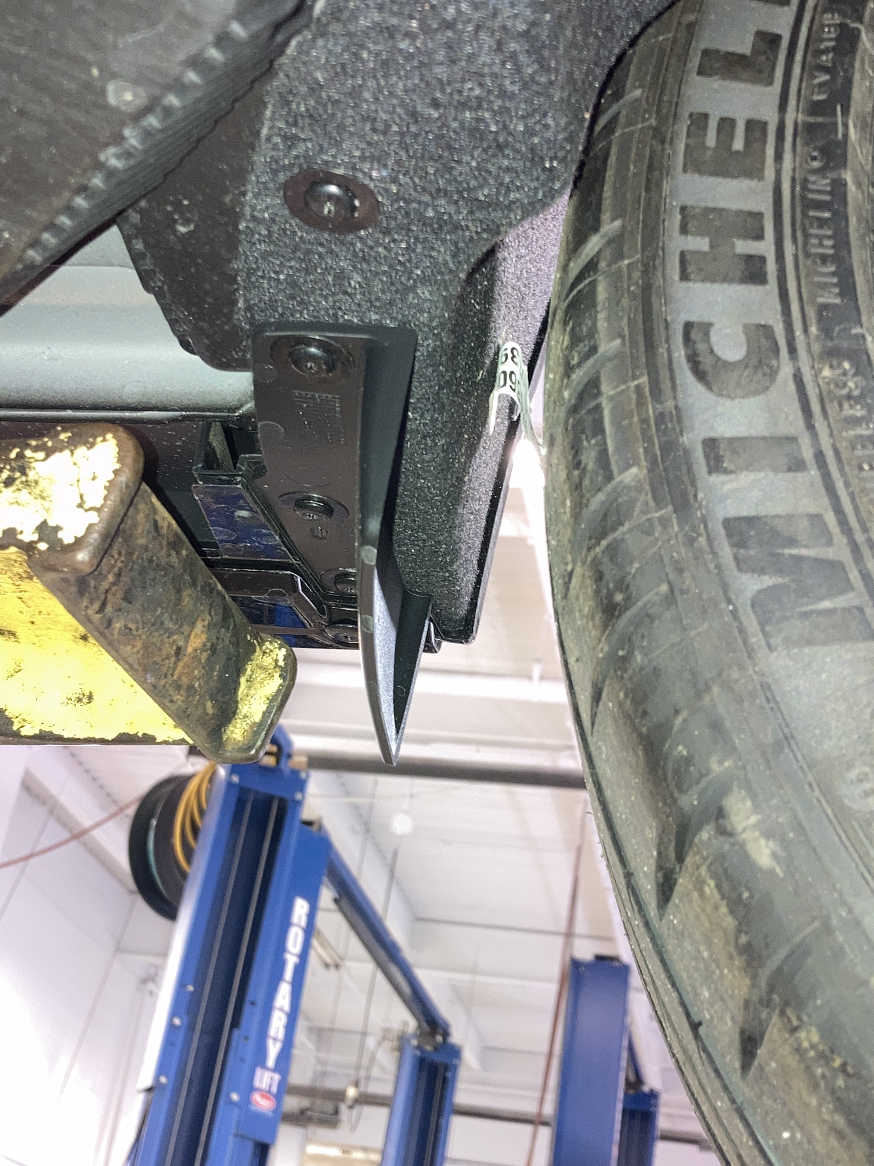

I’m pretty sure its called an air deflector. First pic us my car. Next pictures are anotger 2024 CT5 Blackwing right off the showroom floor to compare. Both cars are manual without Ceramic brakes.
The dealer thinks it was missed in the pdi.
Unfortunately that dealer is out of state. I contacted them and they can not find a part#. Neither can the dealer near me.
Does anyone know the part # for these?
I can’t just put screws in there without that piece since its only that felt like material lining the wheel well.
Any help would be appreciated. I’m calling GM tomorrow.

So, turns out BW5 with the CF1 option do not get the rear tire air deflector little plastic piece. Which would certainly explain the big goose egg when the dealer was punching in my vin#. My dealer ordered them anyway and sure enough they do not for due to the CF. We surmised the pdi guy out of state must have missed the screws that secure the inner wheel well liner, hopefully not the factory. Who knows. Either way huge thanks to Christian at Open Road Cadillac in Florham Park, NJ who is the service manager. They didn’t even sell me the car but drilled down to get the solution and the why.
