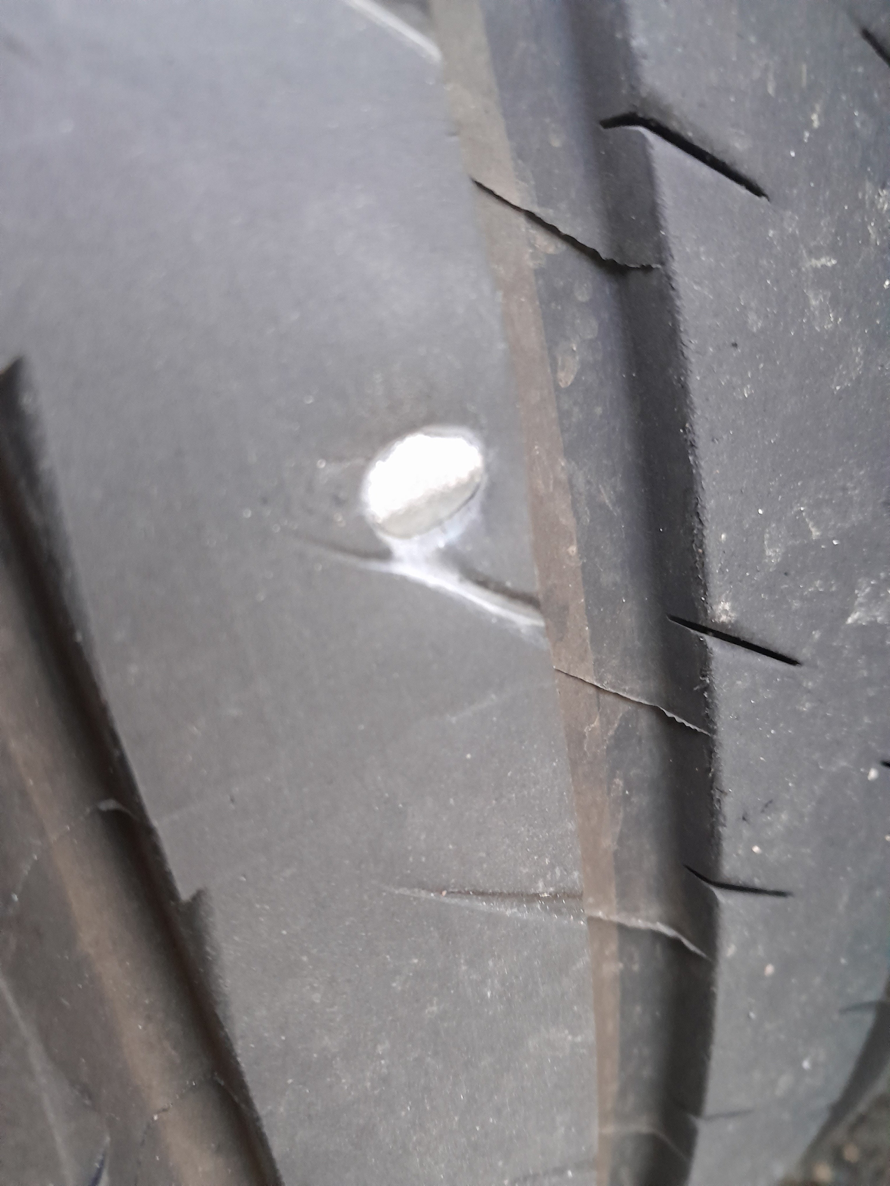

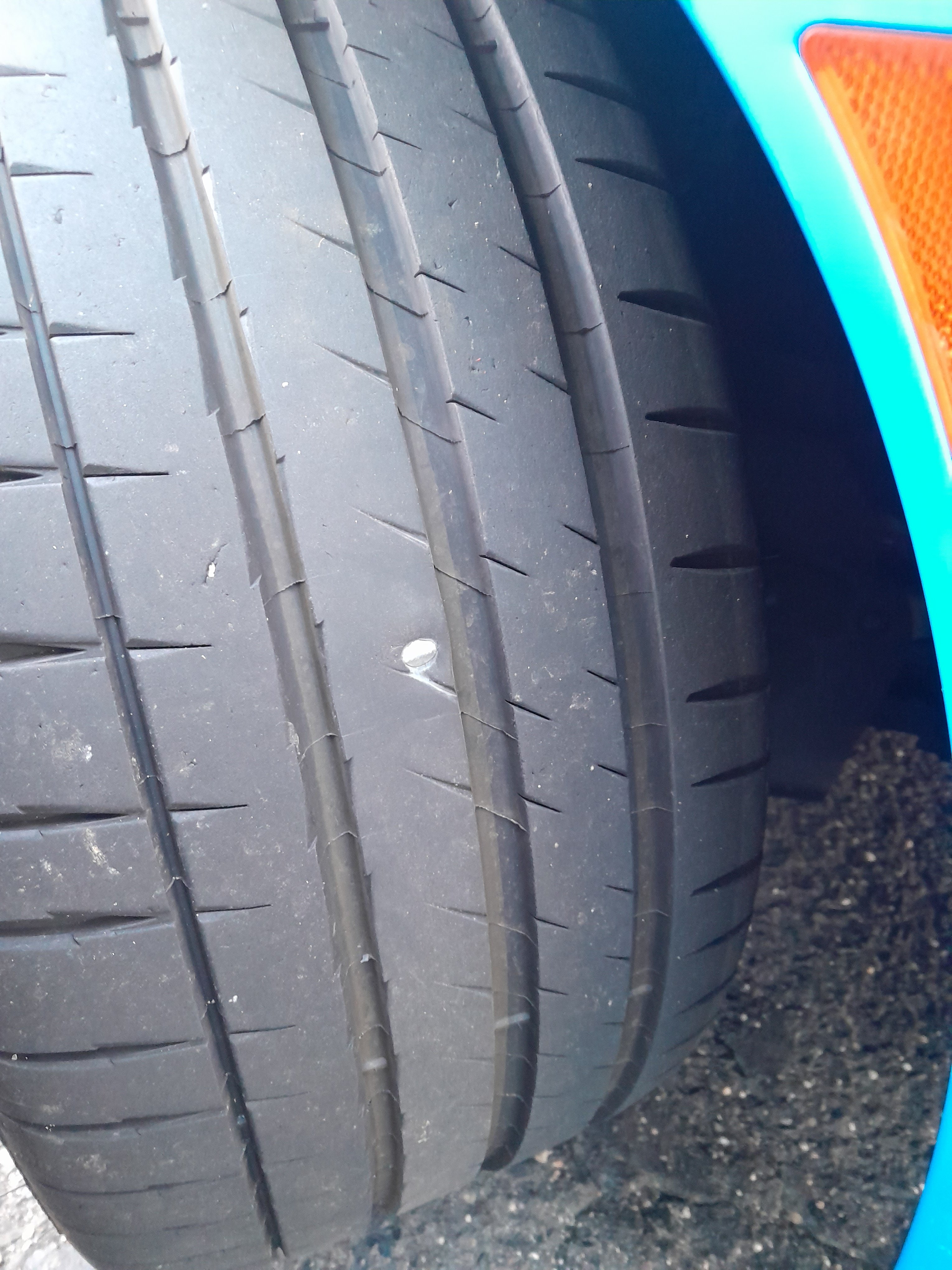

Friday night my car texted me that my tire pressure was low. Upon checking it, it was at 26psi but I couldn't see a nail or anything. The next morning I filled it back-up to 35psi. Then today it was down to 33. So I checked the tire again quickly and sure enough, a nice nail almost dead center.
So now the question is what to do about it. I plugged dozens of tires but I don't feel this is the right application for a simple plug. That leads me to patch or replace. At just over 400 a tire, I think replacing it is overkill and not necessary. I don't track the car or drive to Mexico, so a professionally installed patch should be fine, right? Years back I had a motorcycle tire patched because a new tire was unavailable in time(In the outer banks for a week) and the guy said just not to go like 100mph. I remembered that as I was doing like 120, oops.

I've had the pleasure of picking up two nails since I got my BW. I plugged them both and they're fine. (I would mildly disagree with your statement that "this [isn't] the right application for a simple plug". IMO, this is precisely the right application for a simple plug.)
These tires are such low treadwear rating that you'll end up replacing them soon enough anyway.
haha, yes I was just thinking that to myself. It's the exact application. What I guess I really meant was that an ultra high performance tire doesn't seem like it deserves a cheap quick plug.

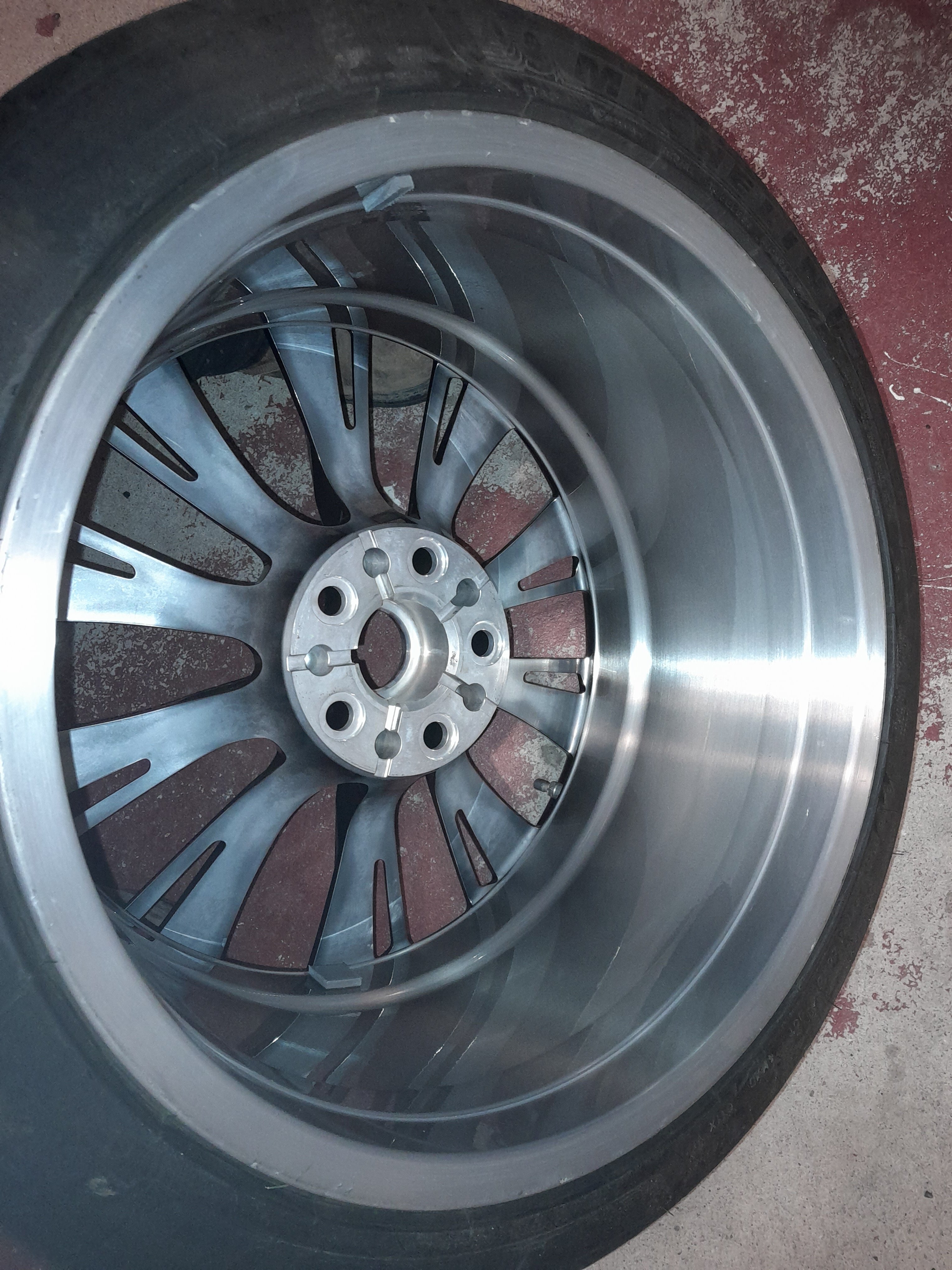

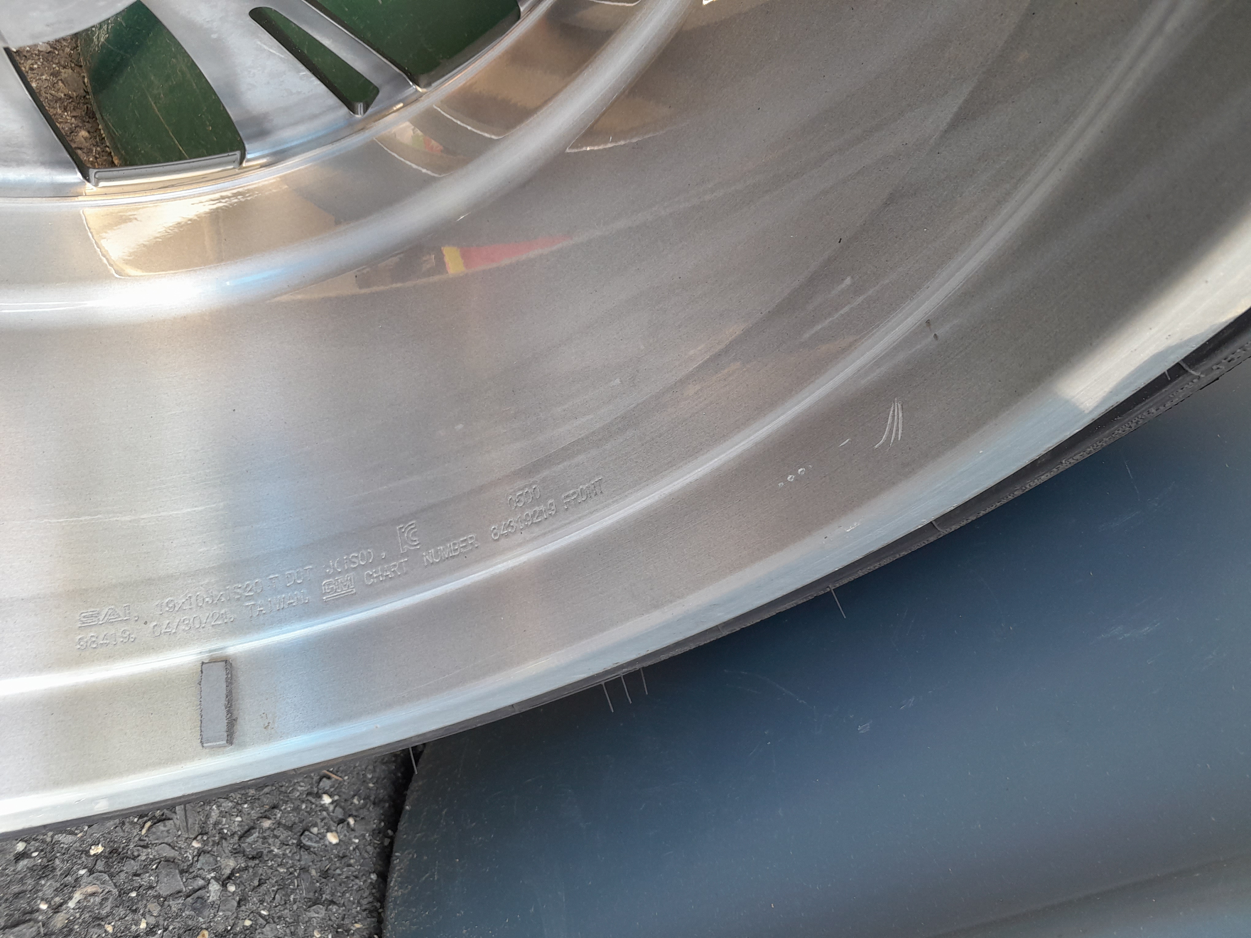

Had it patched today. The place also managed to lightly scratch 2 spokes, put wheel clamp makes on the inside barrel, not balance it when they said they did, and lost my oem valve stem cap. Oh and they had it filled to 43.5psi.
Needless to say the repair was then free. They offered to send the wheel out to have it refinished but I said no, because I feel it wouldn't match or age differently. So yea, not happy. Lesson learned once again about people who don't care touching my car or parts of it. I'm glad I didn't bring the whole car there. Now I have to still get the wheel balanced somewhere.

1st pic is last night, no clamp marks, 2nd pic is after the shop touched it.
