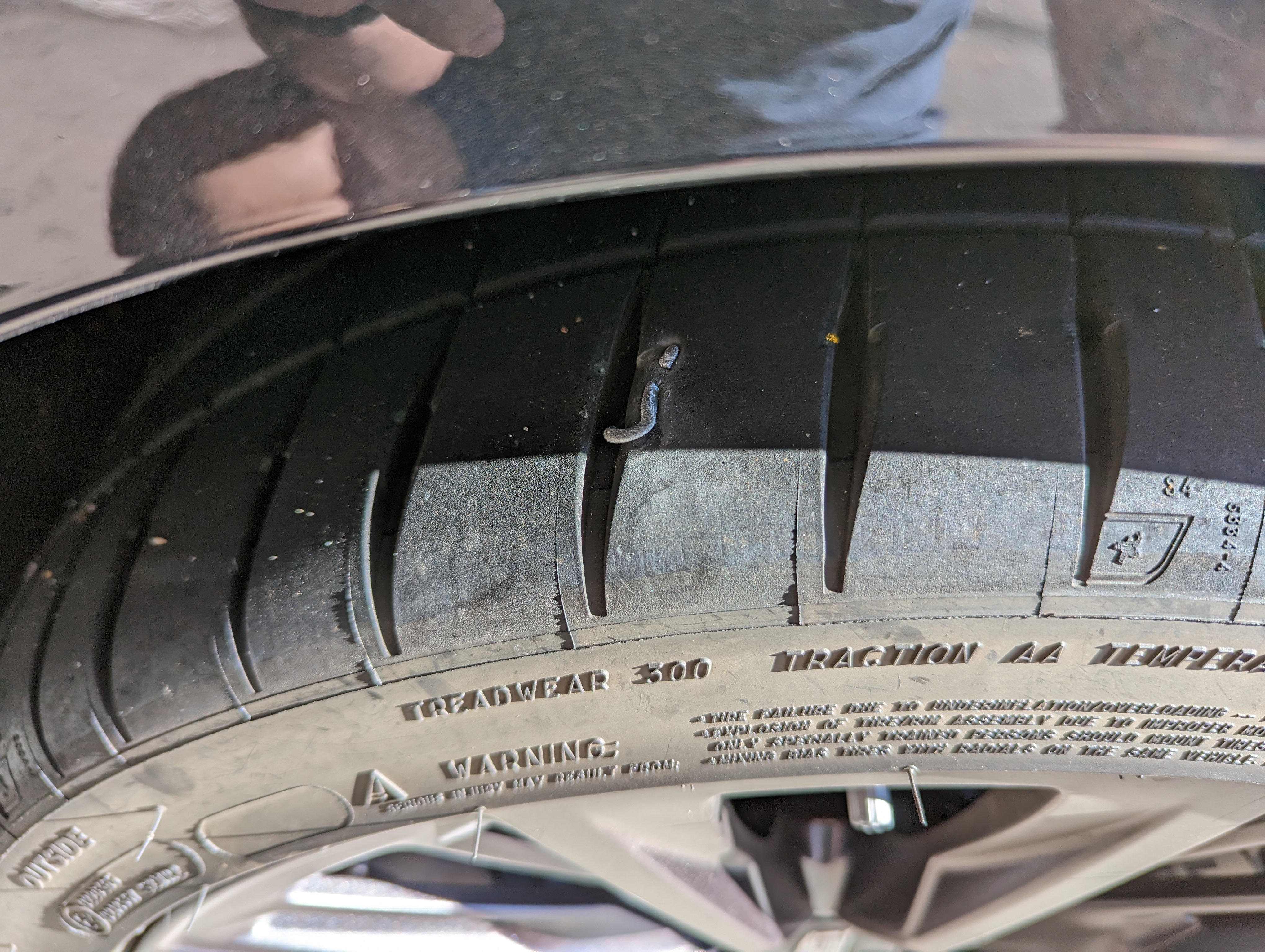

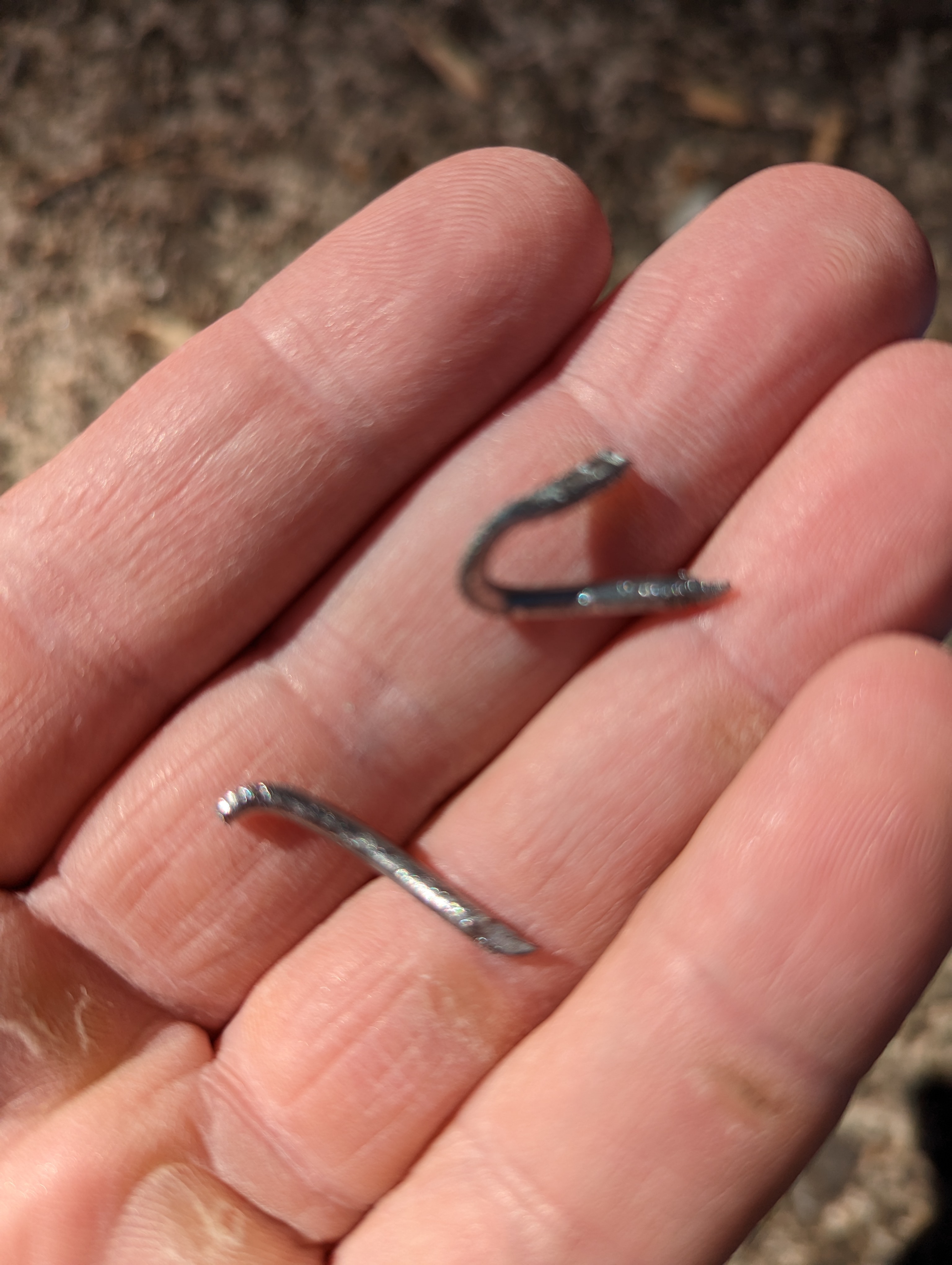

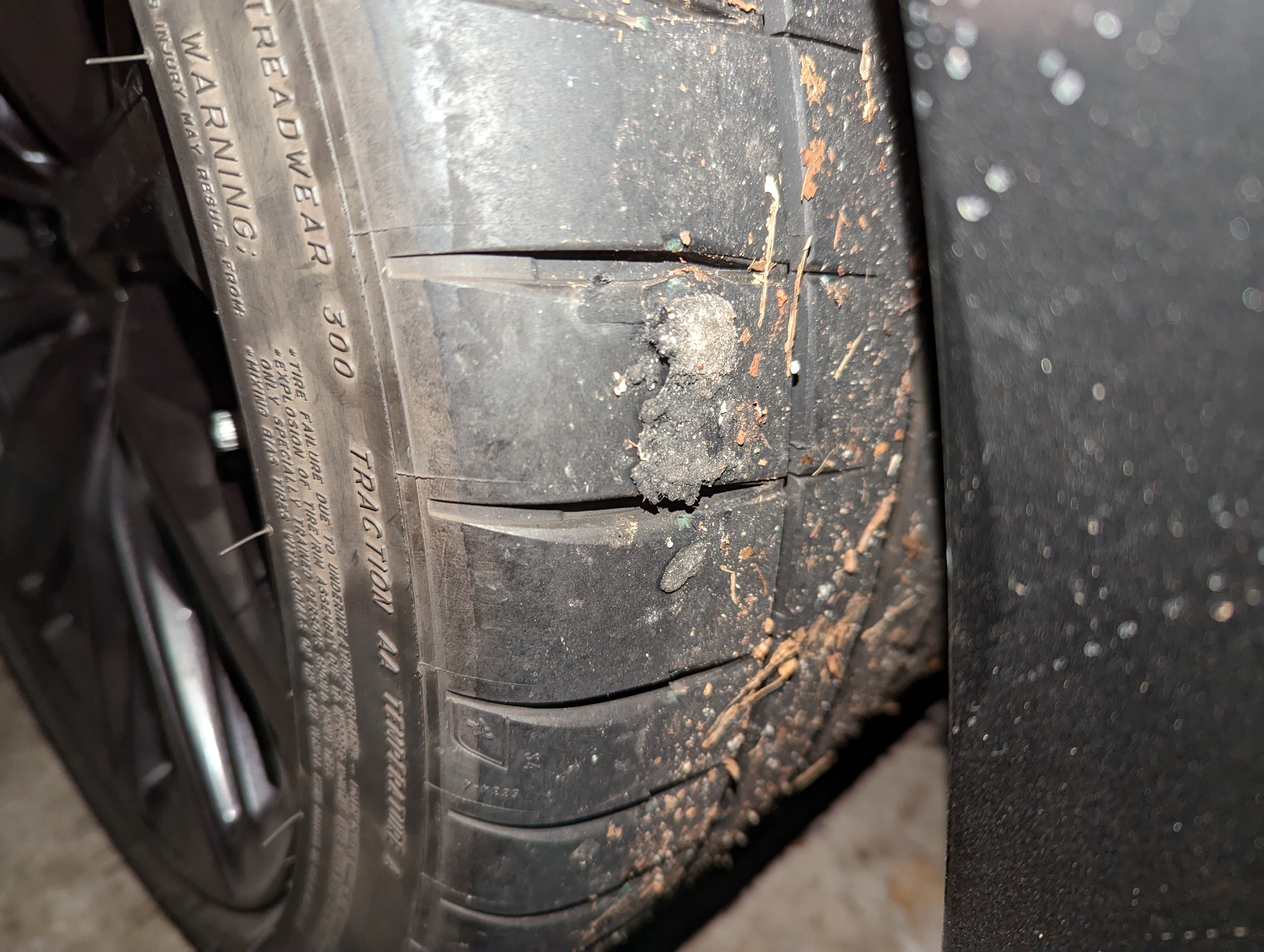

My unfortunate turn to contribute to this thread. Headed out for a drive yesterday, noticed the left rear was at 18 psi. Sh!t. Found this:
Not sure what to do longer term, but for now I took the wheel off, brought it to a friend's place, and we proceeded to plug the tire.

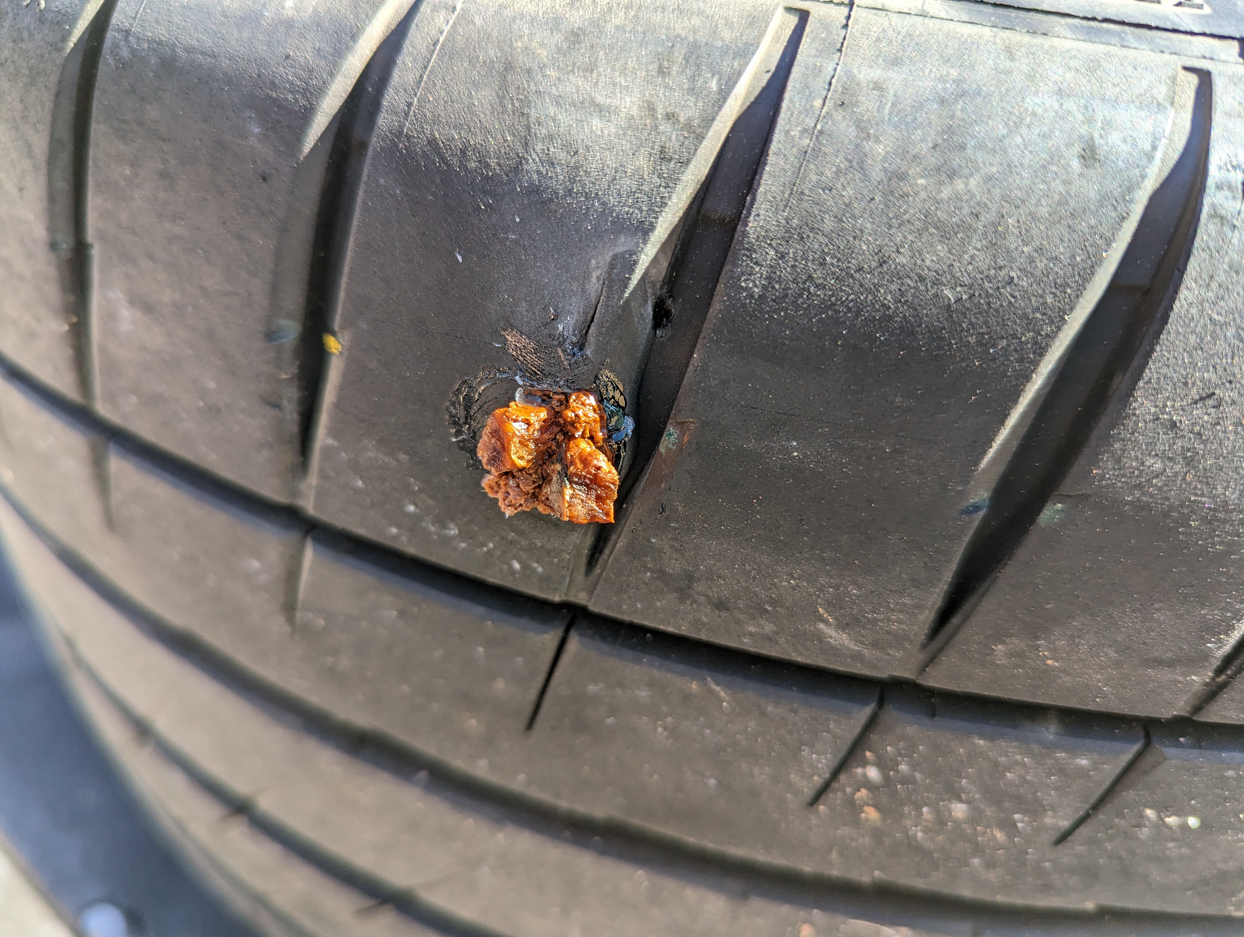

Which turned into this, after some driving.
Holding hair rather well at the moment, but I'll probably look to order some tires in the near future.
If it doesn't lose air in the next few days, I wouldn't worry about it at all for street use. (Went through the same on the original set last year and used a mushroom plug with no problem - other than getting through the tight cords in this particular tire.)
Shave the excess with a razor blade if its a lump still. Its usually best to do that right after you install.
So your experience with this unit has been fine? I've never used this type. I have an order with Modern Spare and they just sent an email that production has resumed for the 5BW. Its pricey though, $700 for the unit and Im rethinking carrying it in such a small trunk all the time. Better to plug and replaced if need be?
This was done, although maybe not to the degree you are recommending. I didn't show all the pictures, and my friend did the work. He's a car guy and he has done this before. He did trim the excess to a significant degree, this is what was left. It was his opinion, based on instructions and past experience, not to trim all the way down to the tire, but leave a little bit outside that will get melted & worn down. Just as you see pictured.
Still holding air, no issues at all, after two months. Recall, this was a plug, not an internal patch. Not shaved/trimmed all the way down, left a little bit exposed that would eventually get worn down.

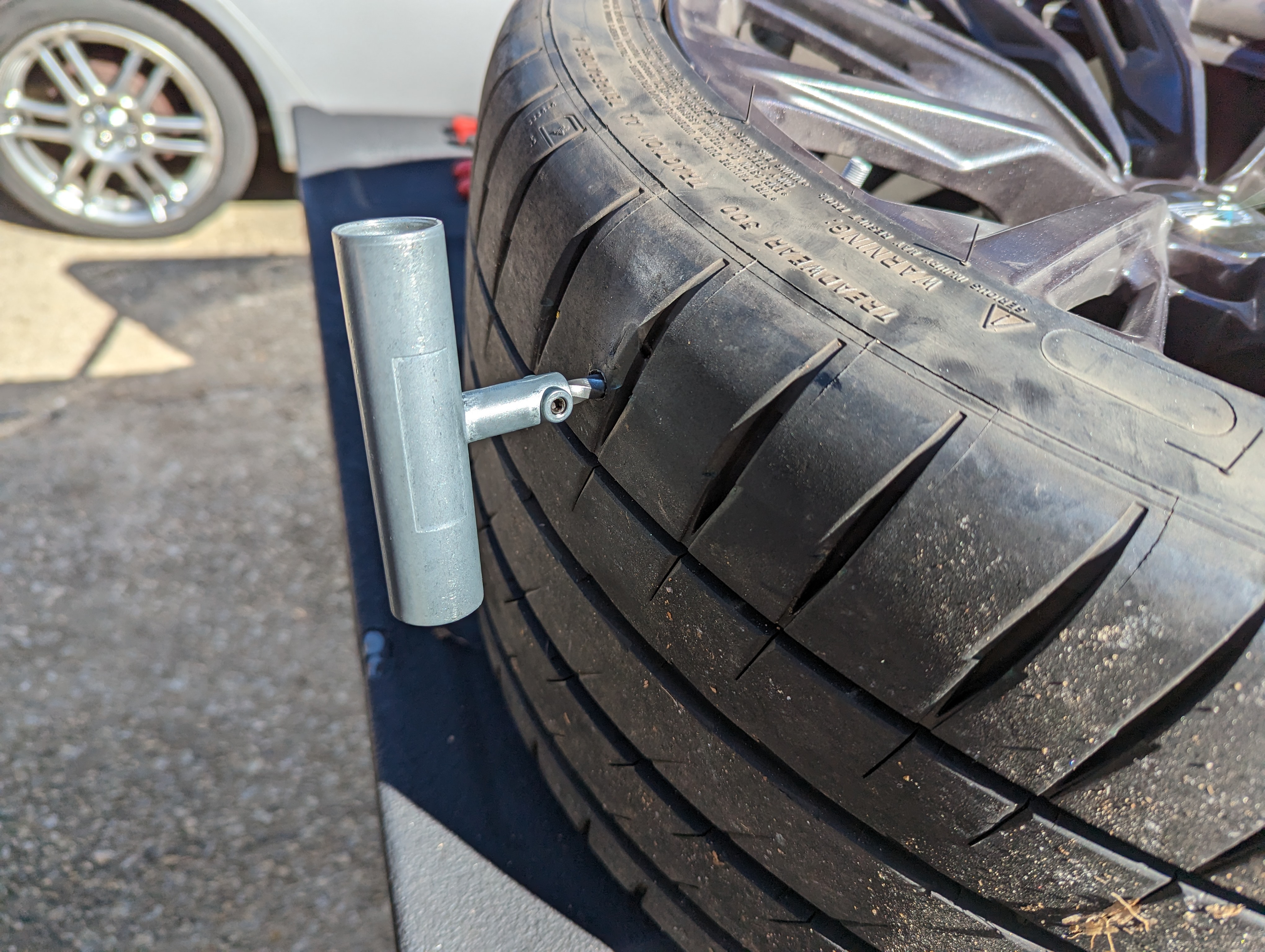

Just picked up my first screw as well. So annoying when you only have 2000 miles on a car and new tires. Anyway, plugged it up with my trusty Tire Plugger, holding air for 2 weeks now so I think I was able to get a nice seal.
Had that same mushroom kit until I had to plug a Summer performance run flat. Destroyed the gun trying to insert the plug. Found a more robust version on Amazon that hopefully will last longer.
