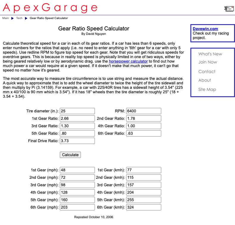

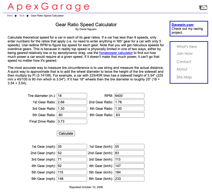

Max speed per gear with the 6mt. Anyone have that info?
Looks like 47-49mph in 1st, 70mph in 2nd. Longish gears to hit the 189 top speed.
I'm a few hundred pages into the manual and feel I should have seen it by now....
Can't be right. I shifted at 6500 or so and saw 47ish in 1st, 70ish in 2nd. The speedo can't be that off at such low speeds.
