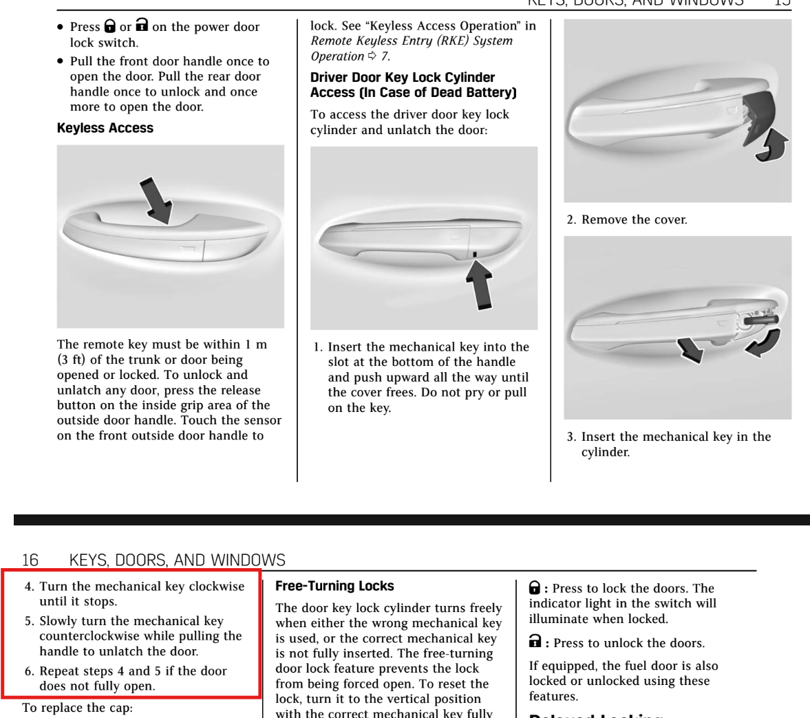

So, quite the problem I have here. I was going to hook up a battery tender to my brand new BW thats in storage... well, turns out the battery is already completely dead and the only other physical way to open the car... drivers side manual key, is not working. key turns fine, you can hear the mechanism actuating but it doesnt unlatch the door.

Sadly this is an area where the 4 is better than the 5. The 4 retains the mechanical door locks so if you lose power you can still open the door.
