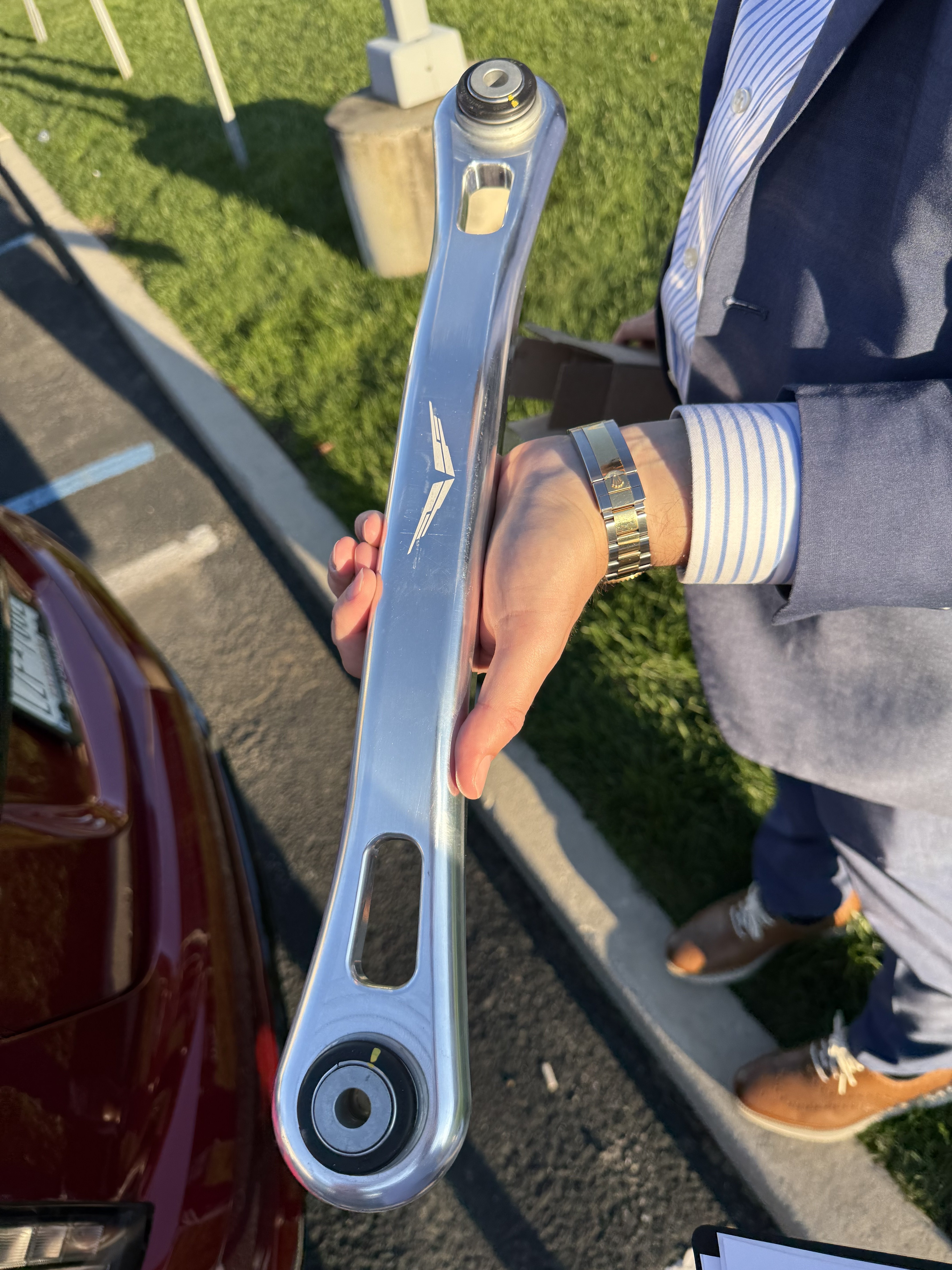

Hello fellas. Just picked up my CT5V Blackwing tonight. 2026 with precision package. In the trunk of the car in 2 sealed boxes were 2 of these silver pieces. I think they are rear toe links? Anyone know for sure what these are and why they would not be installed? Is this something track specific or did the dealer forget to install?

Track specific toe links - only needed for getting aggressive with the camber. As you drive faster, camber will become very important.
I would argue otherwise, the toe links are a big improvement over the al dente noodles on base models regardless of use. They are a dealer installed item that is supposed to be done at PDR and I would strongly recommend you have that done.
Do they need to do an alignment after?
We've found that most Blackwings aren't aligned correctly from the factory - so I'd strongly suggest having the alignment checked and adjusted to spec with or without the toe link swap done. :)
