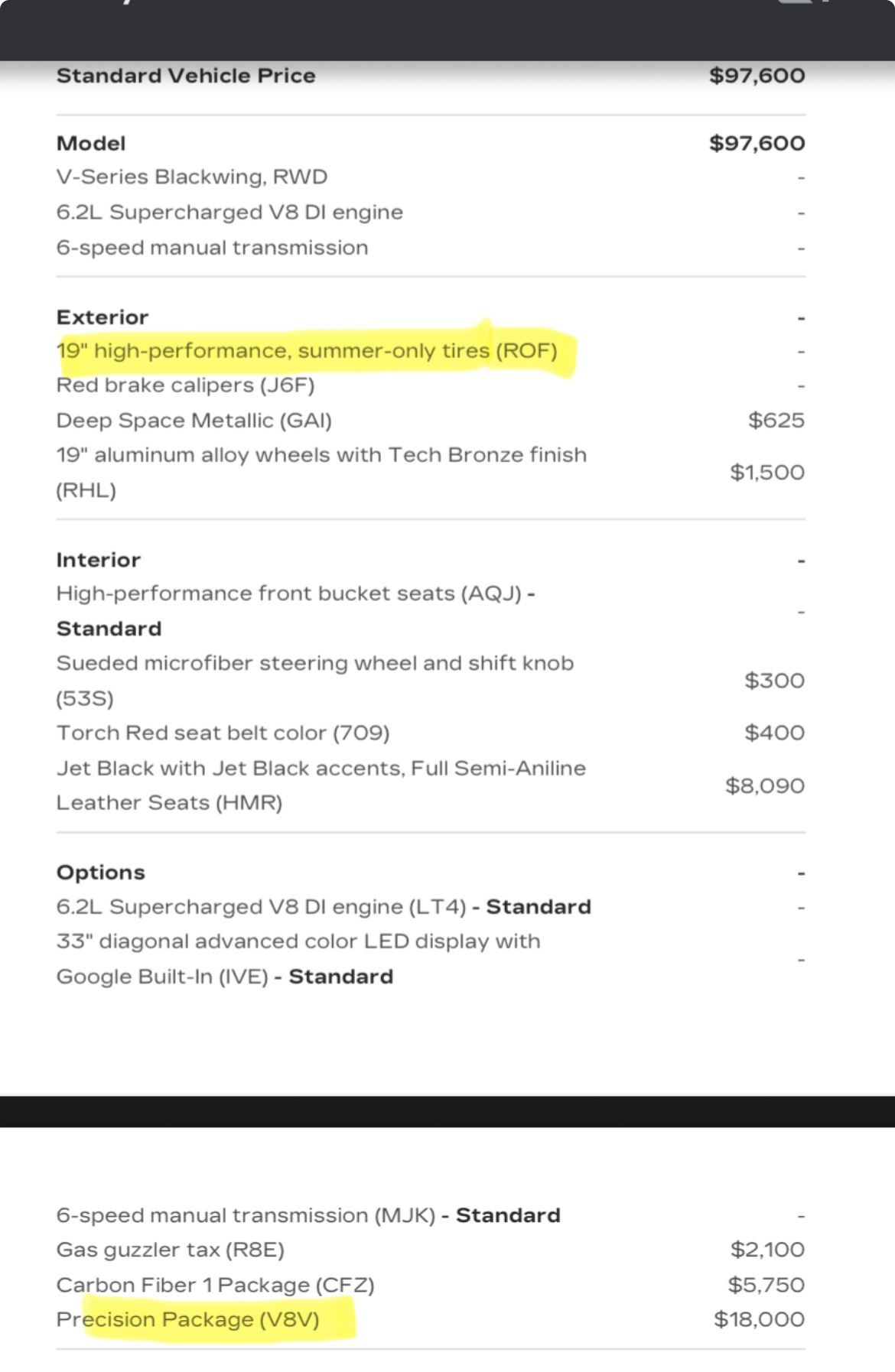

You can definitely order 4S with V8V option. On your order worksheet, it should say:
ROF Tires, 19" Foam front, Summer Only
If the dealership did not add that even when you asked, then that is on them.
Just checked mine and that's exactly what it had on the worksheet (y)
It’s how I ordered mine. If you can prove you ordered it correctly they owe you some PS4S. They can “work with you” on giving you a discount on a second set of wheels to mount the PS4s to.

Just to weigh in, I'm another 2025 5BW precision package owner who ordered PS4S. When I used the configurator to pick options, first I selected the precision package, then I selected "summer only" tires. At the time my order was accepted by the factory (August, 2025) this was the only path to ordering the precision package as cup 2 R tires were basically unobtainium. But even if the the track tires were available I still would have opted for the PS4S because (a) I don't plan on tracking the car much and (b) what kind of shape would they be in at the end of the 1500 mile breakin?
