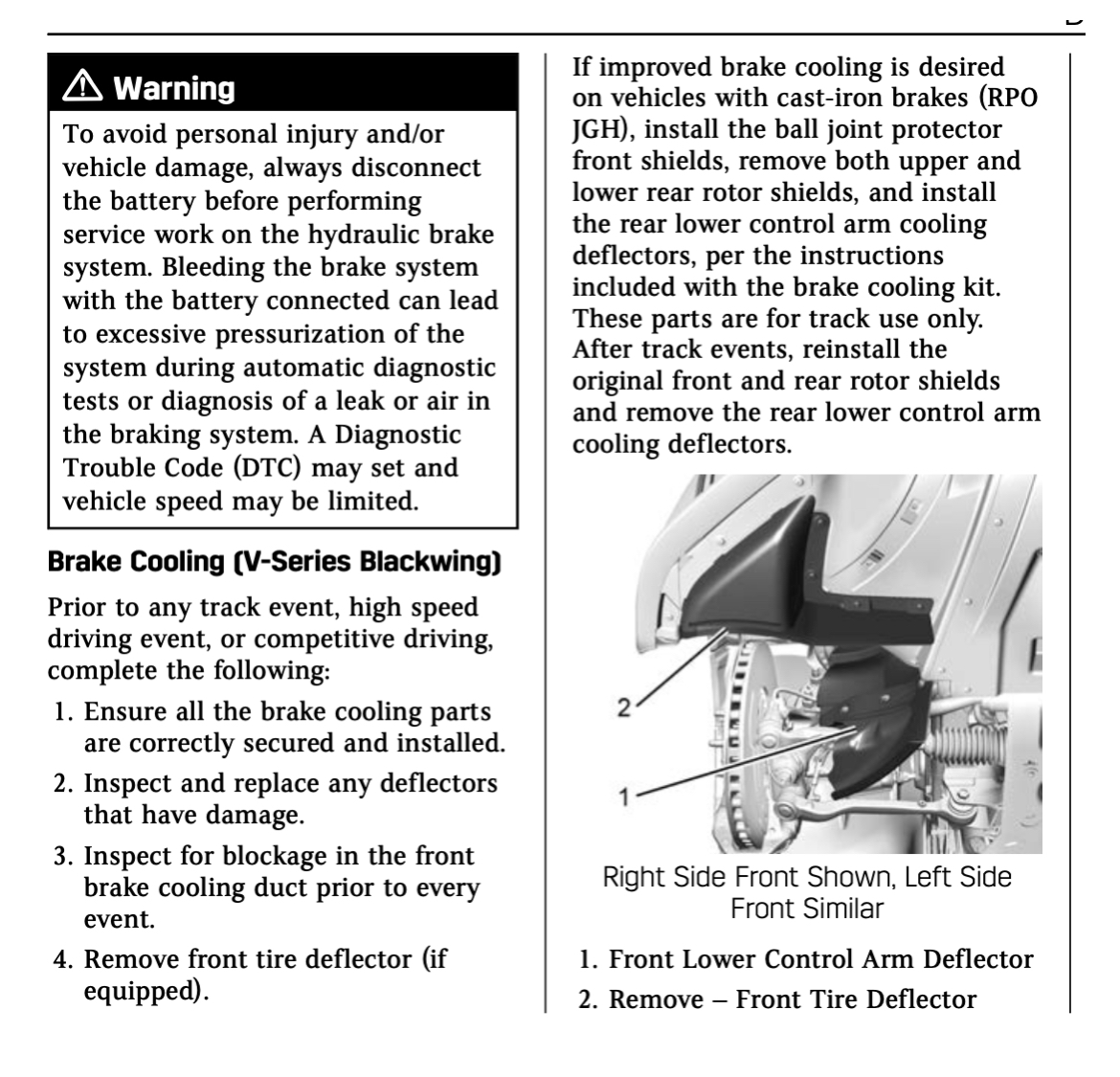

Does anyone know if the 5BW with the carbon ceramic brakes comes with the rear brake ducts and the front bumper dams that you install before track use? I know that there should be brake ducts in the trunk on delivery, but my 5BW did not have them. The owners manual for installing the ducts is a little confusing and comments on different instructions for the iron vs ceramic options.
Please let me know if anyone with the ceramic brakes had the brake ducts on their delivery.
There is nothing to do except remove the front tire deflectors that the dealer would usually leave in the trunk.
Did you check and see it your selling dealer installed them? If they did install you should consider removing them for street use.
