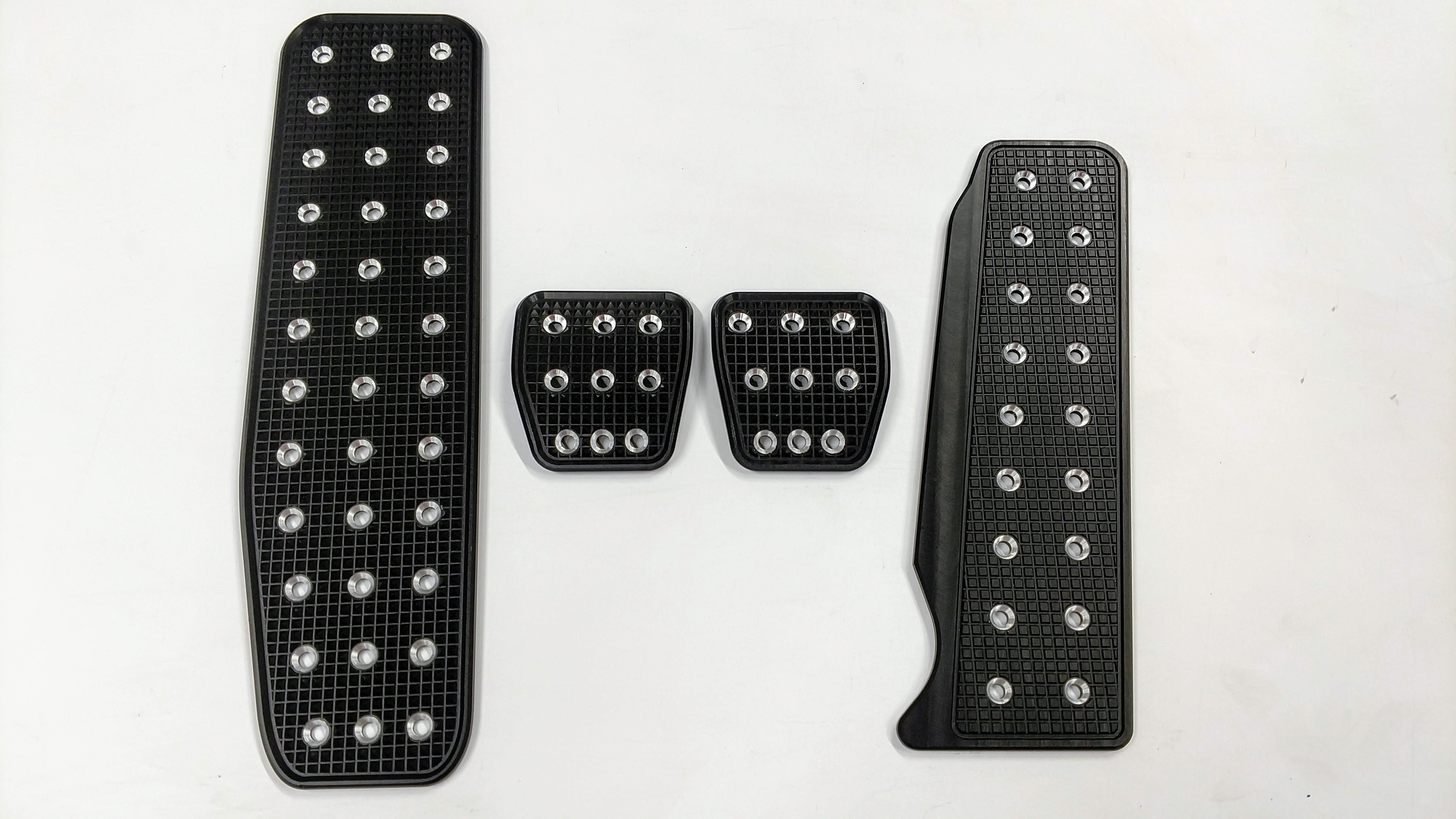

UPDATE: Finally got the SRP throttle pedal installed this morning and took it for a quick drive. 100% fixed the heel and toe issues for me - now I can do it just as easily as in any other car. The pedal is at least 1/2" wider towards the brake pedal. Plus with the minor added thickness of the aluminum pedal that is screwed into the original pedal it has made the whole blipping trouble-free. My foot no longer has to be so far over than the heel rubs the tunnel.
Anyway, I highly recommend doing this if you are having the same issue! Install takes 10-15 minutes - just drill some small holes and screw in the self-tapping screws.

Here are the pedals. I got the pedal in diamond and wide throttle pedal.
They look a little slippery. Are they slippery?
