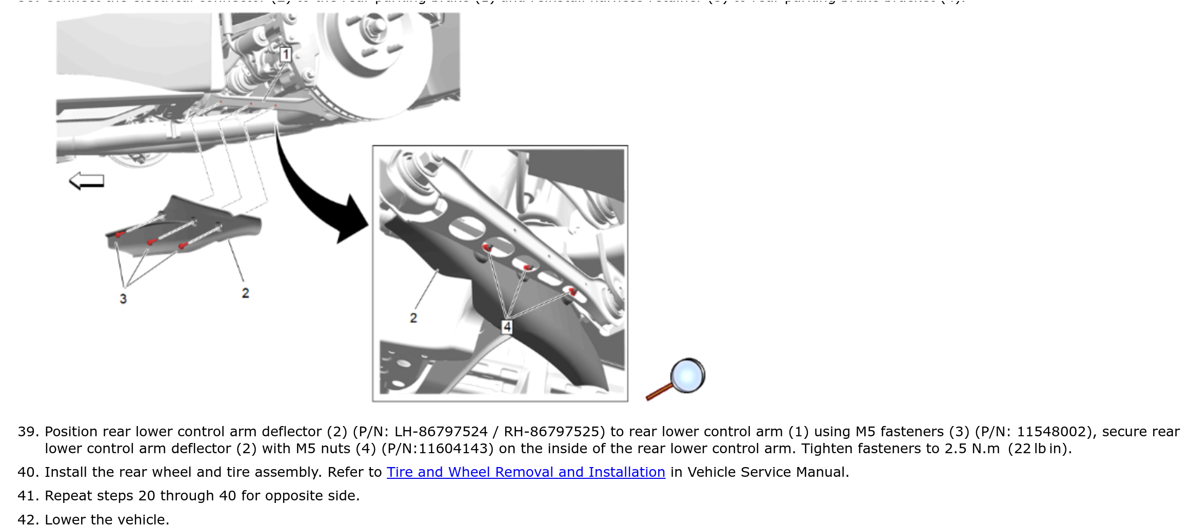

Can someone make a list of all of the extra Blackwing parts that was supposed to come with a non-CCB car. I want to see if I can order them all as extras I’m not sure if they are on my car.
Rear
Rear Deflectors 86797524 (L), 86797525 (R)
6 Hex Fasteners 11548002
6 Nuts 11604143

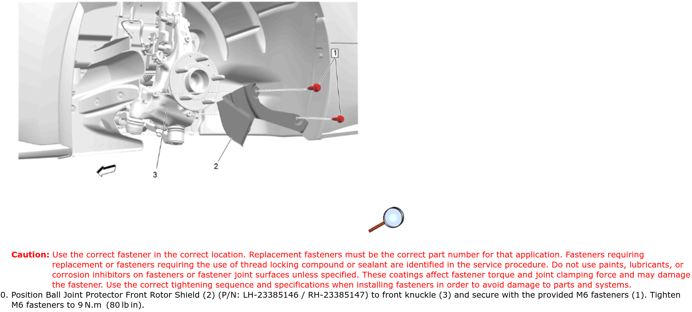

Ball Joint Protector Front Rotor Shield (2) (P/N: LH-23385146 / RH-23385147)

Take the rotor shields off, and put new ones one the front. Put the brake deflectors on the rear. That's it for the steel brake track brake cooling kit.

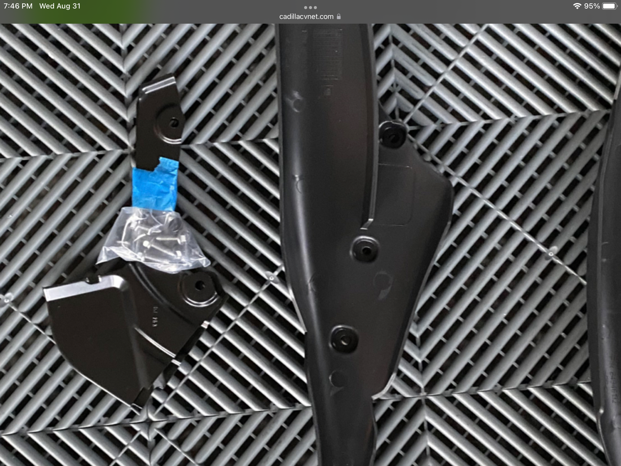

Oh ok. All I had in my trunk was the two steel pieces. The ones with the tape around them in the photo attached. That said, I believe they put all other parts on. What do the rears look like.

For the rear, you just take the rotor shields off, and put the plastic air deflectors on. There isn't an alternate rotor shield like the front. What is also confusing is, is that the front also has the air deflector installed at the factory, but the rotor shields need to be swapped out. I don't think the owners manual is very clear on this, (maybe if you read it 20 times) but the factory service manual makes it quite clear.
All the part numbers are contained in the attachment, but you have to dig a little.

The left side is the Ball Joint Protector Front Rotor Shield (should be one for each side). I cannot remember for sure if CCB cars are supposed to have these installed for track use but I DO think so. The original shield is to be removed, and these installed so that the front air deflectors have a path to send the air to the rotors.
The other plastic pieces are the rear lower control arm deflectors. I know for sure that CCB cars do not need these, as posted by Mirza. These are for steel brake cars only as they need the additional cooling. Again, this is for steel brake cars only.View attachment 12283View attachment 12284
Thanks @Daijoubu. I assume these are supplied with every 5BW, even those without CCB? I don't have CCB, and found these in my trunk - was not quite sure what to do with them. Should they be installed and left on for normal driving? Or only for track? Seems like a lot of work to install and remove for each track session. Thx!
