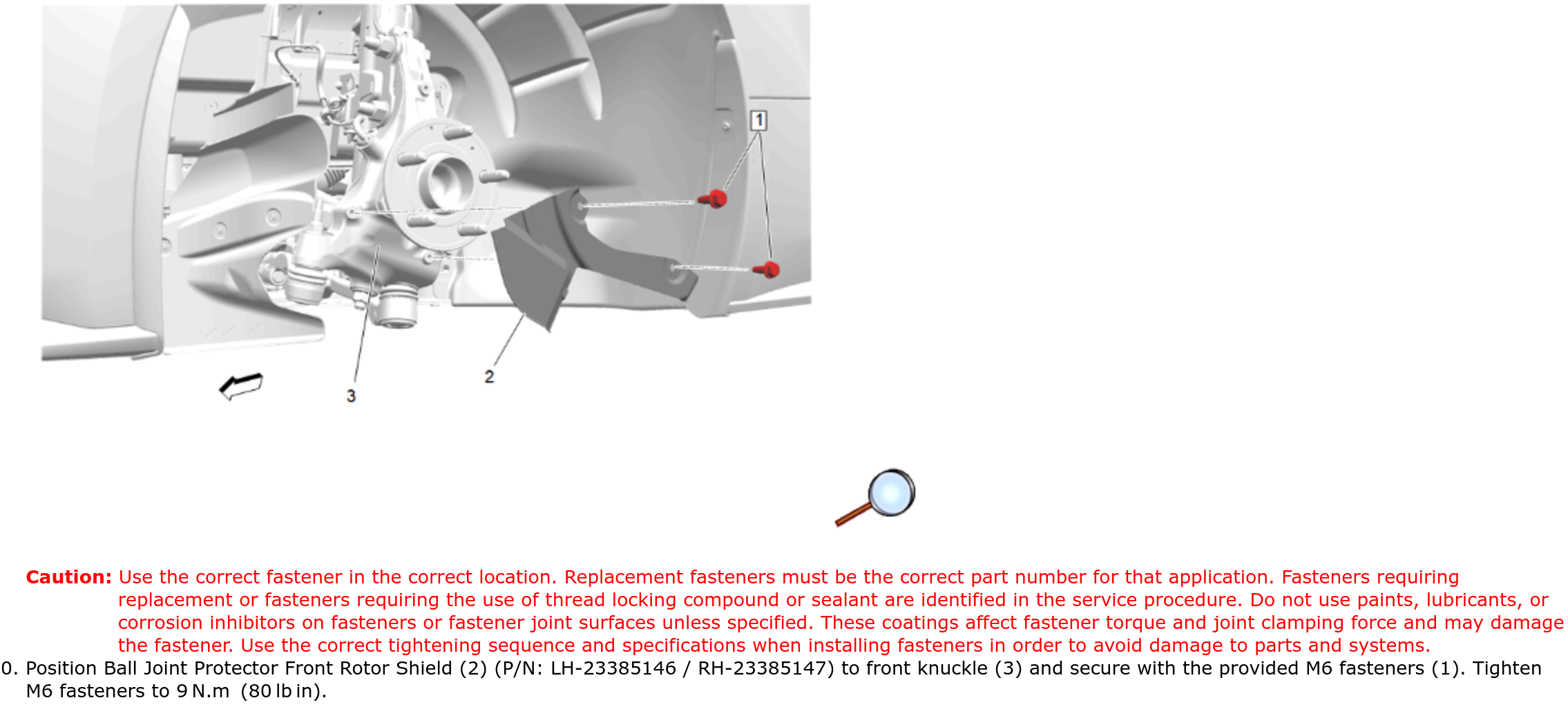

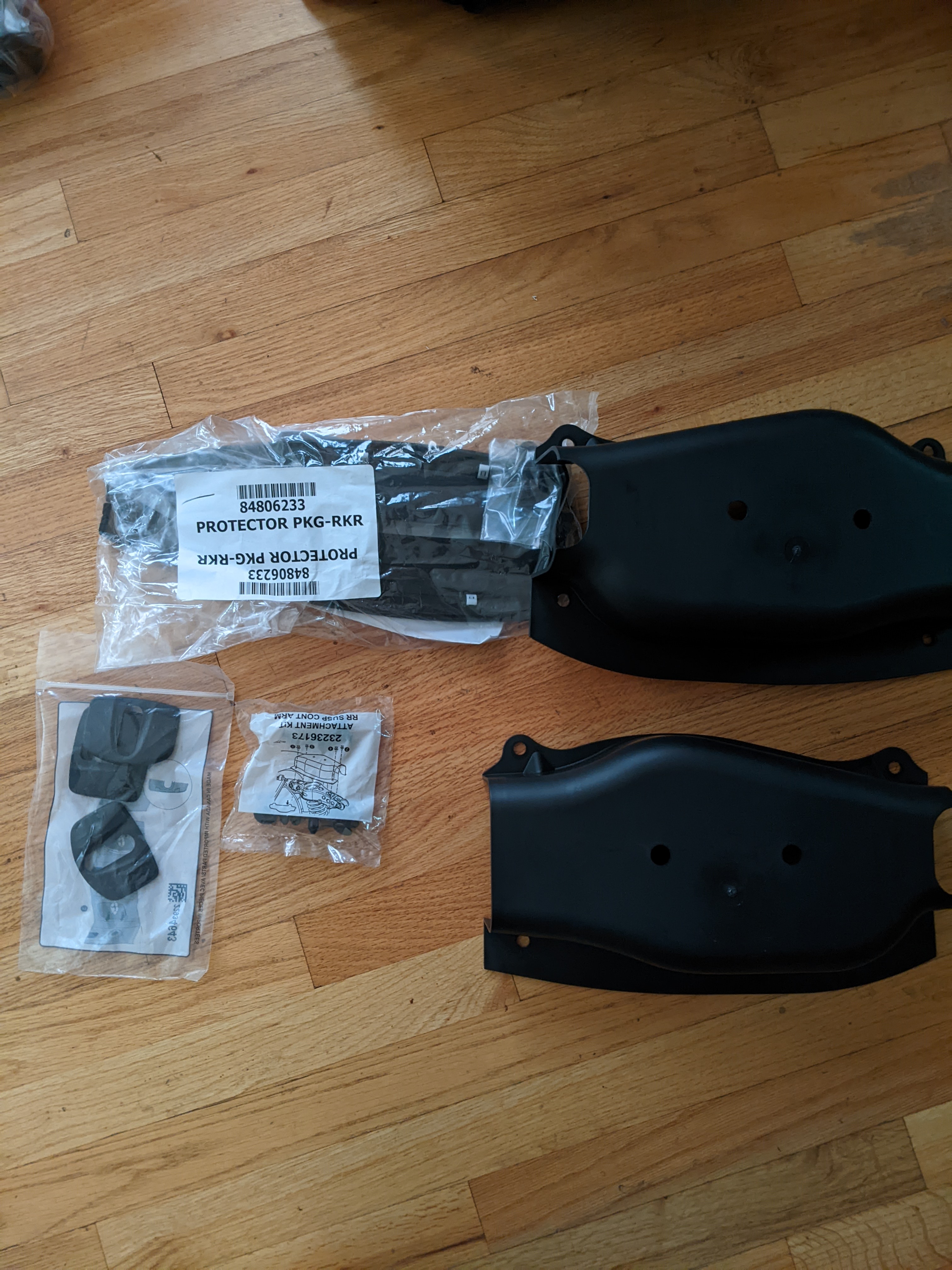

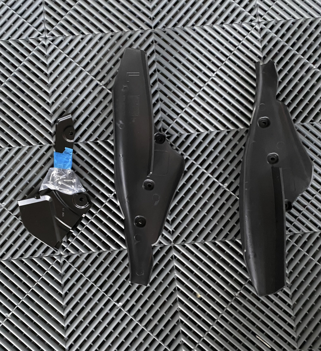

I don’t have either of these parts kitted. I have CCBs. I have not checked to see if they’re installed because I’m not sure where they go.
The left side is the Ball Joint Protector Front Rotor Shield (should be one for each side). I cannot remember for sure if CCB cars are supposed to have these installed for track use but I DO think so. The original shield is to be removed, and these installed so that the front air deflectors have a path to send the air to the rotors.

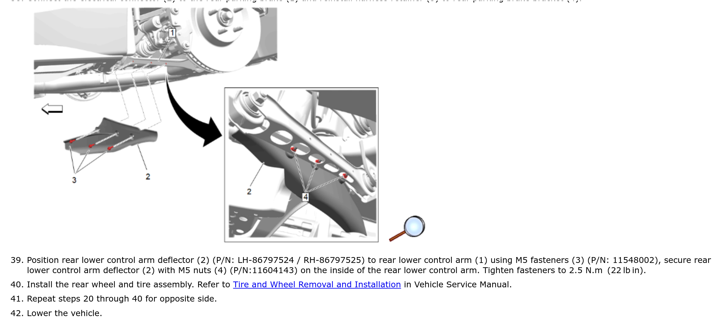

The other plastic pieces are the rear lower control arm deflectors. I know for sure that CCB cars do not need these, as posted by Mirza. These are for steel brake cars only as they need the additional cooling. Again, this is for steel brake cars only.
The other plastic pieces are the rear lower control arm deflectors. I know for sure that CCB cars do not need these, as posted by Mirza. These are for steel brake cars only as they need the additional cooling. Again, this is for steel brake cars only.View attachment 12283View attachment 12284
Thank you, that was very helpful.

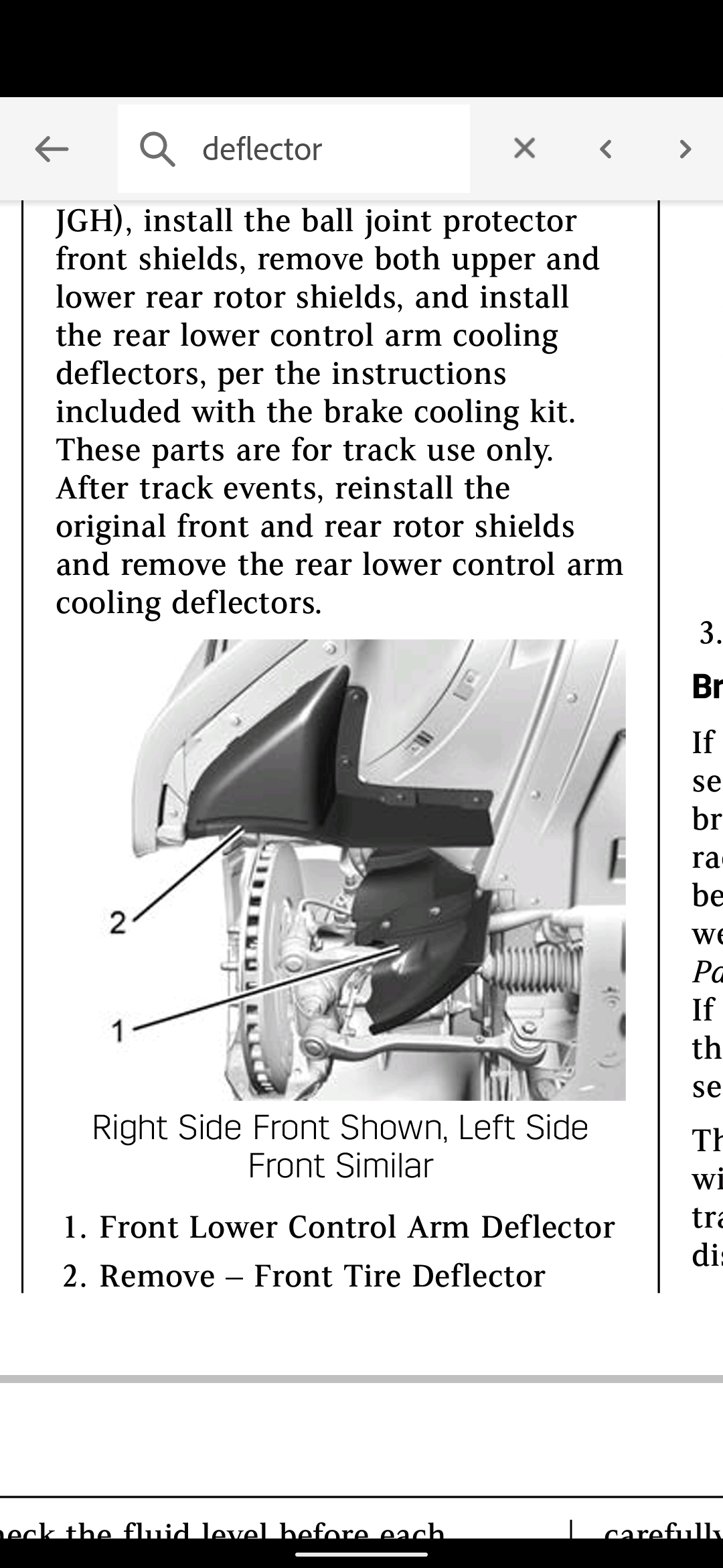

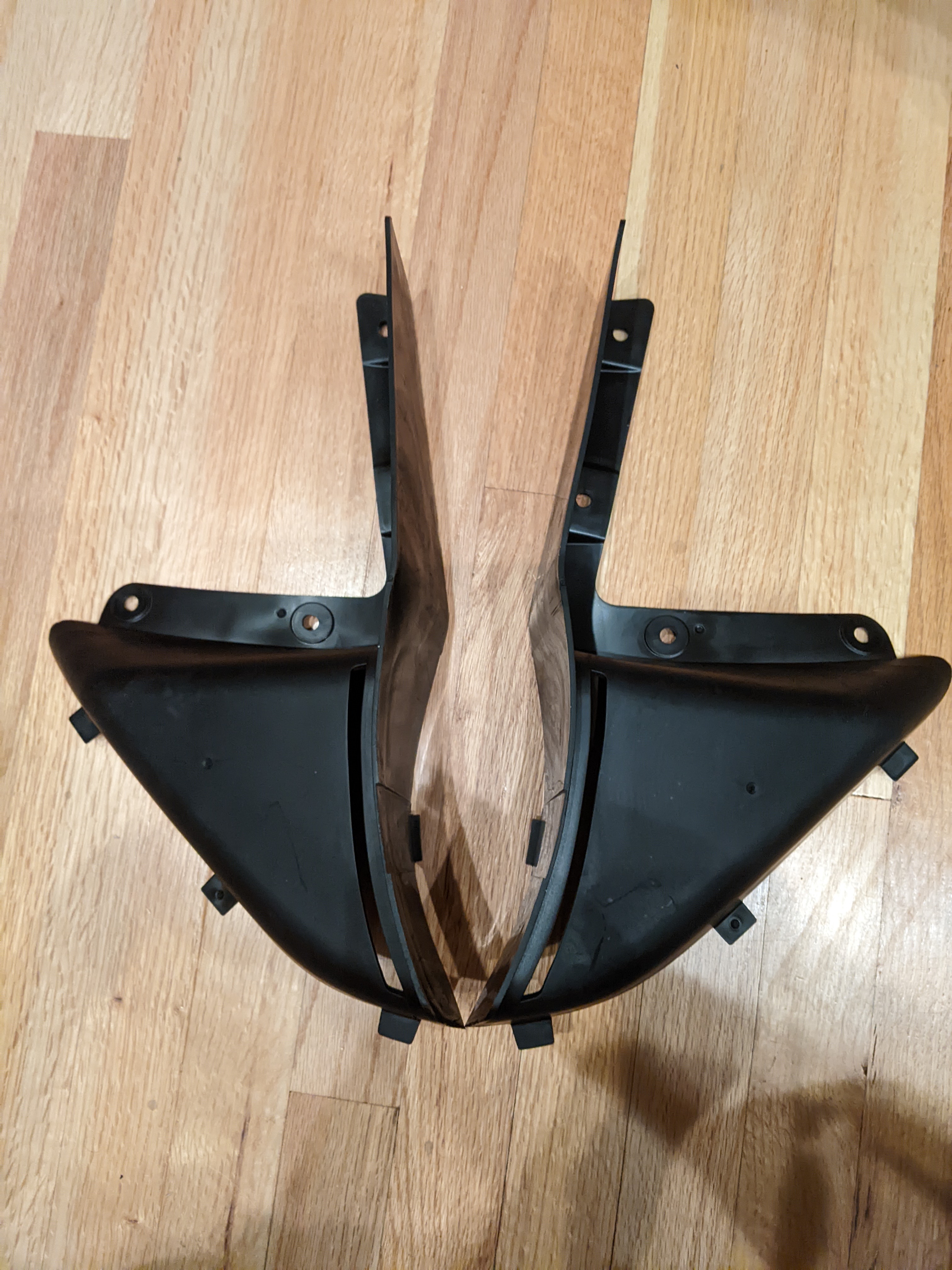

Did you ever figure out what these are and if they’re supposed to be installed for street? Mine came in a large plastic bag with no instructions.
yes they need to be installed..front tire deflectors..they go directly behind the splitter #2 on the image below.
yes they need to be installed..front wheel deflectors..they go directly behind the splitter

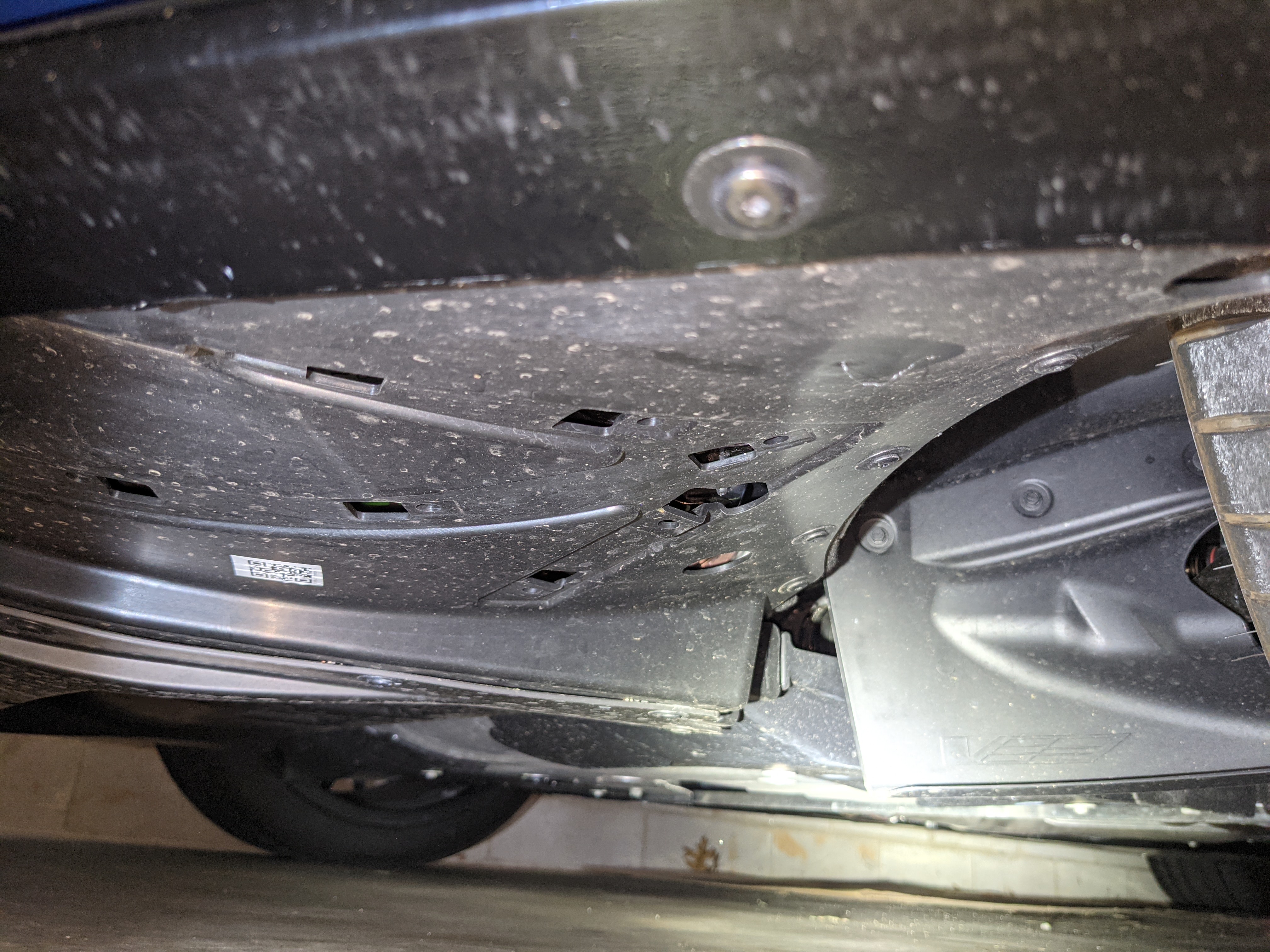

Do we know if EVERY car is supposed to have these? Is it part of CF1, CF2, or CCB? I have none of those, and my car doesn't have these. You can kind of see the general outline of where these go, as well as the holes for the fasteners. They are supposed to be removed for track use, so there's that.

As per my dealer parts dept CF and non-CF cars have them. I have them on with my CF front splitter.

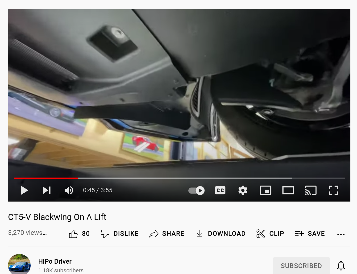

Interestingly, from @poor-sha 's video under the 5BW. He has additional strakes installed that I don't have, and it doesn't look like these front tire deflectors. This is a CF and CCB car. I wonder if those strakes are part of the CCBs to direct debris away from them while leaving a channel of air to hit the brake deflector.

I can't tell what the strakes look like or if it is hidden by the tire deflectors on my car..will check my car...it's at the dealer now.
