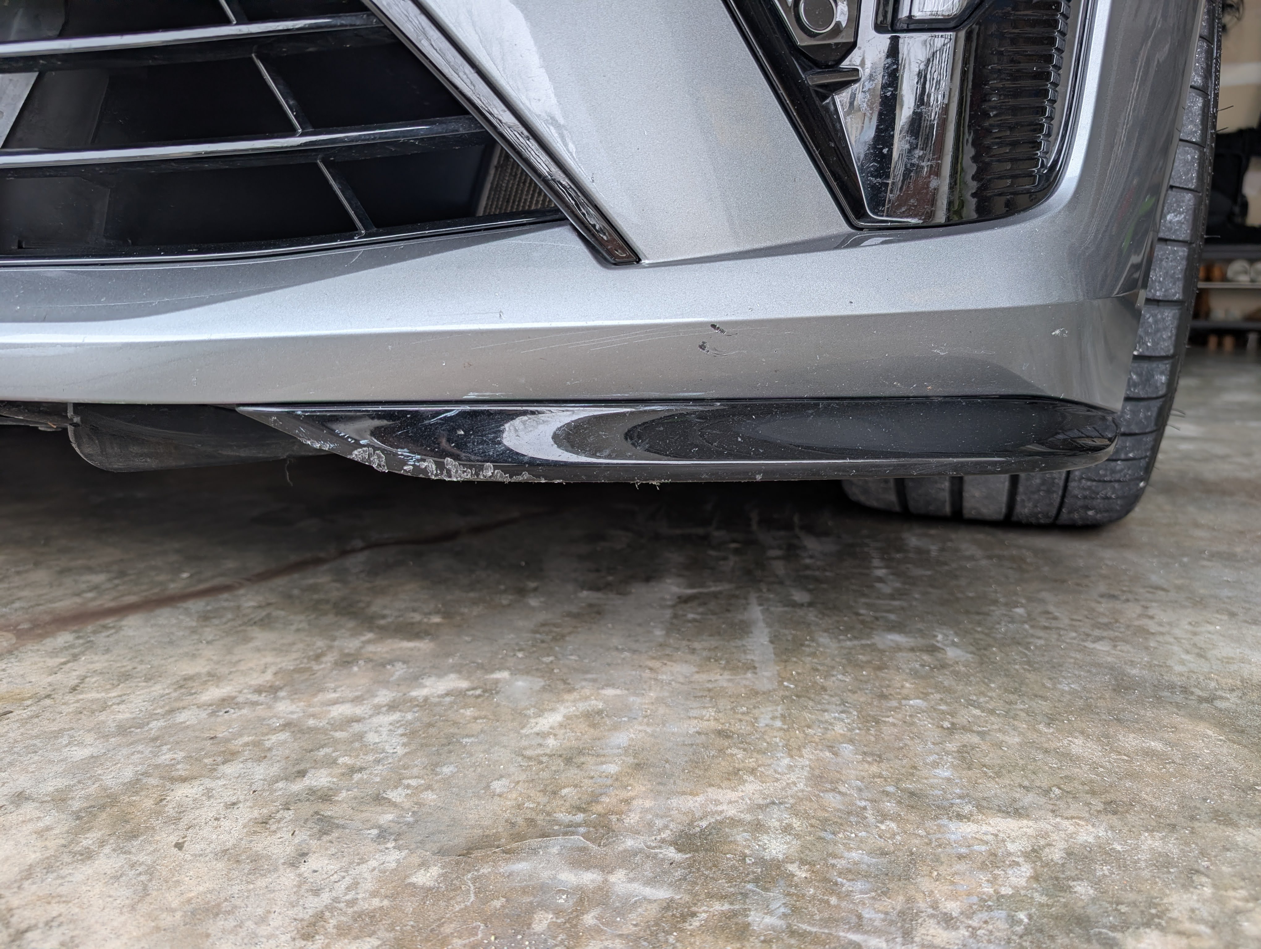

I have a non CF Blackwing and recently came across a steeper expected road curb / sidewalk and scratched up the gloss black piece on the passenger side edge of the front bumper. I have searched online for a new part but I am unable to locate it exactly. Does anyone either know the technical name for that or have a part number to properly search? With this being the first part to with clearance issues for park curbs as well I assume it will be a common replacement.

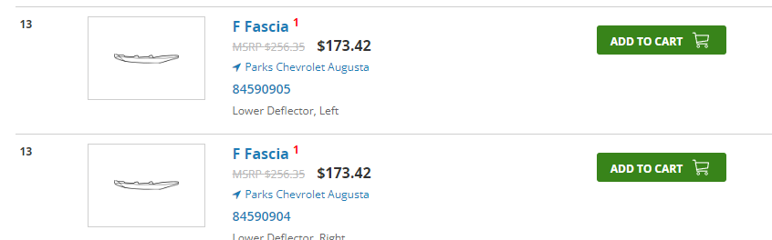

Go to any of the online parts sites. Put in your year and body style. Then select Body, then
Bumper and Components - Front. It's number 13. Or you can just type in these part numbers:
There is a $75 core charge, and they probably will be primer surfaced and need painting. The plastic rocker molding did. If it's just scratched/scuffed you'd be better off having a body shop fix it and paint it.

Thanks for the look up, I saw that exploded view on one site but that part number they had listed was for something on the rear. I agree though I would probably be better off having someone repair it for that cost of new. I believe it is just 2 bolts in the bottom and it comes right off.

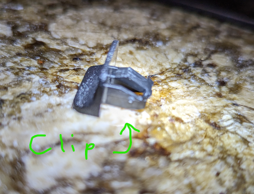

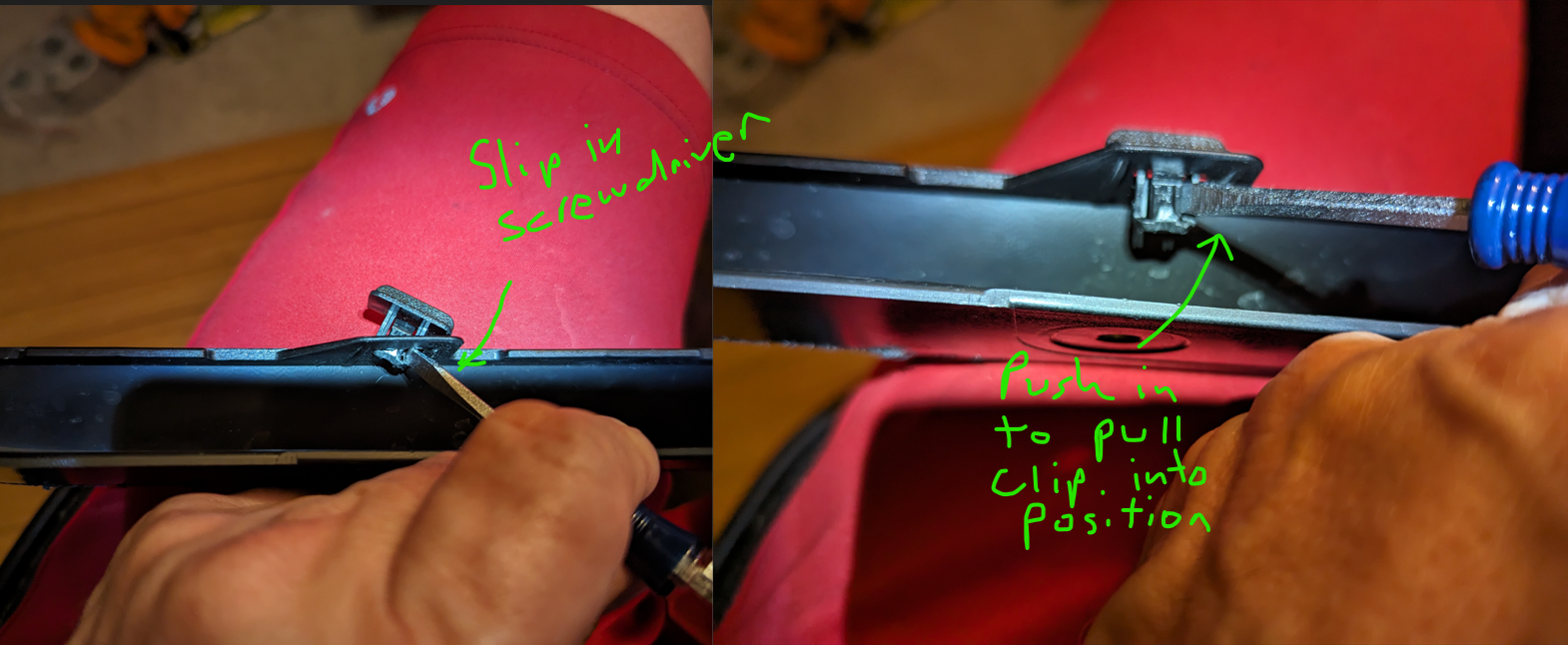

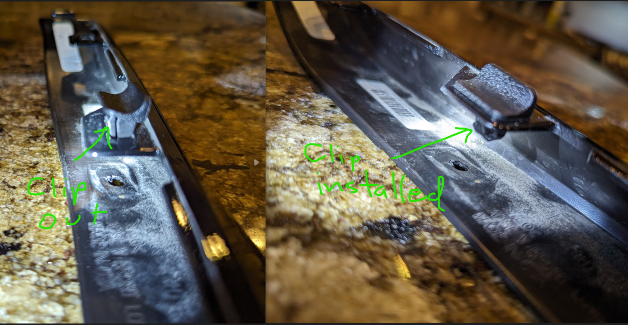

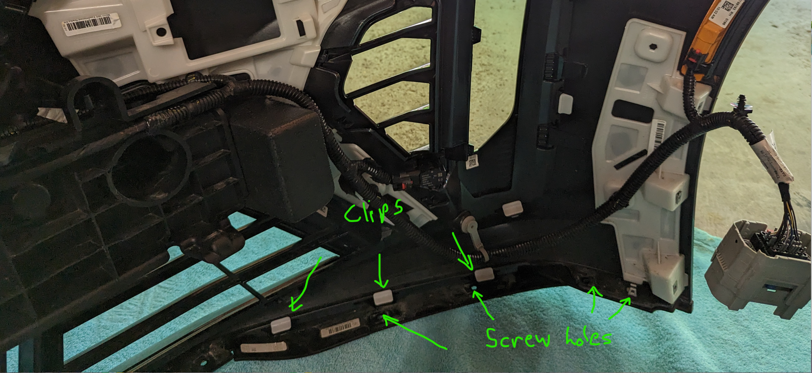

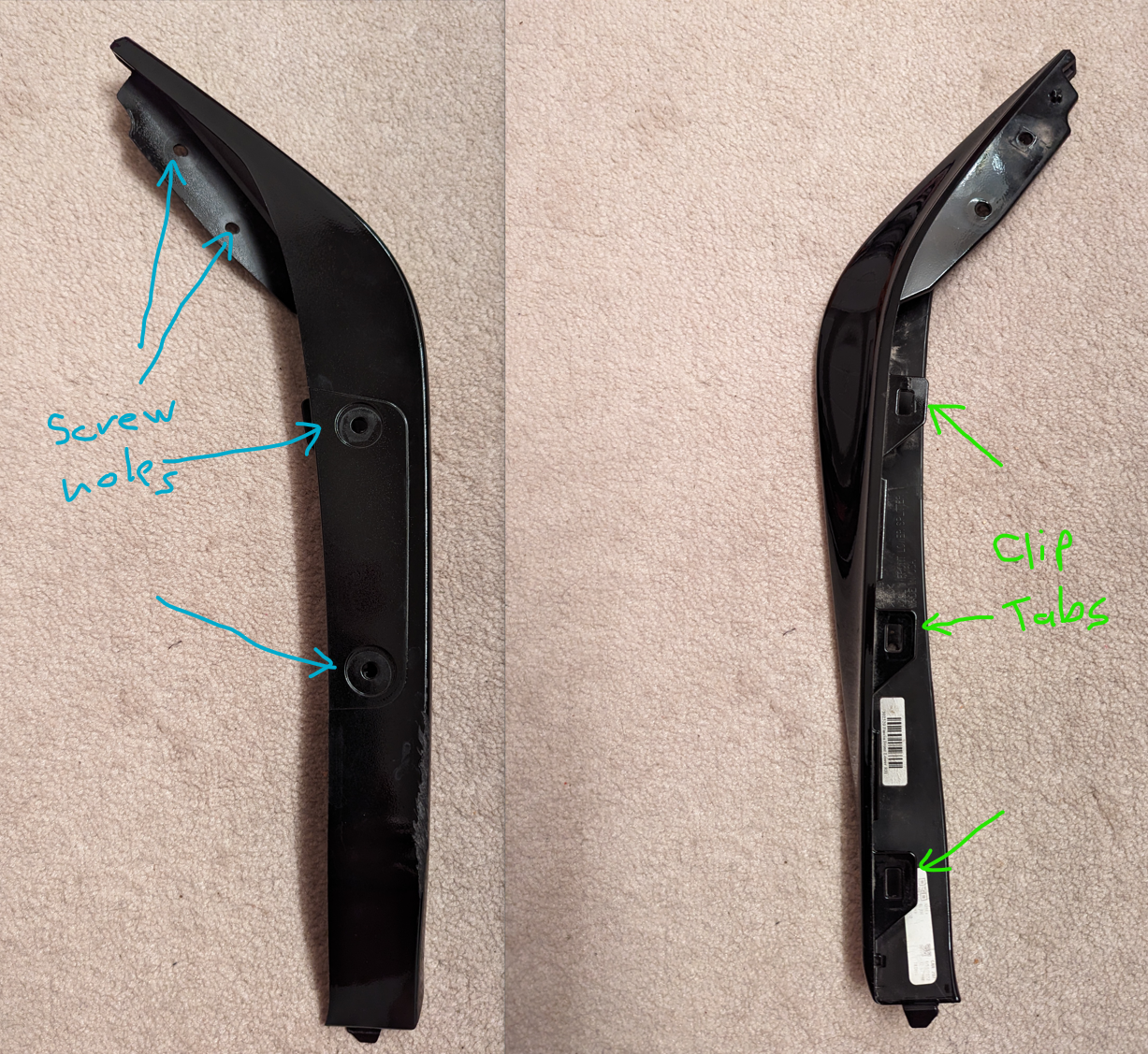

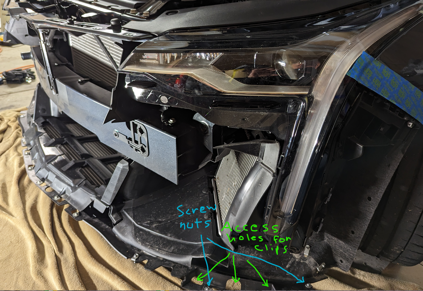

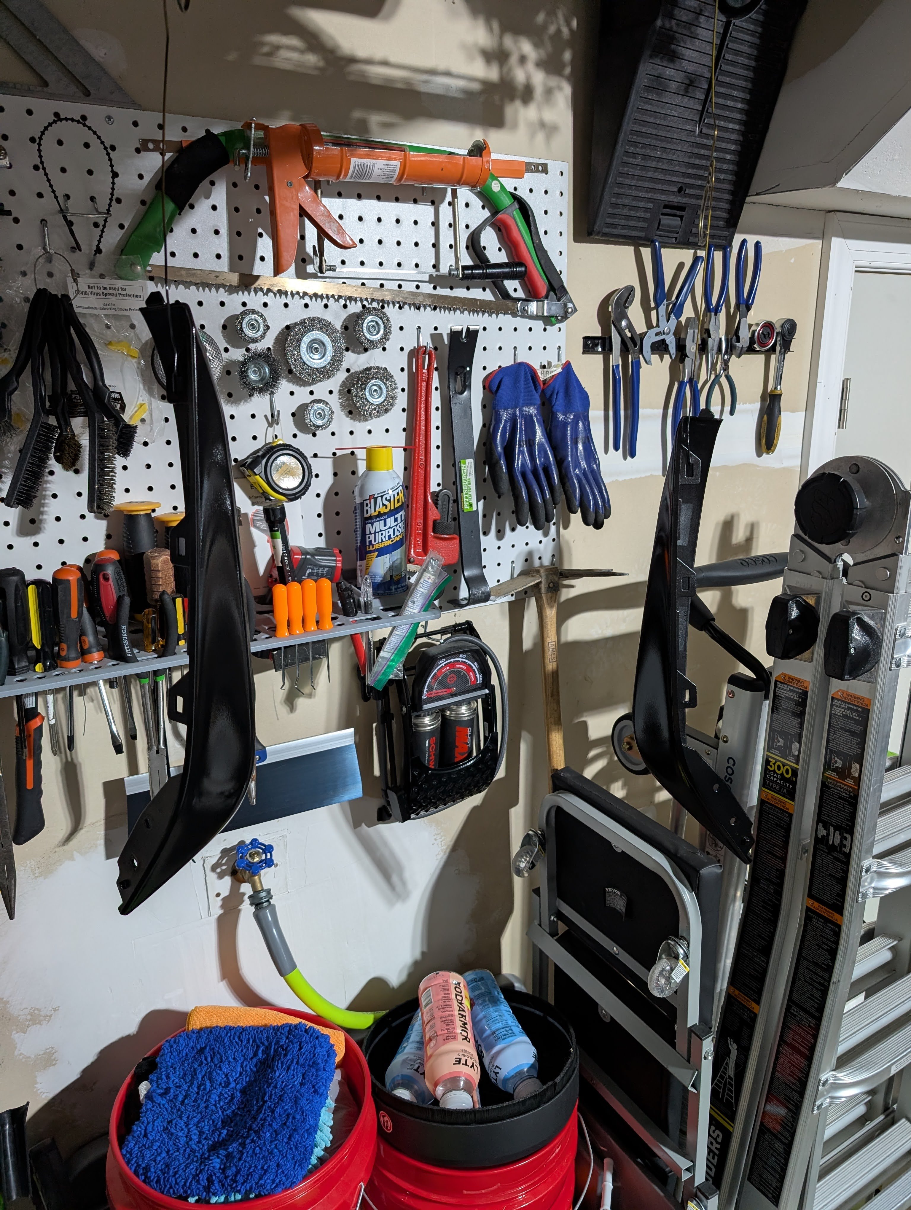

No, you have 4 T5 screws and 3 clips. The clips will be white unlike the one I'm showing here in black, but physically the same. They push in front up top inside the bumper cover. There are openings underneath where you can see the bottom of the clips. The three tabs of the splitter slip through three slits in the bumper cover, and the clips hold it in place. I had my whole bumper cover off (shown below) so you can see what is going on. To disengage them, press on the tongue and push it up. I tested getting the clips back on, and it looks like you can do it if they are in position and you can get a small screwdriver into the slot of the clip between the tongue and the side, then push it in pulling the clip into position. You can see my splitter is also scraped. I've since had the driveway to street slope fixed and the carbon is still intact :cool:
I can't verify the screwdriver will pull in the clip in the car, but it worked in my lap. 🤭

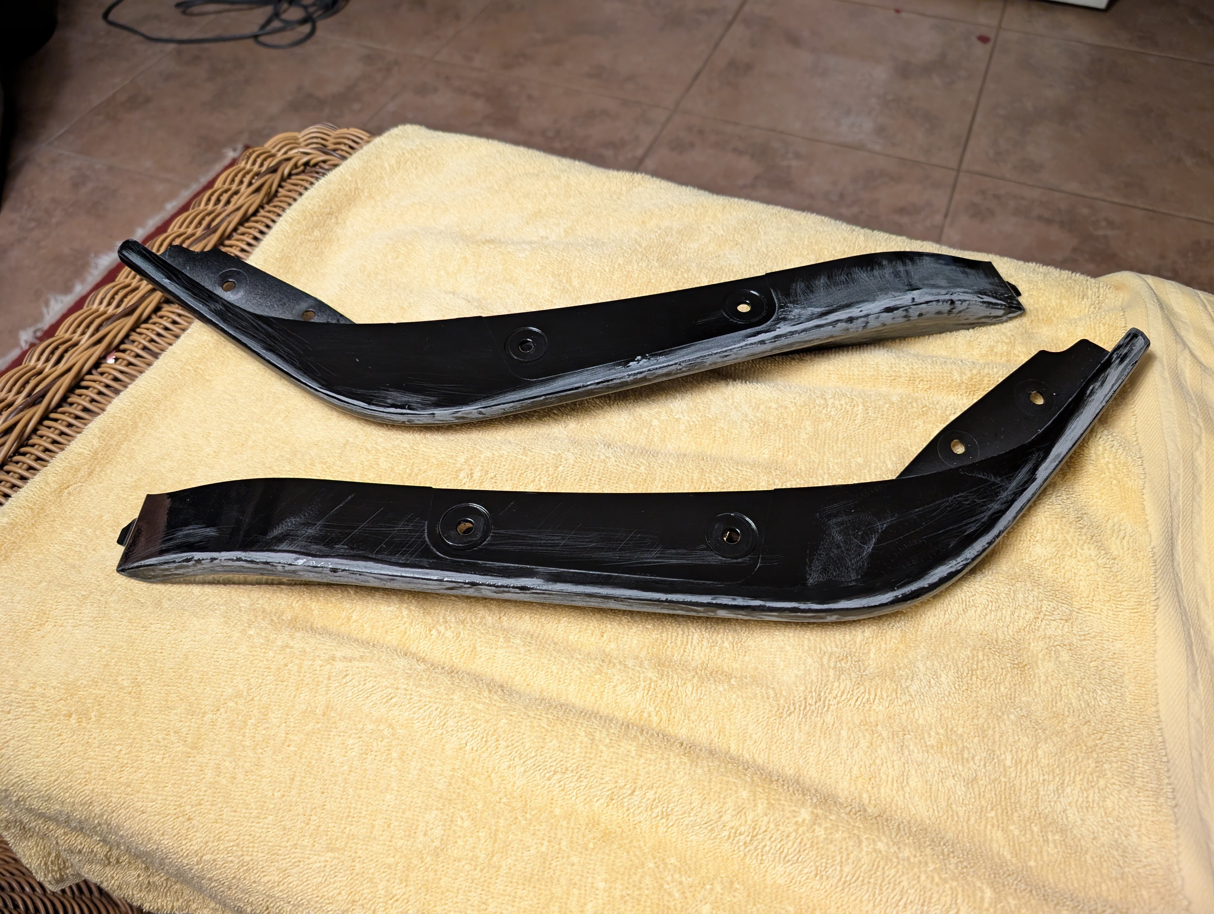

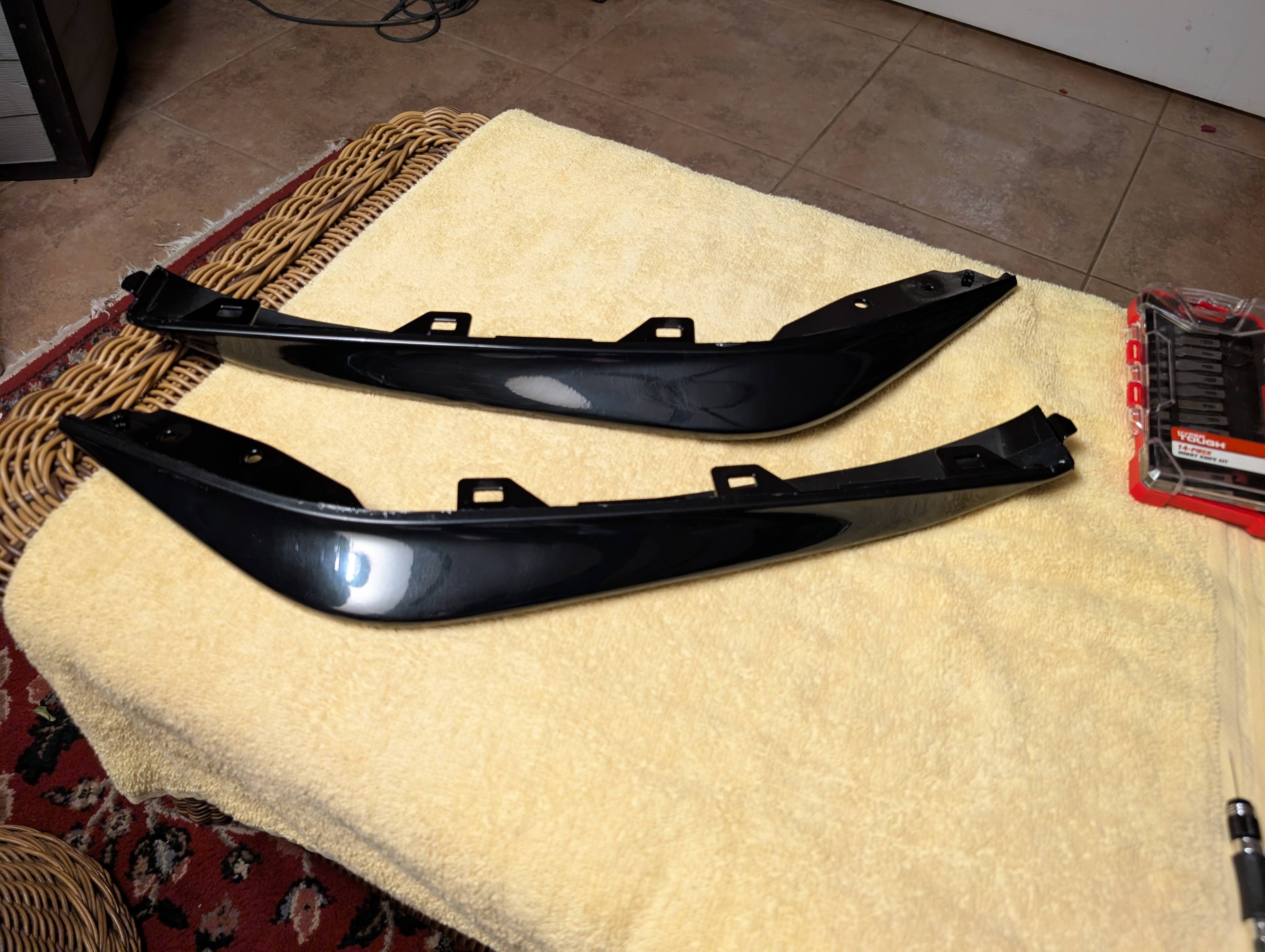

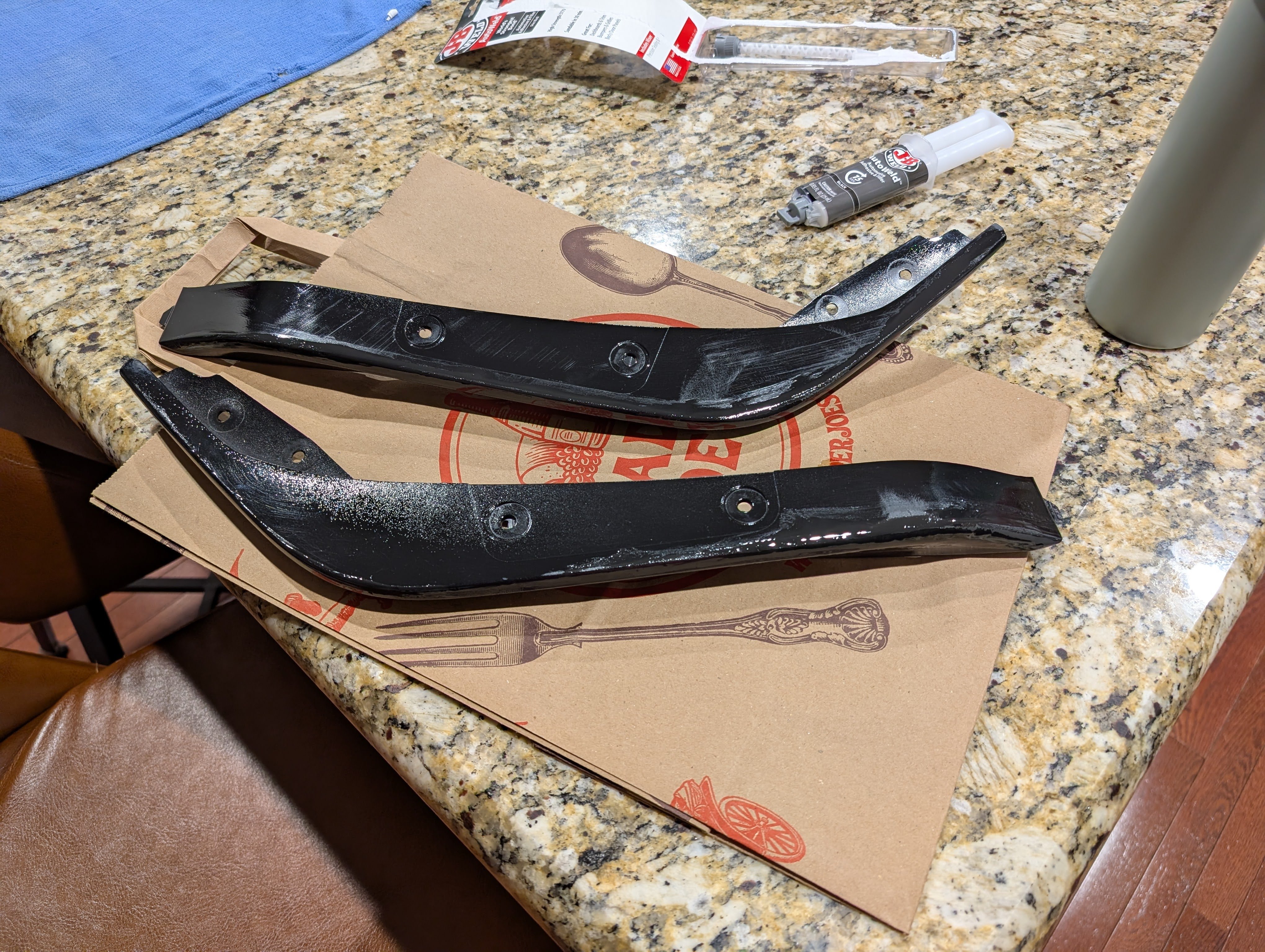

If I were to do something about it, I would probably take them off, sand down the scuffage, and spritz them with some gloss black, rather than shelling out to replace them. I doubt it would be noticeable based on where they are.
My other side was scuffed worse than the one shown. But you couldn't see either one unless you put your head to the ground to look up at it. Eventually there will be other underside plastics that will get scuffed too.

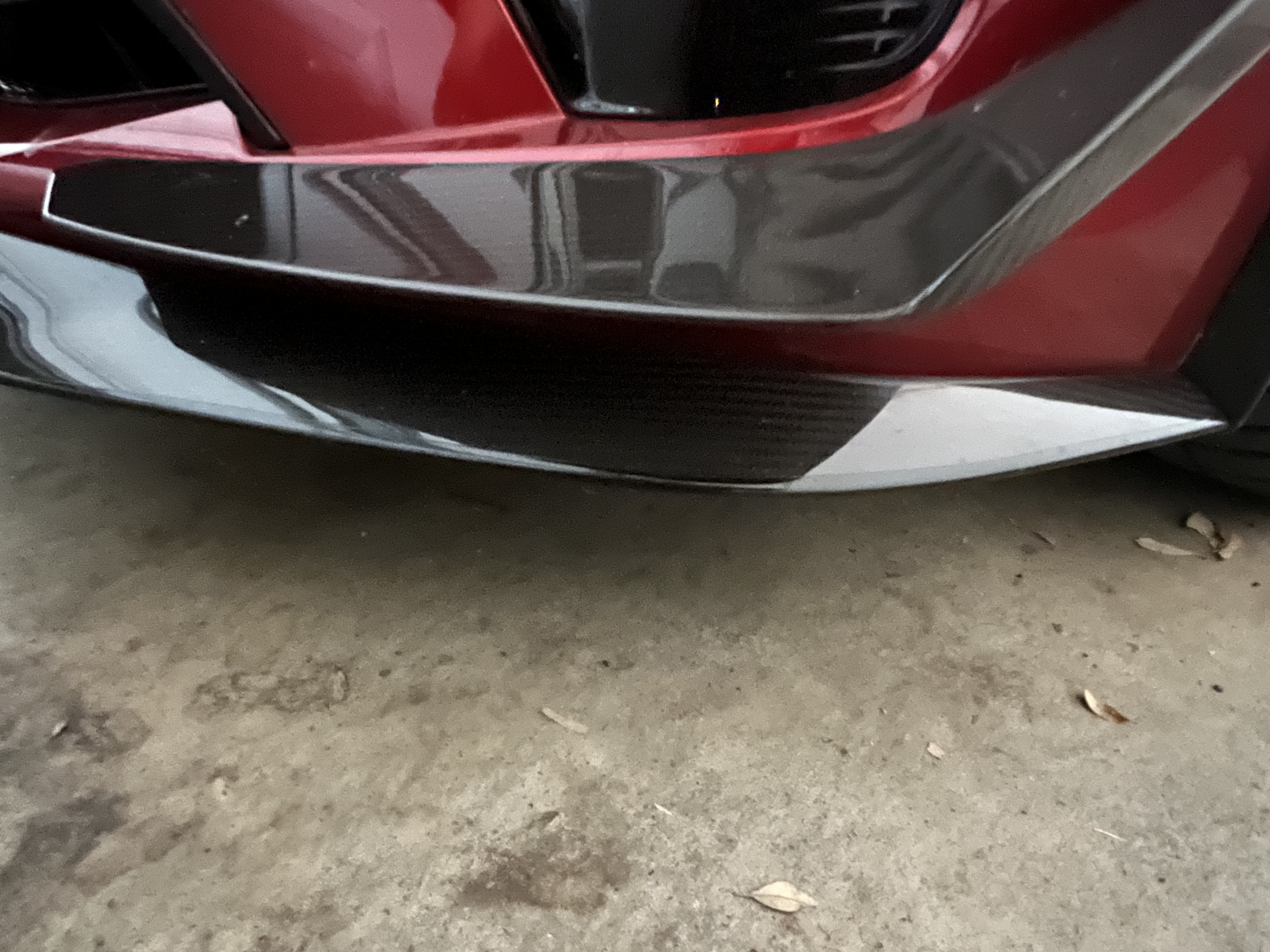

@sethsquire (and @bigE1844) I scuffed mine like three weeks after getting the car and got a recommendation to just put matching black tape on both sides rather than replacing. You can barely tell the tape is there, and it’s easy to switch out if a new scuff occurs. I don’t even think about it anymore. It’s on the leading edge of the splitter here;
What are we looking at?
