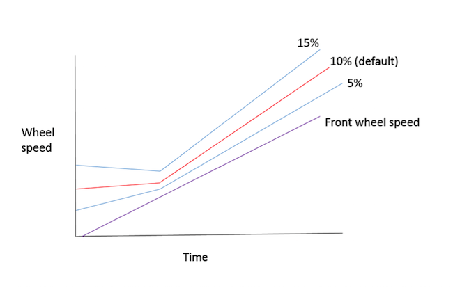

The Slip Target is a setting that controls desired tire spin. The ECM modulates electronic throttle position, ignition timing, etc. in order to achieve the target. The clutch and torque converter are not effected.
^ I wasn't sure if Slip Target had any purpose on a 6MT, where the driver has to control Clutch Engagement.
This ZL1 thread shows more tech details (from a designer).
[ANSWERED] Explanation of Launch Control - Camaro5 Chevy Camaro Forum / Camaro ZL1, SS and V6 Forums - Camaro5.com
Apparently the Slip Target % isn't literal (it's just a scale).

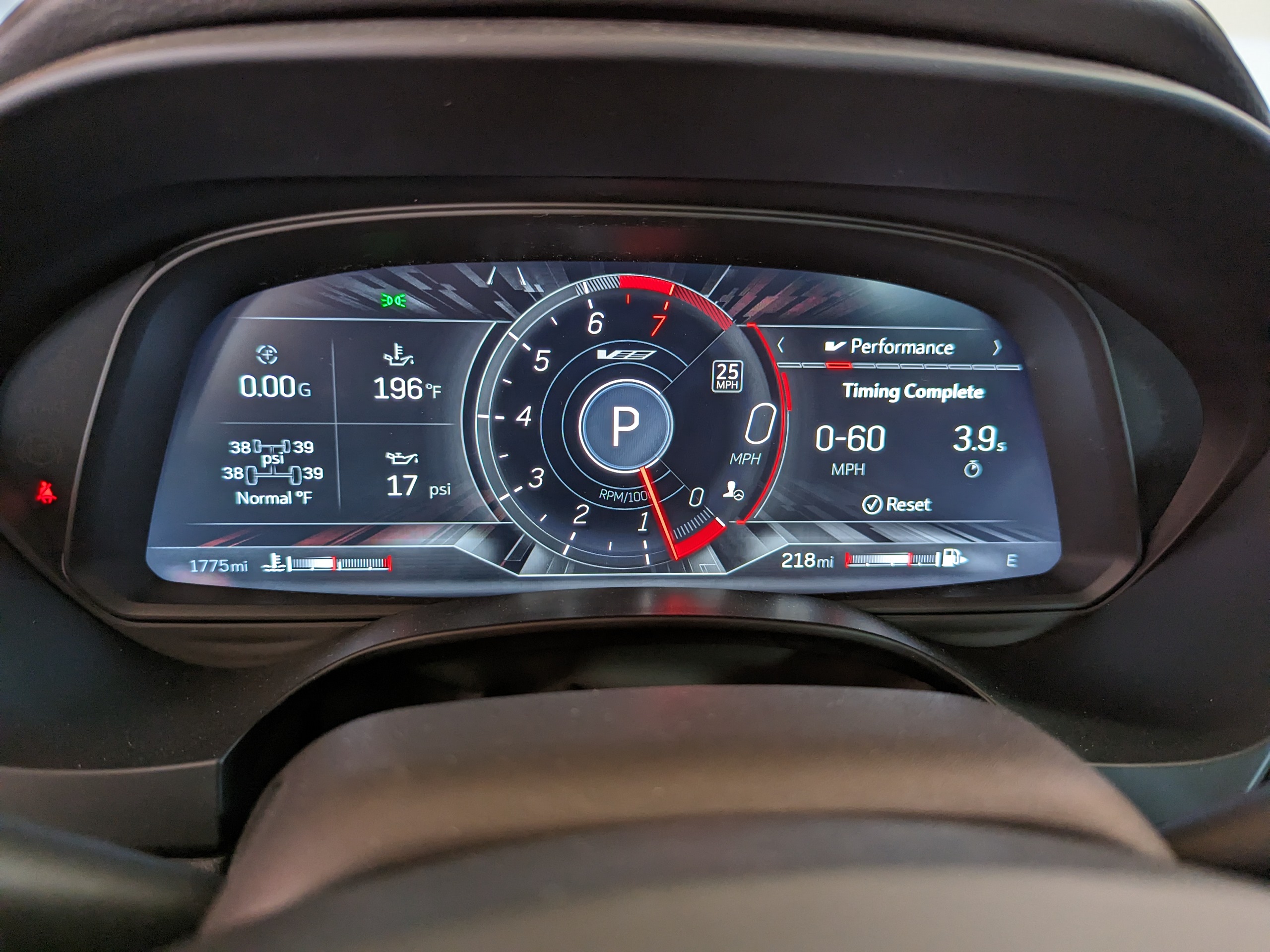

3.9 with an A10, Sport Mode w/ Competitive Driving enabled to enable Launch Control...
Pardon the muffled sound, I forgot to roll up the window.

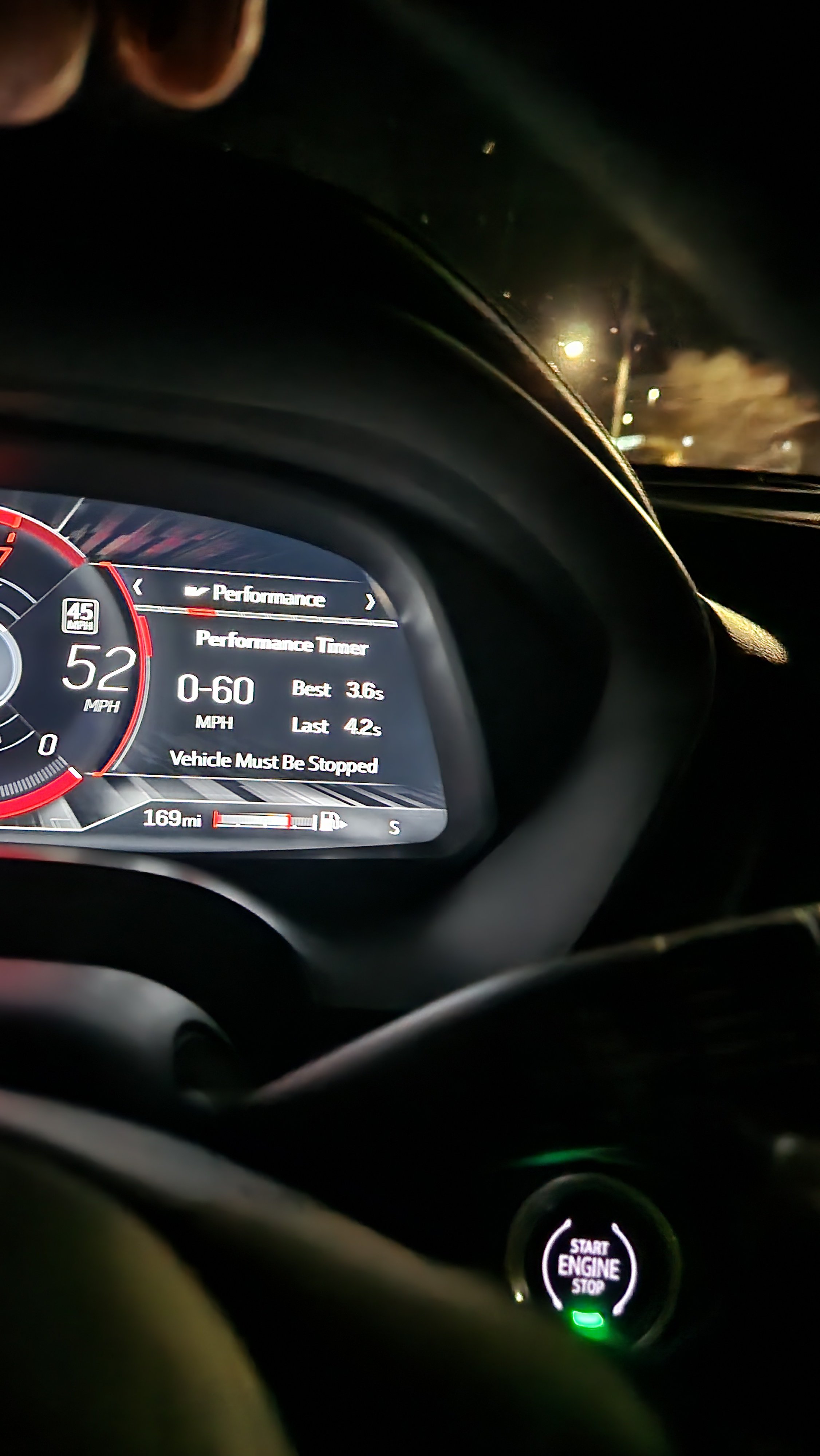

Just tweaking the JB4 and a few other things after installing @Tapout Tuning #WhiteBeltPackage. Not perfect but already down to 3.6 with a few changes. Launch control timing not perfect yet either. Target 3.0...

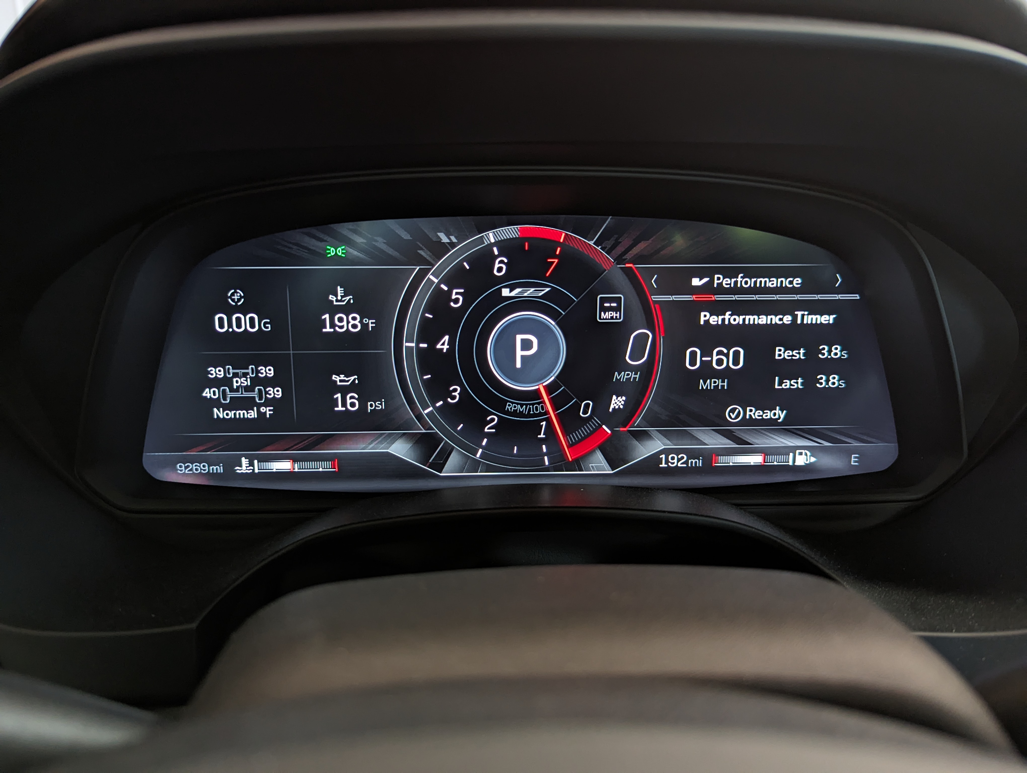

Today, I got a 3.8 on my completely stock 4BW A10.
