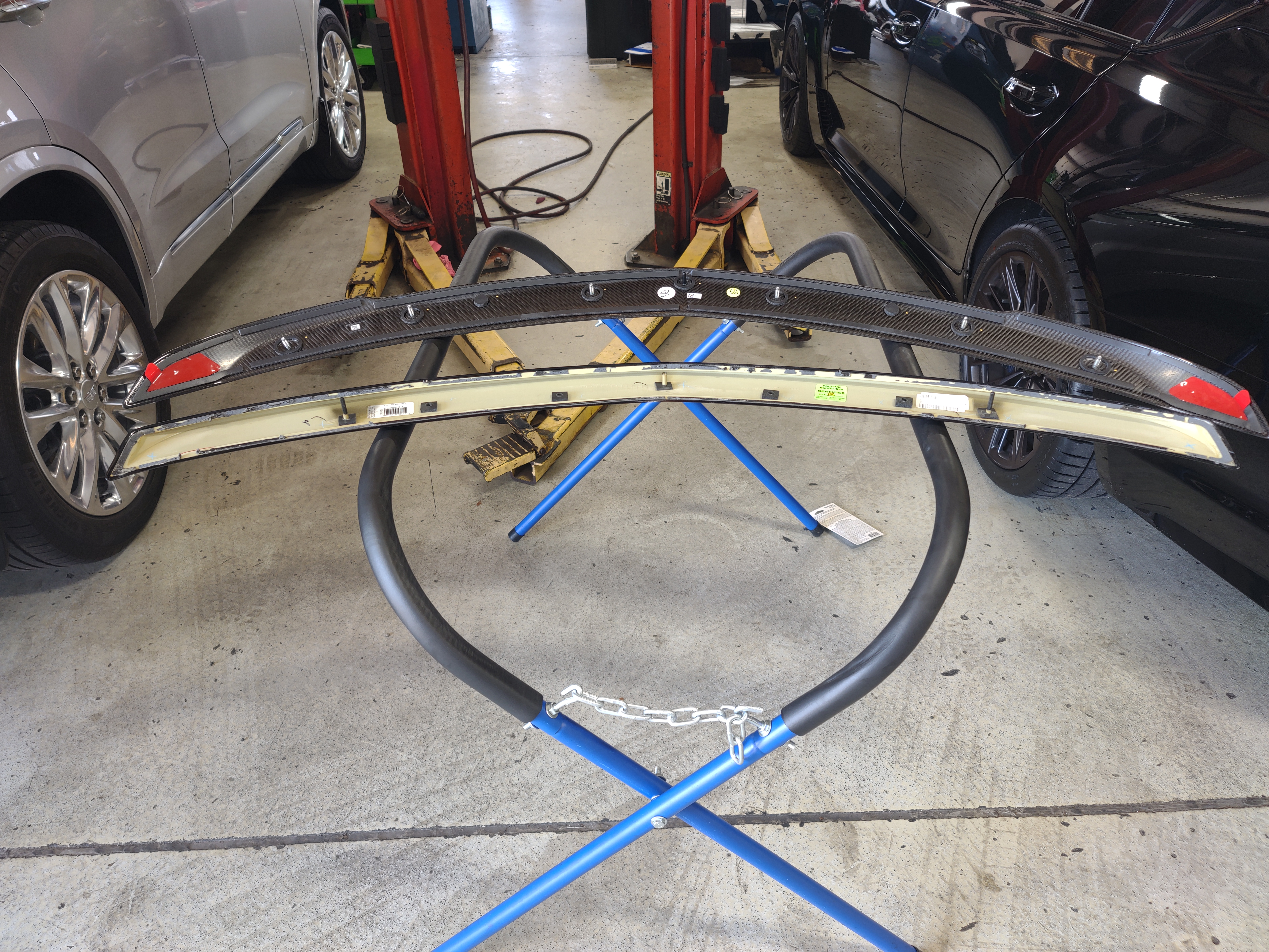

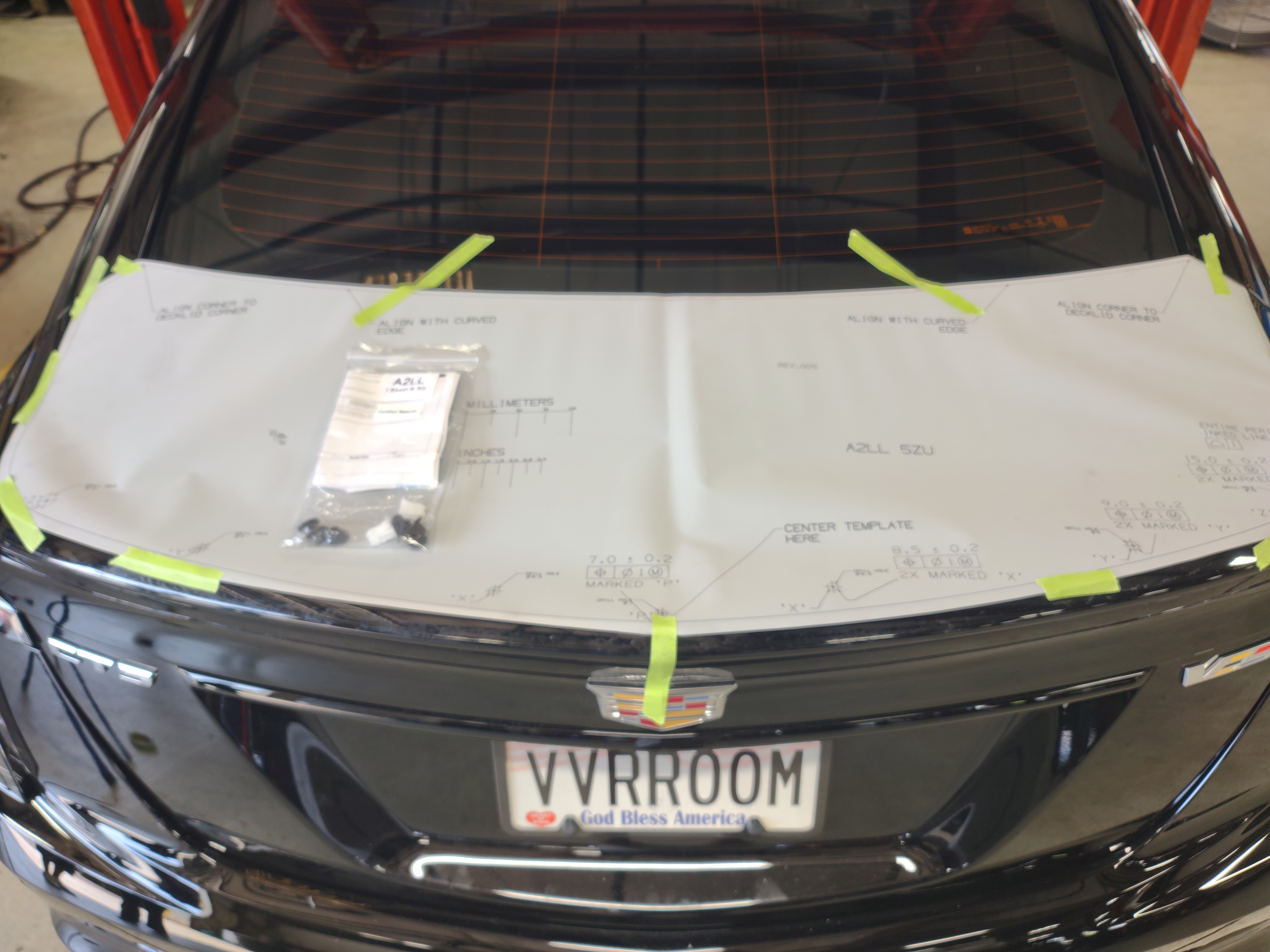

BW5 rear wing is p/n 85561511 and is made in the Atlanta area. Go to myCadillac.com and shop parts/accessories then plug in your VIN and you'll find the oem carbon fiber wing which retails for $3,995 + 10% tax. Shipping is free if shipped to a dealer for pick-up. You can also opt for dealer install of $182. The website runs discounts from time to time of up to 20% off. Your existing spoiler comes off fairly easy by hand as it is only secured by two way tape. Once exposed you will see that the spoiler has 3 guide posts and the trunk lid has 7 factory drilled holes.....3 for the oem spoiler guides and 4 more for the oem carbon fiber wing. The carbon fiber wing comes fitted with screws and fastening hardware as well as a paper trunk template. The template is necessary because the carbon fiber wing has two extra screws that require drilling two extra holes at each of the far edges. The carbon fiber wing has foam padding all around as well as two way tape at the far edges.
