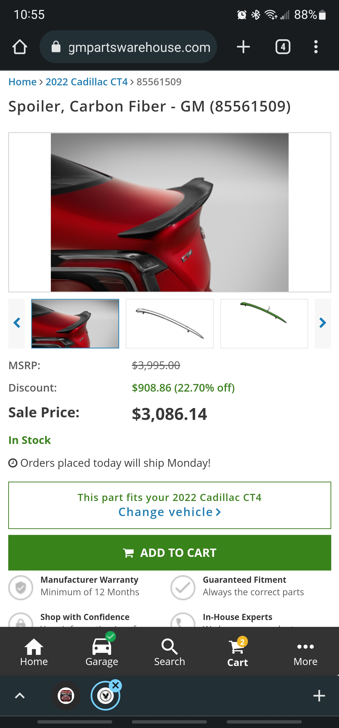

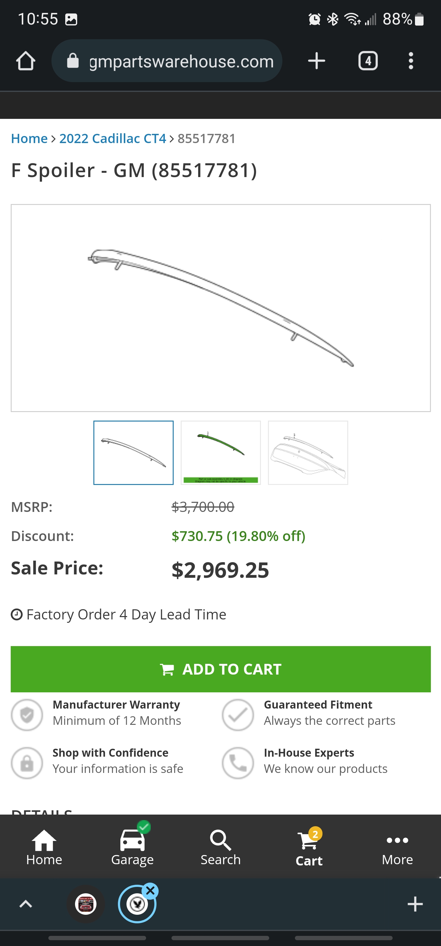

What is the correct part number for the CT4 BW carbon fiber spoiler?? I've seen two part numbers listed on the forum: 85561509 and 85517781
Both come back as carbon spoilers for the CT4 when I search them on GM parts sites.
The second one looks correct from the picture, but I've seen the part number for the first screenshot referenced a lot more here.
It is the 2nd one ( 85561509 ) I purchased it for my 4. I didn't even have to drill holes, they were already there from the factory spoiler.

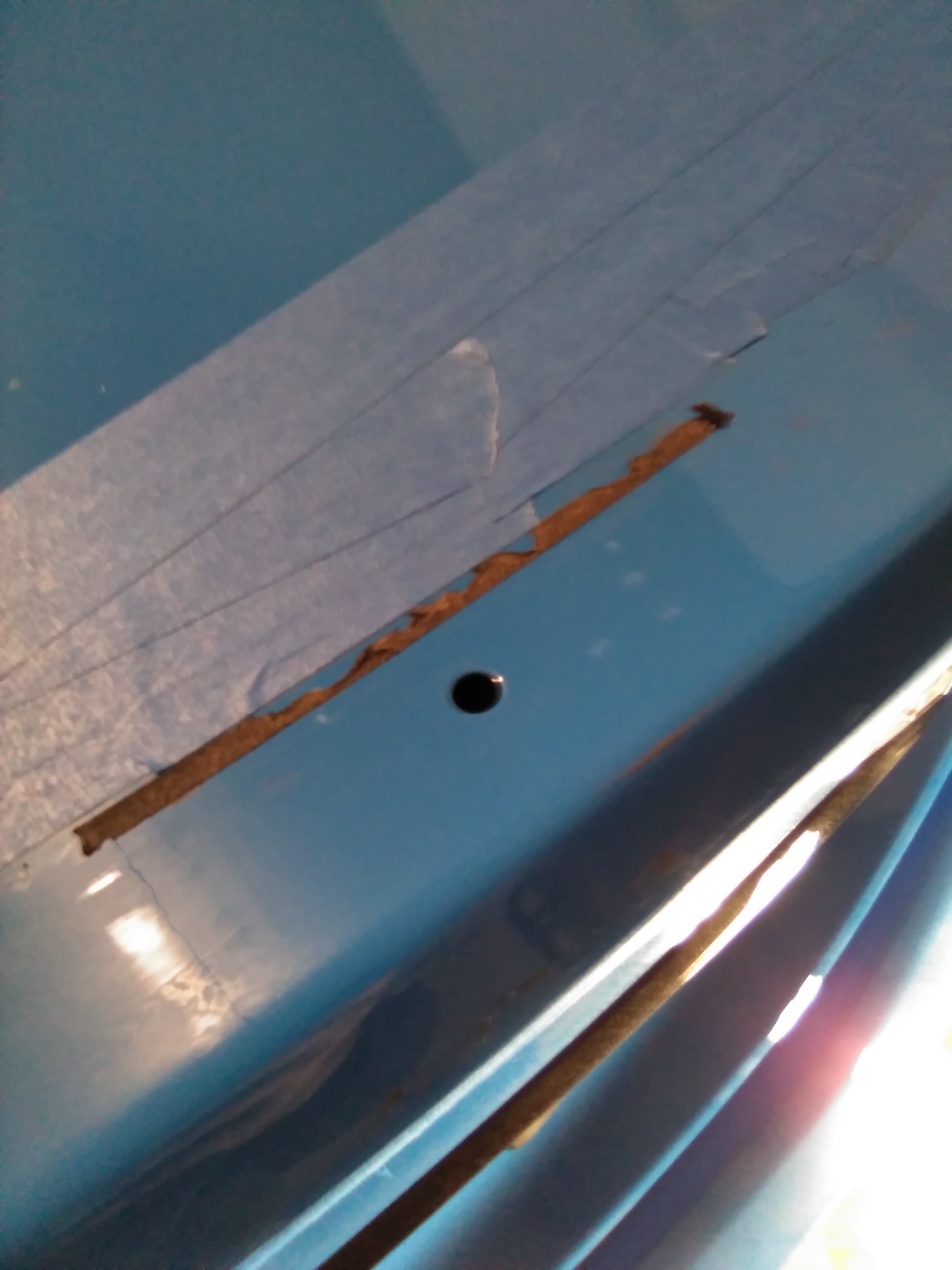

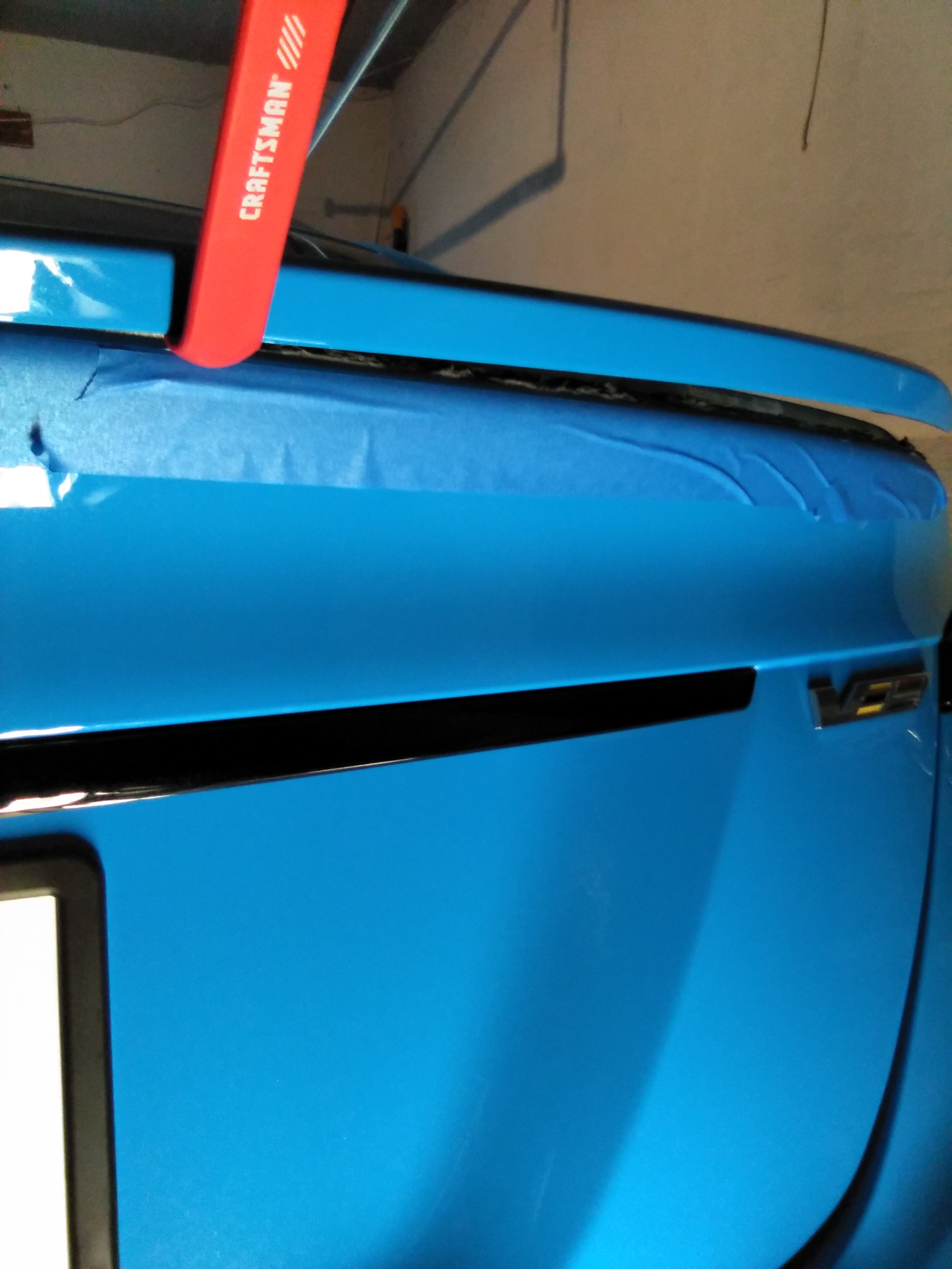

In my case, a 5bw, the double sided tape was front and back, the whole length. Wasn't too bad with a little heat, some plastic trim tools, and painter's tape(ironically, painters tape blue is almost the same as electric blue). Once the spoiler was off, I pretty much used my thumb to rub/roll off the remaining tape.

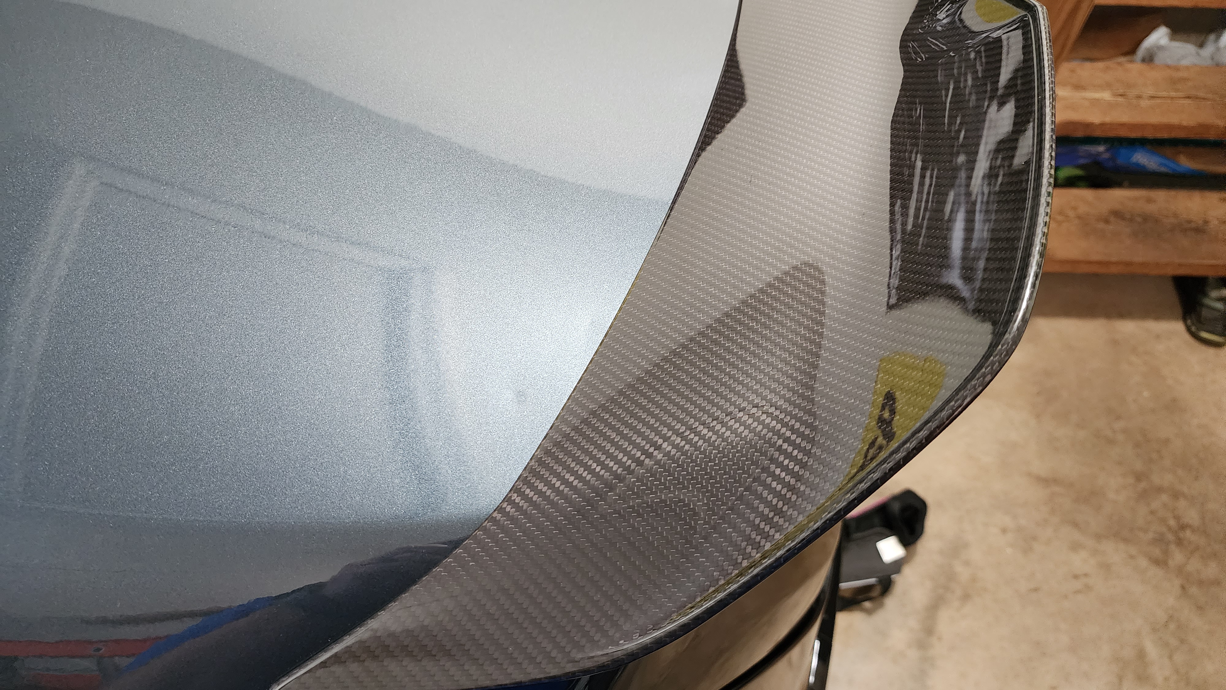

The good, the bad, the ugly.

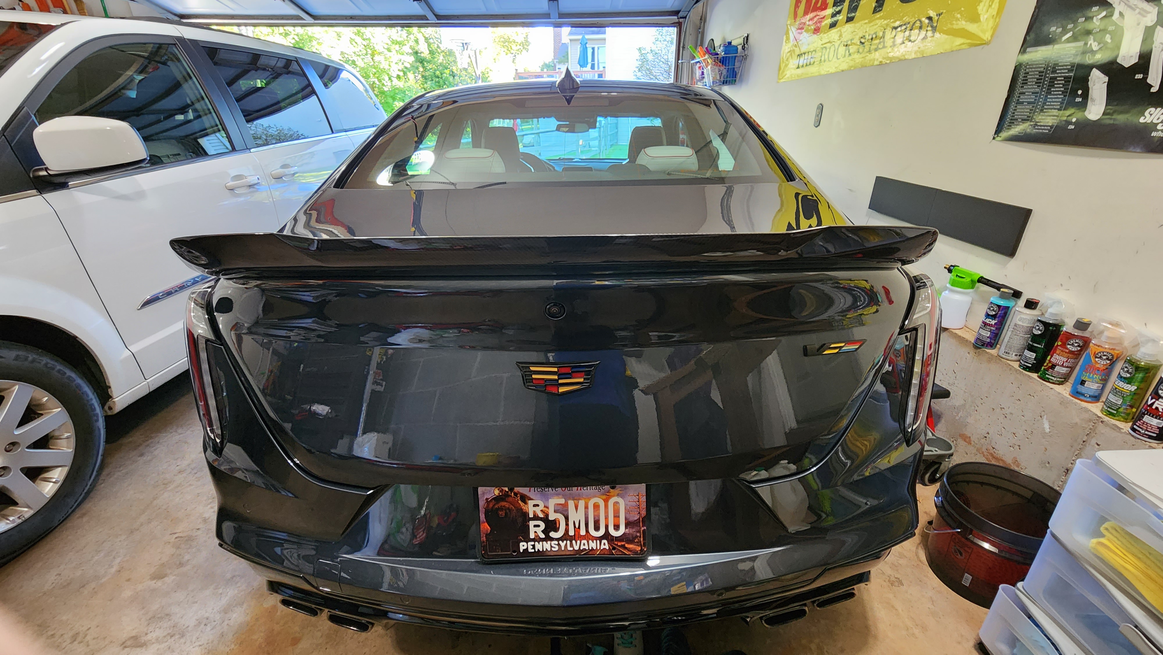

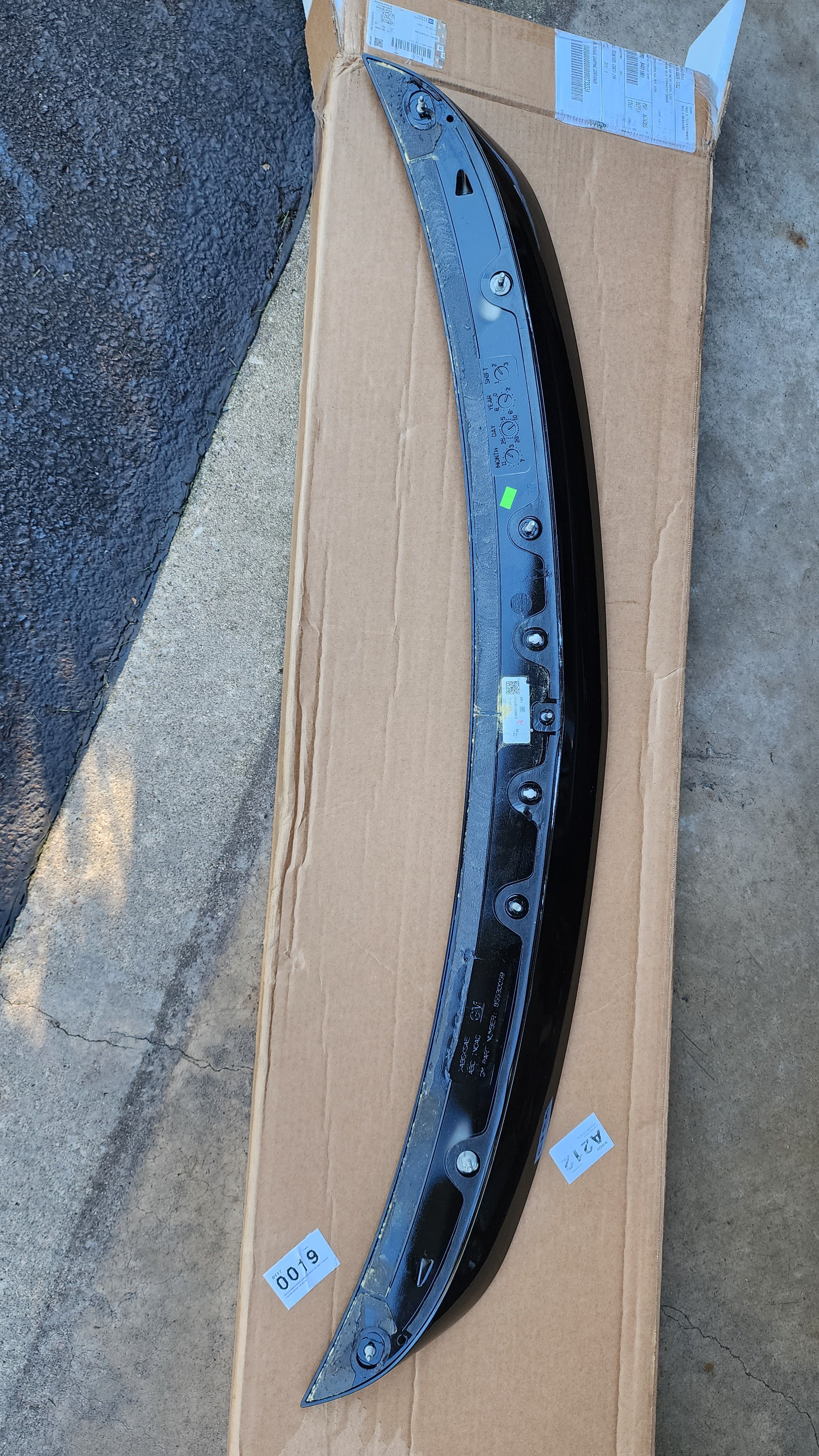

The good: I got the 4BW CF wing installed last night and it looks great!
The bad: the stock spoiler was a bitch to get off. Double sided tape runs the length of the spoiler (inside edge towards the front of the car) so that was fun lol. The most challenging part was the outer most plastic clip on the driver's side. It simply refused to release the spoiler and eventually broke in half. I resorted to trying to pry it with plastic trim tools. Below is the underside of the stock spoiler. You'll see the non-CF spoiler has 2 extra clips in the middle section, but the CF spoiler has foam circles that cover these holes in the trunk. Everything else bolted right up.
The ugly: In the process of prying I put two ever so small dents in my trunk lid. You can see them in the bottom center of this pic. I wasn't putting that much pressure on my plastic tool, but it must have been just enough. :cry:
Sorry to see the small dent. Seems the metal on these cars is so soft. But the carbon spoiler looks great, thanks for sharing the photos.
Removing the outer clips on mine was hell as well. I eventually got in there with pliers and just broke those plastic clips to get them off. I ALSO put a small dent in mine getting the OE spoiler off, luckily under the new spoiler though.
