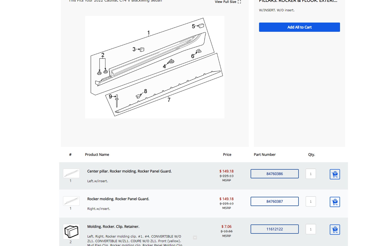

This isn't a carbon part post, but my 4BW non-carbon came with a damaged rocker extension. In the parts list above for the rocker molding, that would be part #8, and it isn't listed there for the CT5 or in the diagram for the 4BW (part #7, attached). Tried the dealer parts dept. and he couldn't figure it out either. I can't believe this part (gloss plastic, not carbon) is totally unavailable. I'm hoping someone might have some advice on what might be going on here.

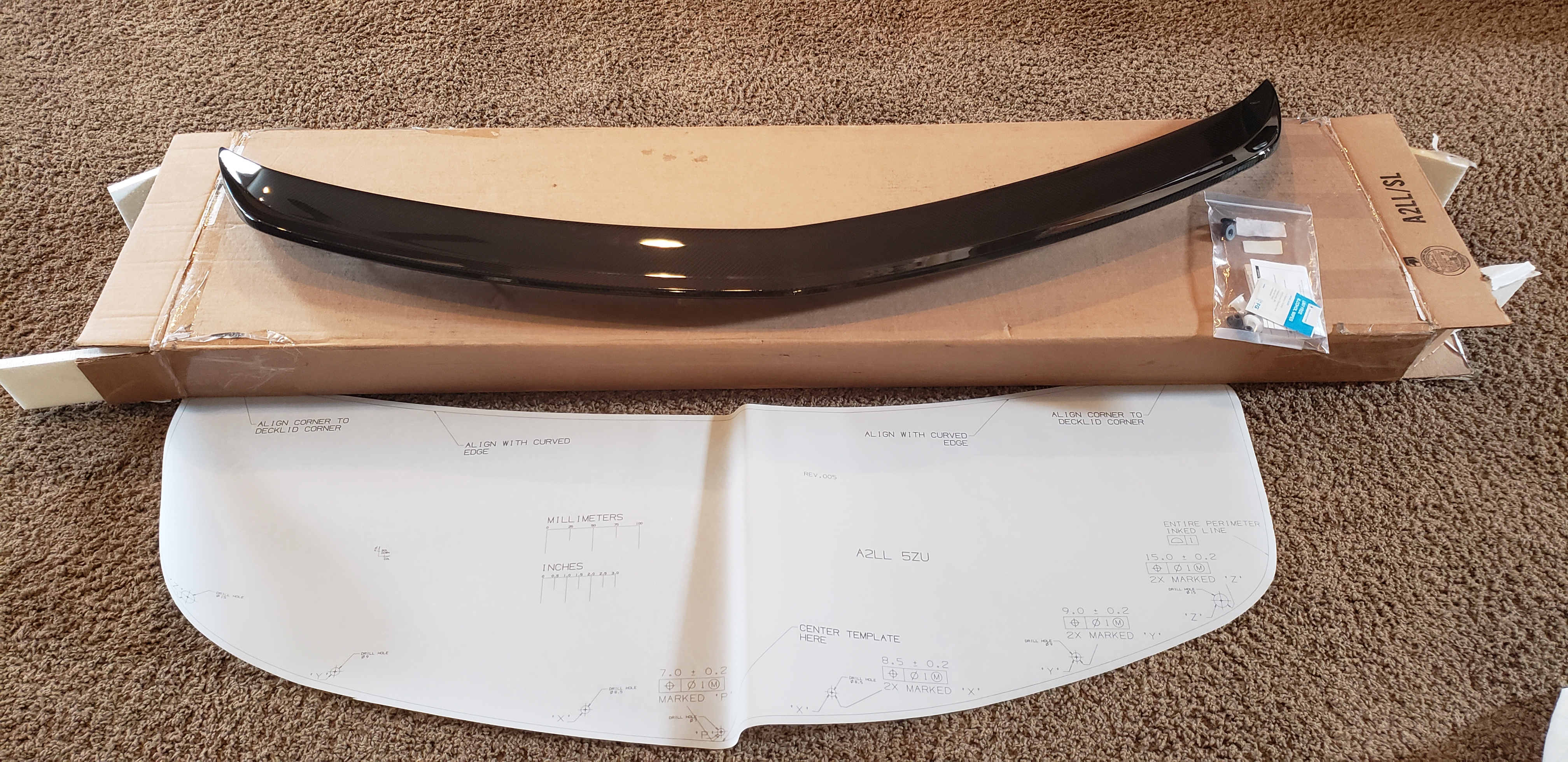

Question for you as it seems you've done this already. Does the double sided tape run the length of the non-CF spoiler or just the outter edges on the driver and passenger side?
I'm trying to mentally prepare myself for how much elbow grease it will take. My CF spoiler arrived today so I'll probably try to install this weekend.
I'm hoping it's the same as the CF spoiler and only on the outside edges. That won't be bad at all to remove in that case.

I just took a look at it on gmpartsdirect. Would you consider the piece you need an "insert"? Seems the rocker piece comes with an insert, but no item 2 through 6 shown to be included seem to fit a description of an insert. That makes me wonder if #7 is included. Strange that 7, 8, and 9 dont show up at this time.

I've wondered if the two pieces come together. It doesn't seem likely, though I may ask the dealer if I can reject it if it comes without it. The online prices of around $150-$160 isn't bad if it has both parts.

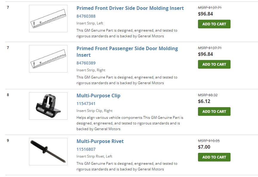

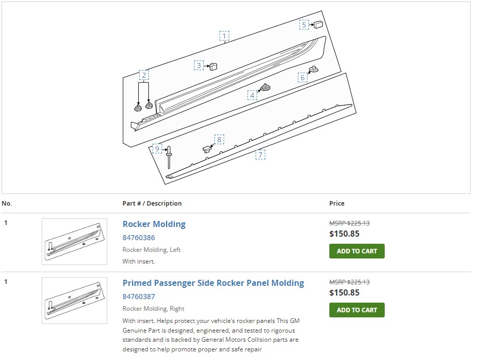

I think I finally figured it out. I'll describe it here in case anyone in the future has a similar problem.
If you search for this same body part using the CT4-V (non-Blackwing), parts 7, 8, and 9 show up. It is called Rocker Panel Molding Trim Insert (84760388 left, 84760389 right). Part 8 is Multi-purpose Clip (1157341) and part 9 is Multi-purpose Rivet (11516807). I count 8 rivets per side.
Although it says this insert does not fit the Blackwing, I think it assumes the Blackwing is using the carbon insert and my car does not have the carbon package. Looking at the Youtube reviews of the regular V, this insert looks identical. Also, whether looking up the Blackwing or the regular V, all the parts 1 through 6 in the diagram are the same part numbers. So I think the problem lies with a false assumption in the parts manual that the Blackwings are all using the carbon rocker insert. I think this also likely means anyone wanting to upgrade to the carbon part only needs the carbon insert and the rivets since the Rocker Panel Guard is the same for both.
The standard insert I found for as low as $90 and the (pricey) rivets are $6- $7 each. I hope a standard pop rivet tool works with them. Also, it says primer so I'll also have to get it painted. I'll post again if I find out anything different after I get the part, assuming it's available.
