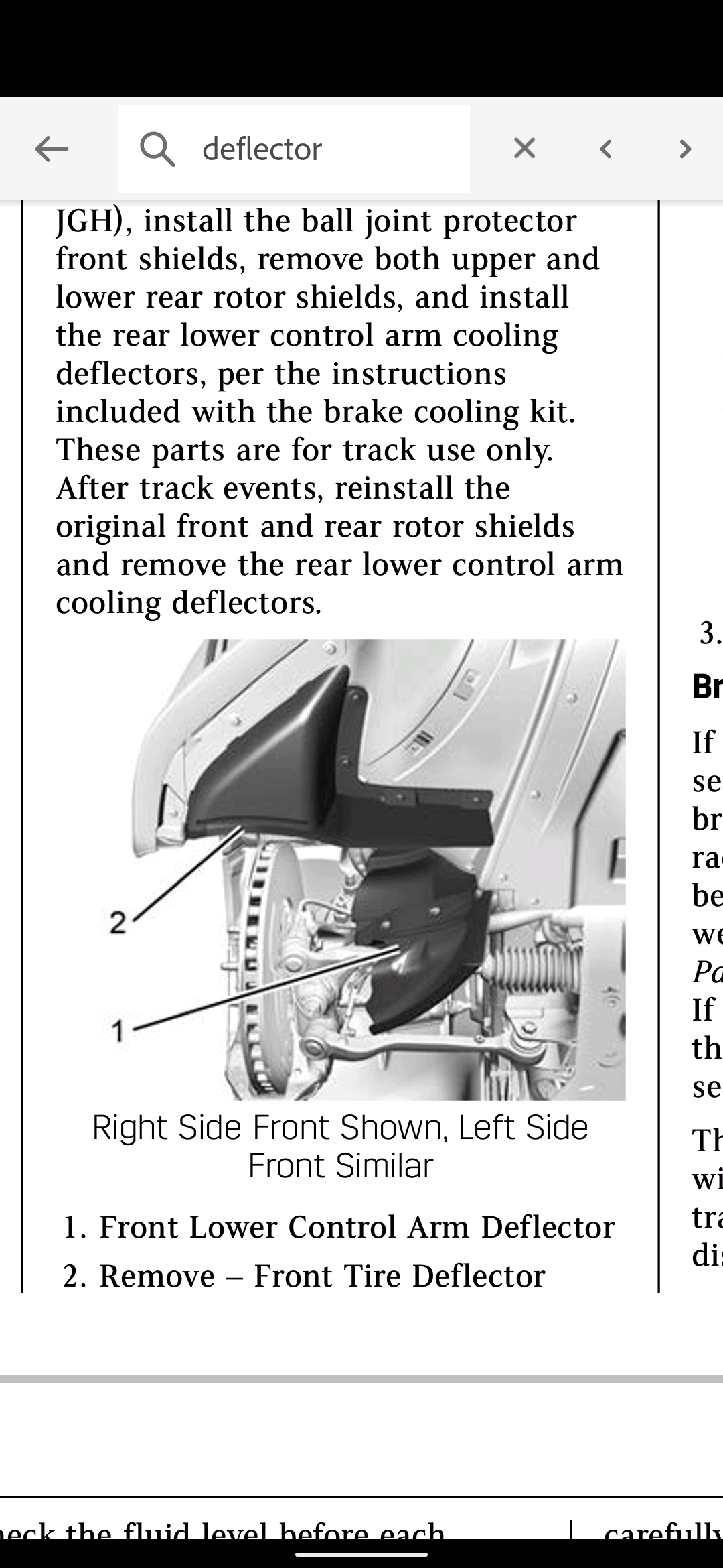

Only thing I am not sure about is whether these pieces are needed with the CF splitter...Can people with 5V BW carbon splitter look underneath and check if those rubber front tire deflector pieces are different? It's #2 in the image. Thanks!
For what it's worth, my car (non CF, non CCB) doesn't even have these AT ALL. Dealer really has no idea if they should be on the car, or if they should have been in the trunk from the factory. I'm not sure what package these deflectors are part of.
I installed the front splitter with those pieces in place...also verified with my dealer part dept that both have the same..my dealer did not install these ..but the dealer did not install any of the underneath aero ..these pieces were in my trunk.
I installed the front splitter with those pieces in place...also verified with me dealer part dept that both have the same
Great. When I went to a different GM dealer I showed them the manual and they can't even find the part to order. Cadillac is supposedly shipping me all the brake cooling parts I was missing, so hopefully these come in as well since I pointed out they were missing.
I installed the front splitter with those pieces in place...also verified with me dealer part dept that both have the same..my dealer did not install these ..but the dealer did not install any of the underneath aero ..these pieces were in my trunk.
I had those pieces in my trunk and have no idea what they are for or what to do with then. Should I put those on? Where can I find instructions for them?

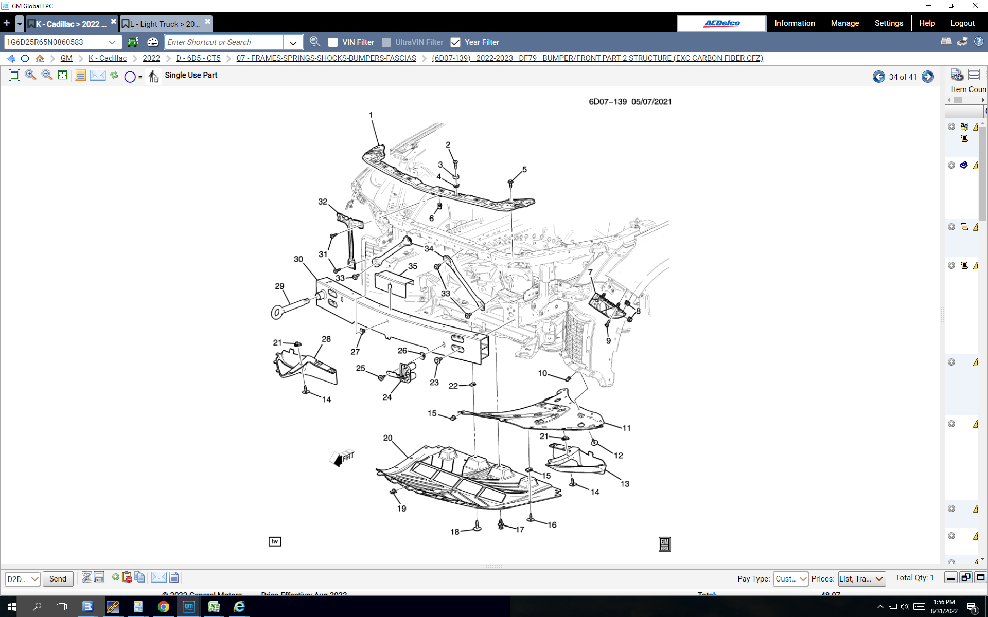

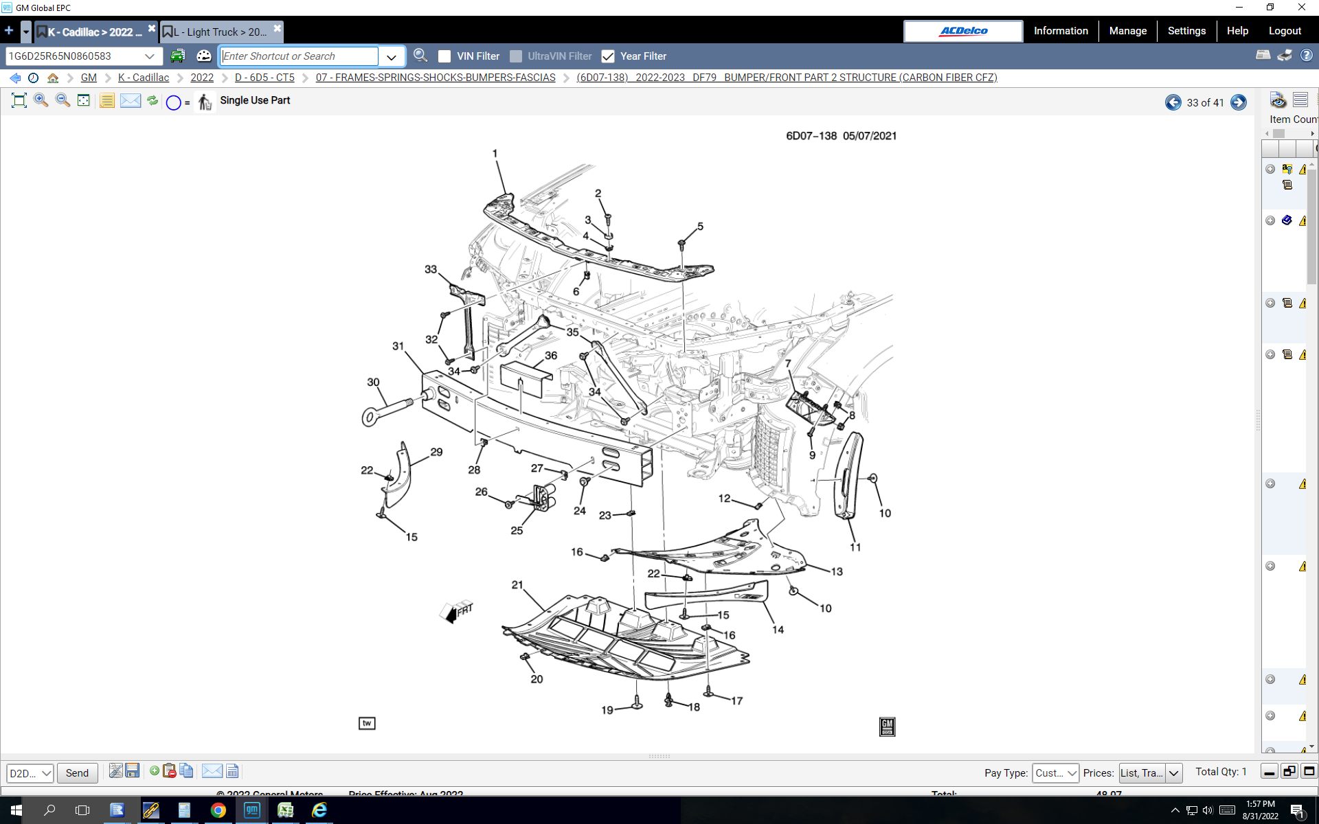

So some clarification from my parts guy....the first image is for a non-CF car and the second one is for a CF car. You can see that parts #13 and #14 and parts #28 and #29 are different. So the rubber tire deflectors for a non CF car are not used for a CF car. I am not sure if there is a difference for carbon ceramic vs non carbon ceramic brakes now.
Non Carbon Fiber Car

Carbon Fiber Car
