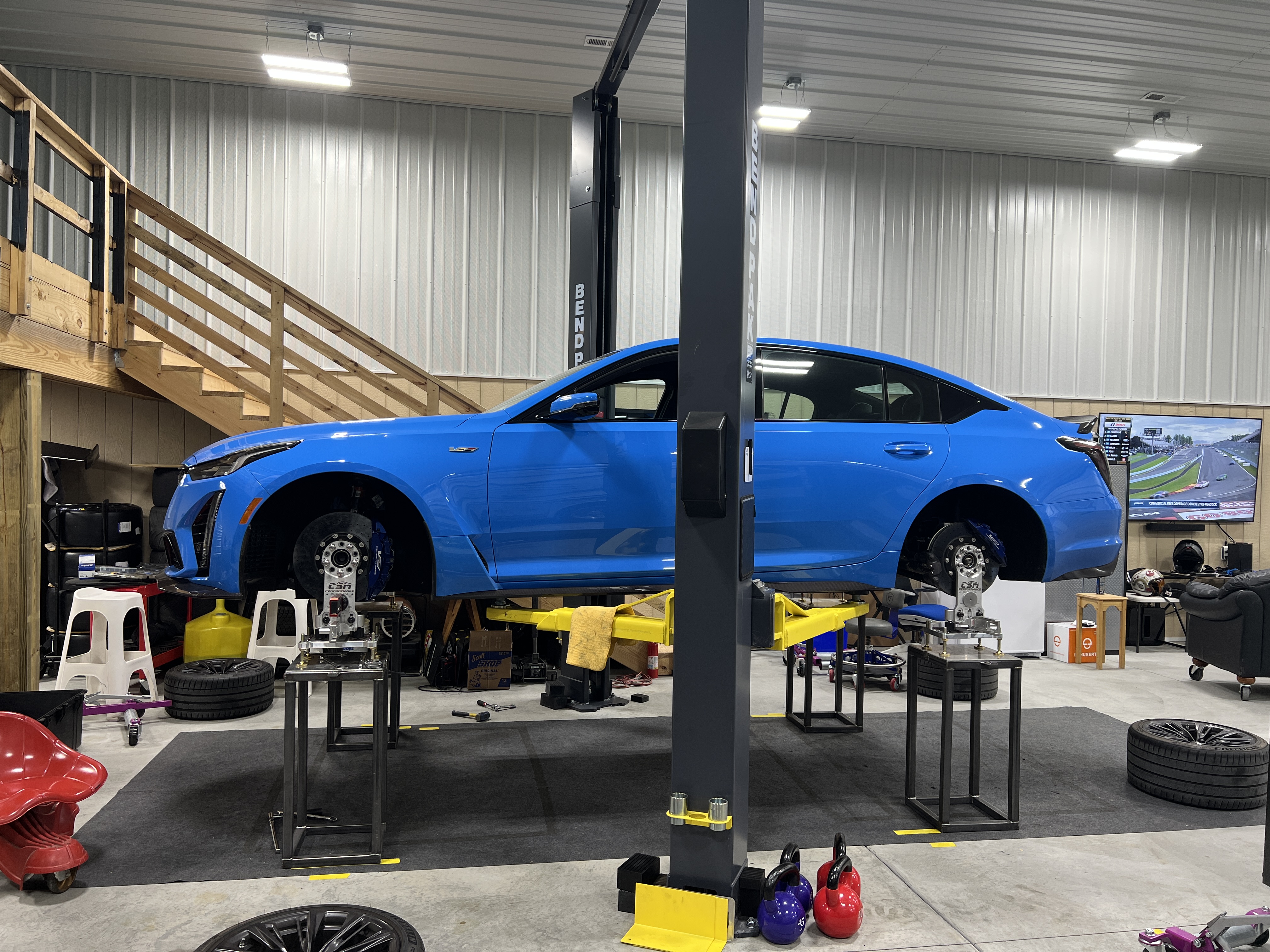

Thanks. I’ve aligned mine three times now. I’m now using the CSM hub stands which are phenomenal, albeit expensive.

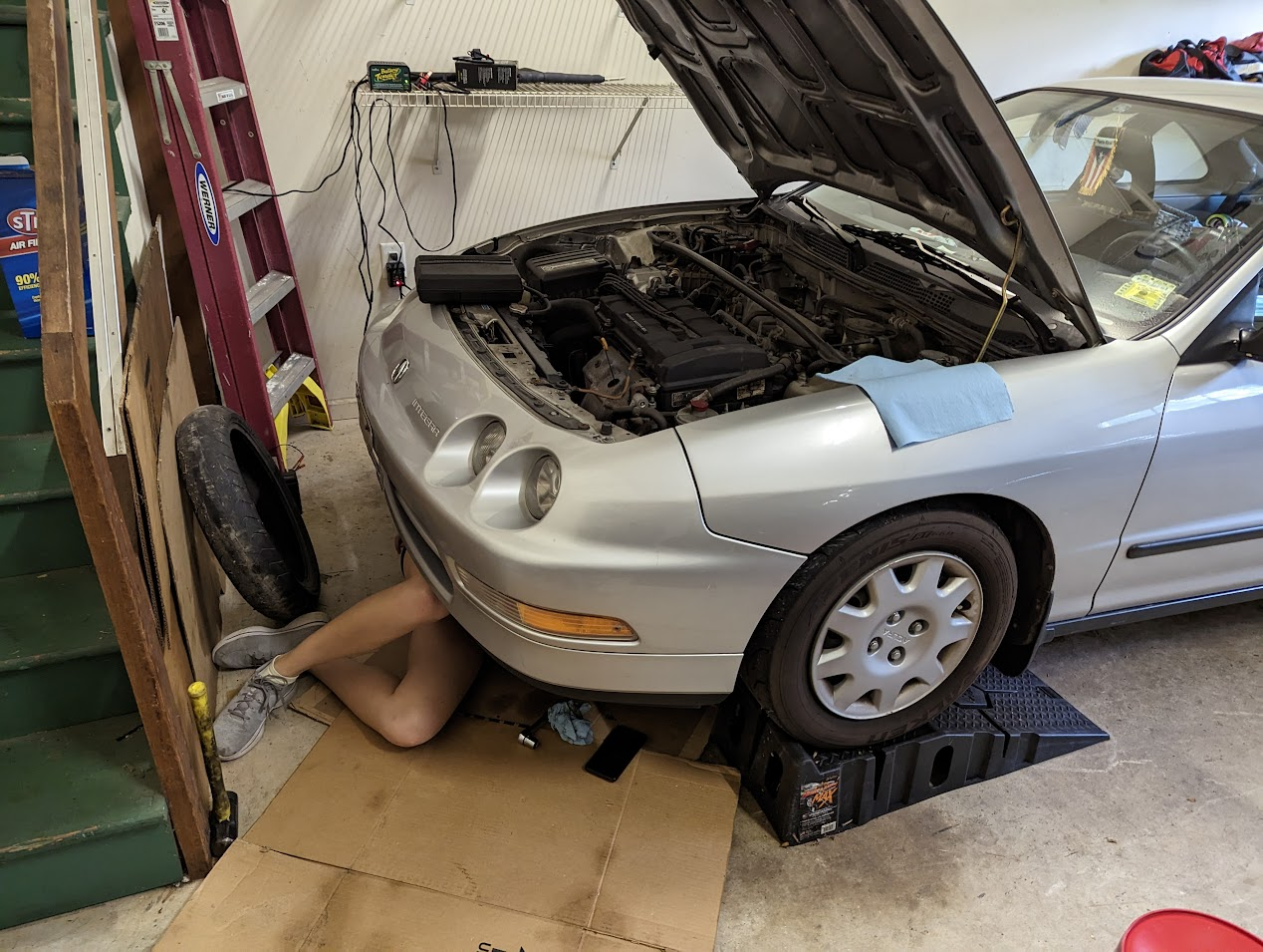

Completely agree. This is a great picture of one of my daughters "helping" to change the oil. :) I let her have my old Integra during college (and still for a while until she gets her new GR 86) on the condition that she knows how to maintain it. Also had to know how to drive a manual transmission. She has a lot of fun with the fact that she can drive a MT and many male friends cannot.
For reference, I encourage my kids to help me anytime auto work is being done in my house, which is frequently.
