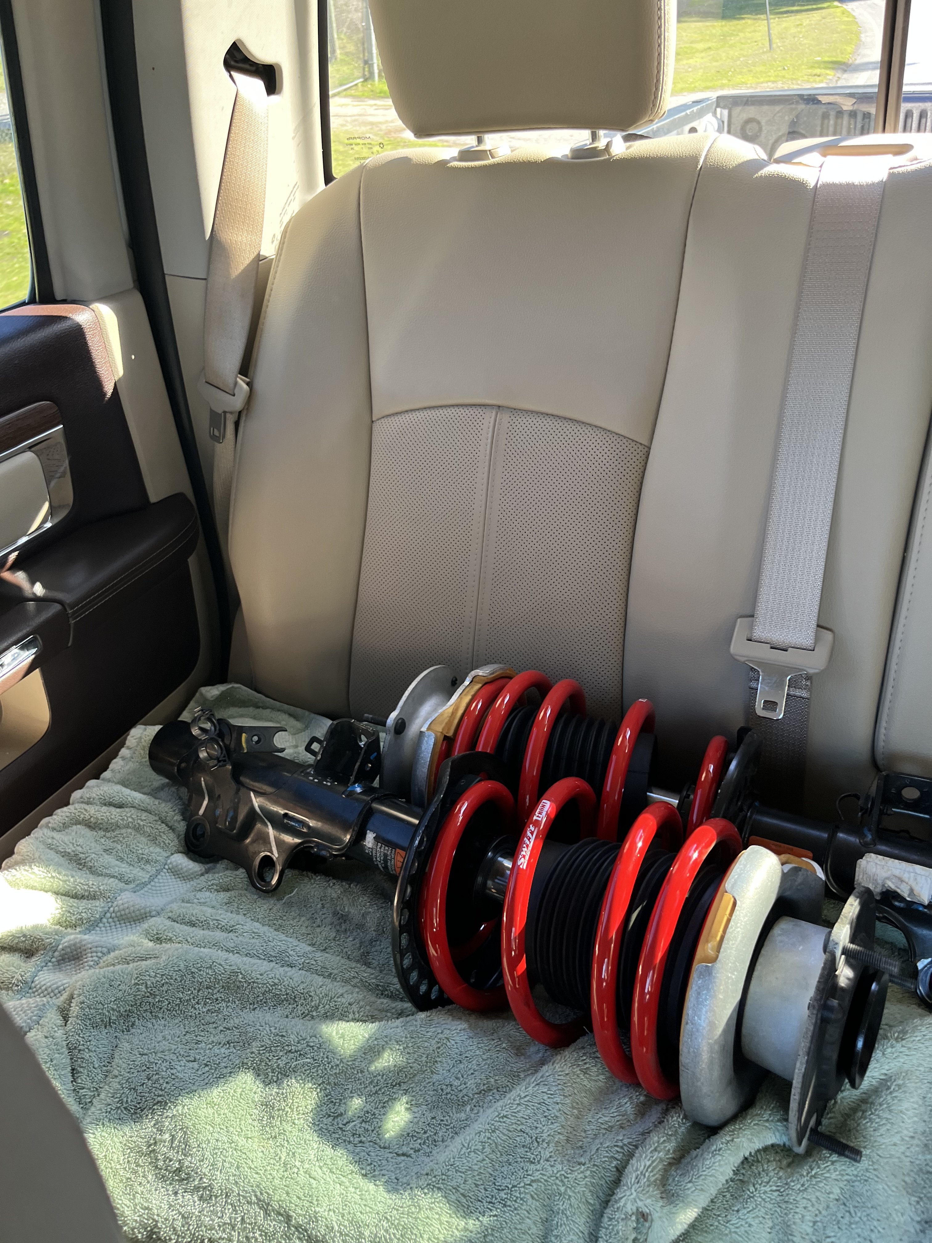

Just double check your struts before you starts disassembly. I found a leaky front passenger strut on mine, thankfully I found it when I started. Not when I'm finishing...

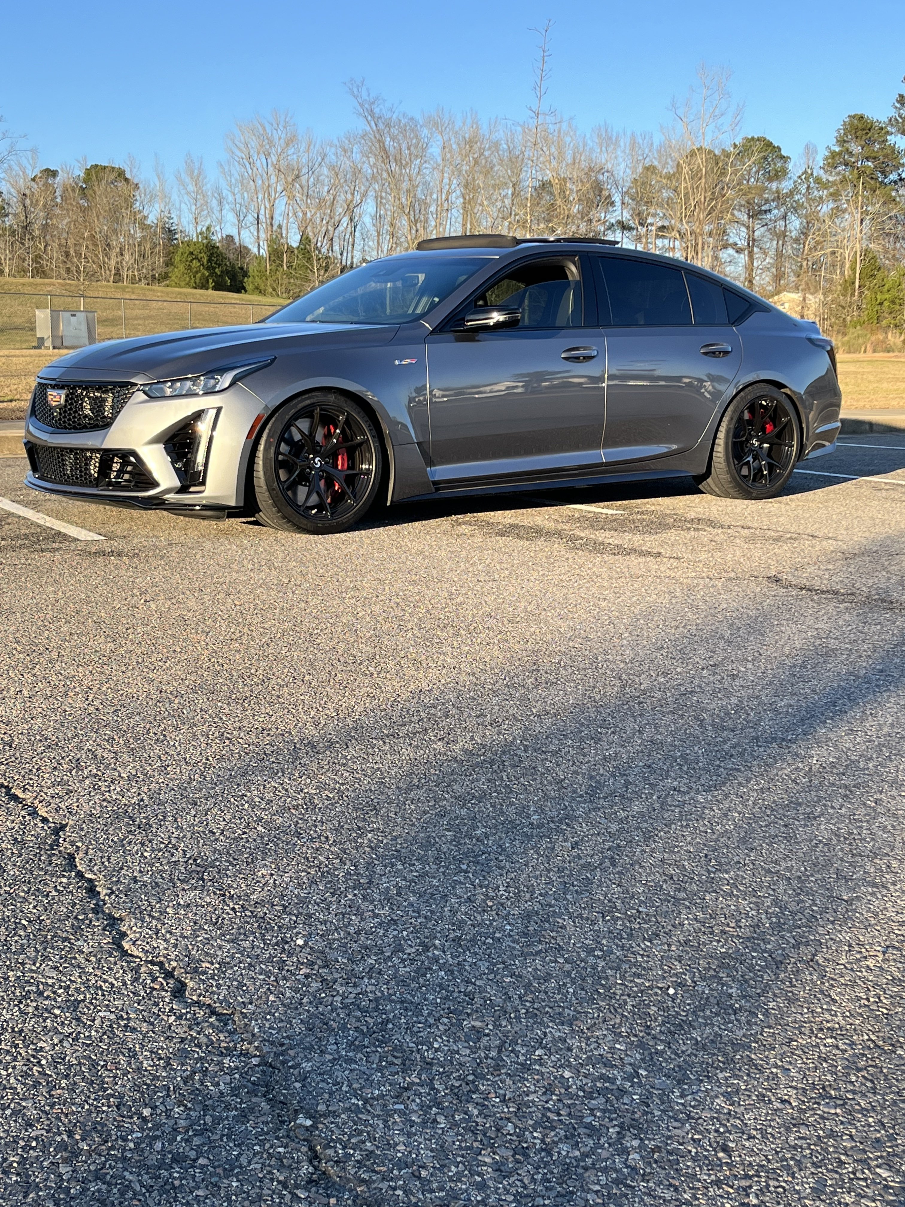

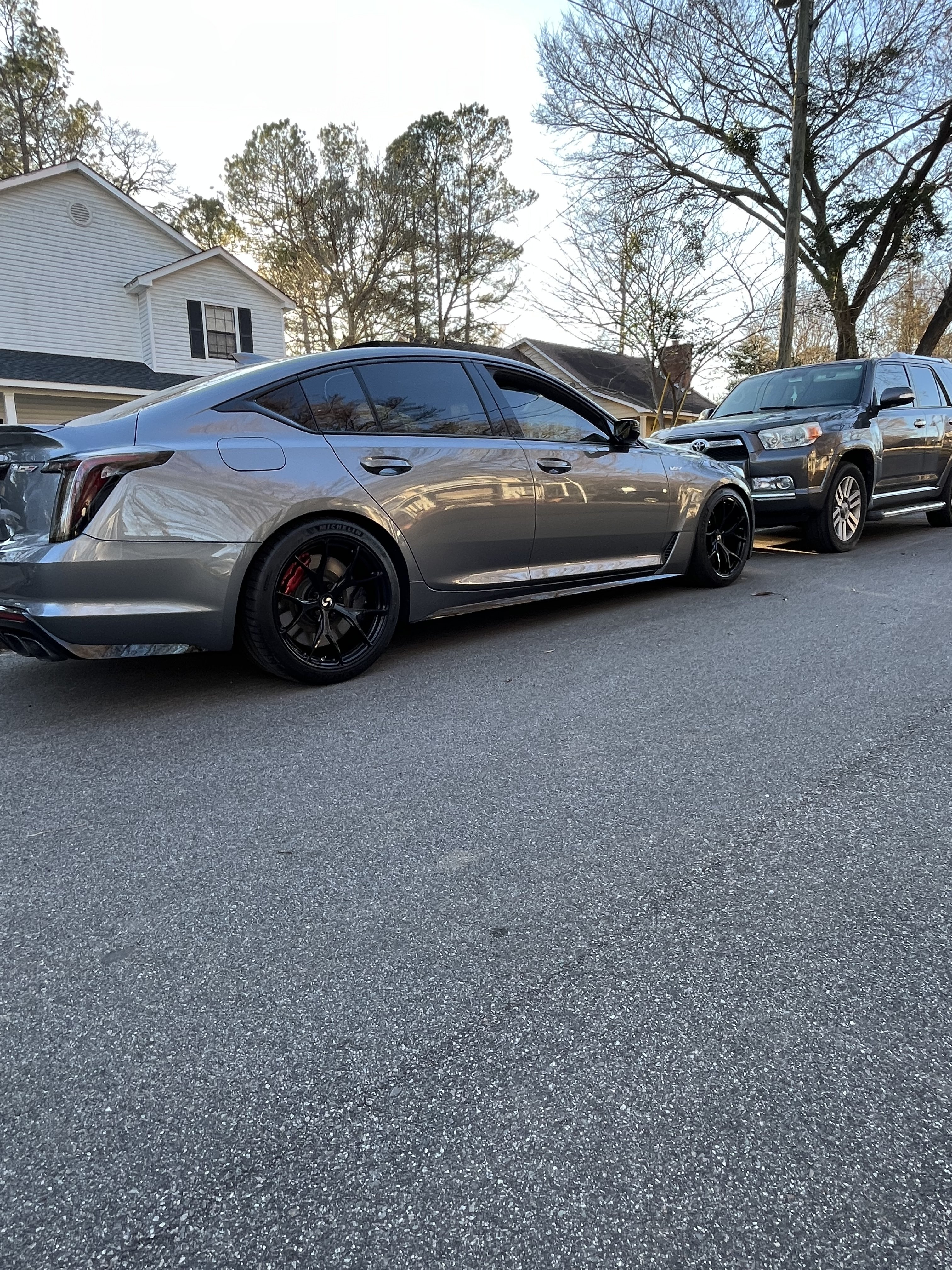

Springs are on. Ride is still awesome and feels crisper on steering input. I still have to get alignment done
