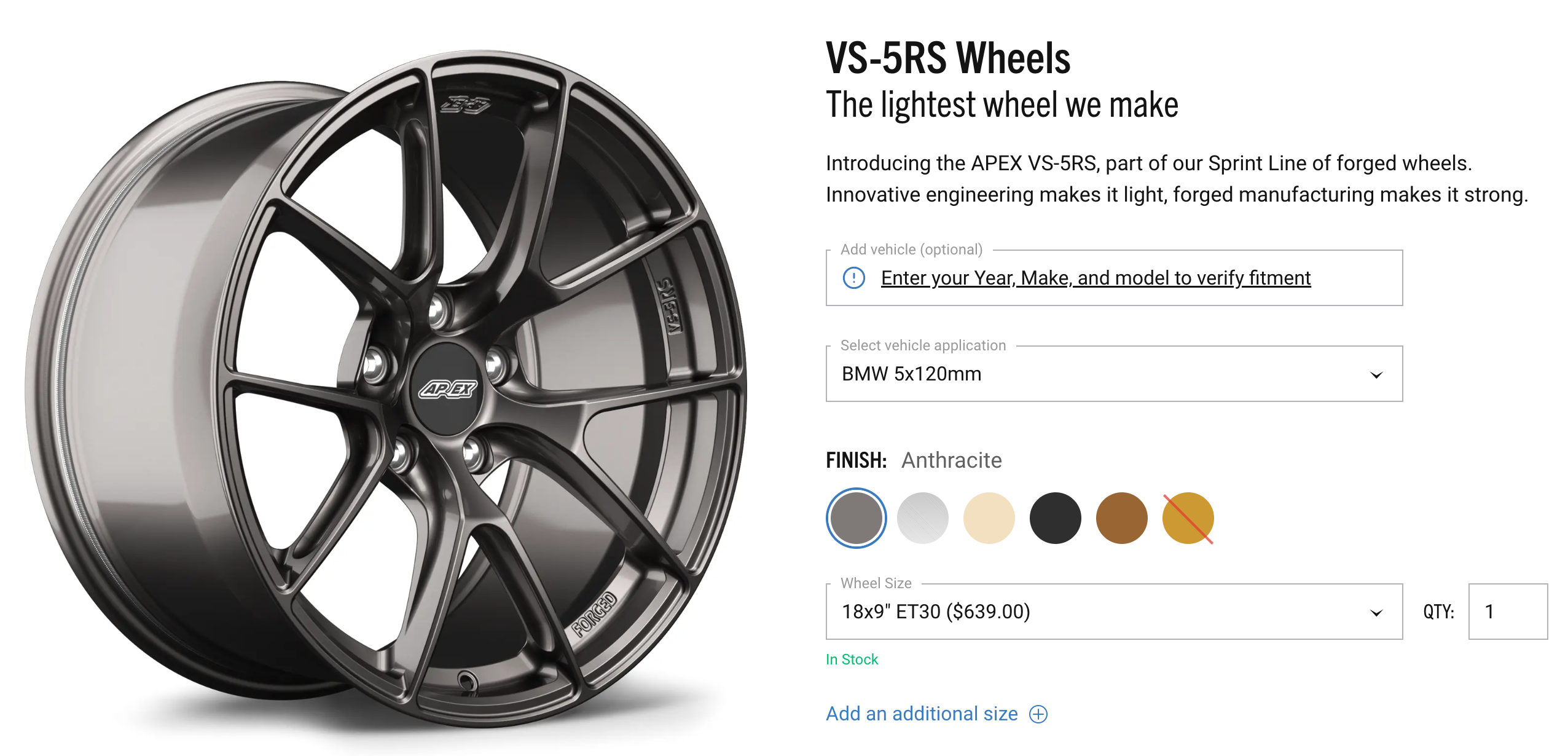

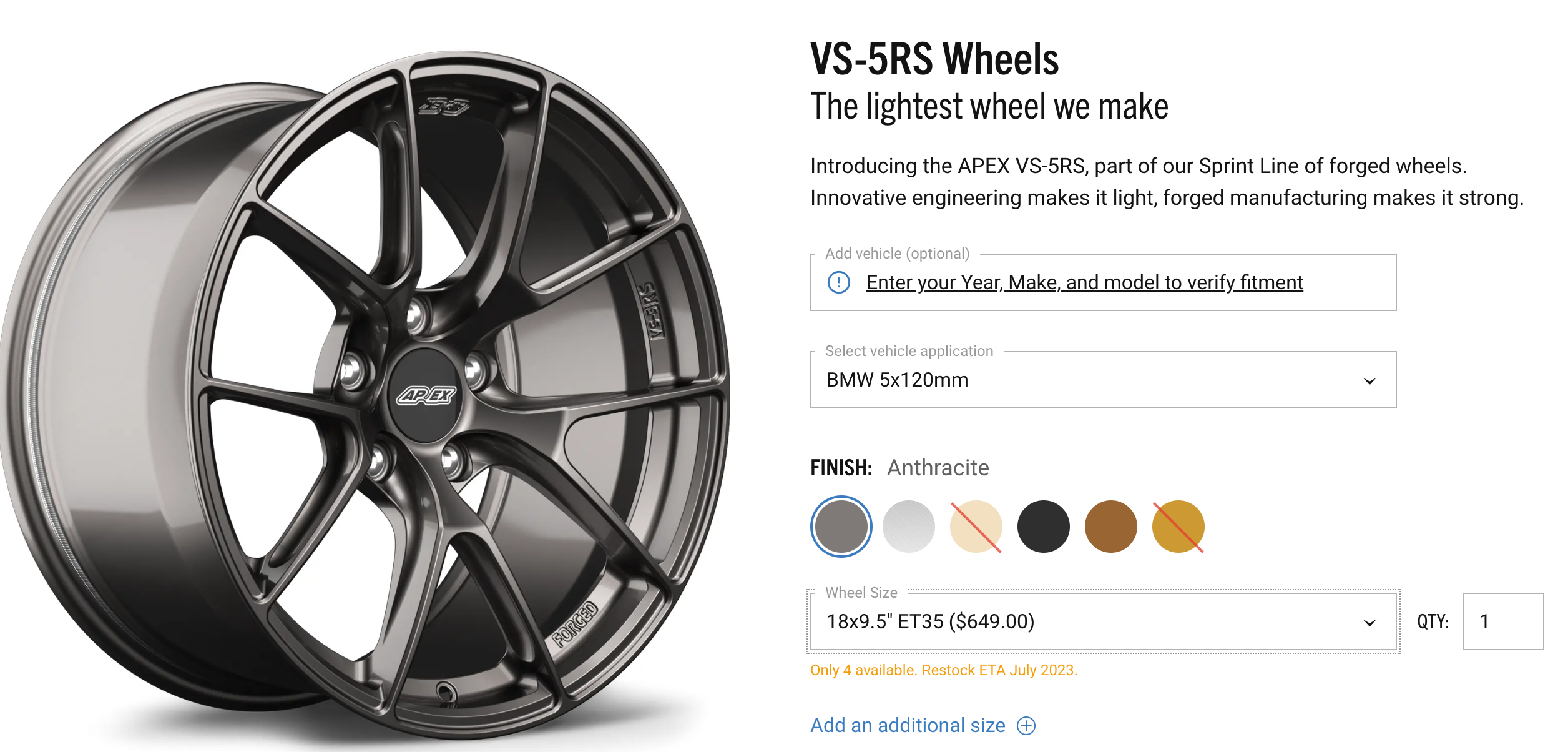

Anyone with experience with aftermarket wheels know if these Apex VS-5RS with these offsets will fit on a 4BW without requiring any spacers? The fronts real close at only 2mm difference, which I read +/- 2mm seems acceptable vs. stock. However, the rears are 13mm so it looks like they would poke out about 1/2 inch vs. stock. Not sure if they would rub the rear fender if hitting a big bump?
Stock wheels:
Front - 18x9 28 offset
Rear - 18x9.5 48 offset
Apex wheels
Fronts 18x9 30 offset

Rears 18x9.5 35 offset

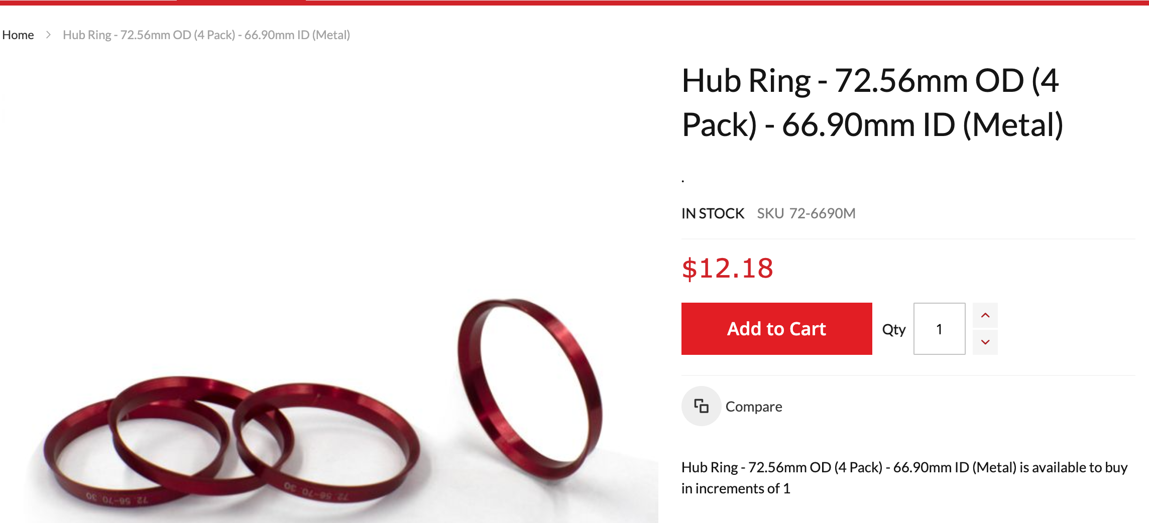

Thanks, I think these may be the correct spacers. Did you notice any difference in handling when you switched to your setup? Any issues with the rears poking out 1/2 inch?

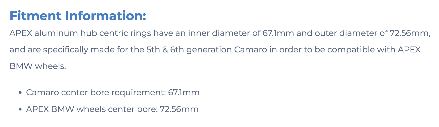

or is it these if 4BW is the same as the Camaro?
Those are the right spacers.

But the e28 9.5" square, the poke in the rear is no issue. The only thing on my setup I don't like is the square 255/35s mean the rear wheel gap is increased. If you ran an 275/35 rear, you're set.
The Apex's are substantially lighter than stock, a big upside.
