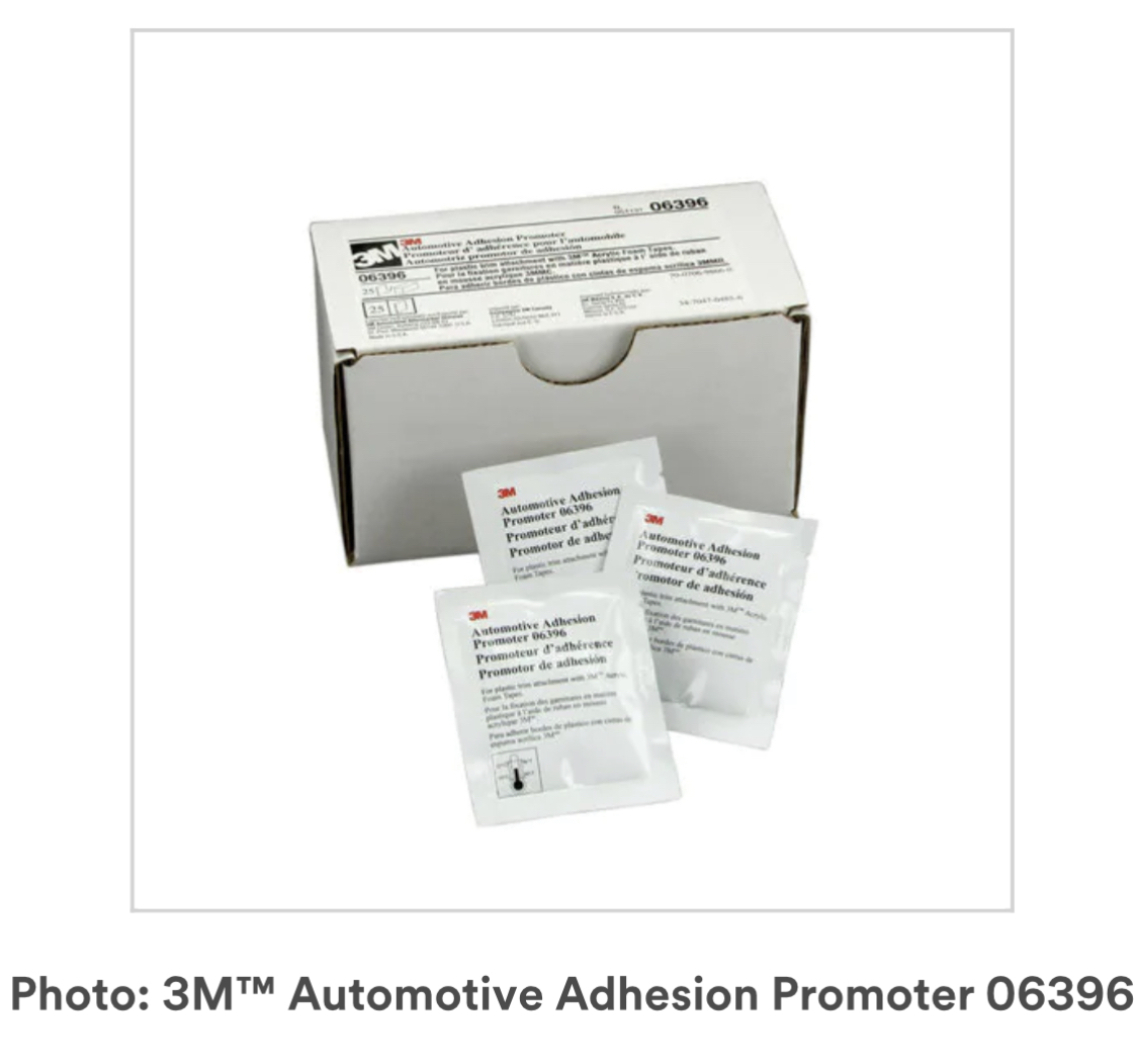

So what’s the verdict, safe to put on over ceramic coating if you wipe with the included cloth or no?
Yes, but I strongly recommend using 3M adhesive promoter 06396 before applying the badge or any trim on a ceramic coated surface.
I have a 2022 GMC truck that was professionally ceramic coated with a rated 10yr coating and it’s very hydrophobic. I installed a front hood protector that used 3M tape for attachment. I had the truck to 98 mph several times with zero issues. The protector has been mounted for 8 months and it’s “stuck” on the hood solid. I’m sure that hood would catch more turbulence than a tiny badge on the rear of the BW.
My coater told me to wait at least 2 wks to allow the ceramic to cure minimum but wait for a month if I could. I waited a month. Then, applied 3M adhesive promoter where the tape would be, then stuck the hood protector on. Using alcohol may work, but the promoter definitely works.
As an FYI, I blue taped around where the tape was going to stick to the hood to prevent the promoter from going beyond.
