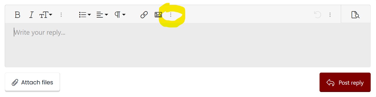

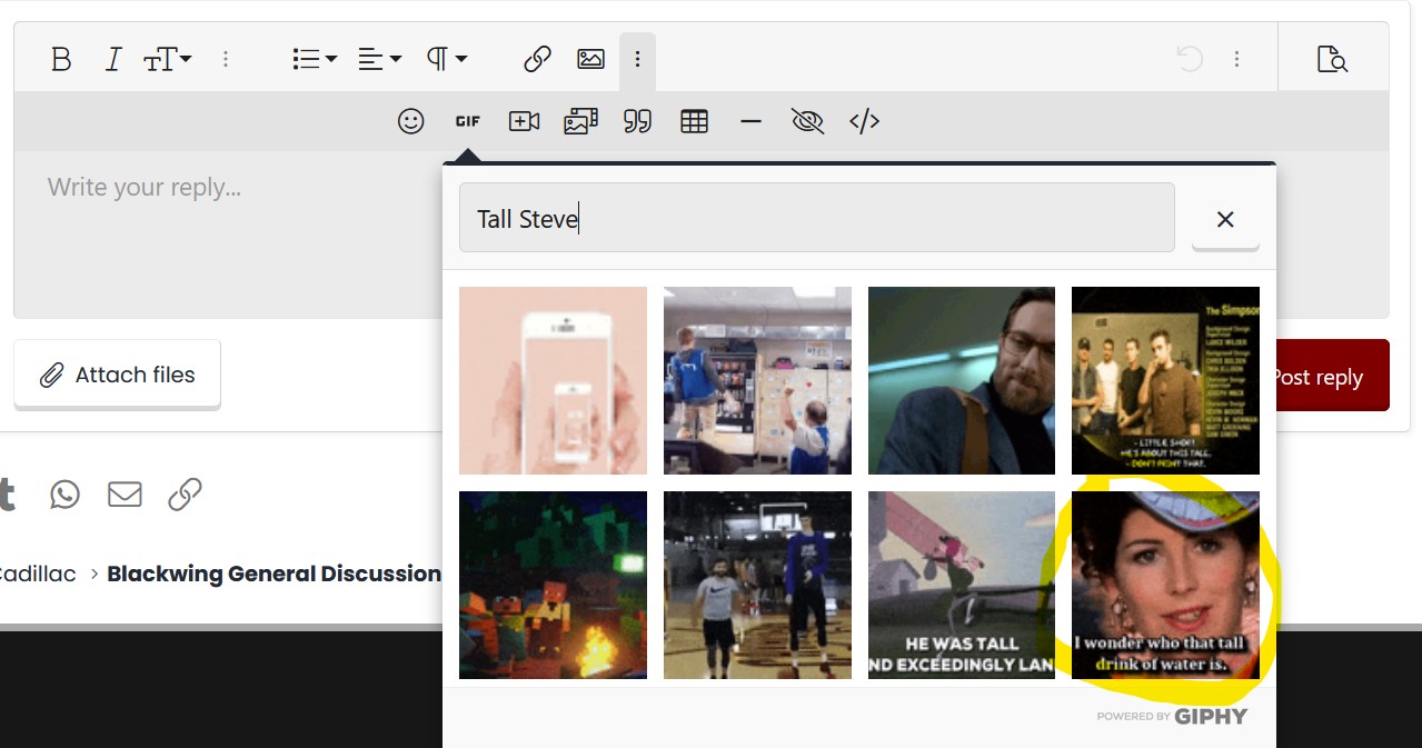

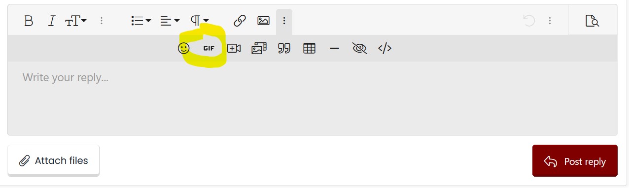

On that drop-down everything is gray. I can't use, I tried uninstall to no avail. Any suggestions?
