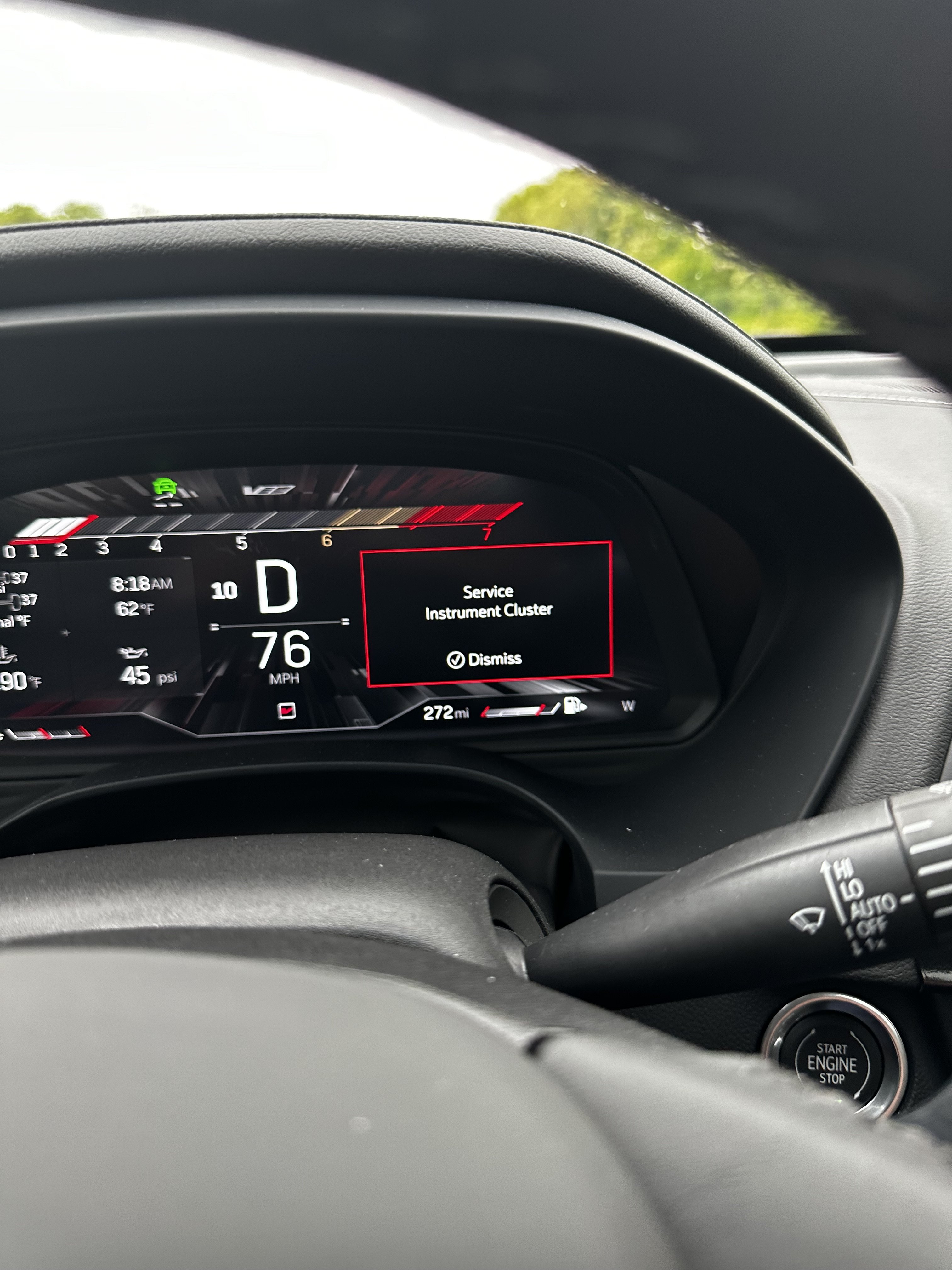

May 9 - Instrument cluster threw another Service warning this morning. Will the annoyances with this car never end?!
I guess the good news is that may dealer has one in stock because the service manager ordered it after the first warning because he could not find any source of the problem, e.g., loose electrical connection or fuse issues as others have noted on here. I wouldn’t let him install it a few months back out of my concerns about secondary damage, but now I guess I have to let him do it. Could be a safety issue at this point.
Does anyone have any suggestions on what I might look out for post installation or to warn him about pre-installation. I’m worried they are going to break trim clips and fix with glue and tape or something. Should I demand they order a new trim piece that surrounds that cluster in case they break something? Anyone have any pics from a GM service manual that shows the process for replacement of the cluster!

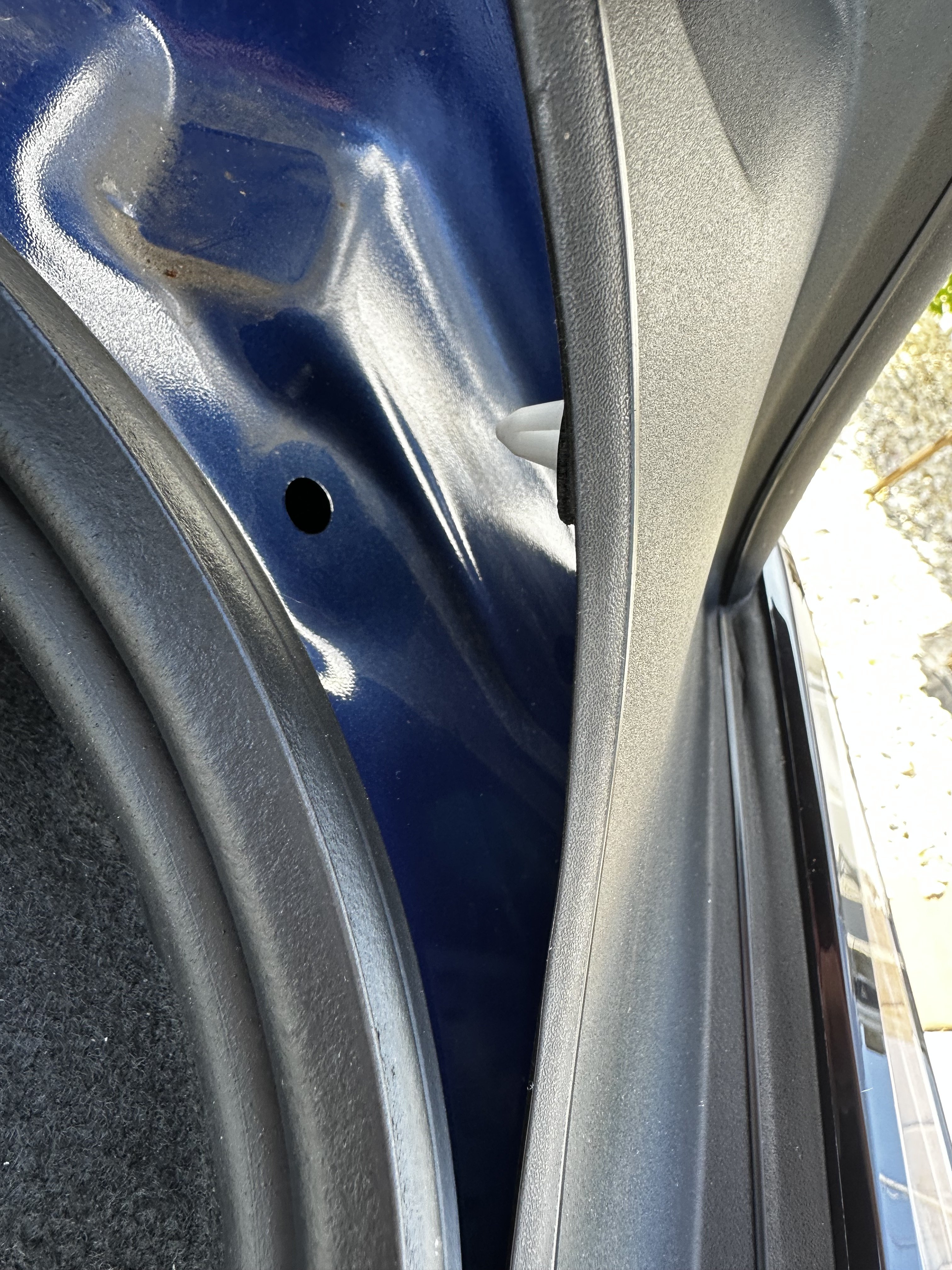

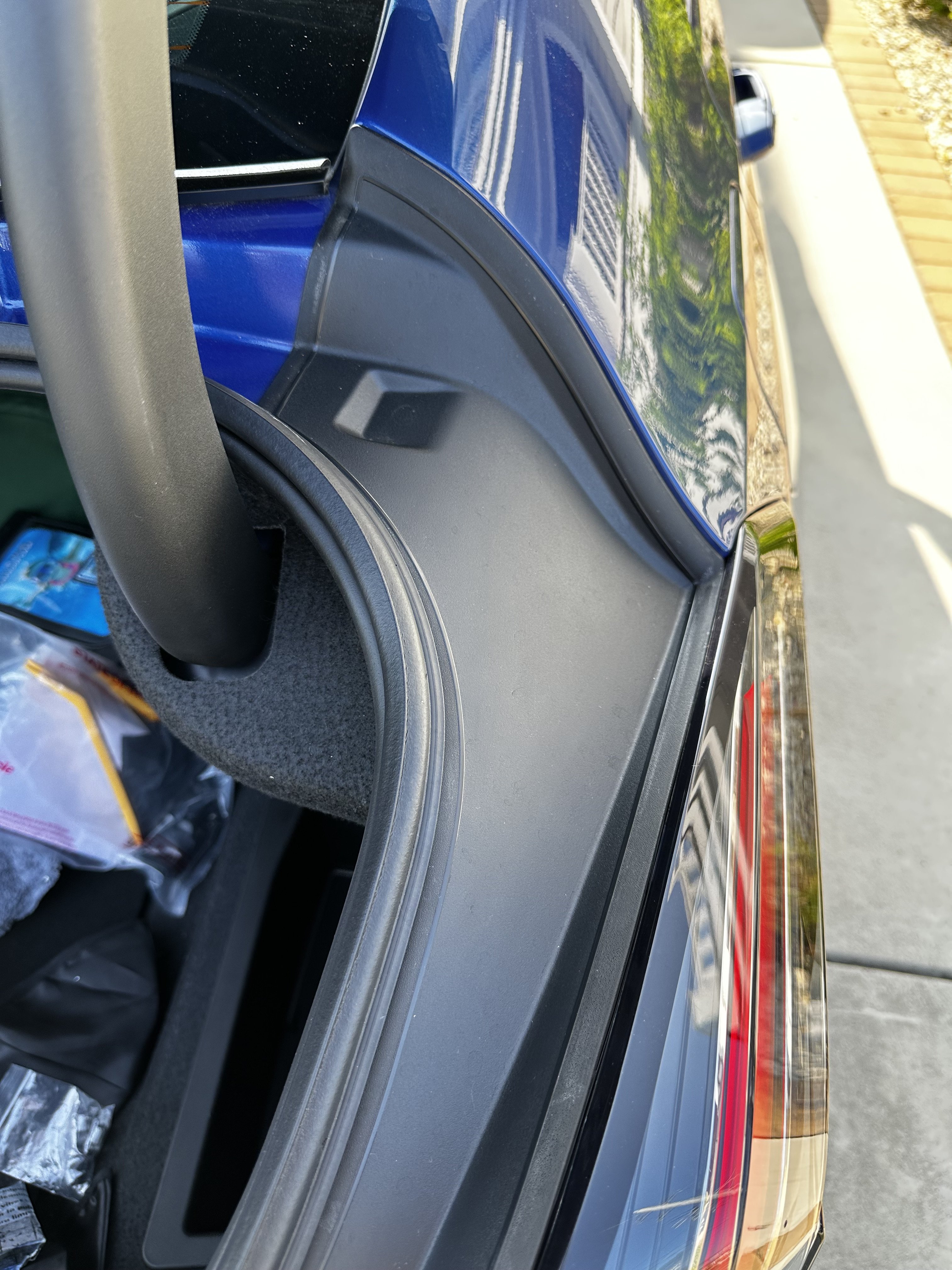

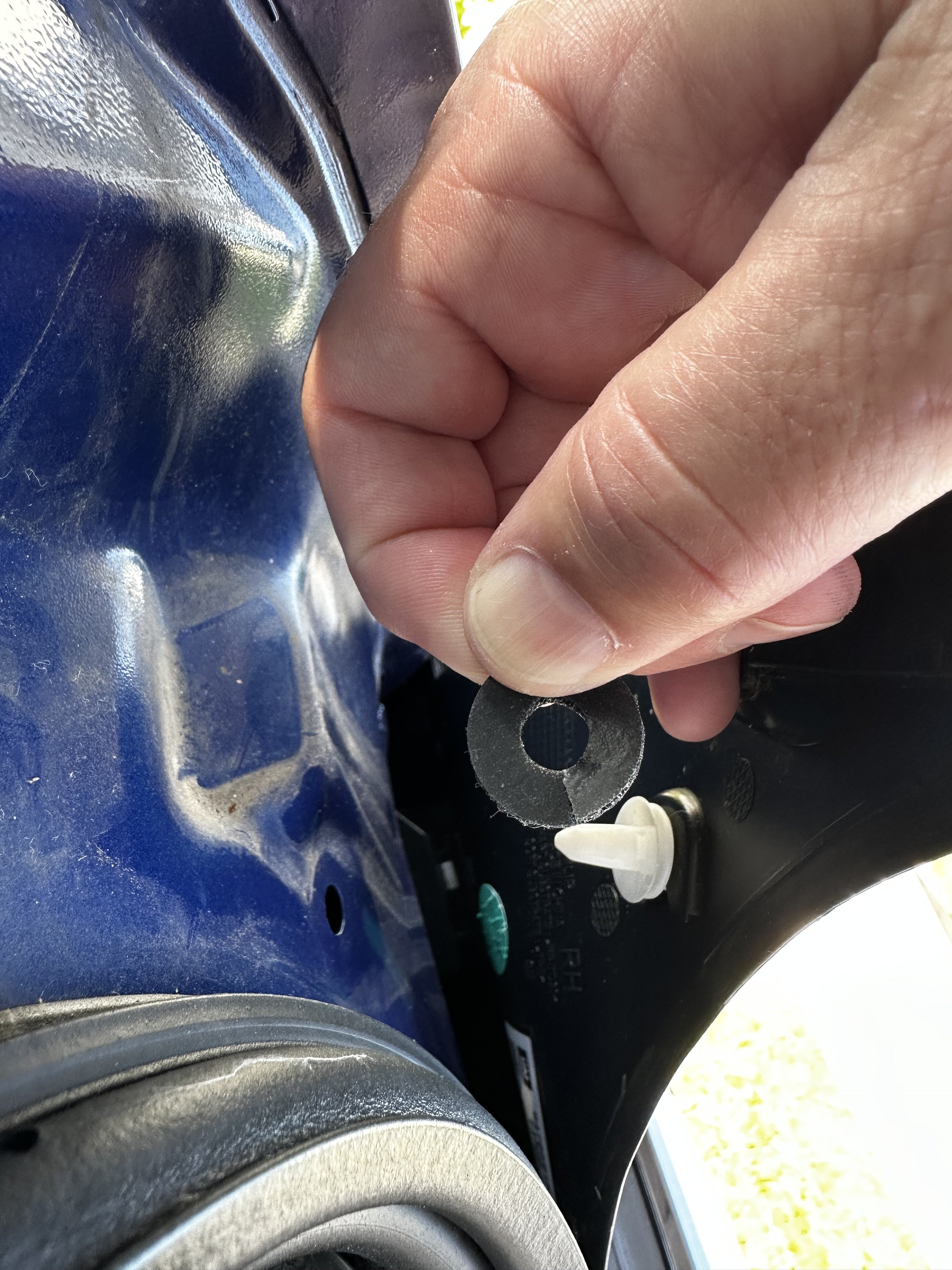

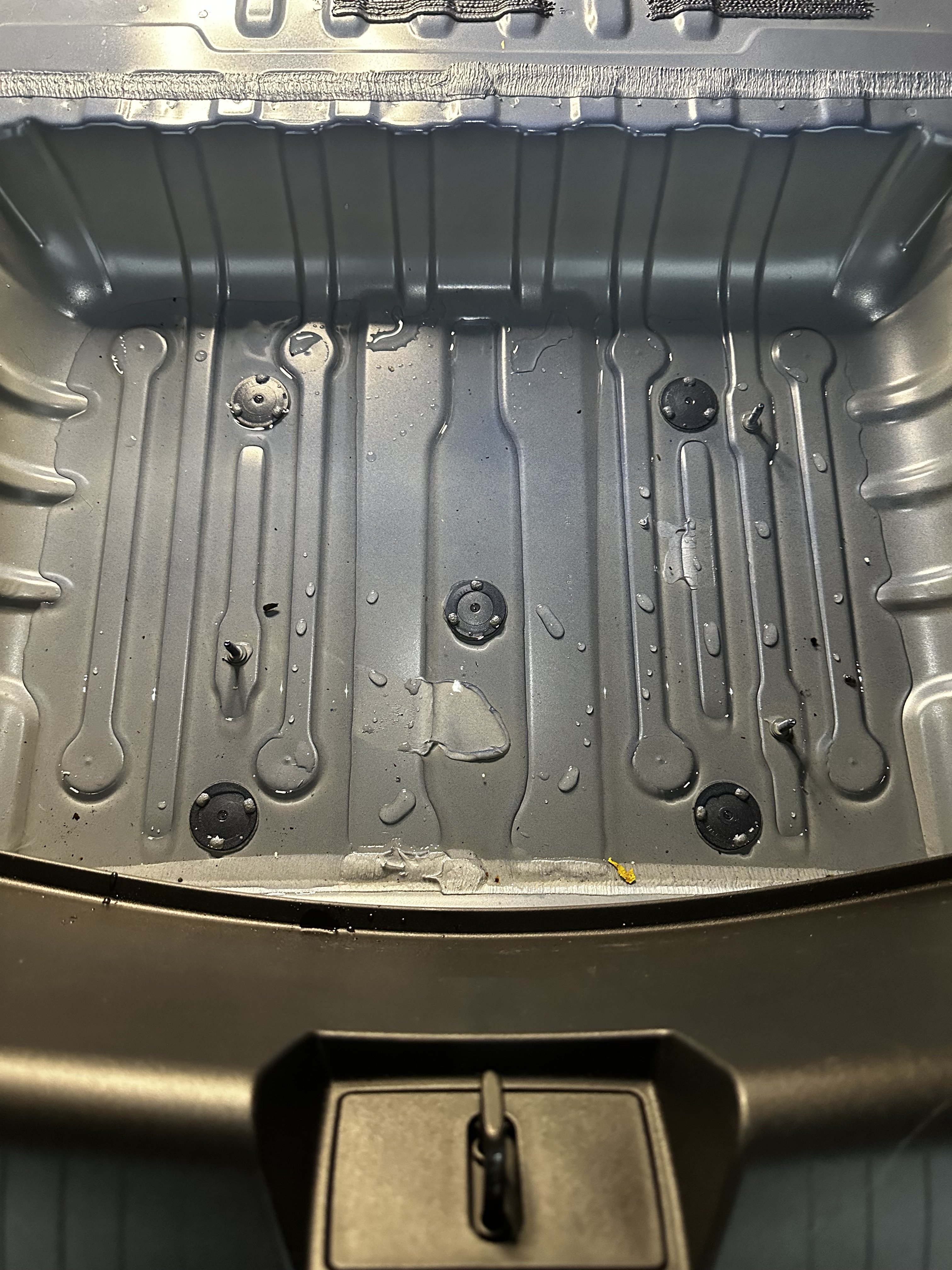

Leak in trunk now! Popped trunk and passenger side was all wet. Had some cleaning supplies in the well there and my paper towels and a rag were very wet. Popped off the trim piece and immediately saw the problem. The foam gasket washer was torn, misplaced and possibly missing adhesive. Dealer replaced my taillights because of glue stains inside and they clearly had to remove and replace this piece of trim. Now why GM put a hole where water runs down is beyond me, but to not have replaced the fastener and washer-gasket is just inexcusable. I’m betting these were one time use parts.

Service manager tells me he does not think those trim pieces and those holes need to be watertight. Confirmed tonight during rainstorm that they absolutely need to be. Taking to dealer tomorrow. will need entire new trunk liner. GM/Cadillac is just letting me down.

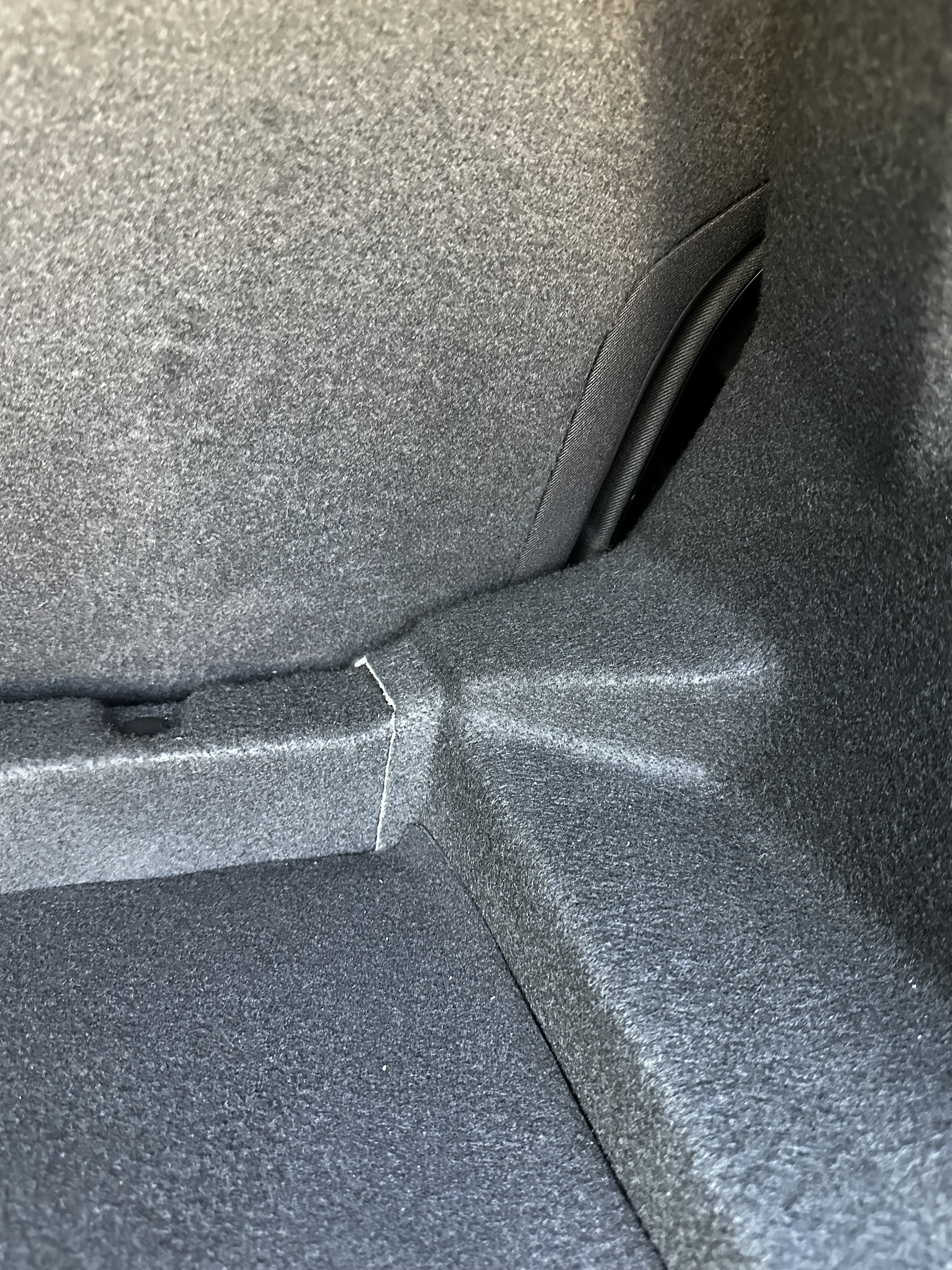

Trunk liner wasn’t even properly installed - various components were not seated properly as a result not being installed in the right order. I fixed myself.

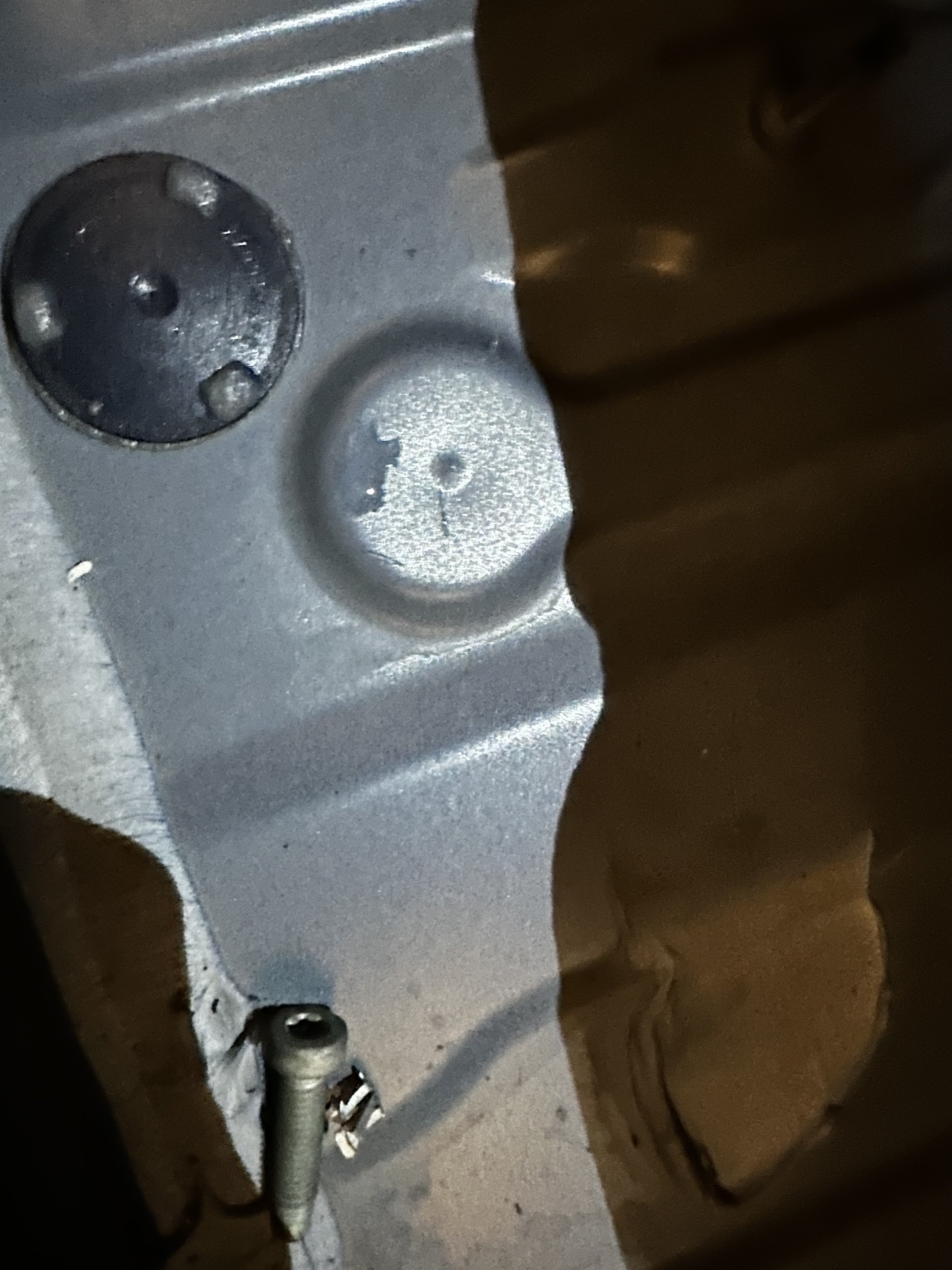

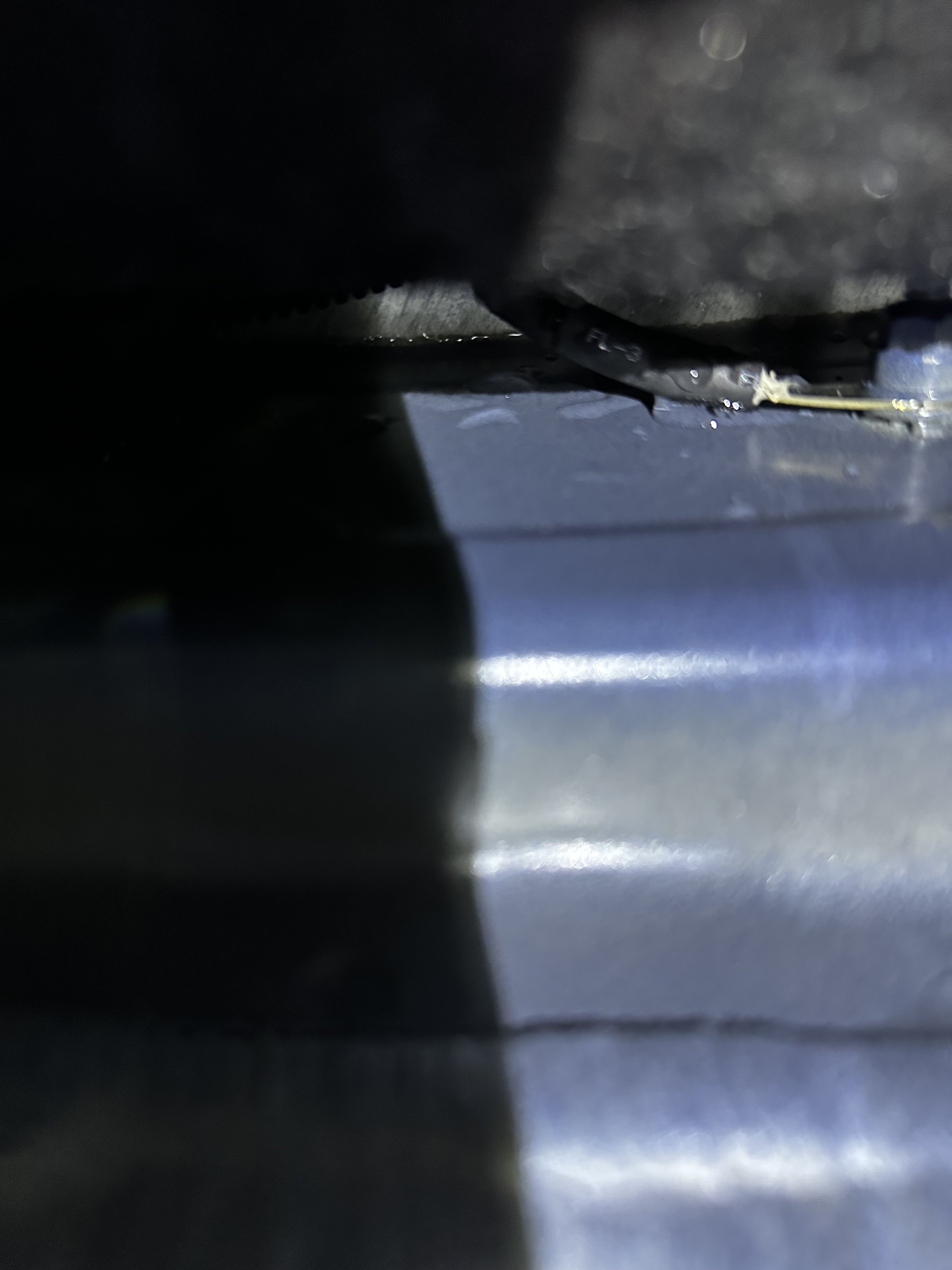

Also, when I diagnosed the leak problem I found a bolt and clip under the floor tray (styrofoam tray holding the fixaflat). Pic below, in which you can also see water from the leak. Anyone have an idea where they are from? I’m worried that when they replaced the tail lights they dropped these and just left them there. Service department has yet to answer my question on this. Also found a second one of the tiny clips when I got the car back yesterday after the entire car liner was replaced.

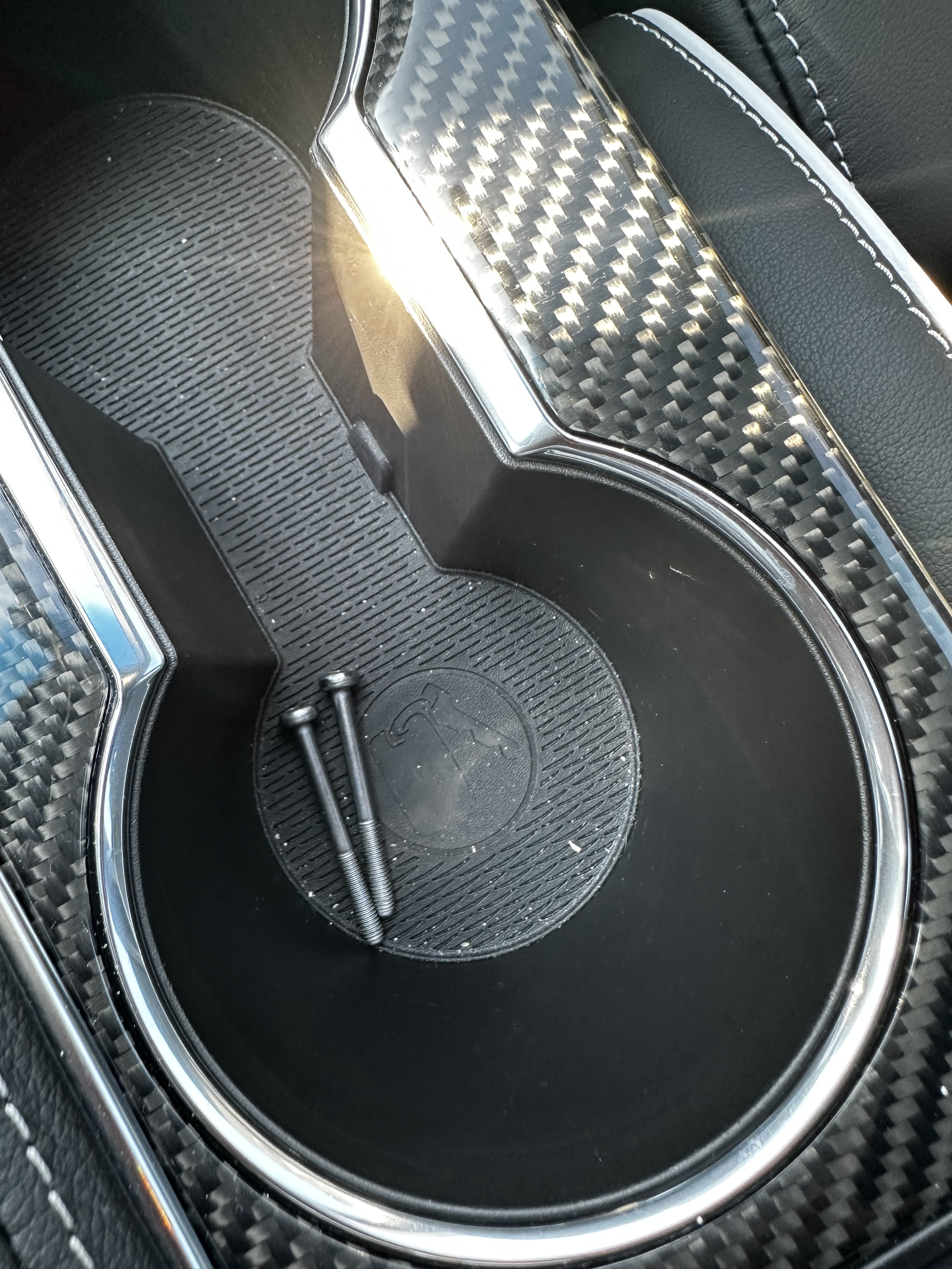

Lastly, since my instrument cluster had thrown two service me codes I asked them - if they had the instrument cluster that they previously ordered to - to replace it while it was there. They sent that one back and had to reorder it and wanted to keep it yet another day. I told them no thanks. I’ll take it back. Picked up my car and turned out they partially disassemble the dash and threw it back together and forgot two bolts!!! Found them in the cup holder and the dash shroud is clearly loose. See pic.

First pic...assembled in wrong order. The center piece behind the rear seat goes on after (on top of) the side panel.
Pic of bolt and clip...looks like the bolt that holds one of the tie down loops and the clip one of several that holds the scuff panel covering the latch area.
yup wrong order. Thanks on the clips id. They scratched that scuff panel a lot taking it in and out.
