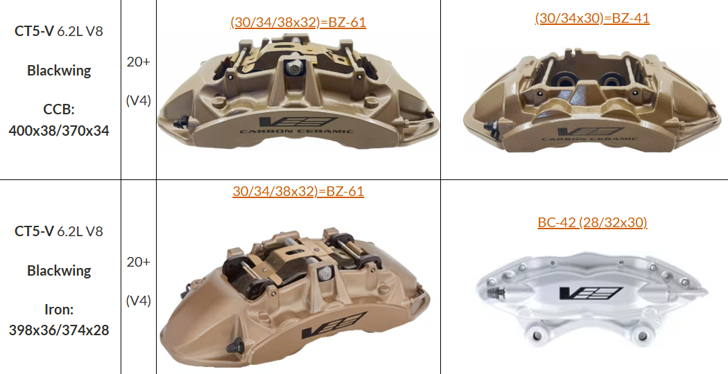

I'm getting ready to purchase the red calipers for my 5BW (currently the gray).
Some of the GM parts sites have the ceramic calipers cheaper than the non ceramic. They have different part numbers so I'm wondering if these calipers are interchangeable? Rockauto has a set of the front right now at the best price but they are also the ceramic calipers.
I don't want to purchase something that will not work so I'm here asking if anyone would know.
TIA
The fronts are the same BZ-61 calipers. At least according to that diagram. Rears are obviously very different.
I just looked and GM has different part numbers for CCB vs iron calipers. The prices are nearly identical. I believe the difference is just the graphics on them. Both have the V logo but the CCB brake calipers say Carbon Ceramic below the logo.
^this. The mounts are different for the front calipers as the CCB rotors are larger, but the front calipers are the same minus the graphic that says carbon ceramic on it. Rears are completely different.
