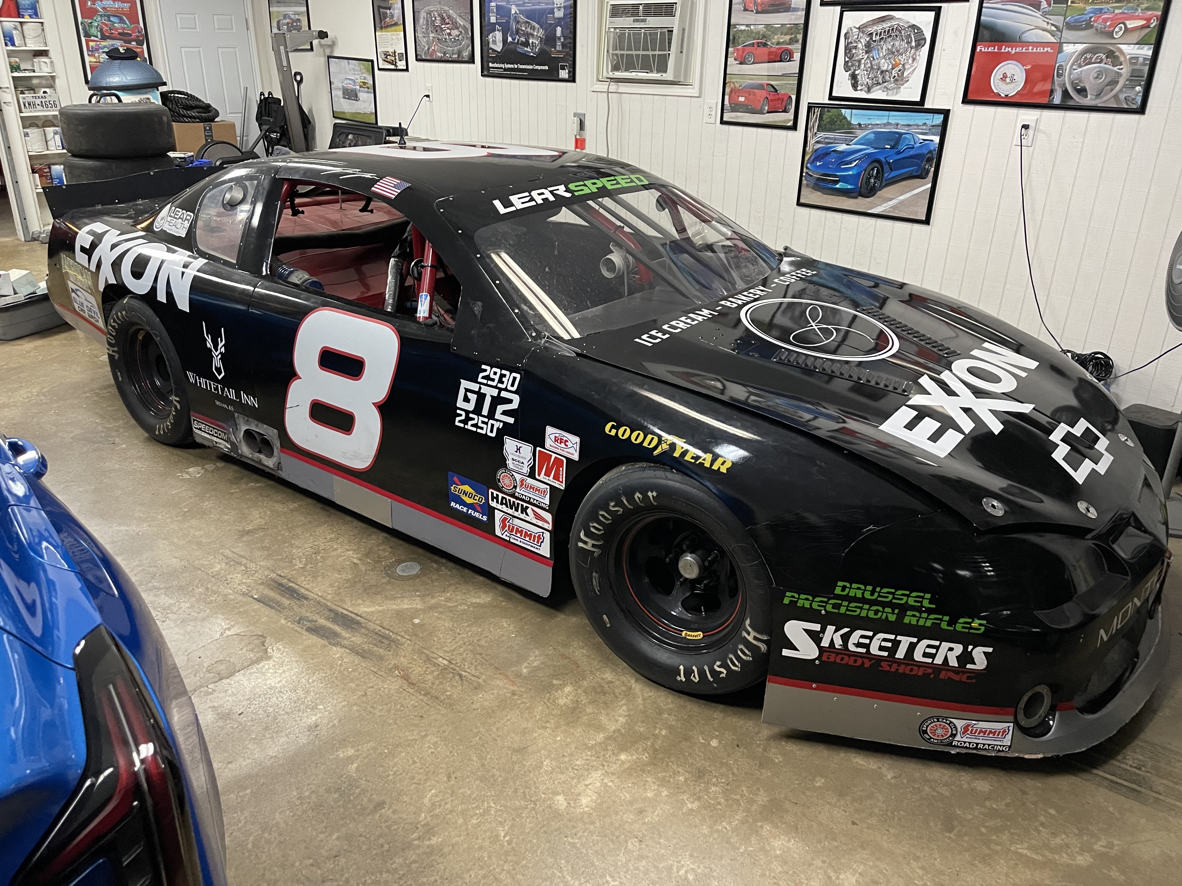

Insulated garage with an AC window unit with heat. I’ll just set it to keep it 45 and above if needed. If I’m out there working I’ll keep it above 60. I’ve got a few small space heaters if needed. Not a fan of using those unless I’m in the garage though. I’ve got a remote temp gage that displays on the bedroom clock so I can monitor temps. The AC is NICE when it’s 100 plus outside! I used to think that tire cracking was a myth until I saw my own tires crack! These were going to be used at Homestead Miami on the Roval layout. That would’ve been catastrophic at 165 on the front straight! The side load on the progressive banking on NASCAR 4 is quite heavy!
Pic of window unit (top middle) with obligatory race car shot. And race tires. Since tires is what this is about! I’ve used the Pirelli wets in 32/33 degrees freezing rain at COTA with excellent results. Fortunately, no cracking. And that’s an even softer compound than a slick!! You have to run them in the wet or else they just melt/chunk off. That’s why you’ll see many racers going wet spot to wet spot on a drying race track.

Wow man! Thanks for sharing. That garage looks like a bedroom with cars in it… I mean I’ve seen apartments less nice than that!
I can appreciate any advice from someone so obviously experienced. It makes me more confident in my decision to get another set of wheels and tires.

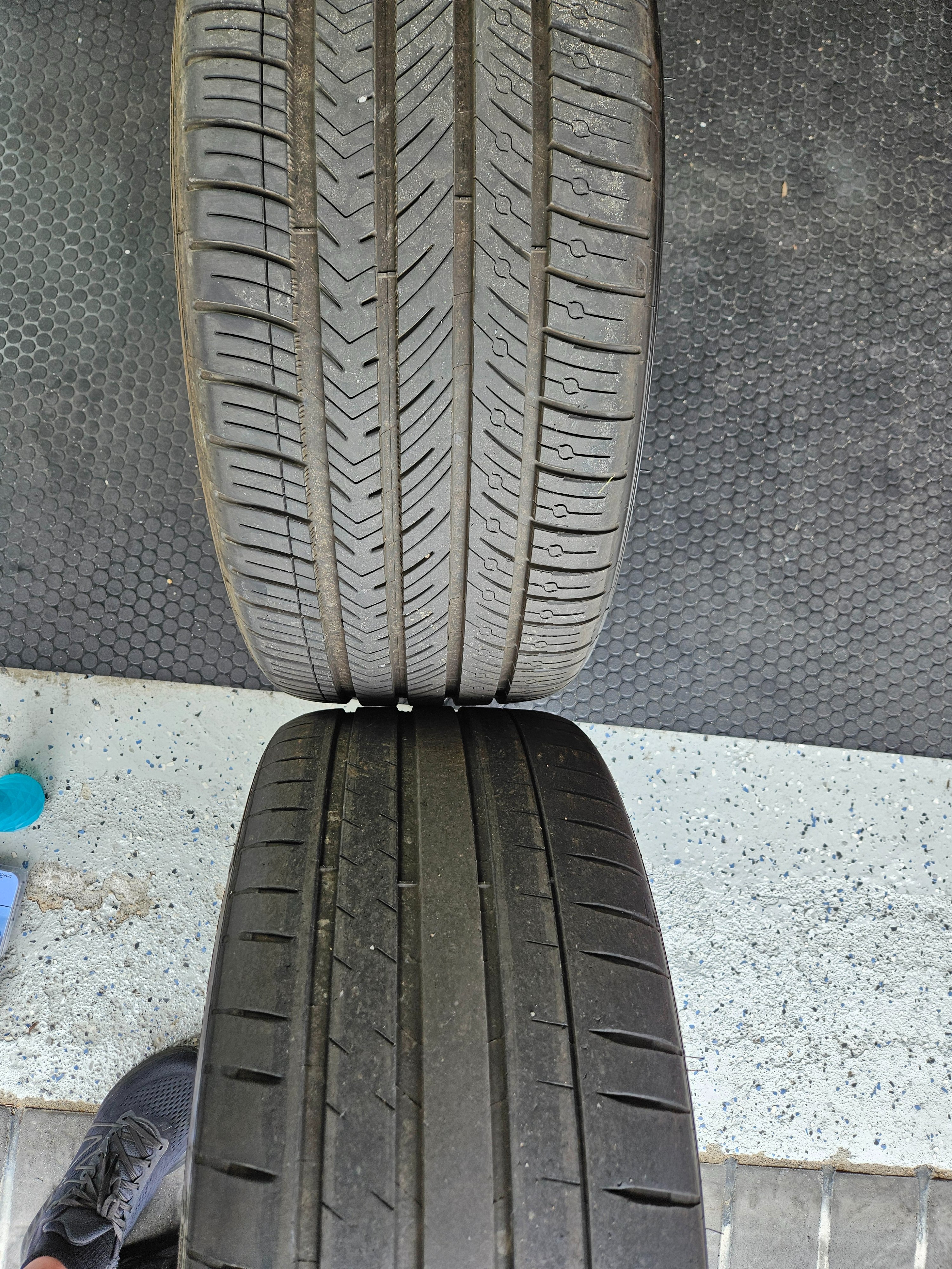

So I picked up a matching set of the black satin wheels which I mounted AS4s onto for the winter. Here are the front and rears of the AS4s up against the PS4s. As other have mentioned the AS4 are 275/35/19 up front and a 285/35/19 in the back. The widths of the fronts are comparative, obviously since there's the same size. The AS4 rear is just a bit less wide than the PS4 at at the sidewall, but you can clearly see the narrower contact patch. I also threw in a photo to show the spread where the AS4 rear meets the wheel so you can get a sense of just how much it pulls away from the 11" wheel pulls.
Though the contact patch is smaller, they handle perfectly fine on the twisties even when pushing the car for extended periods of time. Granted, we're not talking track driving but they are more quite adequate for my winter driving. Also potholes are not a problem with the stretch on the 285s. I am in NY and have hit a few deep potholes in the mid of winter with the AS4s and no damage to the wheels at all.

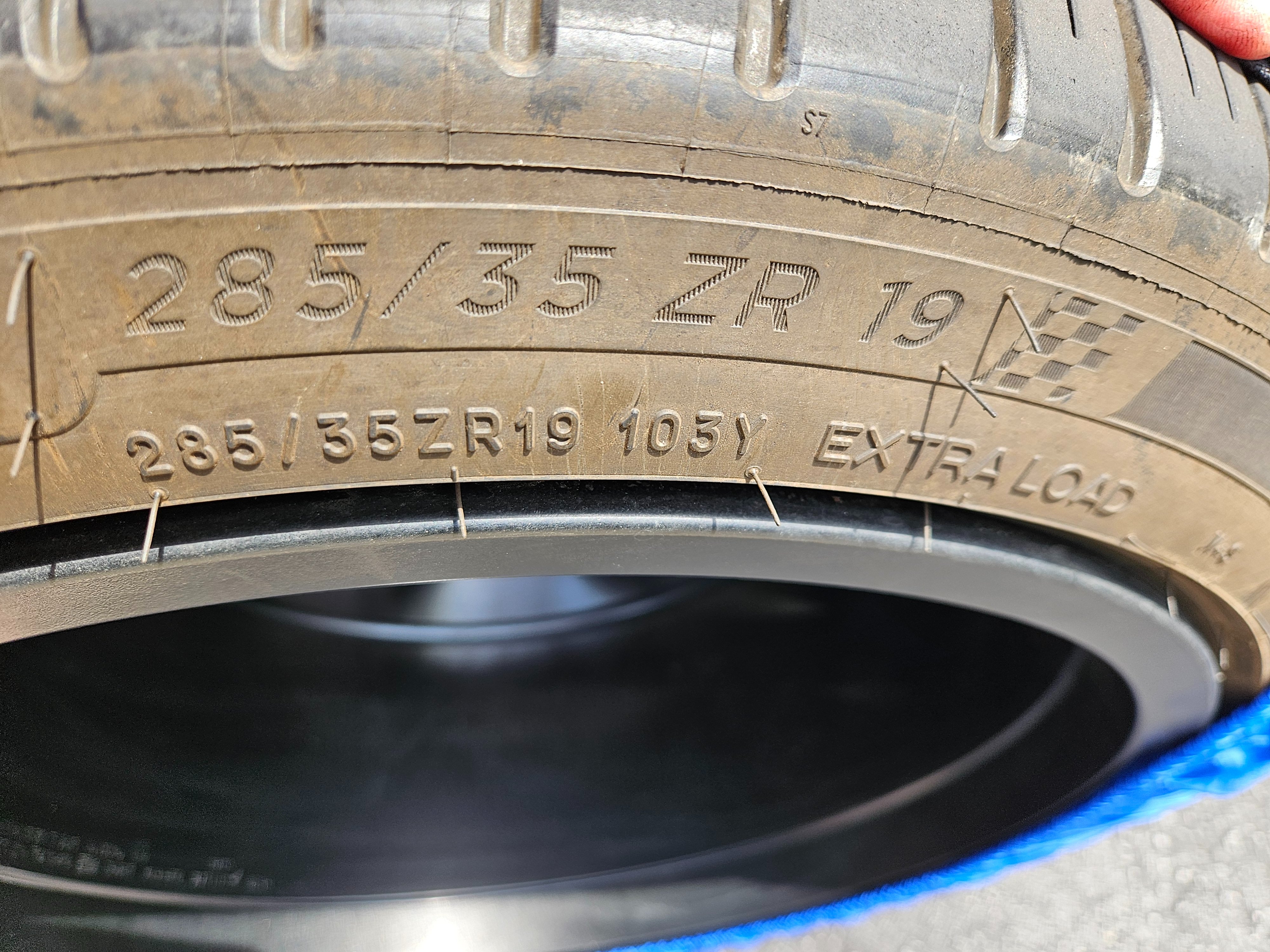

Word, but are they available in the 305?
The ONLY A/S tire I was able to find that fit the BW rear is the Invo. Which isn’t necessarily bad, the reviews are pretty good on them. I had been hoping for more of a straight up winter tire like the Alpin, but can’t find it anywhere. 🤷🏽‍♂️🤦🏽‍♂️
