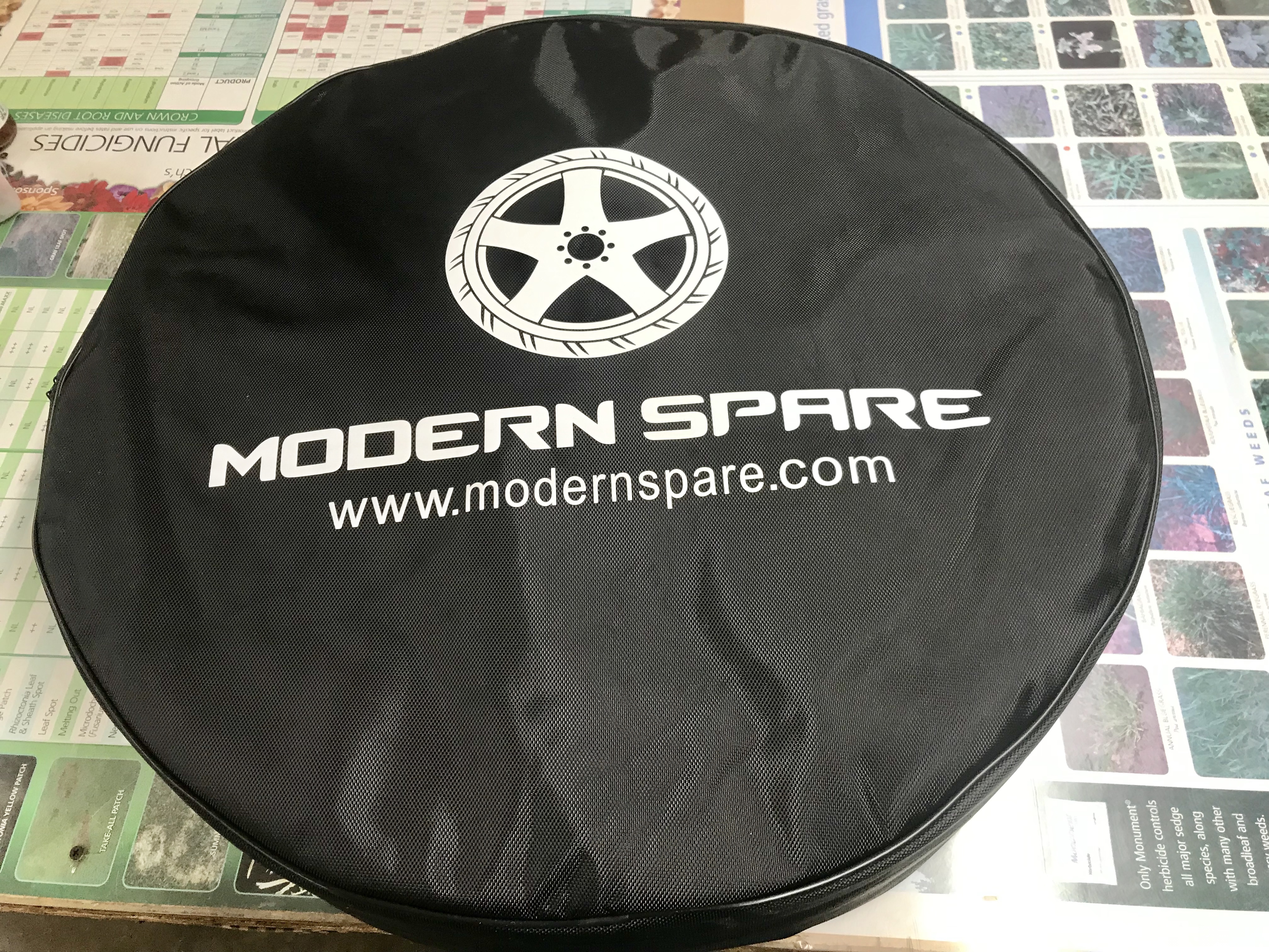

I had one of their kits in my "sons" Camaro and it was a nice setup...

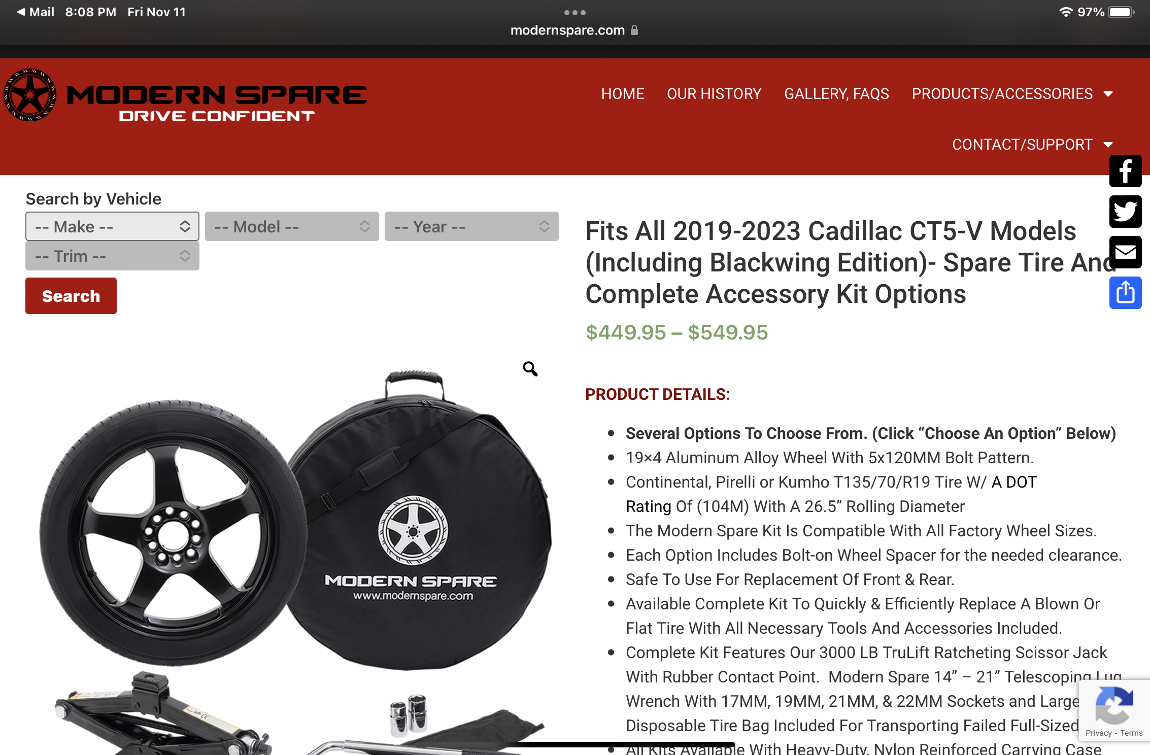

Just checked and found the following for a 5 BWView attachment 14346
Adding the link....
But it's on backorder....
These kit options are currently in a “backorder” status. The specific wheel required for this vehicle is out of stock and not expected to be ready for shipment until late November though possibly sooner. We encourage you to submit a backorder reservation. With this reservation, you will have an order in place once the wheels arrive. No charges or holds will be placed on your card until the kit is in stock and ready to ship. At that time, you will be notified via email with order information. This will ensure your order is in place and you will not be affected by other potential inventory shortages. Thank you – Modern Spare

I had it in a Camaro and it took up a lot of room....IMHO it will take up room in the trunk of a 5BW too but I'm going to get one as I don't put crap in my trunk.. To me its a great insurance policy..
